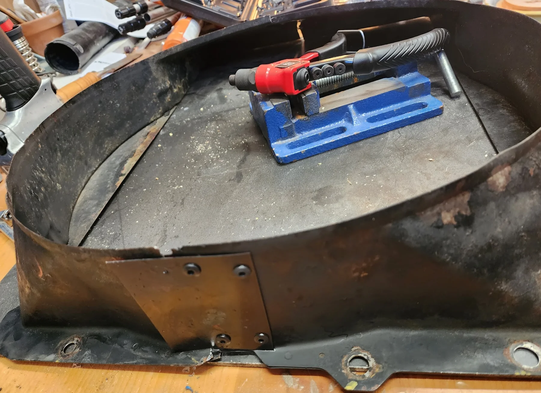

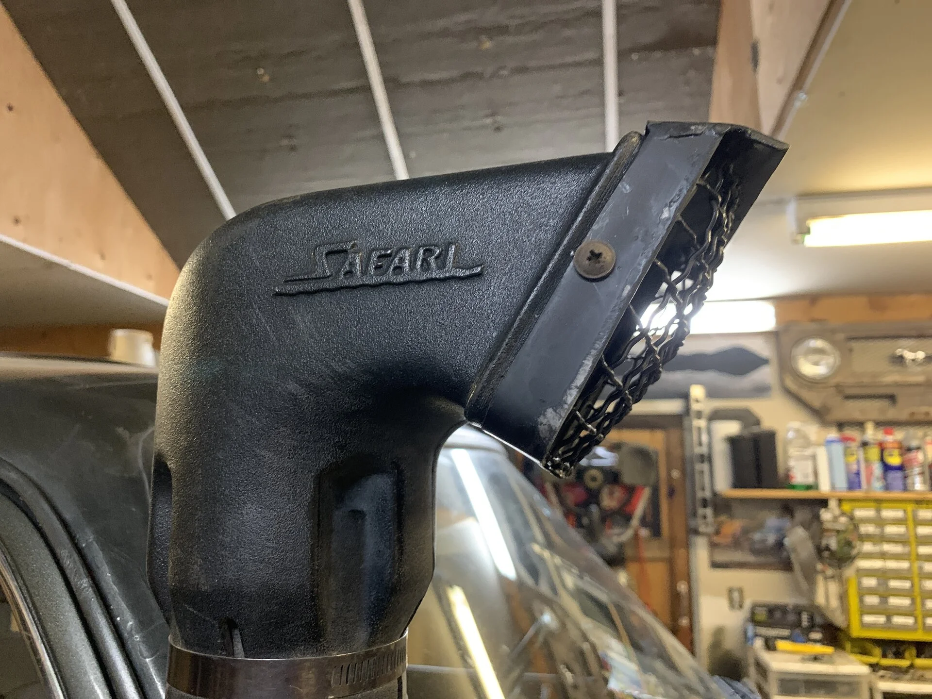

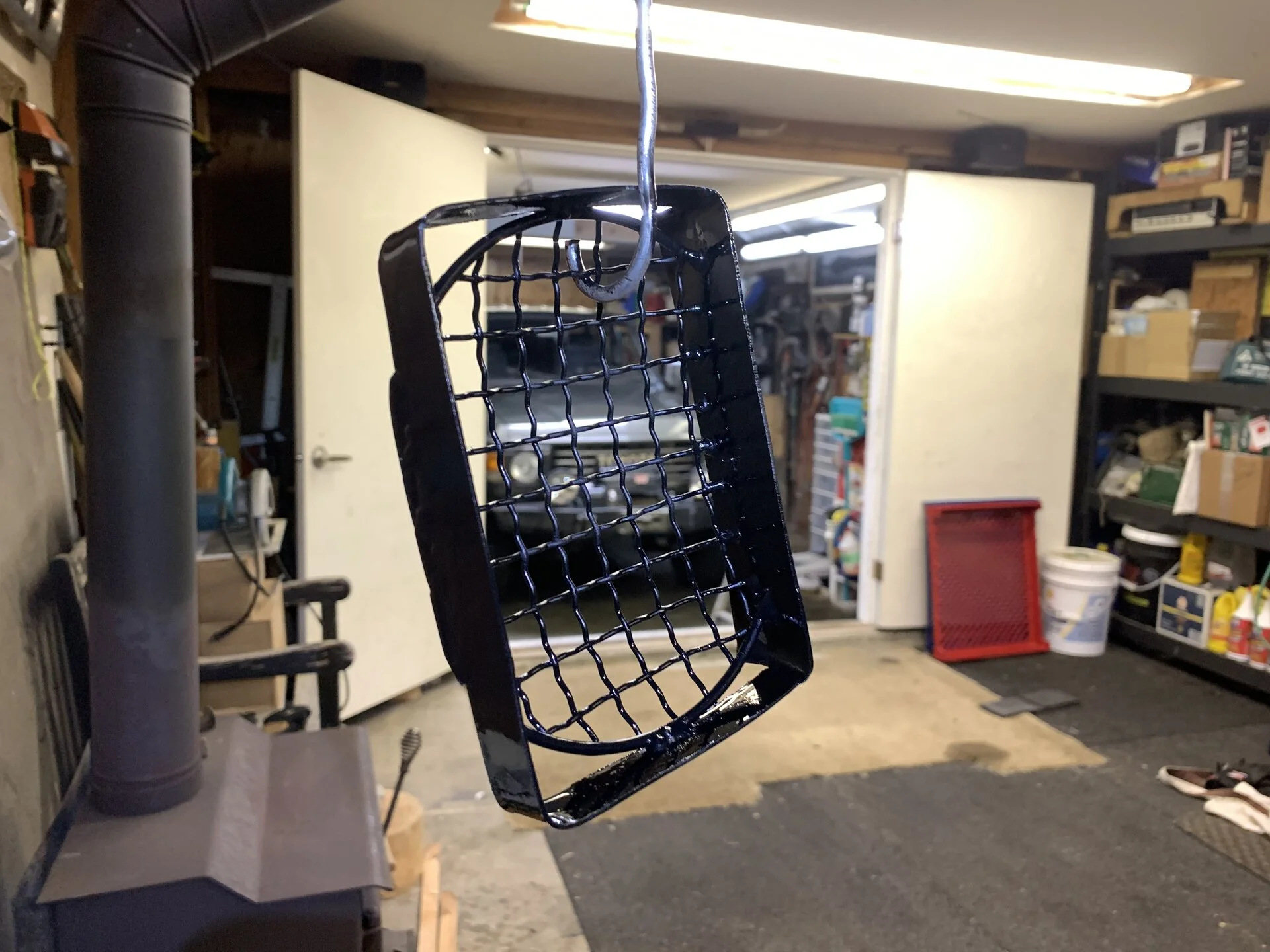

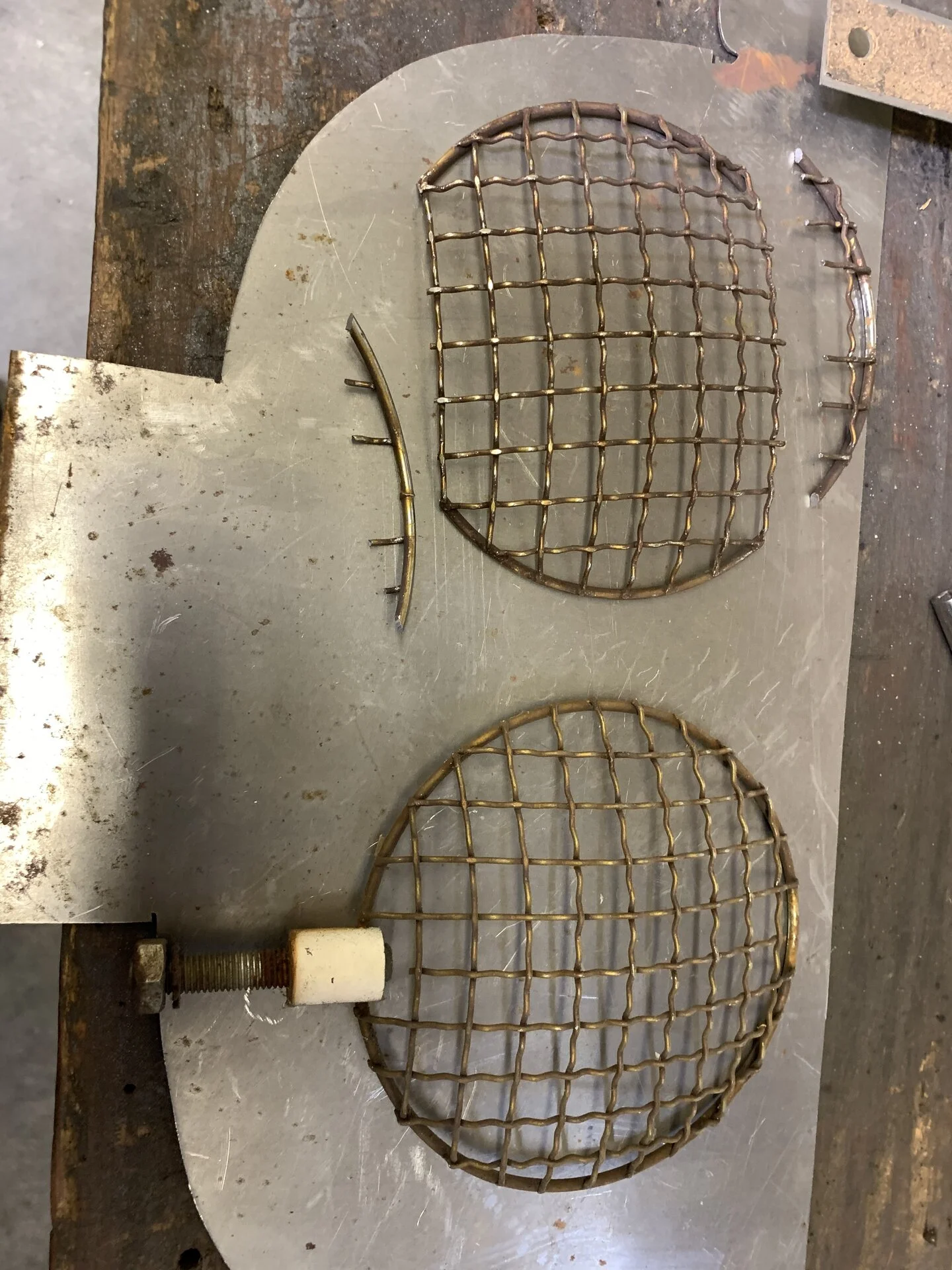

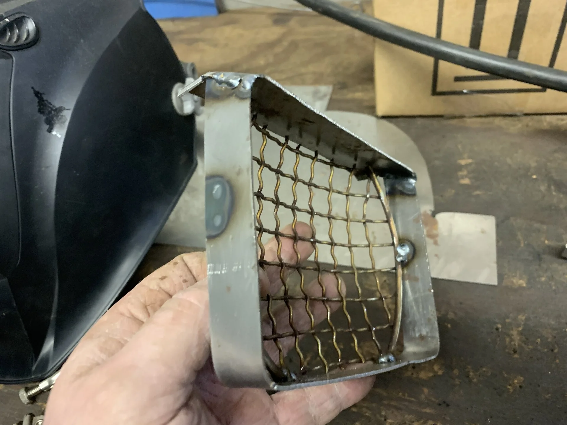

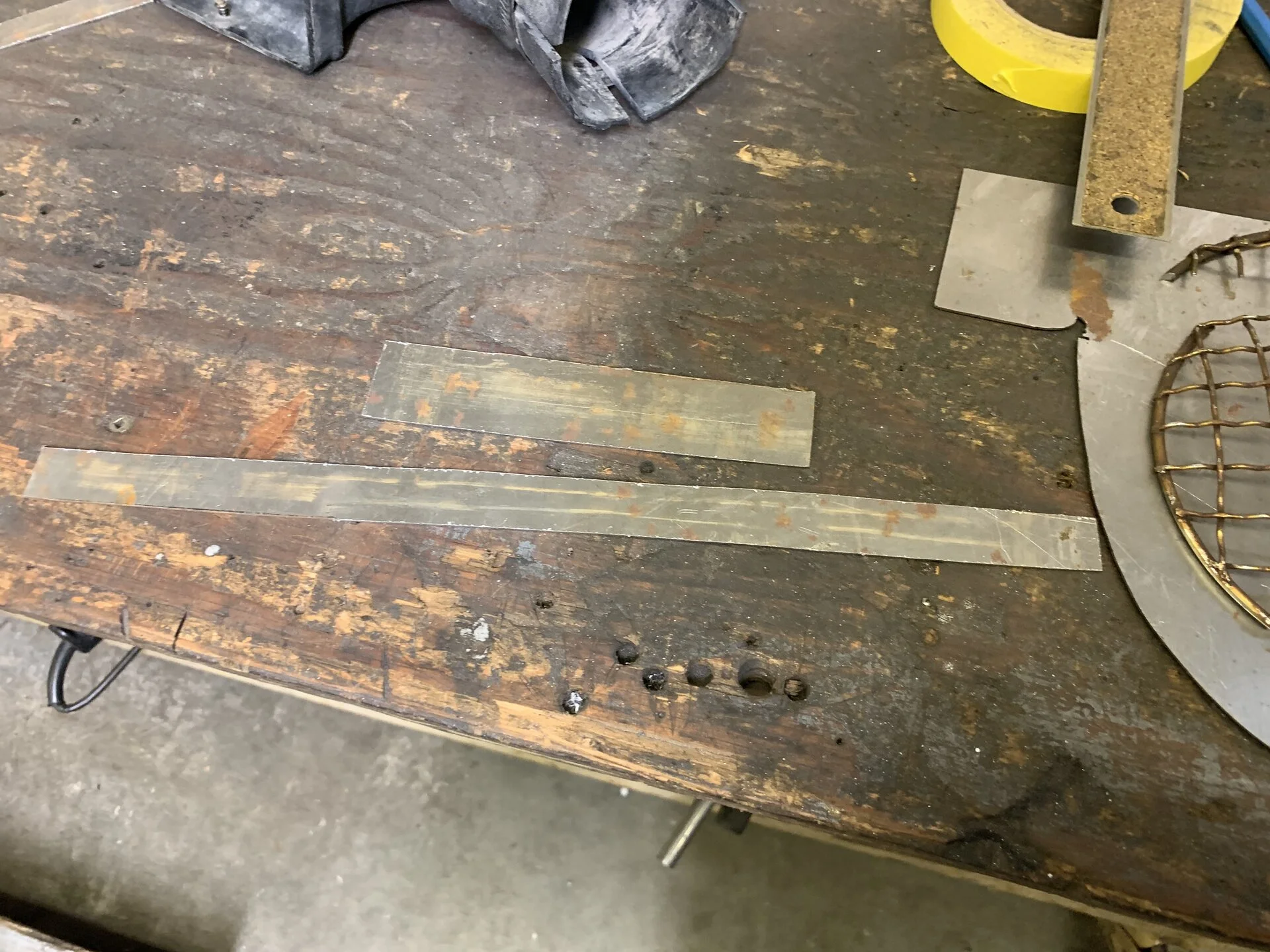

Custom Snorkel screen. Got a couple of hours to kill.
In no particular order. Took one of my old last century round headlight screens and made rough cut. Couple of strips of .18 ga metal leftover from fender work. Bent it up. Welded it up. Kind of fun. Got a road warrior vibe to it. Should keep the sticks and leaves out of my airbox now. Final pic when the paint dries.

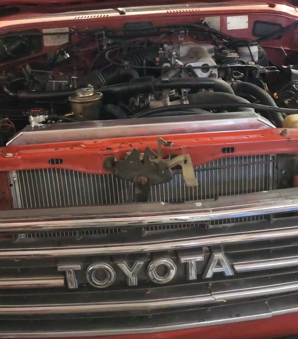

Is that a Mishimoto?
Honestly... No idea. It's from cruiser corps. Got here in great time, no damage. Cools good. Cooler than the original.
Only _minor_ gripe, the AT lines wouldn't screw in as far, the threads ended and blocked my threading it further.

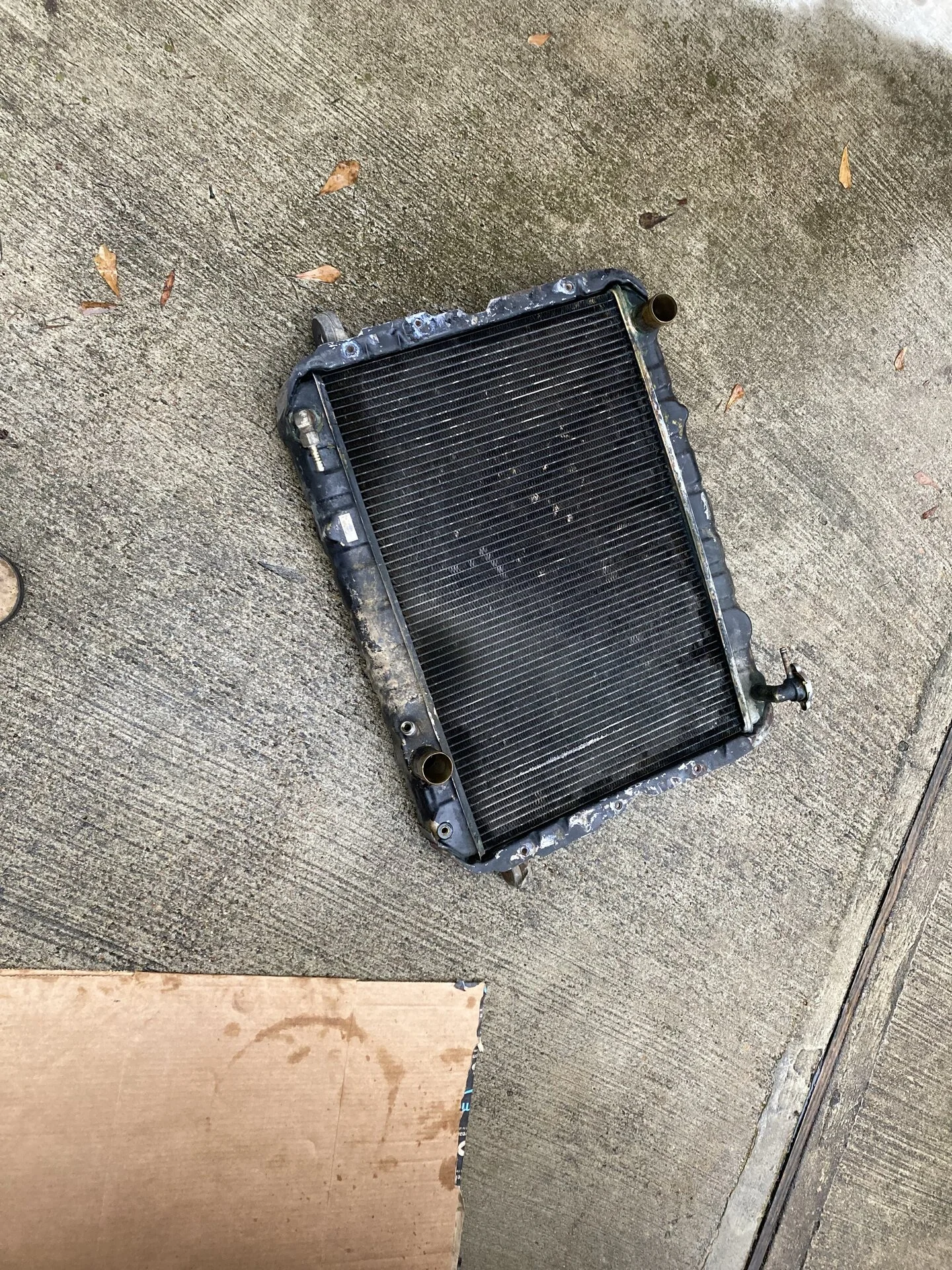

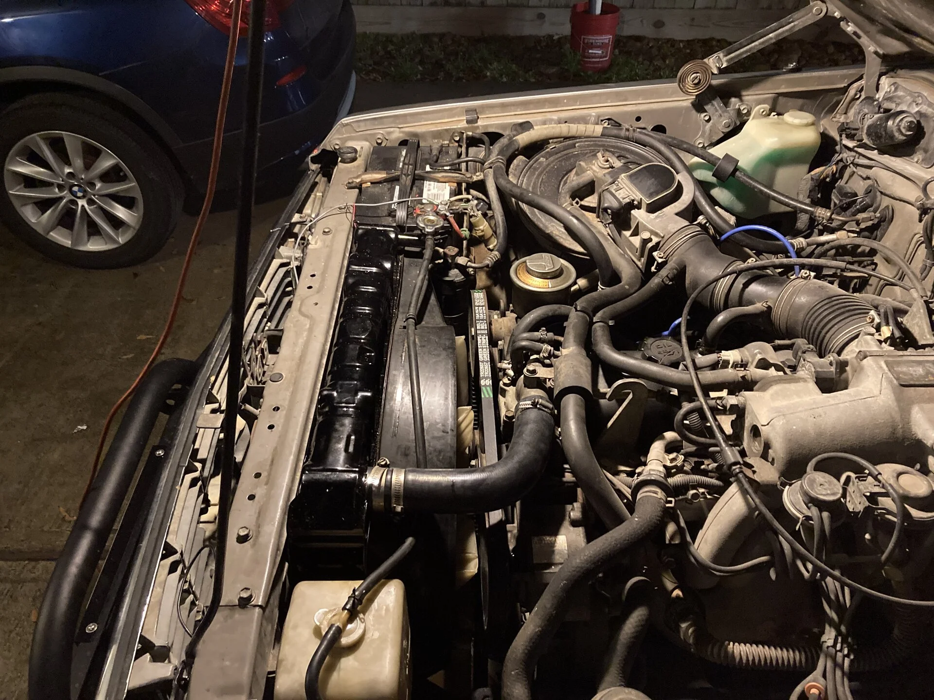

New radiator. The one installed by the PO was welded/soldered about three times a couple of years ago. Started leaking again so I figured i'd just replace. Ordered a CSF *before* reading all the mixed reviews on here. And then of course when I removed the existing one it was a CSF also 😖. Hoping it holds up better than the last one. 🤞
