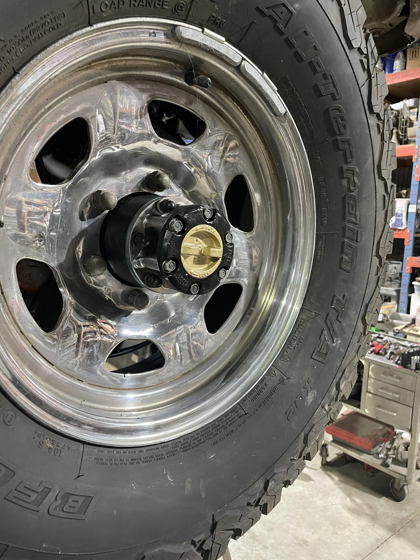

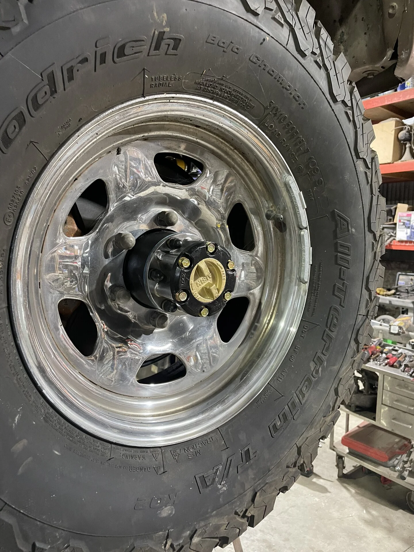

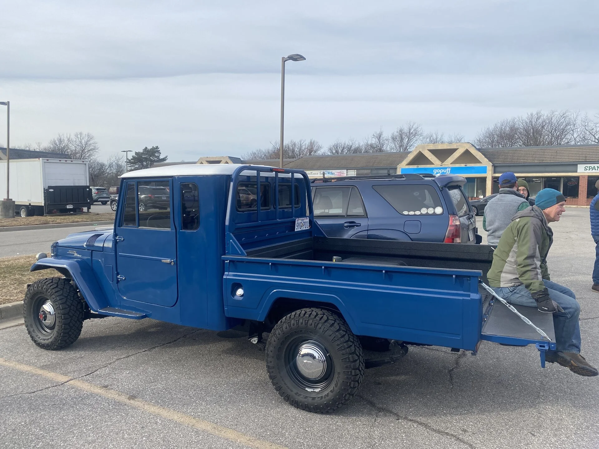

I thought I was looking at 70 series wheels and 33's until closer examination. Your hubs look brand new!
Thank you. A buddy of mine @BigHighBlue actually has a set of chrome 70 series rims on his 60. Have never seen them anywhere else and did not believe they were 16’s until I took a closer look. Ben, post a pic if you can.

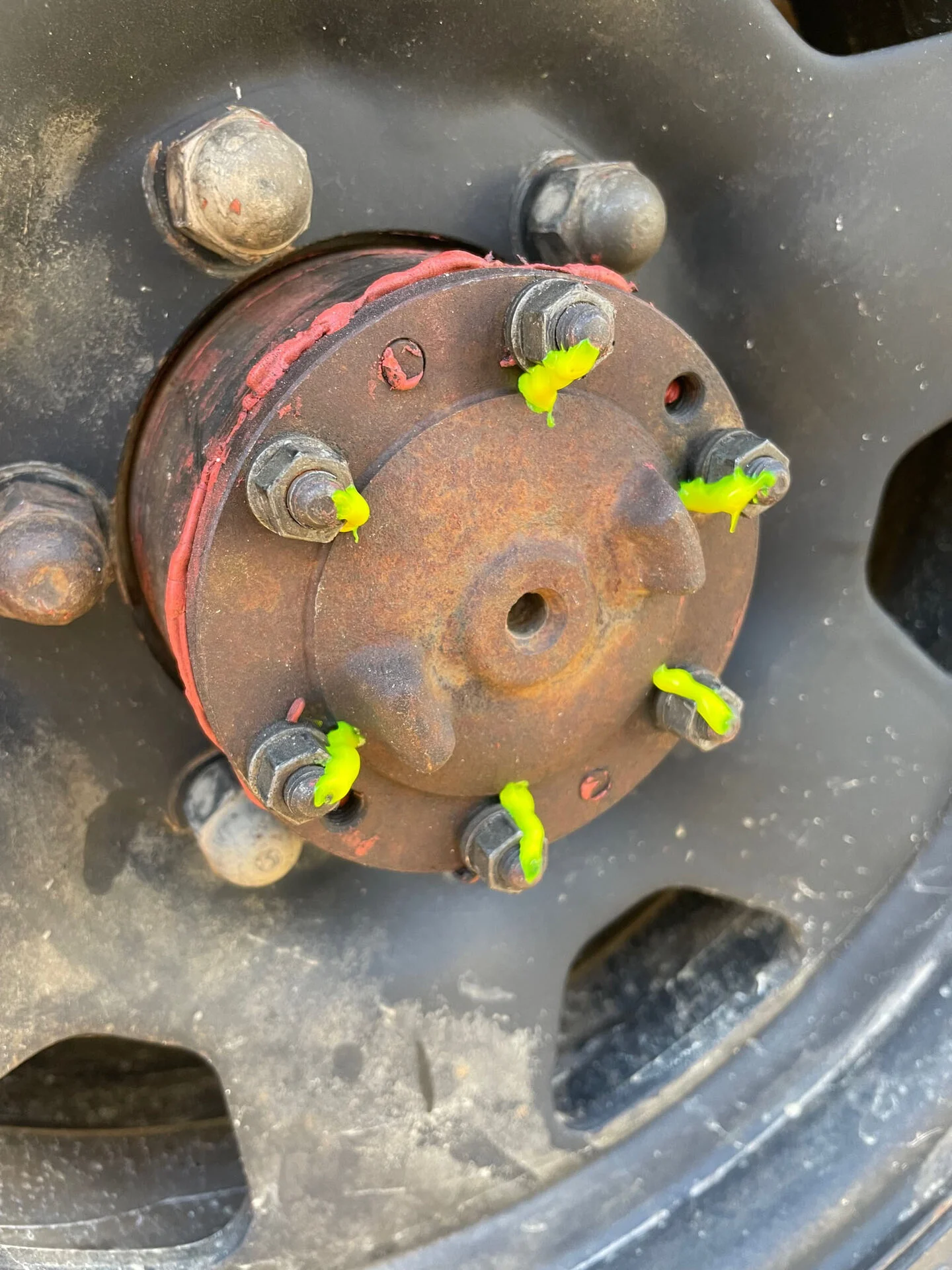

Added torque check paste to the flange nuts since I just rebuilt the rear FF hubs. If the nuts loosen I'll be able to tell before the gear oil begins leaking .

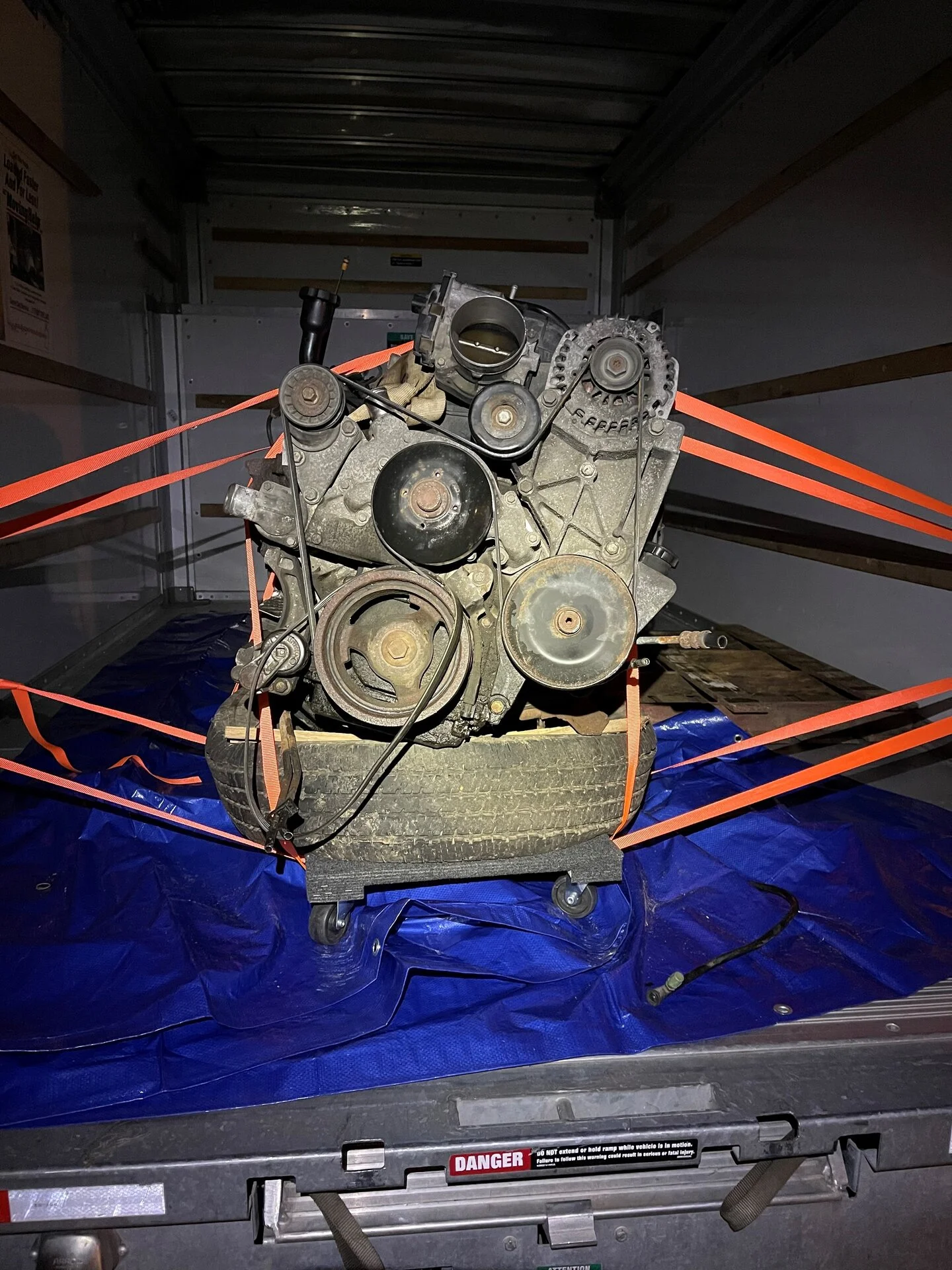

Picked up 6.2L of power in the sketchiest transport work I've ever done. Rolled it off the Uhaul and into my garage. Teardown starts soon to see the internal condition. Motor is an L92, aluminum block and heads. Truck accessories, non-hollow valves, intake manifold and camshaft are what differentiate this motor from an LS3. Once it's ready to go into my 60 it'll be putting out way more than a stock LS3.
Any hints on how to find a motor like this? It seems sketchy vendors are the normal here

That style never came in chrome for the 70 series, at least not in 16" flavor but I will say they are the first I have ever seen. 0 offset?
Howdy Neighbor. Yeah its hard to explain. "Nobody" has ever seen them in chrome including me yet here they are. Based on their condition I'd say they are OEM. We need some some of the TEQ guru's to weigh in on this.
It took a couple months to find a good deal browsing FB Marketplace. Choose the motor you want, and if you're handy and you have the time I'd check junkyards as my first stop. There are three large ones near me and they'll pull/sell the motor for you for extra if you can't. Still a shot in the dark if it runs/was maintained well. But as long as there's not a hole in the block and the cylinder walls aren't gouged to hell I'll be fine because I'm doing a full rebuild. You'll have to be pickier if you just want a drop in.
For this motor it came in a couple suvs/trucks, the most common of which are the '07/'08 Escalades. And since they're so popular where I live I can get the entire vehicle for ~$5k if I need to. I didn't want to have to strip it down to recoup costs and that's why it took so long to find motor only. Some people want $3,500 for just this motor, why wouldn't you buy the whole car and strip it for parts to sell?

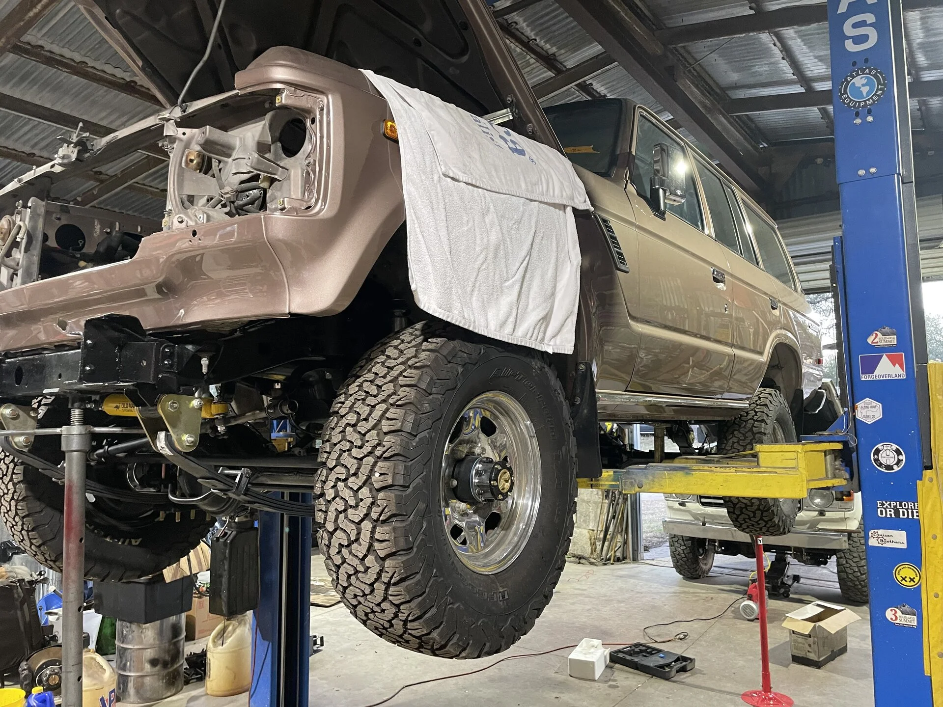

Not the weekend, but took her for a ride to see the vehicle engineer. Part of the registration process for a modified vehicle in Oz.

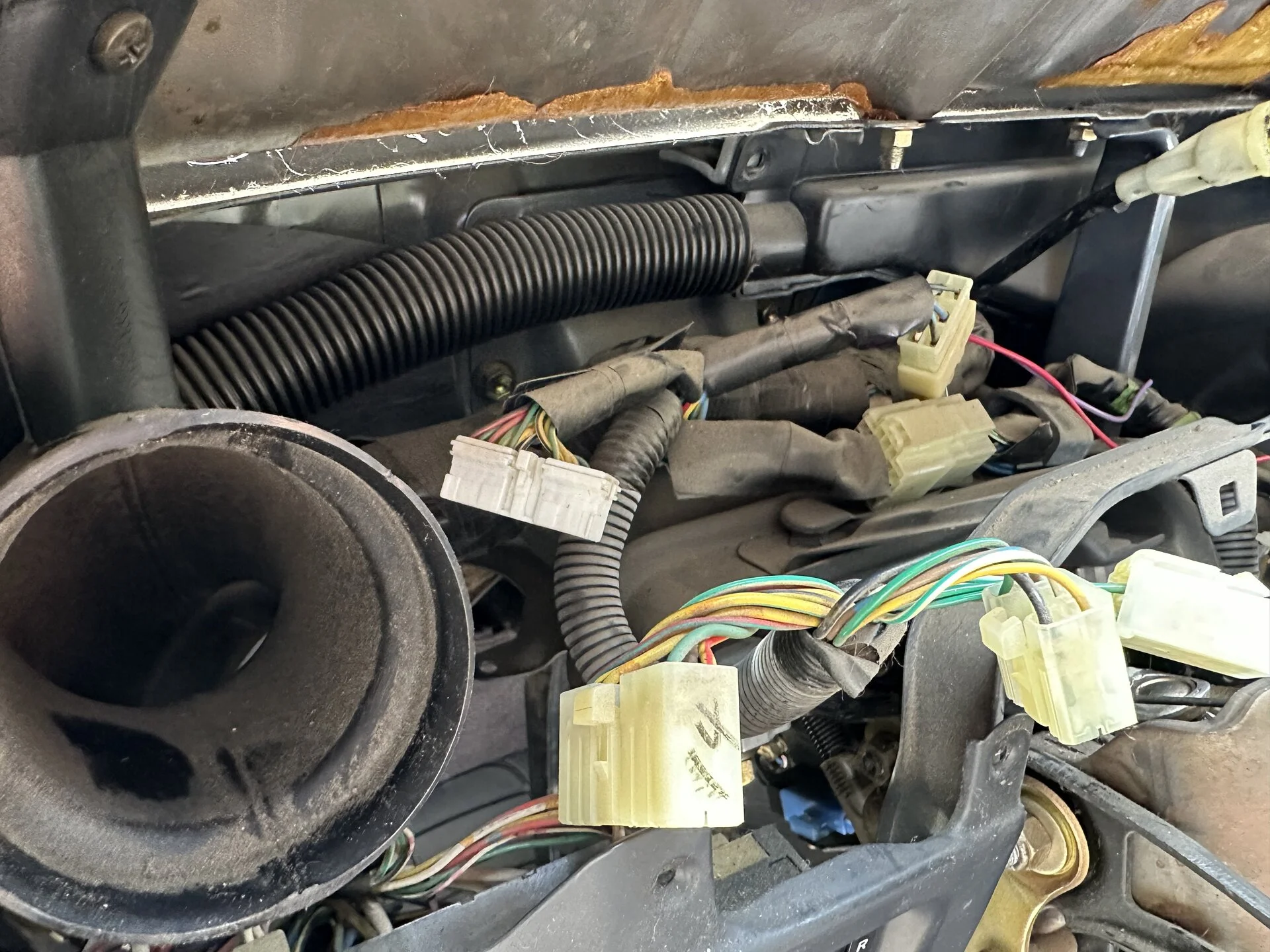

2 weekends ago was a big one for me.
1. Swapped stock wheels for new ones and replaced the dry rotted 31” Toyo AT’s for 33” KO2s. I’m really digging this look.
2. Finally made use of the new dash that’s been sitting in my garage for a year. The one that came with the truck had a dash cap that looked worse than the original dash underneath. I had a moment of panic when I had to cut holes in the sides for the side defrost vents, but thankfully that went smoothly. If it’s in your budget to order one of these from Toyota, I recommend it. We all know they won’t be available forever.

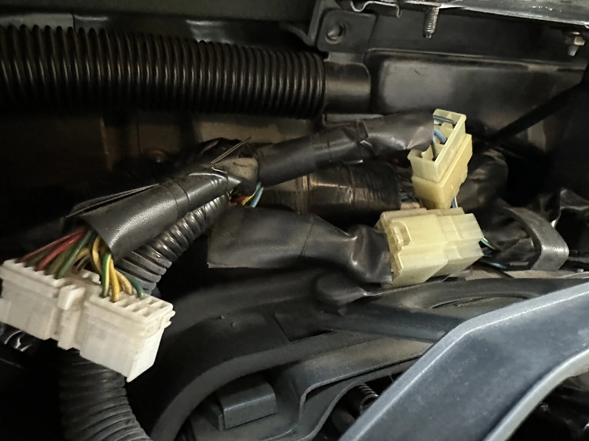

3. LED light swap in the instruments. Everything except the high beam indicator. I was worried it would be too bright but the dimmer still works enough to get them to a great level of brightness. Very happy with the results.

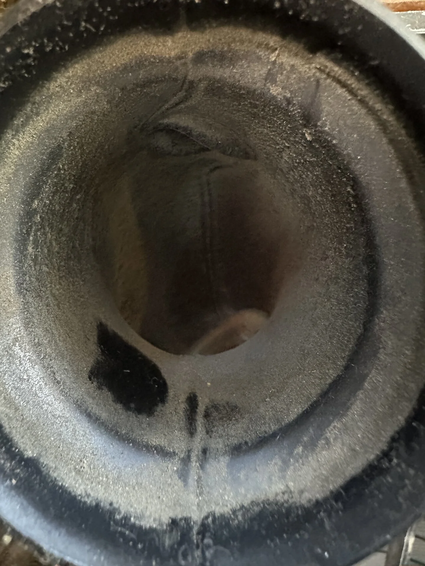

4. Cleaned a lot of old dust. Really got inside all the vents.
