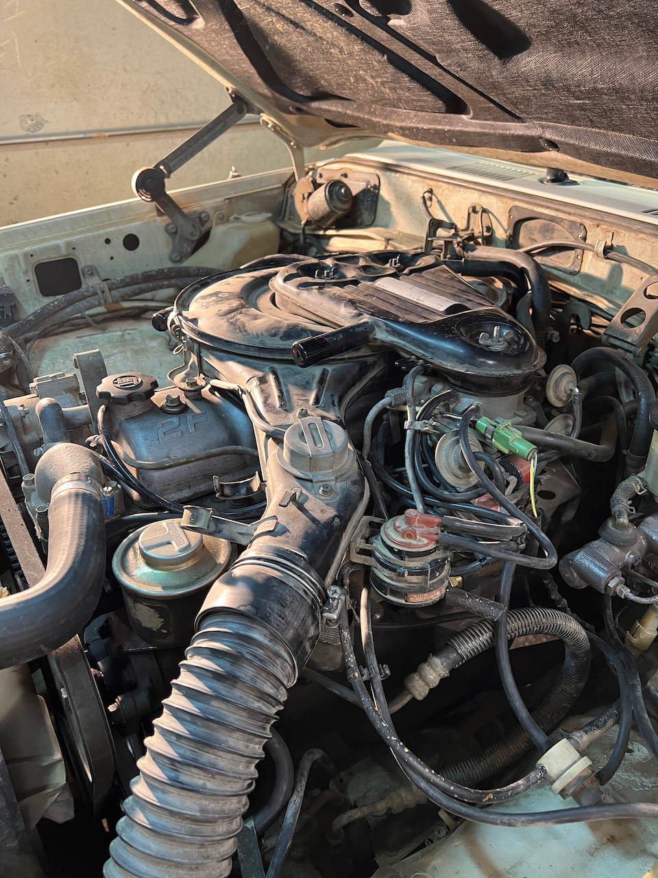

Successfully (fingers crossed) completed a desmog of my 1982 FJ60 (aka Lefty...read more here if you're interested). After reading 42 of 59 (so far) pages here, I finally dug in. Used the Jim C kit and a TON of great advice in that desmog thread from @FJ40Jim \which made the process go as smoothly as can be expected. I'm now EGR, EGR cooler, air rail, air pump, spaghetti lines, and a ton of random air and vacuum lines-free. And, the engine feels smoother than ever with maybe even a bit of a power gain. With time, I'll see if it can get into double digit MPG numbers which would be amazing.
Box of stuff removed
Finished (but somehow still dirty) product
How long/difficult was this? I've thought about doing this myself. Looks way cleaner now.
