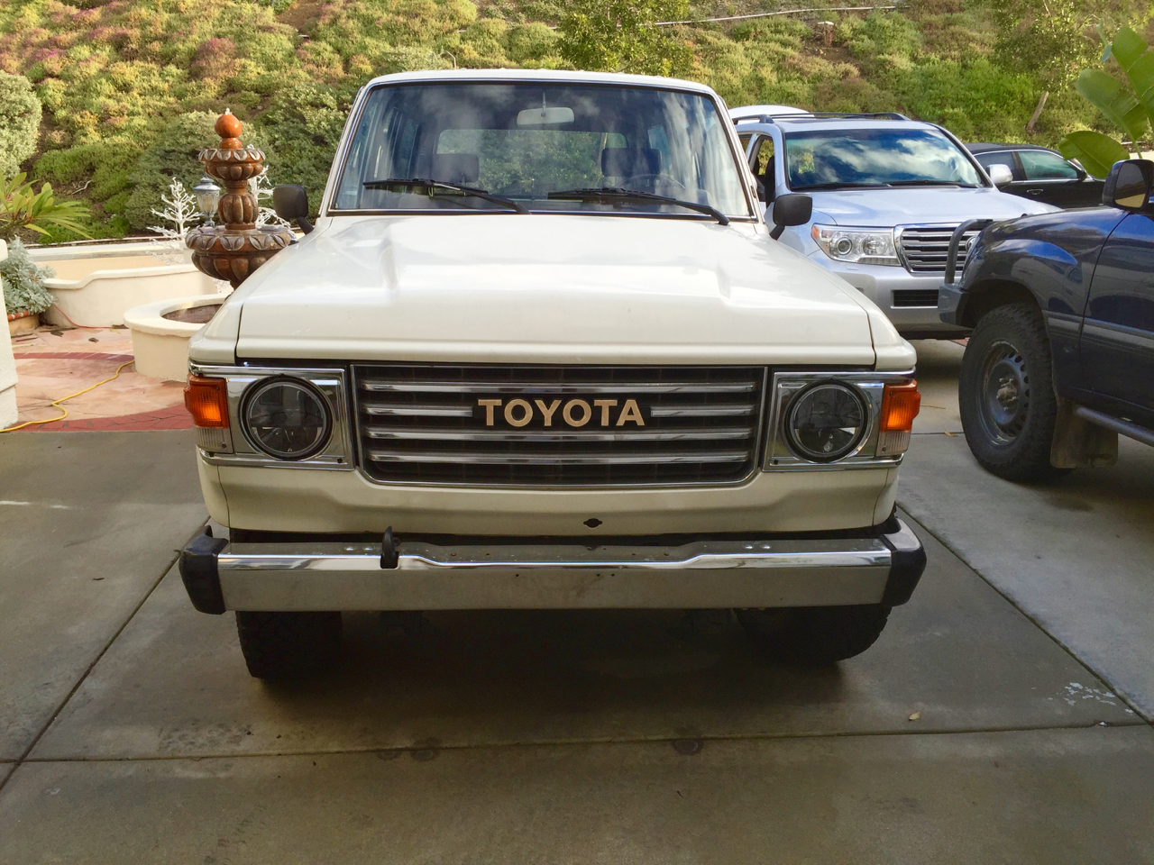

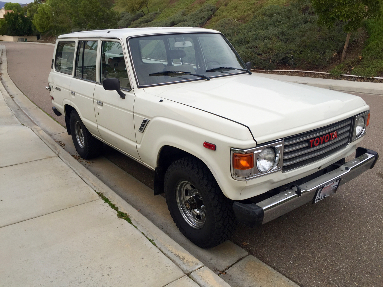

Been perusing the 60 forums for a while and finally pulled out my wallet and bought one, a 1982 FJ60 in pretty much original condition. Bought the truck from a Land Cruiser addict/collector a couple hours north, stuck the key in, and drove home to San Diego with a smile on my face.

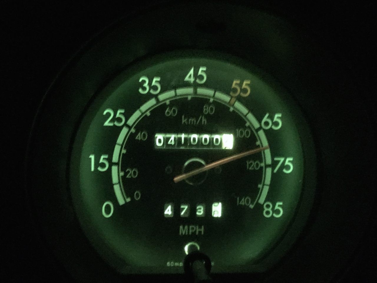

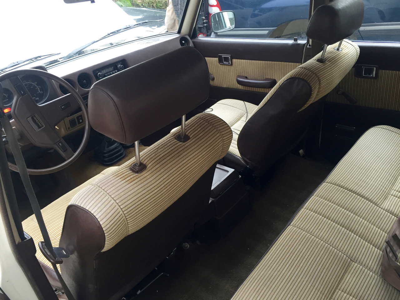

The truck has an interesting history. It belonged to the Los Angeles County Parks department and was recently sold to the guy I bought it from. So I'm officially the 2nd registered owner. The truck has only 41,000 miles, but is definitely showing signs of age and government use. The interior is as close to perfect as I'd imagine an unrestored 30+ year old truck could be. The exterior is a bit rough...some surface rust along the roof rails, small dents and dings here and there, even holes drilled for antennas and light wiring. The suspension seems to be shot, hoses and soft lines need to be replaced, the battery looks more well-suited for a Yugo, and a surely there are a hundred other things I haven't discovered. Lots of work to be done!
Day 1
Low miles as observed on my way home

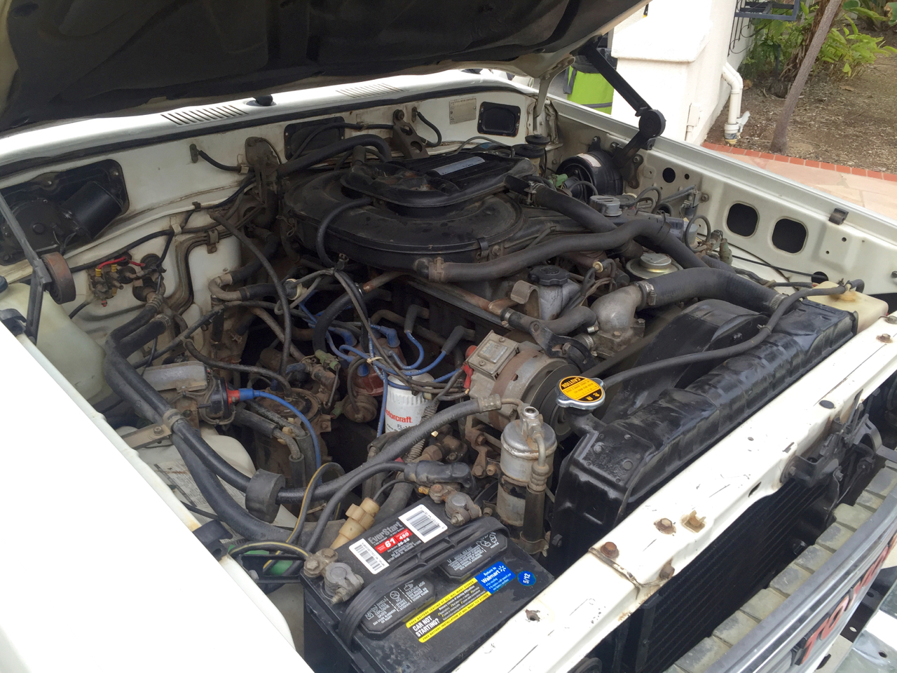

2F, crying for some TLC and a few OEM parts

Likely first steps:
1. Appropriate battery tray and battery
2. Baseline fluids, filters, etc.
3. Removing the strange red "accents" which will drive me crazy
4. Suspension (likely a mild lift...don't want to venture too far afield of stock)
5. Figure out what to do with the body work

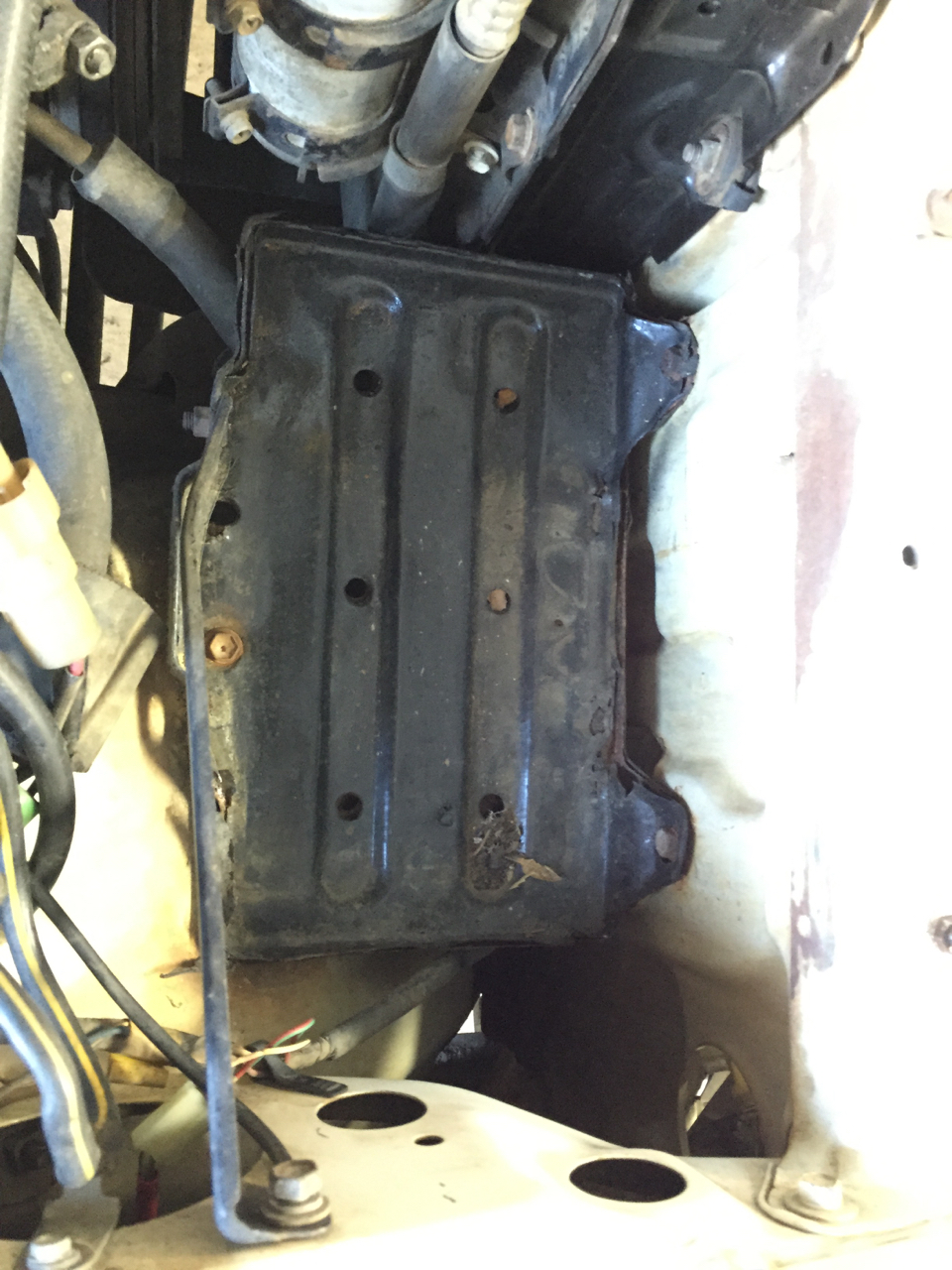

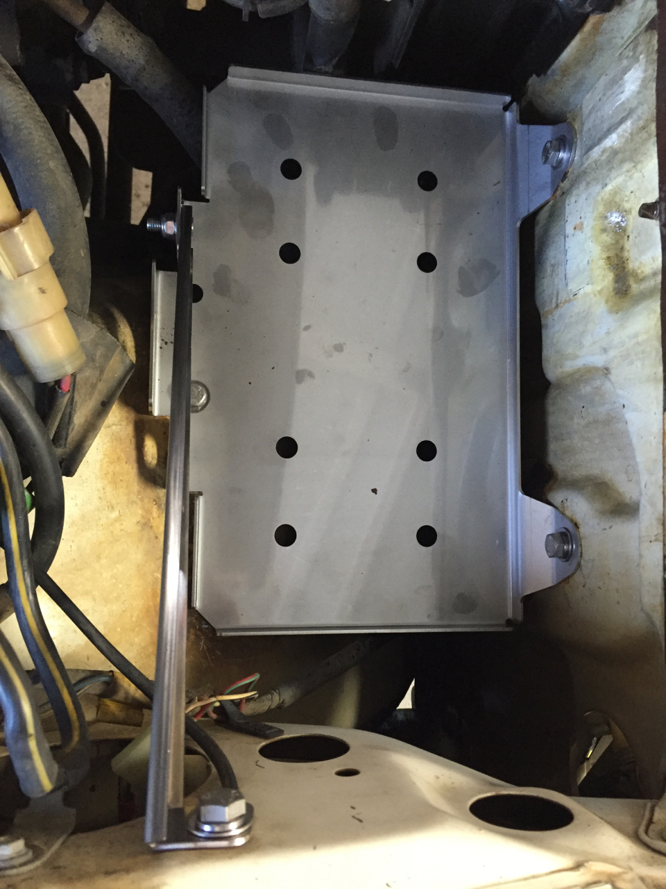

Not only was the battery that came in the truck tiny, but it wasn't strapped down at all. A few minutes on Stainless Steel Battery Trays for TOYOTA LANDCRUISER and within a couple days, their complete tray assembly arrived. Very nice kit!
The OEM tray was rusted away, nearly non-existent. At least the black plastic coating was still there!
Shiny and new
Group 27 all strapped in and ready for action!
If anyone needs a used OEM battery tray support, that was the only piece of the original tray assembly that was worth saving. PM me and it is all yours!

The red trim is silly. But nice find!
I couldn't agree more @tgadd . An hour with a razor blade and some plastidip and we're one step closer to how Mr. T intended the truck to look.

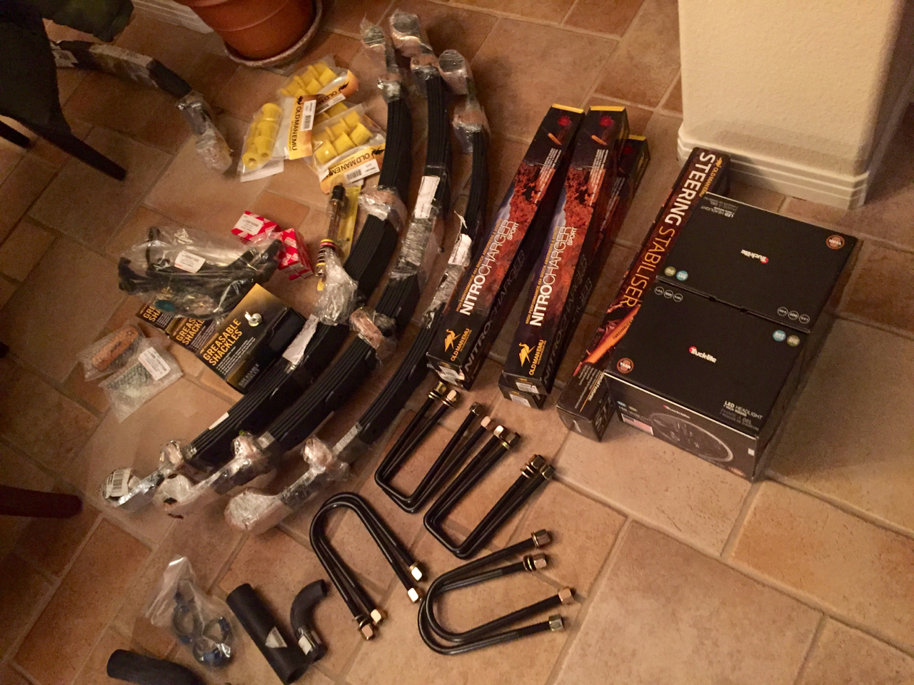

Suspension and a few other bits installed!
Started with this pile of goodies, the bulk of which came from @cruiseroutfit . Thanks, Kurt!

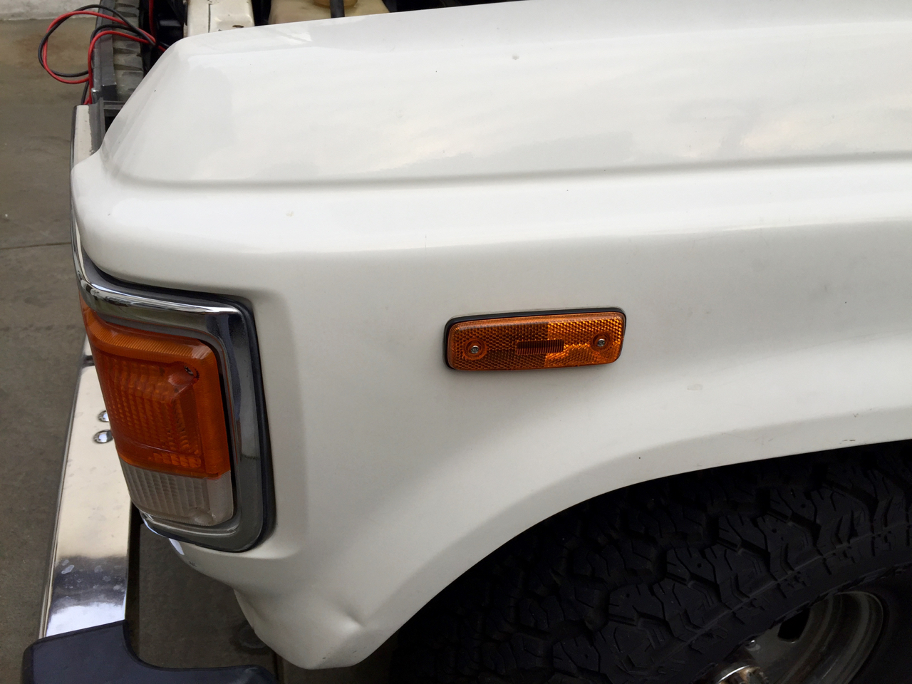

Mounted the correct front side marker lights which some previous owner oddly changed to rear, red lights. Had to fix the wiring in the process. All good now.
Truck-Lite lights installed.

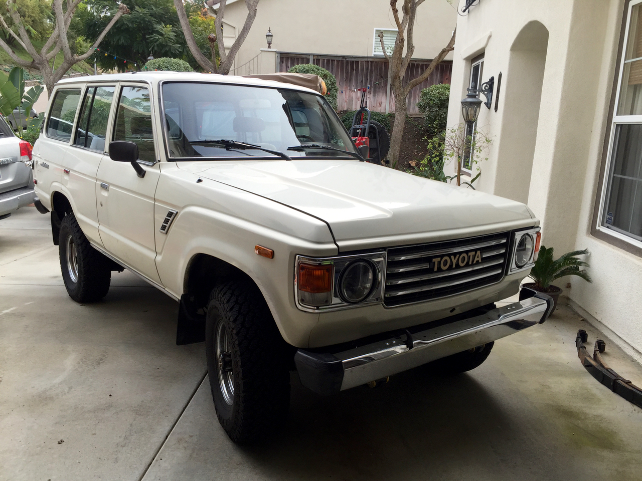

OME light/medium lift installed after a marathon solo effort yesterday. Man, am I sore!
The truck rides SOOOOO much better and gained a bit of height.

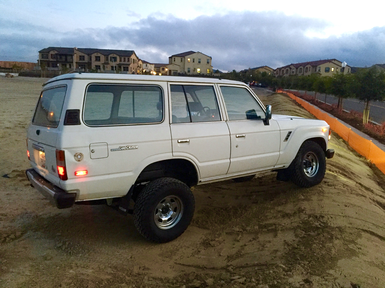

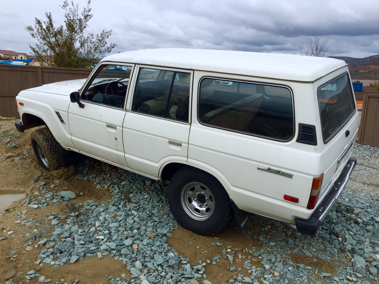

As part of a rigorous suspension testing process, I headed to a local suburban construction site and drove to the top of a pile of dirt. Springs flexed as expected!

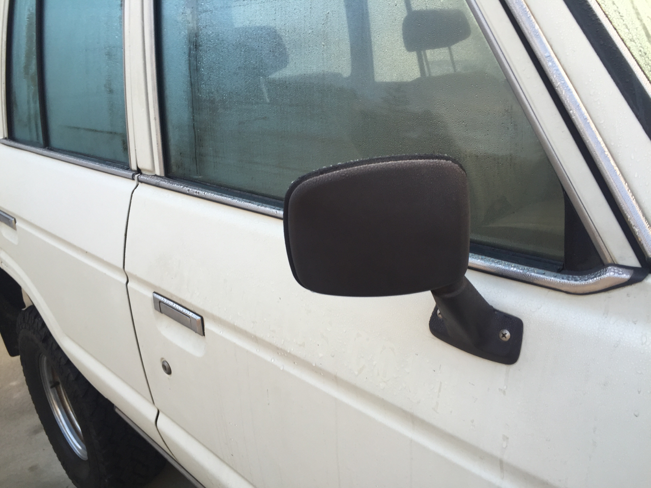

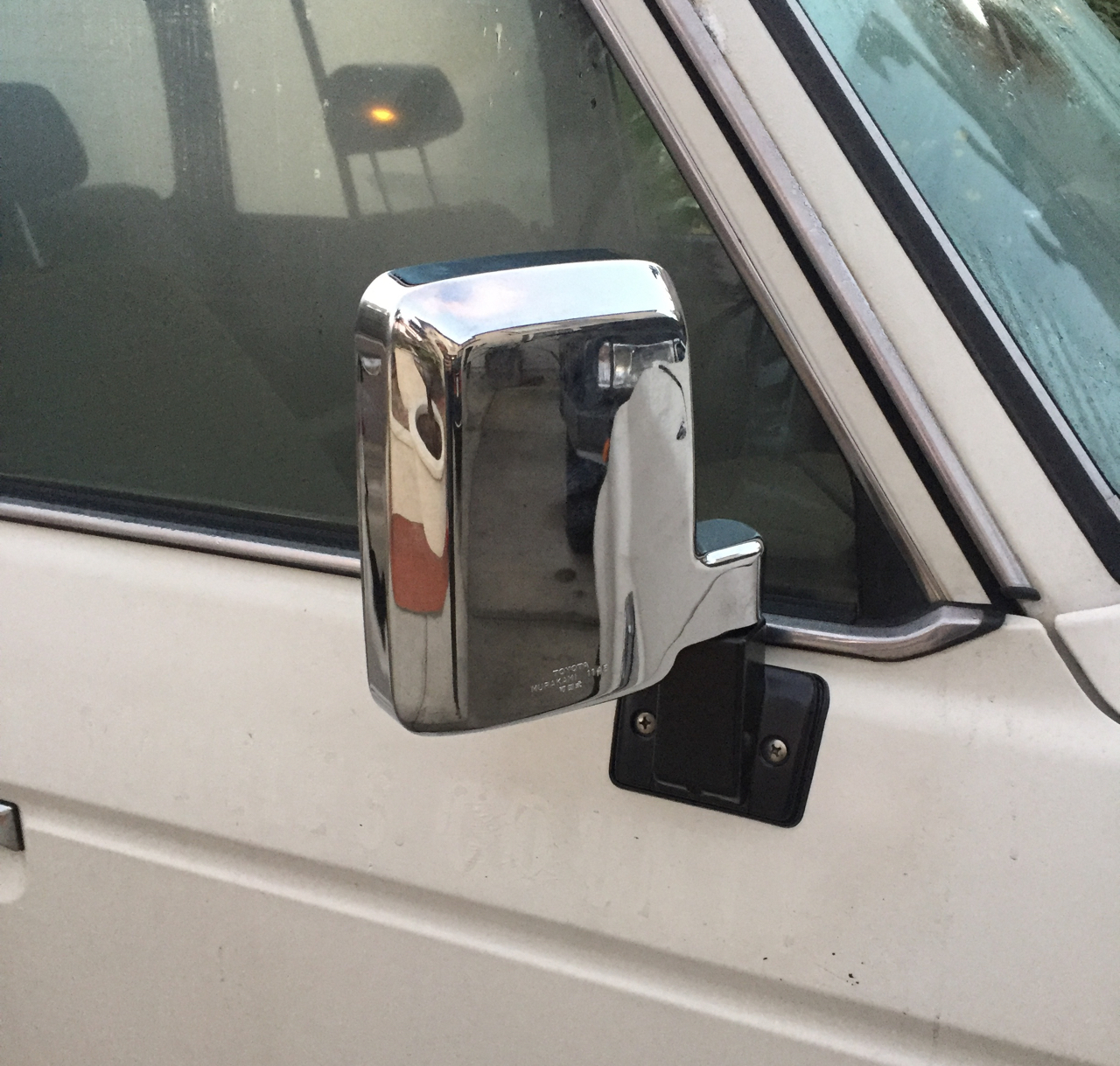

Also, @beno hooked me up with new FJ62 mirrors so that I can actually see things behind me. Decided to stick with the chrome for now since there's a ton of it on the truck anyway...and I'm too lazy to paint.
Before (low visibility)
After (improved visibility)

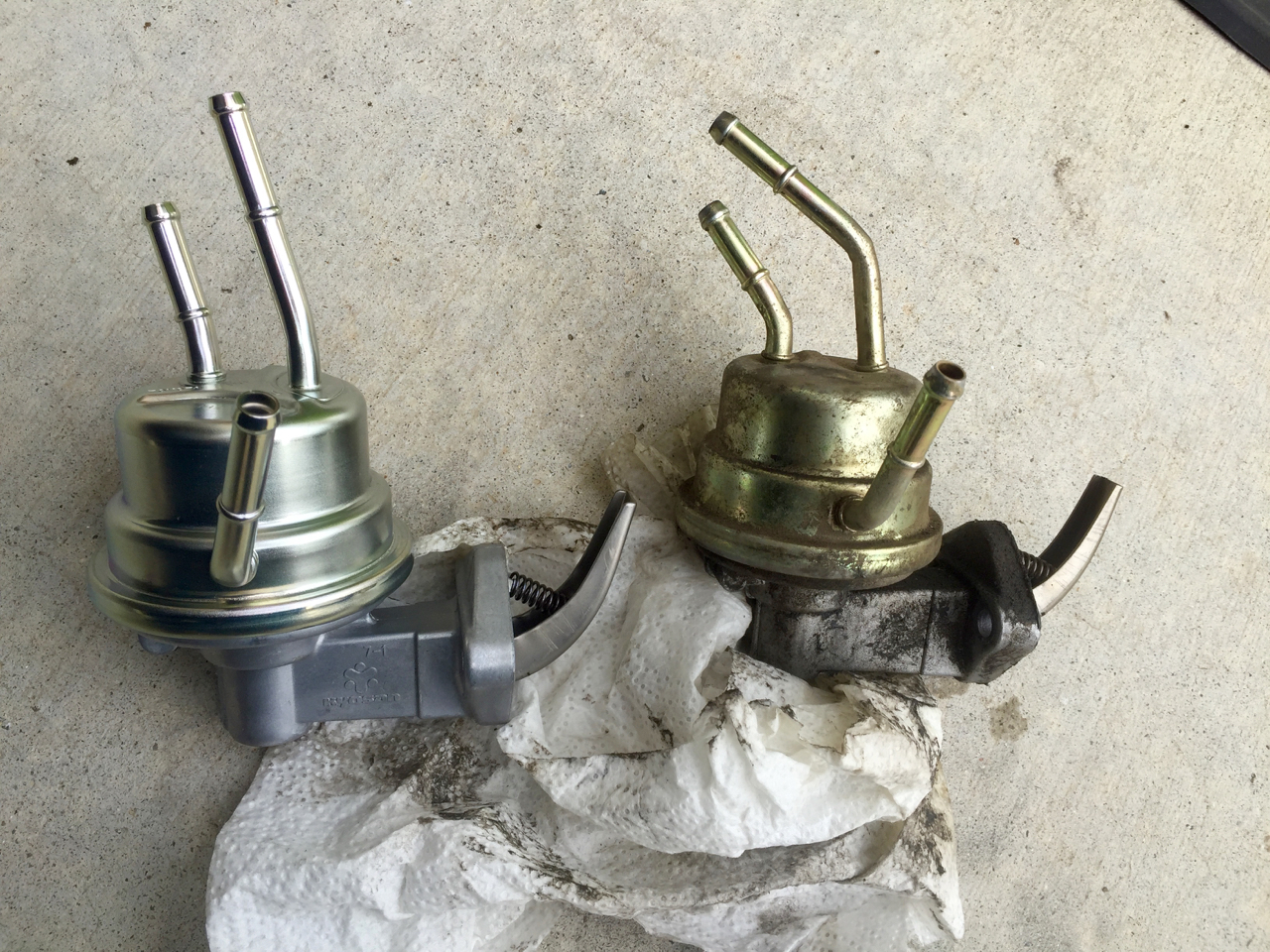

Discovered the fuel pump was leaking gas so replaced it. Solved the leak (and the stink) and it seems to run a bit smoother, especially at higher engine speeds...but that could be wishful thinking!

To celebrate/test drive, I drove around a dirt lot until a security guard gave me a dirty look

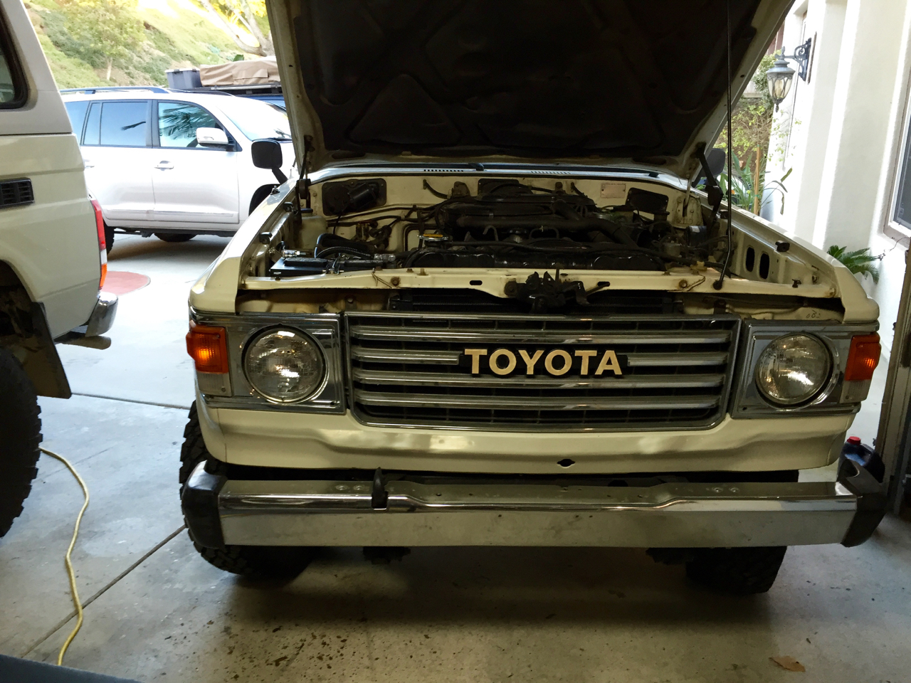

Sure. Lights are in and done...took all of 15 minutes. I'll take some pics of the light output from the FJ60 when I get back in town. In the mean time, here's a thread where I posted a few shots and video of the same lights in my BJ74.
Overall, I like the Truck-Lites. Visibility is significantly better than stock. Installation is truly plug and play. No ballasts or wiring harness to deal with. There is a weird XX pattern to the low beams that you have to get used to. If you can live with that drawback/feature of the light pattern, you're good.

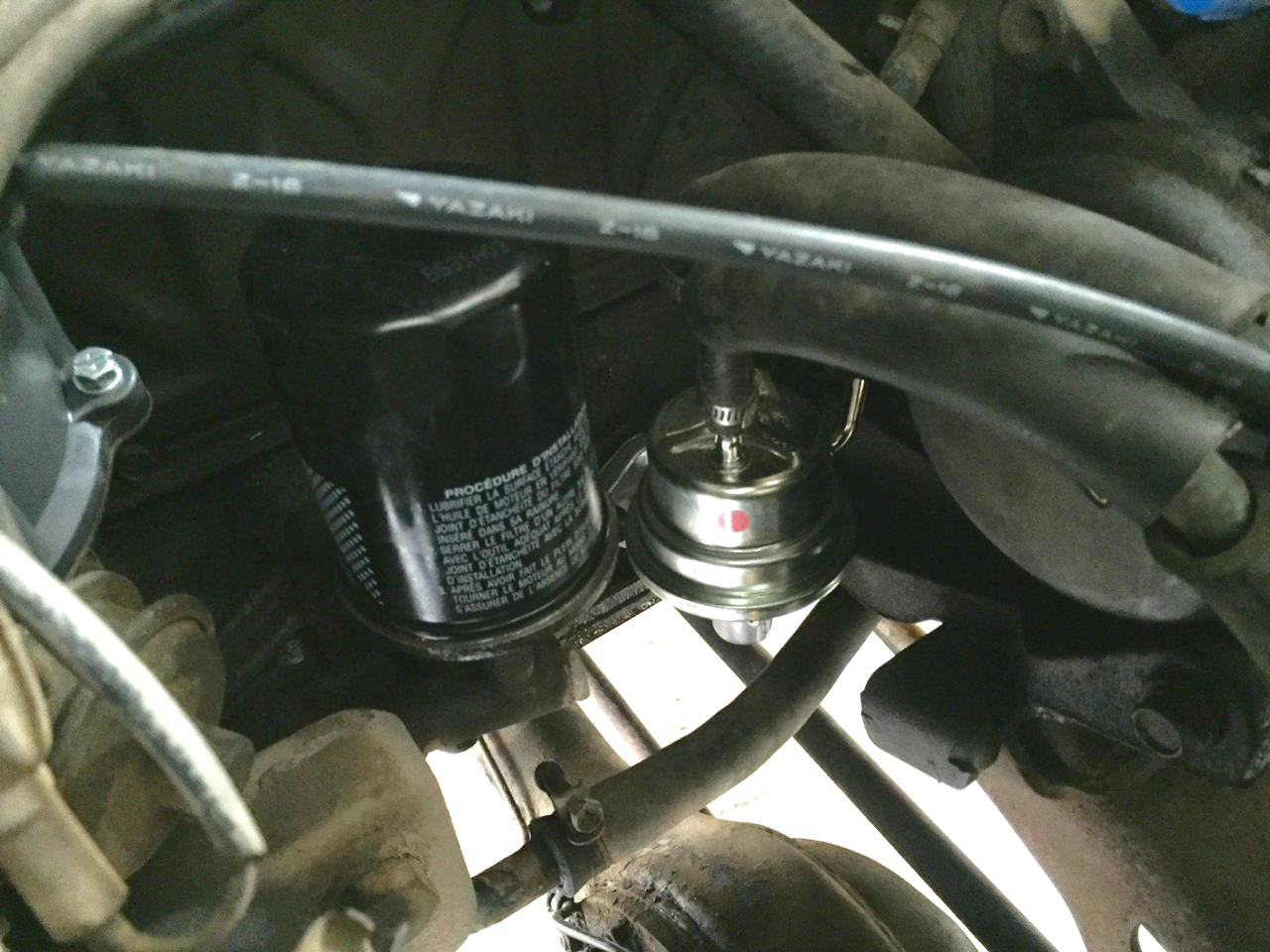

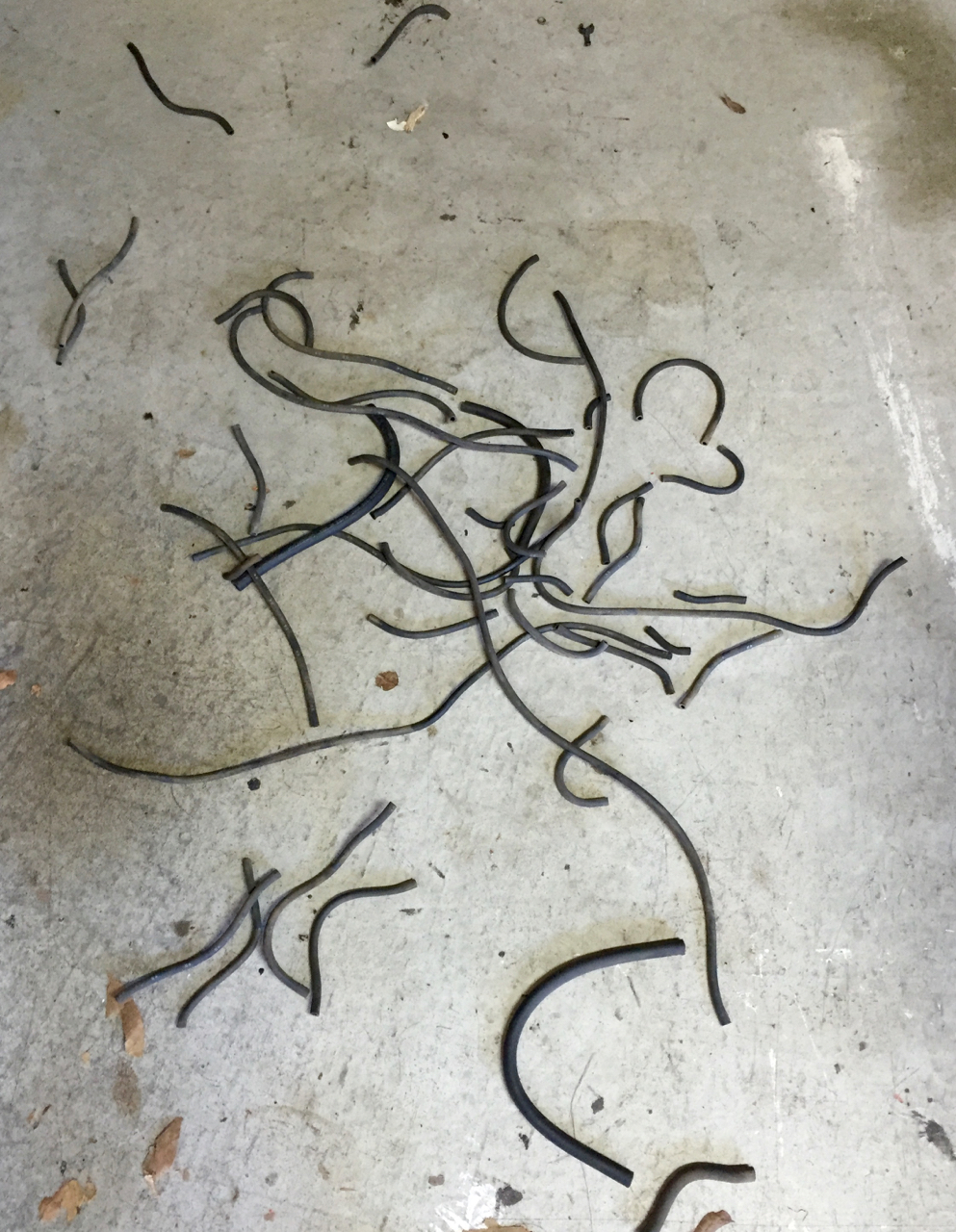

Replaced most of the of 30 year old vacuum hoses (realized I missed a few as I was closing the hood) with new from boostcontroller.com.
Assuming I'm missing a hose (down low in the highlighted/boxed area pictured), but for the life of me, I can't figure it out, even after reading the manual until I couldn't see straight. Anyone know where the hose here should be attached? Truck runs fine...or at least I think it does since there wasn't a hose here when I bought the truck.
