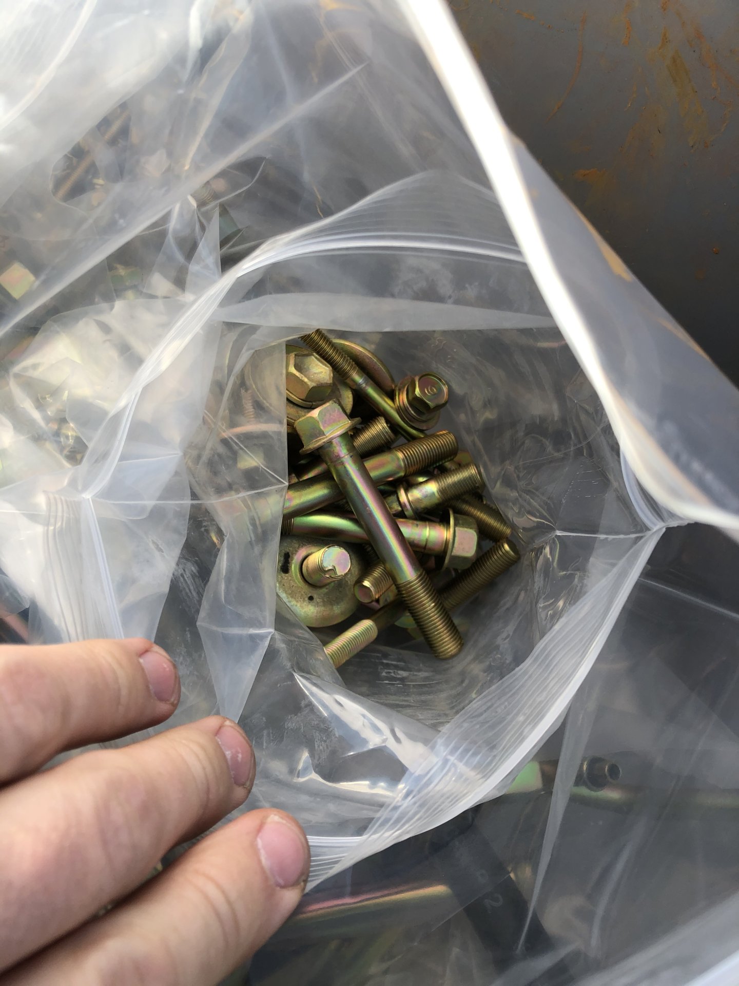

@timexlost "I got a bunch of hardlines and hardware back from being zinc plated. It all came out beautiful"
That does look nice...do you simply provide a plating shop with a bunch of rusty, grimy old bolts and bits and it comes back like that?
Yes...that pretty much exactly what happened. I'm currently in the process of restoring my entire engine bay, and some of the hard lines I wanted to replace were discontinued. I opted to instead have the original ones restored. I soaked all the hardware, lines, brackets, hinges ect ect in Evapo-rust overnight to be sure they were worth restoring, then went ahead and dropped them off. The shop cleans everything in acid then dips it in zinc. The process doesn't hurt the rubber either so I was able to do my A/C lines as well.
I also found bags of 60 series hardware from Japanese junkyards on Yahoo auctions. Essentially these junkyards disassemble 60's and toss all the hardware into a bucket, then sell the hardware. So not only did I do all the hardware from my truck, I also now have about 50lbs of extra hardware freshly restored and ready to use when I need it.
not a bad way to spend $280
