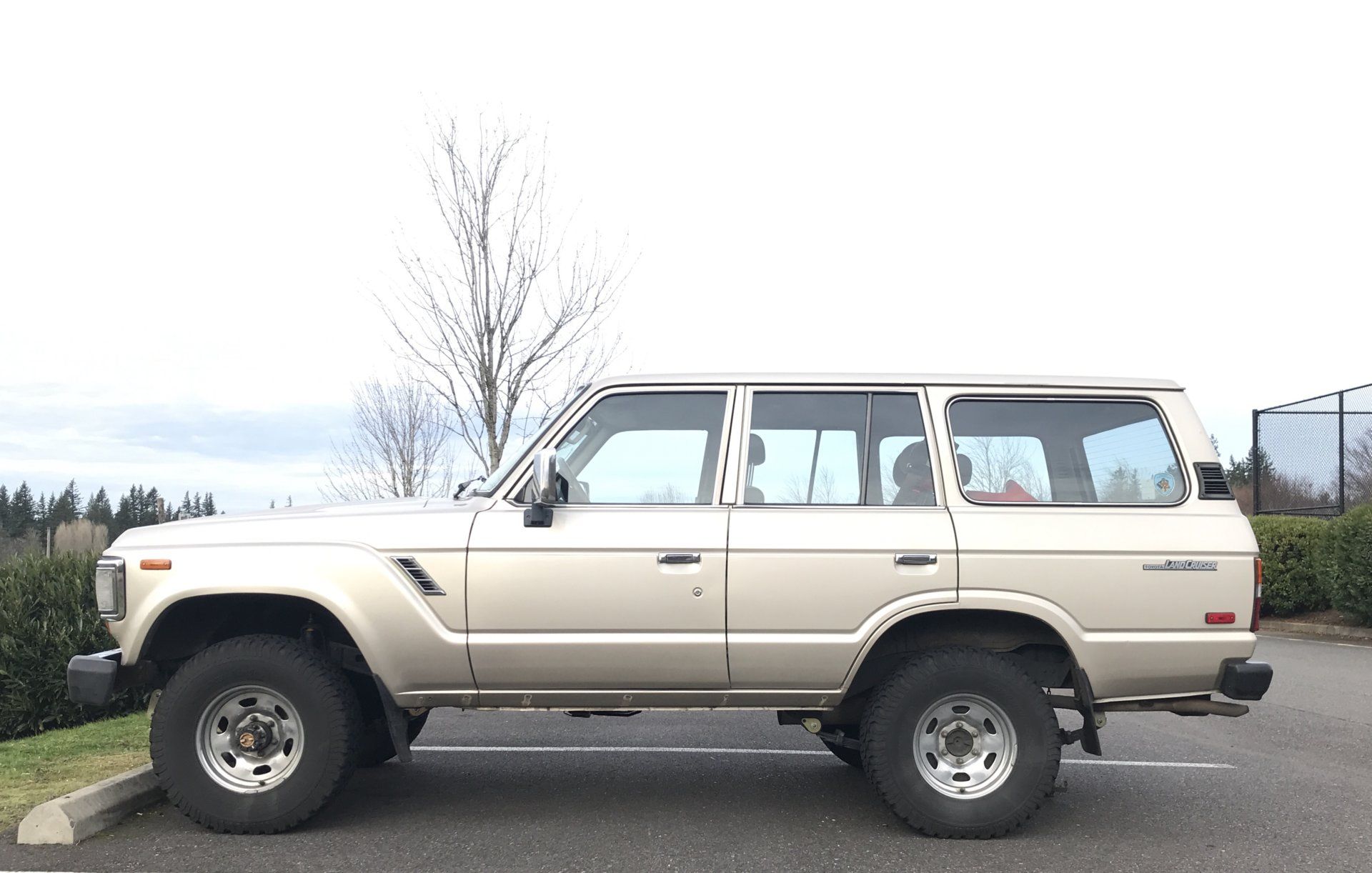

Yes, they are the 426016026203 70 series wheels in 16x6 with 255/85-16.
They drive great and I’m experimenting with tire pressures now.
