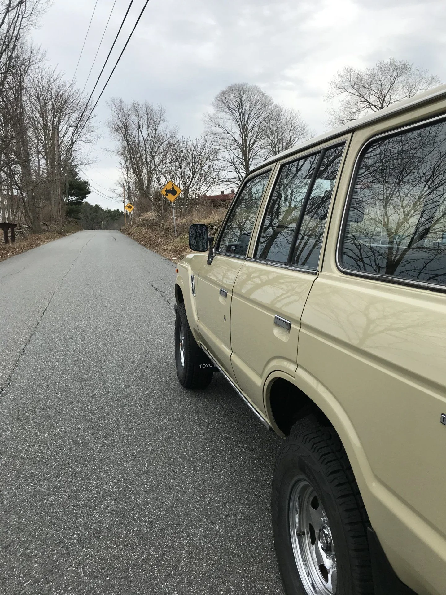

Picked it up! Flew up to Seattle, then began the 1500 mile drive back. This is my first Cruiser so I'll be leaning on this forum a lot (thanks to those who have already helped) to guide me through the many things I wanna do to it. Snapped a couple pictures on the way down, please excuse my brooding photographer act. Can't wait to meet as many of you as possible, looking forward to harassing you with questions.

Gorgeous backdrops. Congrats on your first 60. It’s a good one to start with. :)
Welcome.
Ask away, there are a lot of knowledgeable folks on here. It is always a good idea to to search first before you ask. Most stuff has been answered before.
The pictures are great, the forum loves pictures!
Nice looking 60, re-painted blue with the brown interior is different.

Definitely need to see more pics of your 60, my first 60 was blue and I find myself drawn to them!
Now one forum etiquette pointer if I may. Your second pic posted appears to be of a bridge but there is no 60 in sight.
If your going to pull off some excellence with a

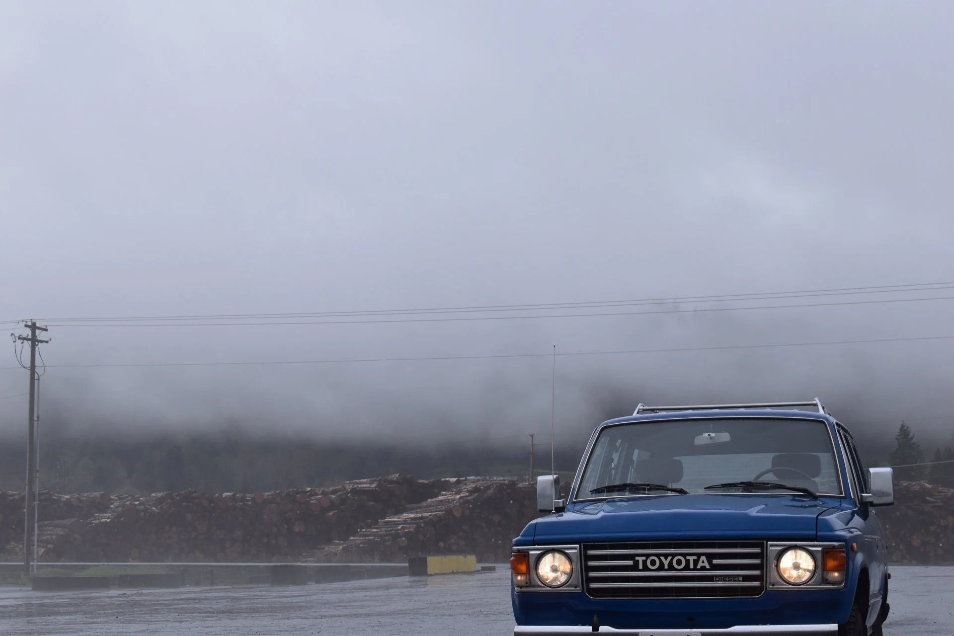

in the 60 section you have to try to get at least a sliver of your 60 in the pic. You know a taillight or bumper corner or such. Your 4th pic posted with the coastal scene reflected in the passenger side mirror..Now thats some brooding instagram pic excellence...;)

I wasn't sure about the interior before I bought it but it's really growing on me! And don't worry, I've become well acquainted with the search function...

Nice-A** 60 bud congrats! I love the OEM / dealer roof rack.
