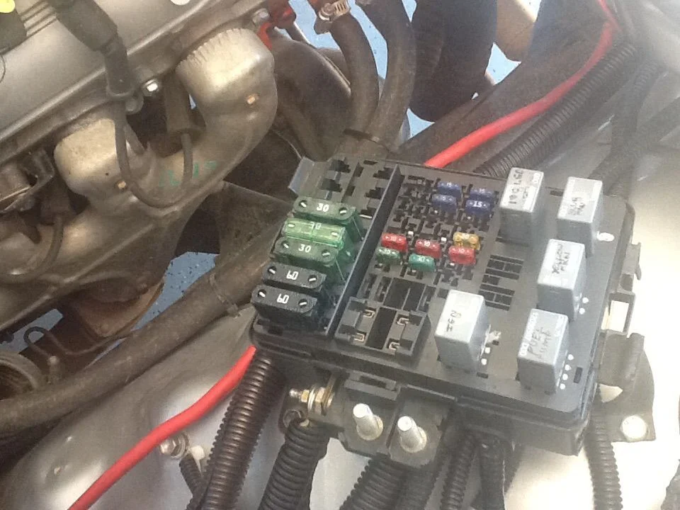

Got a lot done on the re-wire and up grade of the GM fuse box from the 5.3 Vortec conversion. Up grade the main power to the fuse box from 10 guage wire to a 3 guage wire. This will allow me to handle 94 amps very comfortably. Also added 6 more circiuts for the 4 54watts LED light bar that will be added soon.
Cleaned up the Toyota and Vortec wiring.
View attachment 1088998 View attachment 1088997 Got a lot done on the re-wire and up grade of the GM fuse box from the 5.3 Vortec conversion. Up grade the main power to the fuse box from 10 guage wire to a 3 guage wire. This will allow me to handle 94 amps very comfortably. Also added 6 more circiuts for the 4 54watts LED light bar that will be added soon.
Nicely Done!
Do you have any details on the fuse box?

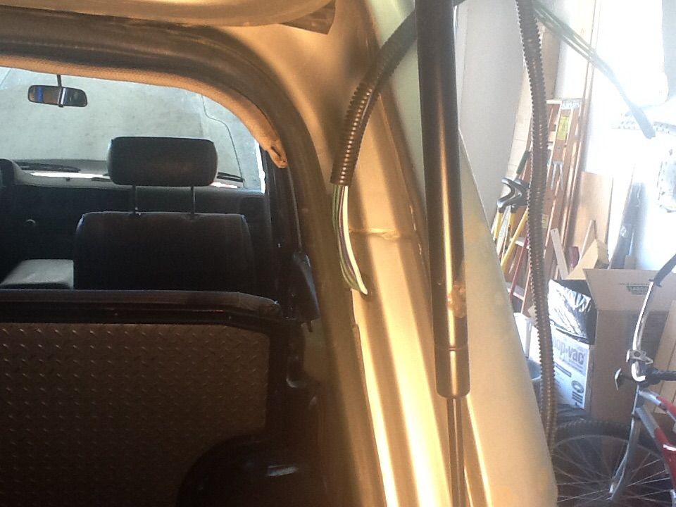

Finshed laying the last of the interior wiring for the 6 new LED light bars. The last couple weekends I started with a clean up of the wiring into and out of the new GM fuse box. See previous post. (Soon to be a separate thread on how I did it so others can follow or get ideas.) I laid 6 new circiuts in the fuse box (previous weekend) this weekend laid one 14 guage wire from the GM fuse box thru the fire wall down the inside of passenager floor all the way up the "D" pillar. Then for my other 5 LEDS lights laid 16 guage wire via the same route.
Picture of the 1/2 inch hole with gorment.
All 6 wires bearly squeeze thru the gorment. Hopefully will be water tight.
