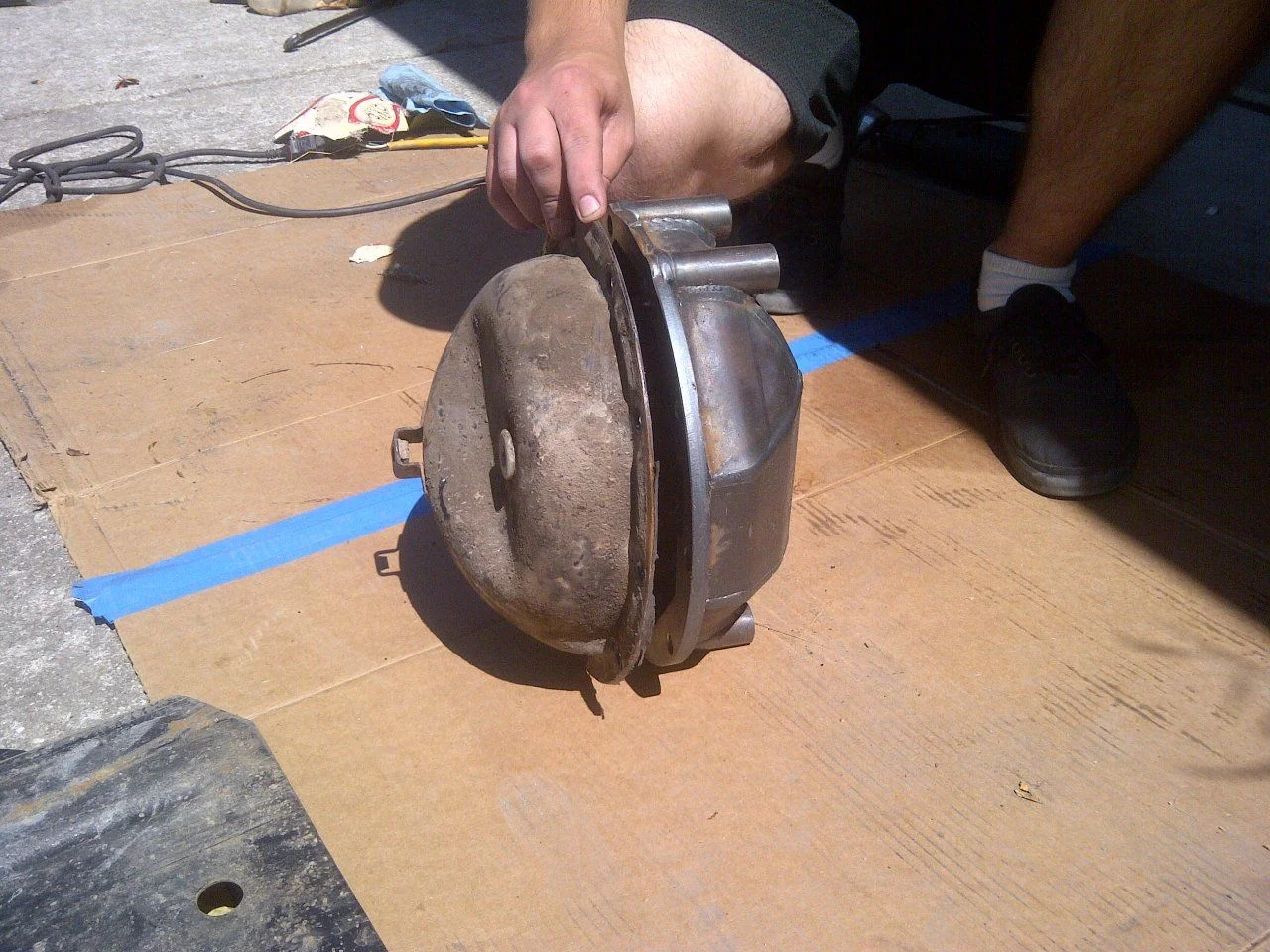

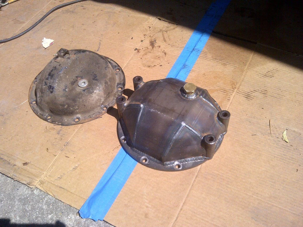

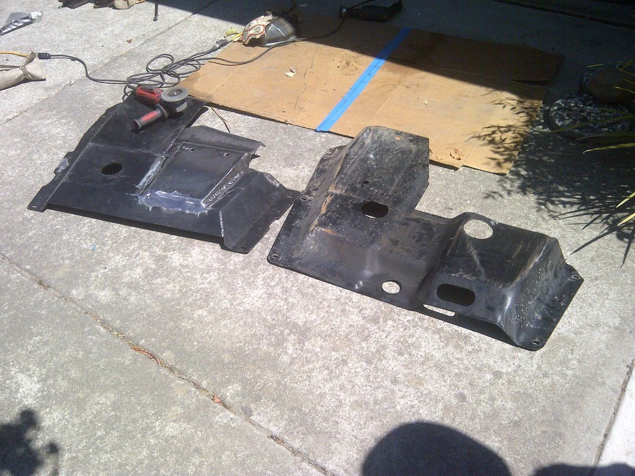

Finished the fab and installed a 1/4" thick skid plate to to replace the original, and installed a Ruff Stuff rear diff cover. I picked up the diff cover from Georg and was informed that he always has to deepen the ring gear inner relief cuts to make them fit and to be sure to dry fit it and check before assembling. He was right, of course. Note that I had fitted a 62's rear sway bar on my '87 60. It won't work with this diff cover. It needs to set farther from the axle to clear this cover. I plan to remedy this after Rubithon (first timer...) given that my fairly novice off road skills can benefit more from the diff cover than having the sway bars!

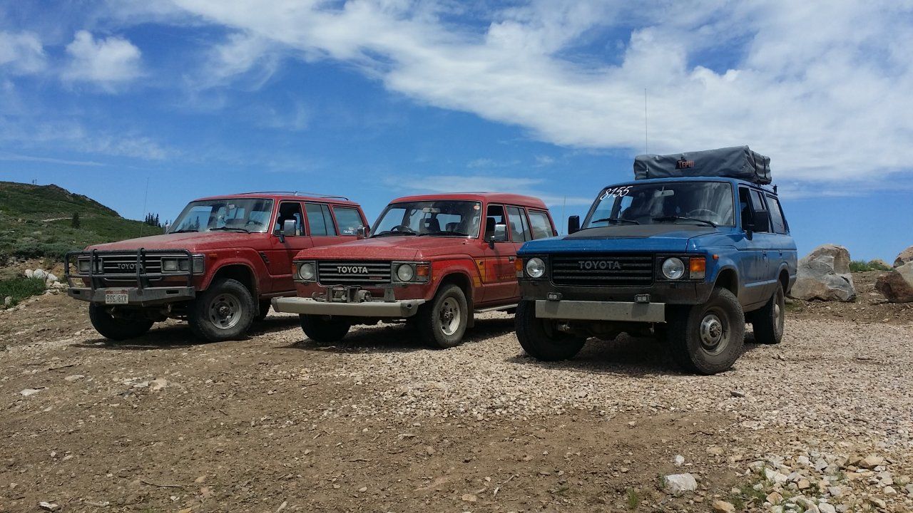

This weekend the we took Stoffel out on an overnighter in northern Utah. We met up with some of the old FJ Cruiser club members that we used to trail run with and some new folks. The wife, myself, and our friend had a blast with the rest of the group! We took the old transcontinental rail road bed from Wendover, NV all the way to Golden Spike National Monument; about 180 miles of dirt off road. I ended up getting two flat tires, but that is about par for this trail (damn rail road spikes)! The first was swapped out for the spare and the second was able to be patched in the field. It was a great time!! All pics can be found here:
