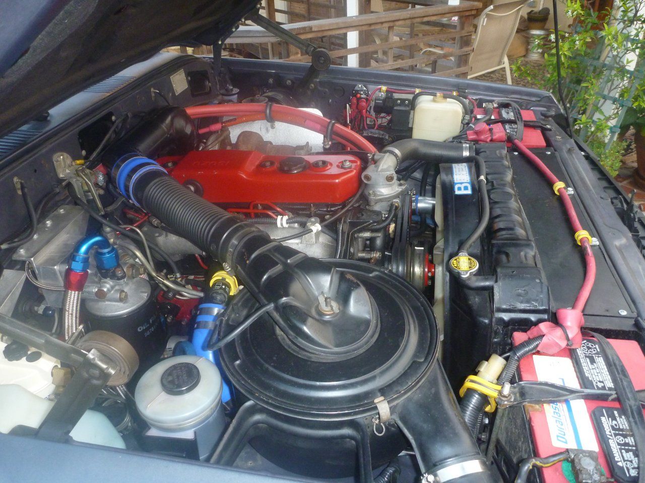

Is the location of the air intake stock?.....Advantages/disadvantages of this if it's a mod?
Not stock.
When a big 2nd battery is installed (which is not installed in that pic) it gets in the way of the stock air intake hose. So I used this Spectre air duct hose.
You can see that the radiator expansion tank has been moved to the passenger's side too.
This duct is the perfect size and can 'screw' into that square hole that exists in the inner fender and make a gentle right angle bend to reach the round hole opening in the front... at the same location the stock intake hose attaches. It fits into that hole opening perfectly too. Nice & snug.
The quality of this duct is very good. It is strong and thick. I used to have one of those thin flimsy ducts... & it fell apart after a couple years. This one looks like it's going to last a very long time.
Not stock.
This duct is the perfect size and can 'screw' into that square hole that exists in the inner fender and make a gentle right angle bend to reach the round hole opening in the front... at the same location the stock intake hose attaches too. It fits into that hole opening perfectly too. Nice & snug.

I'm in the process of my dual battery setup, I like the idea of a battery on each side of the radiator to help balance the static weight of the batteries out. 45+ pounds per battery so 90+ pounds on one corner could cause issue.
This was not last weekend, but here is my dual battery set up/ I used a second factory 60 tray and mount with a cable connecting them. Simple and works well.
Output, that is clean!
Doug, did you use an isolator or did you wire the batteries in parallel? That wire up across the shroud makes me think that they're wired in parallel.
No isolator in parallel.
