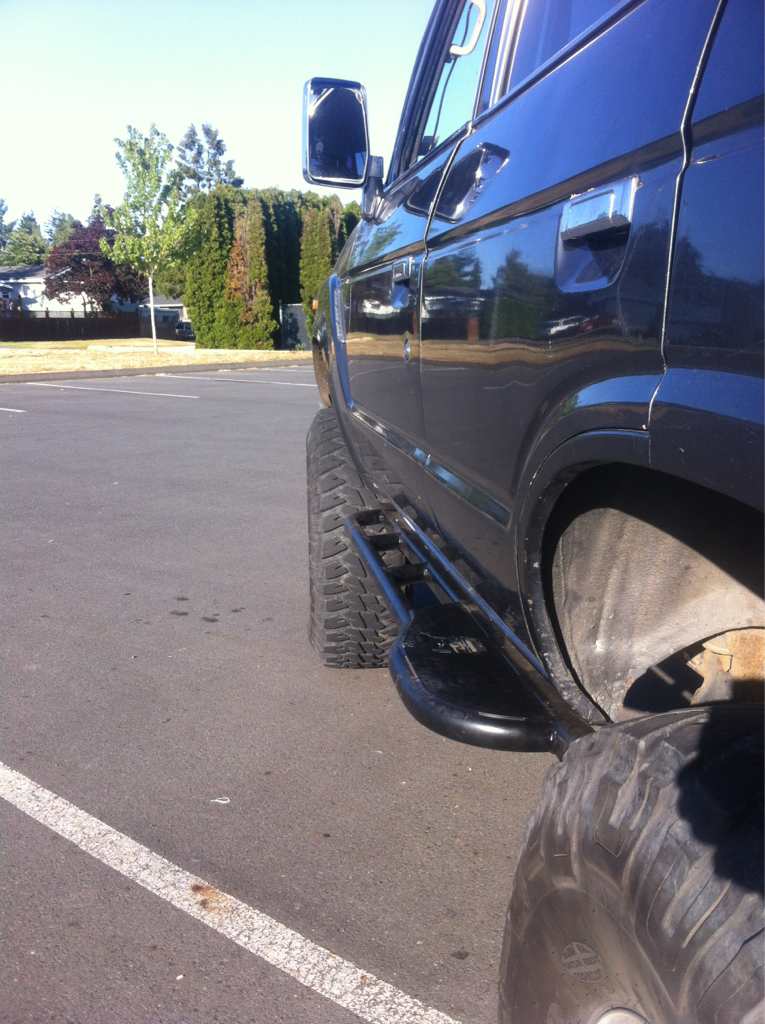

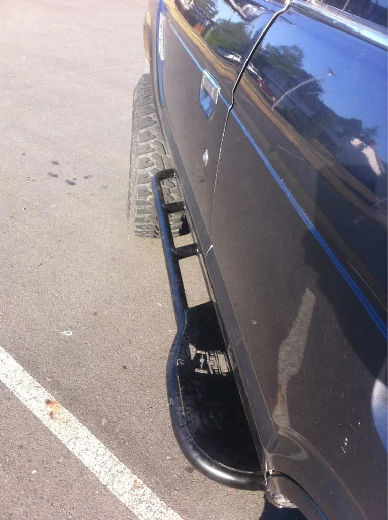

Installed the sliders I built, picked away at them for months, but finally finished.

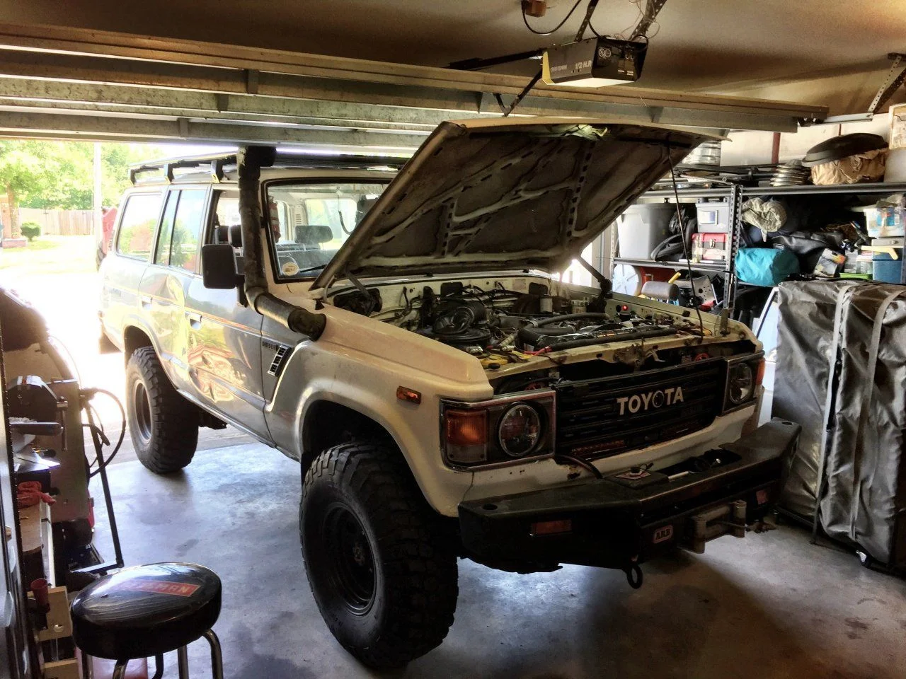

Finally unpacked the new garage enough to pull her in and do some post diesel swap checks after a couple thousand miles. Re-tightened engine belts and found lower radiator hose rubbed on the power steering pulley a bit to leave a mark. Replacing the hose and will better secure it. Everything else checks good.

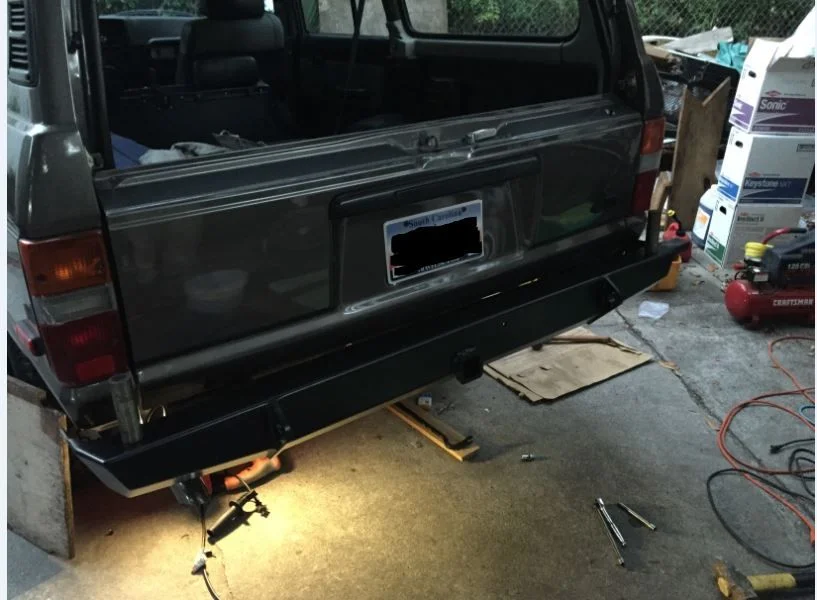

I know it's not the weekend, but since I started on the bumper yesterday and finished today I figured I'd share a pic. Shout out to @lcwizard for taking my call on a sunday night when I got stuck putting his bumper on my rig. Swing outs will go on another night when I find some more time.

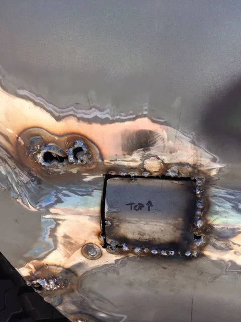

Blew holes in my patched panel. Still learning to weld but think I figured it out but will see tonight.
Get a thick brass block and hold it tightly behind the spot you're welding. the block won't stick to the weld and you won't blow through.
Carbon blocks also work and are sold as such.
Eastwood sells a magnetic version. I use an 1" thick ingot about 5" x 2" because it takes longer to heat up and burn your hand. You will be amazed at the results. You can fill a 1/2" hole in 18 gauge in seconds
