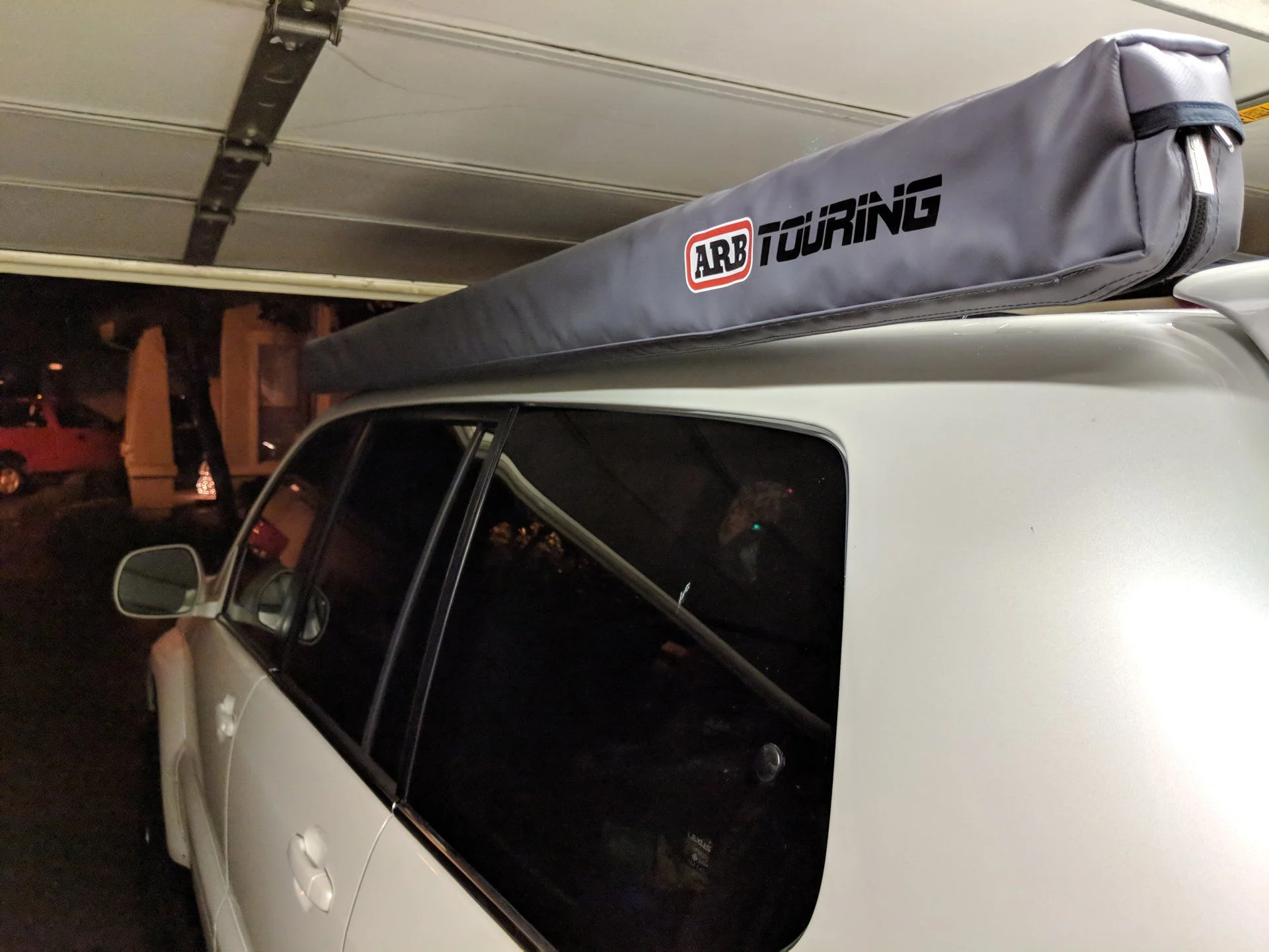

Finally went awning! Had to install it halfway in the garage with 8" of space cause it's POURING here.
tips, tricks, pix?
Install onto factory side rails or do you have aftermarket?

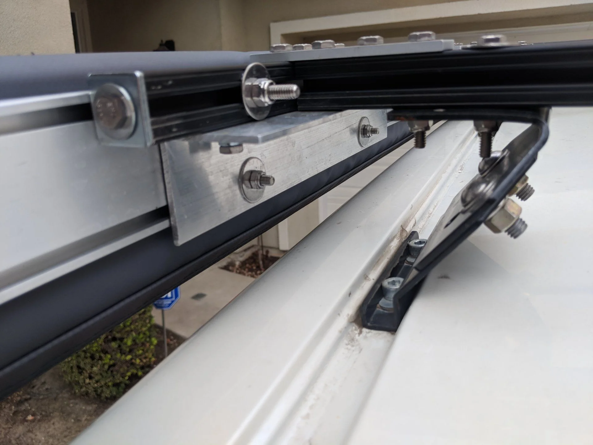

tips, tricks, pix?
I don't have a factory rack - it's an 80/20 frame on Gamiviti towers. I cut 3 brackets out of 3" aluminum angle to support the lower channel of the awning along the length of the side rail. 6 bolts through the side rail in the top channel and 6 bolts through the brackets in the bottom channel.

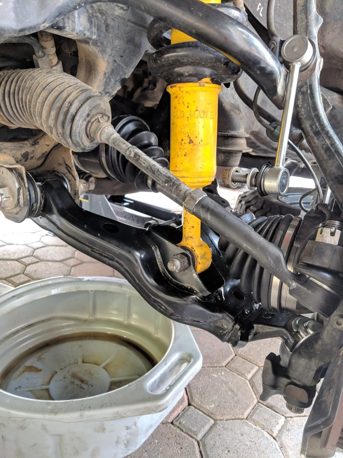

Wrenching weekend!
LCAs, CVs, tie rod ends and sway bar links. Goodbye money and hello clunk-free driving.
Did you go with OEM LCAs? What do you think the culprit of the clunking was? I noticed mine clunking recently with the 0 degree temps. I have an appt. next week to get it looked at but it would be nice to give them a starting point.
Yeah OEM everything except CVs. Not sure what exactly was causing the clunking (I could feel it in the footwell) but the tie rod and LCA boots were pretty shot. How are your sway bar bushings?
Sway bar bushings look alright. I think it’s my LCAs.
