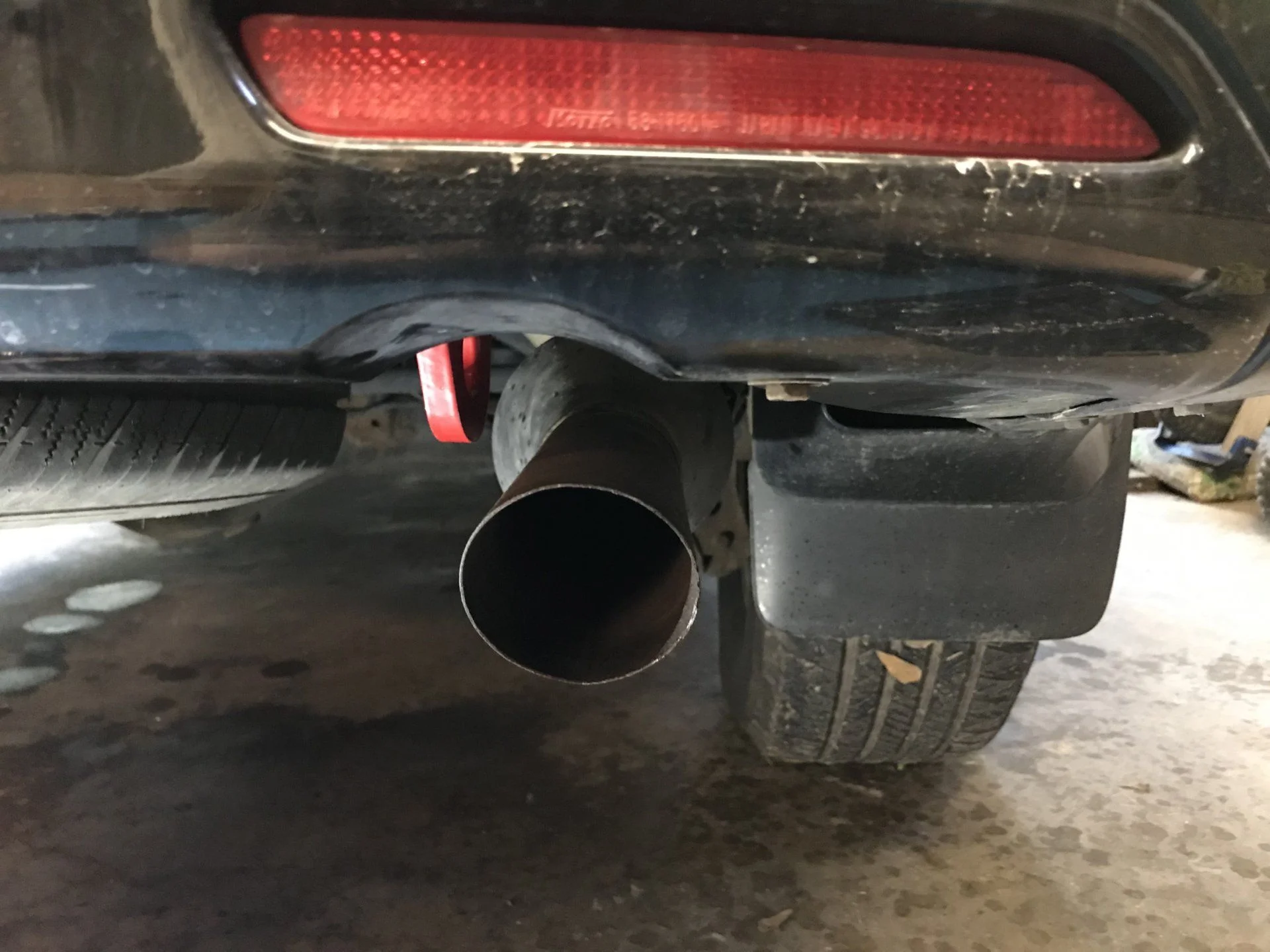

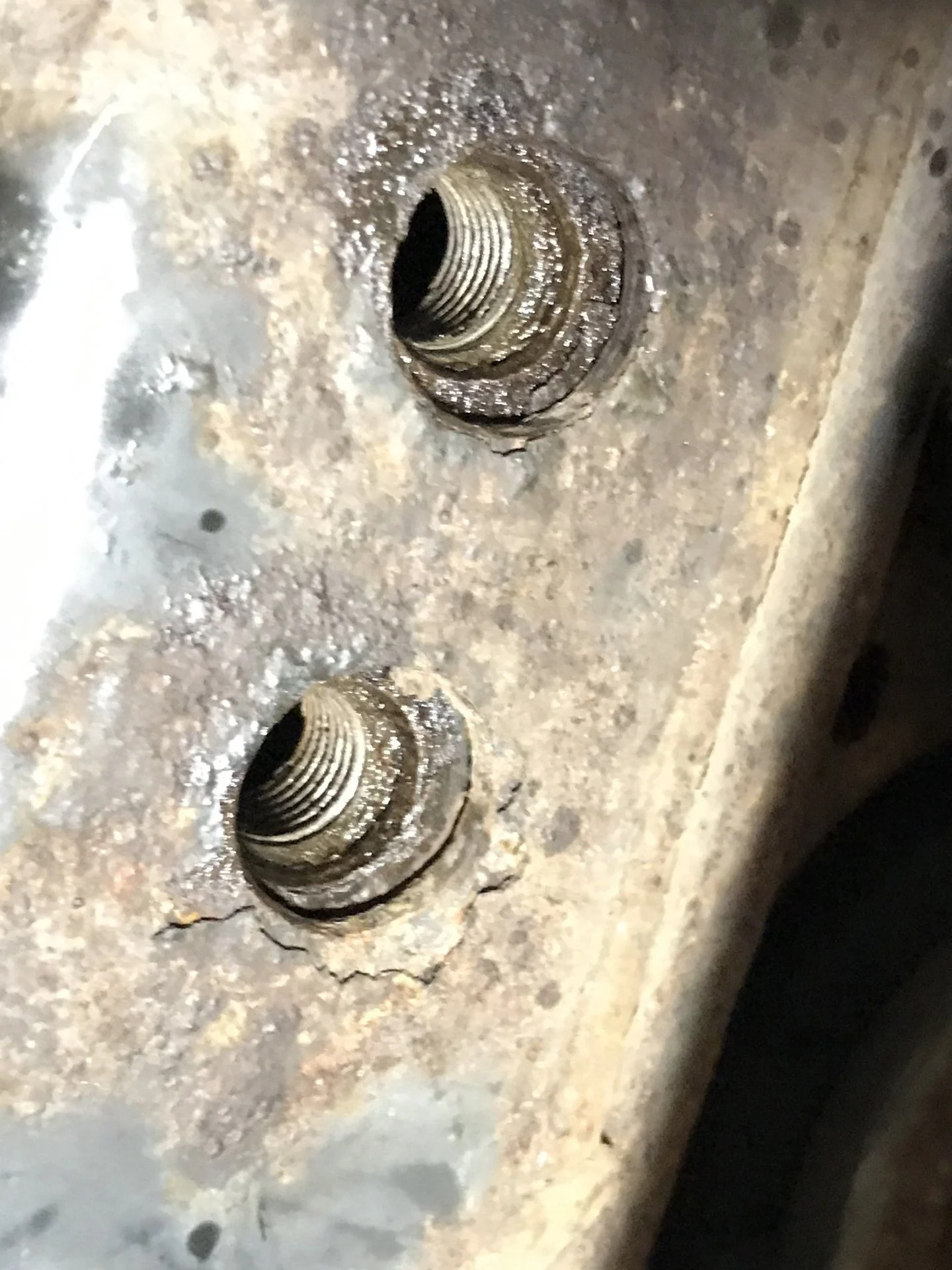

Finished adding my passenger side tow point from Trail Tailor. It took using a chaser to clean out the rusted threads. This one sits close in to the exhaust pipe.

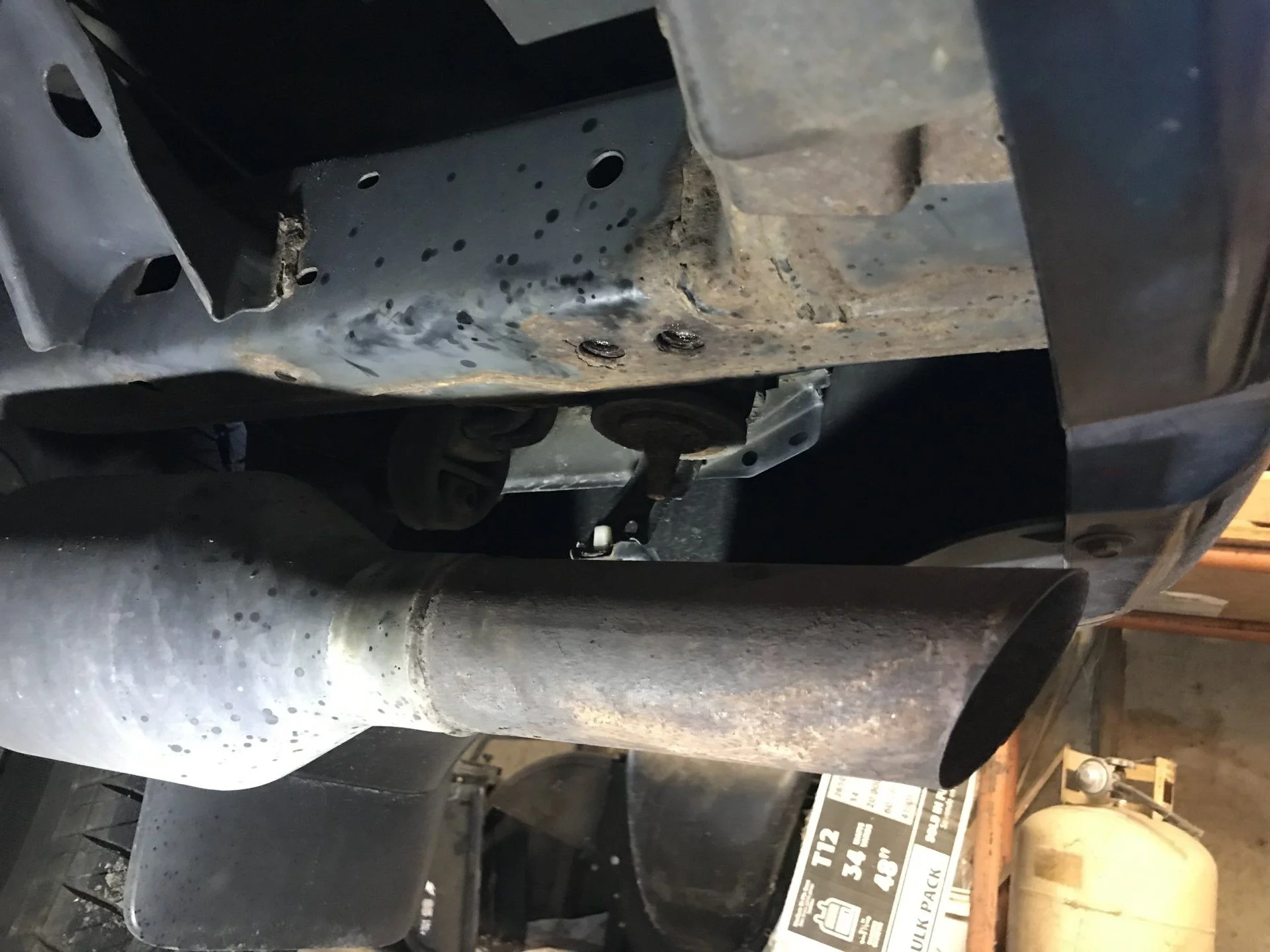

Location of the holes and closeup after cleaning up threads.

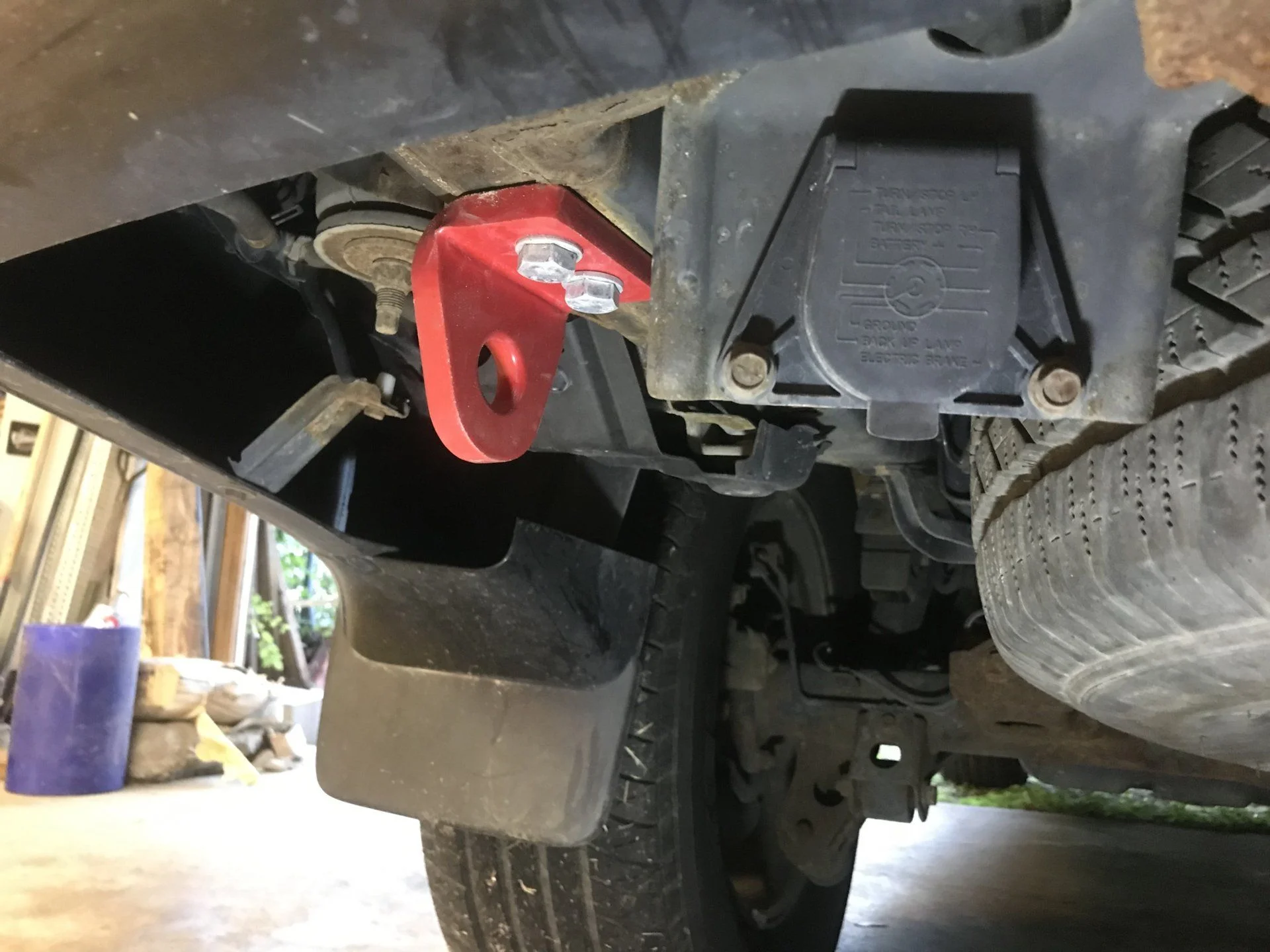

Tow point installed

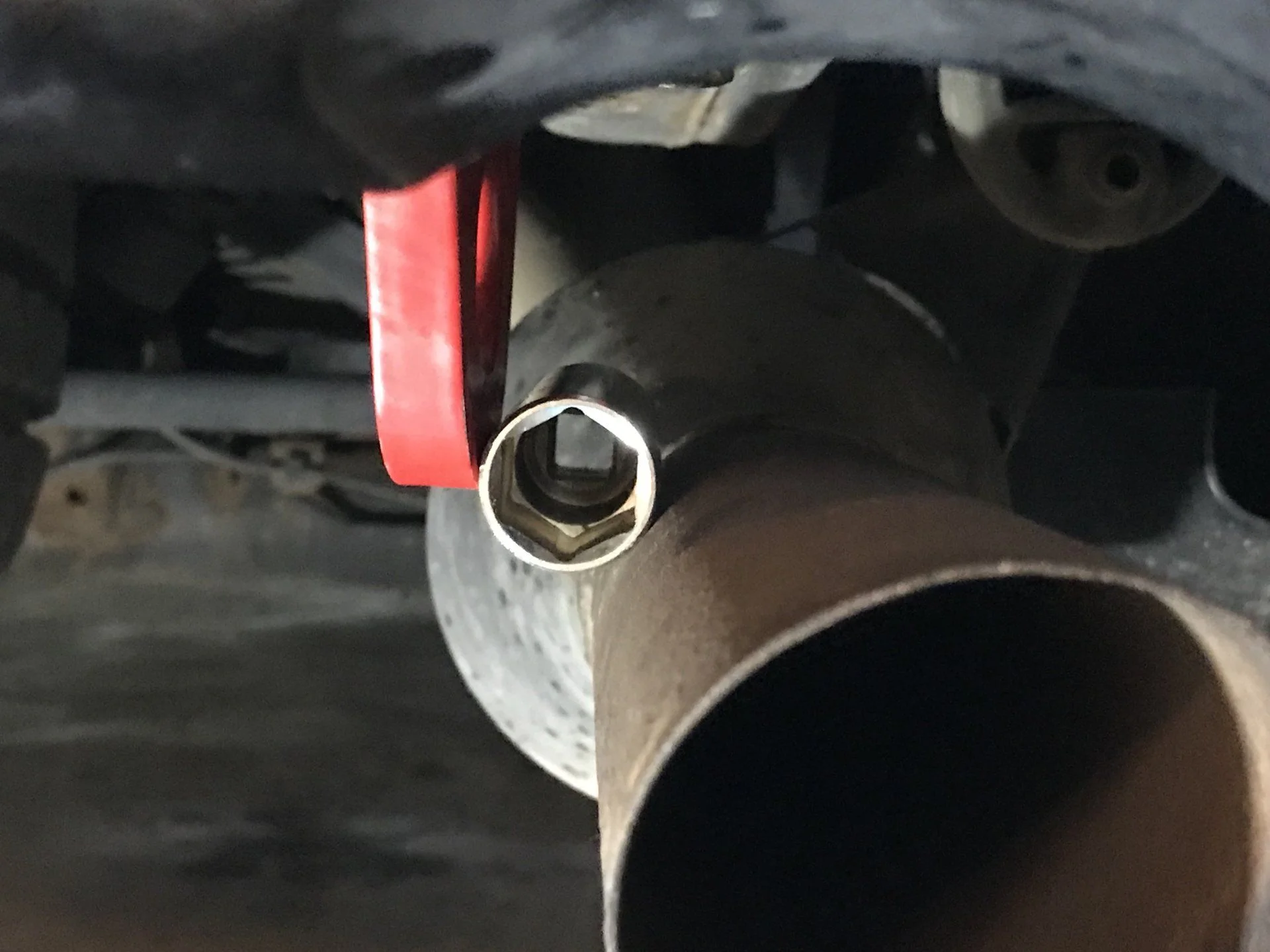

Clearance with a 3/4" socket for reference

Clearance with the Chrome Exhaust Tip installed

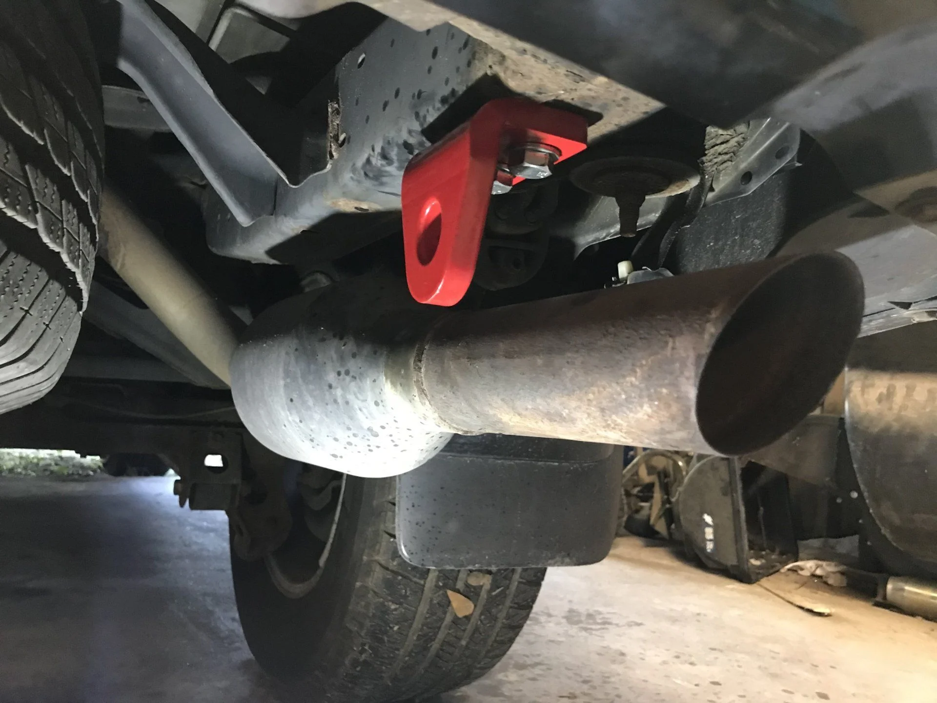

Drivers side view for reference

Nice! Keep the tip off ;)
Better departure angle clearance esp with the shorter angled pipe
