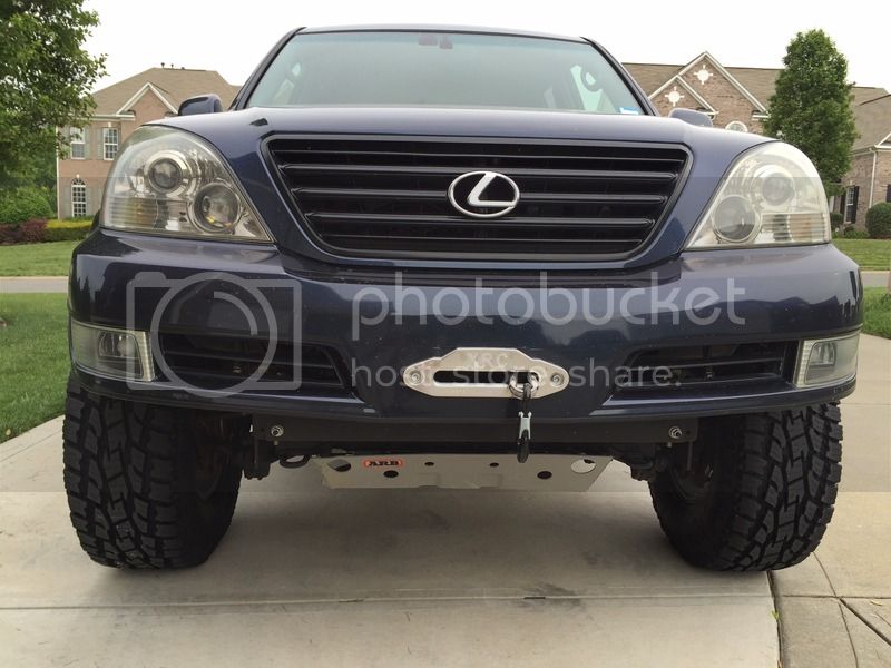

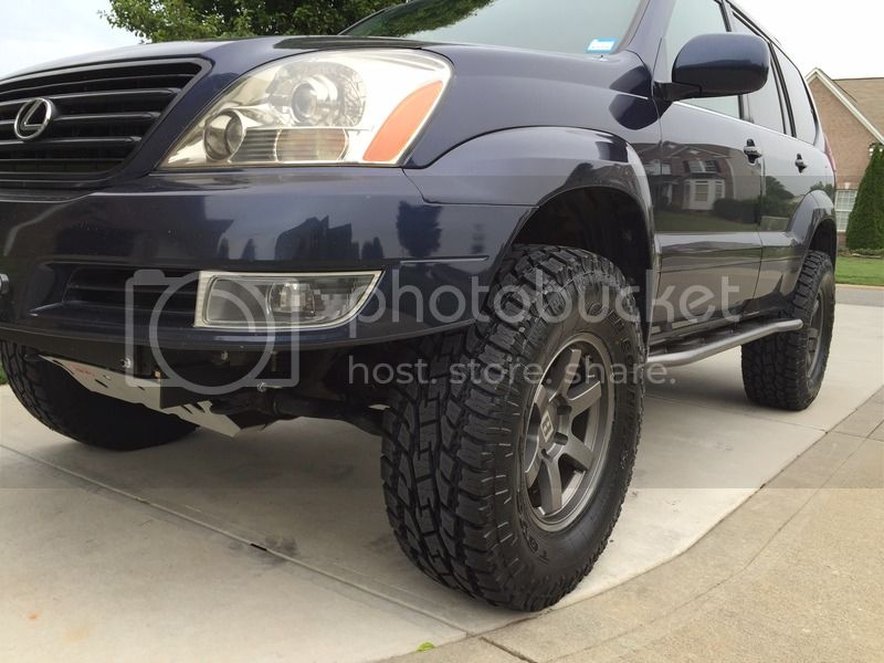

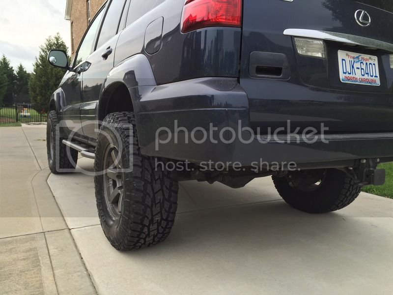

New tires.... 305/70R17 Toyo AT2 Xtreme
Looks bad A*%!! Are you running stock UCA's? If so do they rub with those wheels? Do you have a body mount chop as well?
Thanks
Looks great madtoy! How does she feel with the 305's?
Haven't had a chance to get on the highway yet. But they were super smooth and quiet on the 3 mile back road home.
@lobodog1 - Light Racing UCA set at the 1 degree setting instead of the neutral 2 degree setting. Then had caster dialed in at the bottom control arm to get ~3.5 degrees. I did chop the body mount, and pounded the pinch seem flat. Also cut and moved some plastic. No rubbing, but very close. These tires are every bit as tall as most 315's. Measure 33.25" tall loaded.
