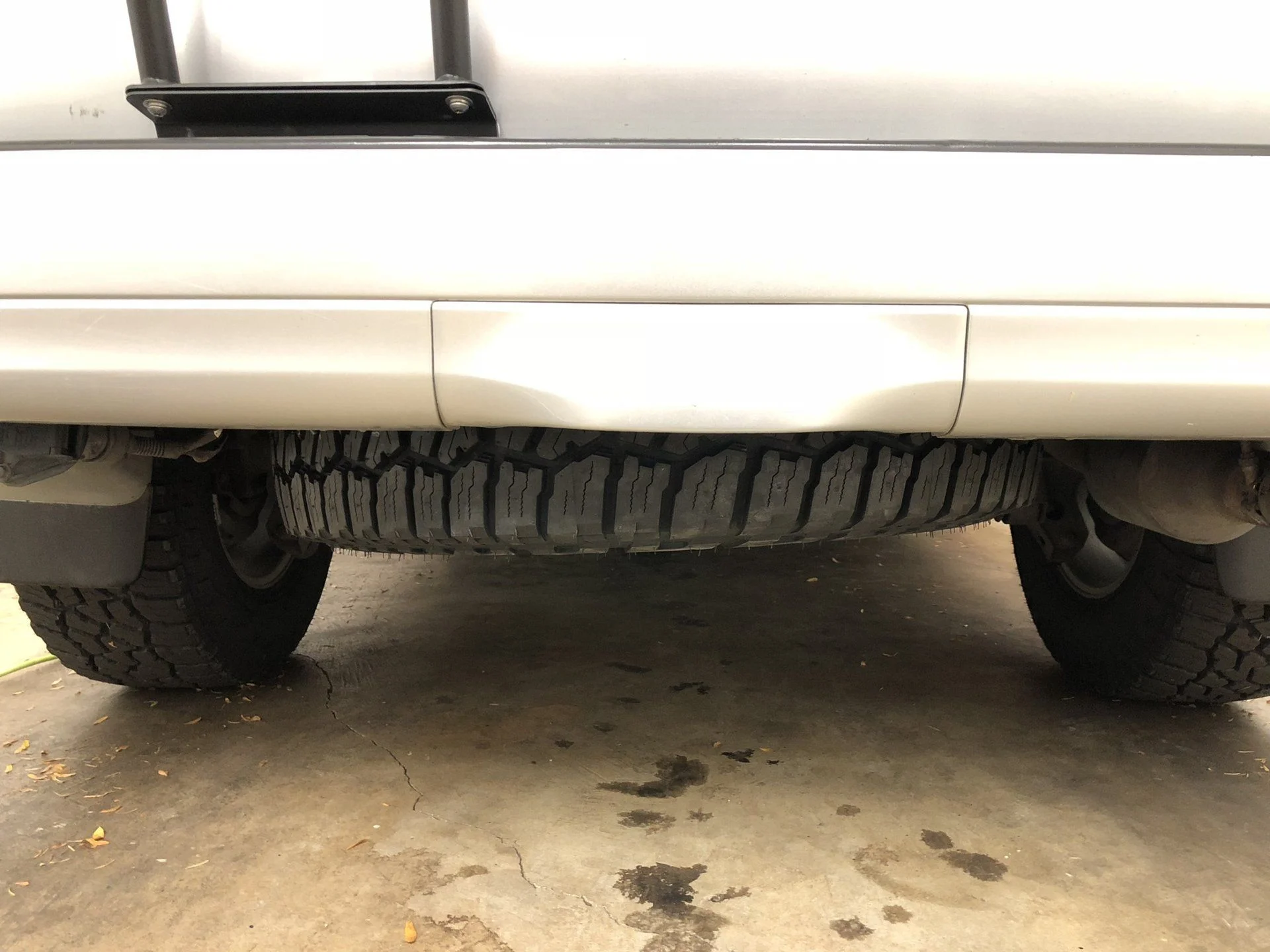

Last night I did a rear coil conversion using SSO's kit, FJ Cruiser rear springs, and OEM spring isolators. Didn't account for the rear swaybar endlinks being rusted on though. Had to cut them off, hoping to track some down locally today and get it back on the road this evening. Having an extra person around to stand on the axle ends really helped with getting the springs into place. Cut the airlines and the bags came right out, and removed the compressor while I was under there too.
Where does the 3rd airline go towards the driver's side edge of the vehicle from the compressor?
Are you going to get the smaller receiver that bolts to the rear bumper bar?
Yes, that is the current plan. Drops my tow rating down 1,500 pounds which shouldn't be too big of a deal, just not sure about using it as a rear recovery point then.

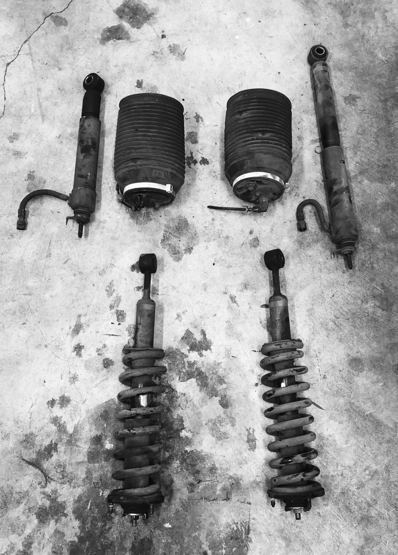

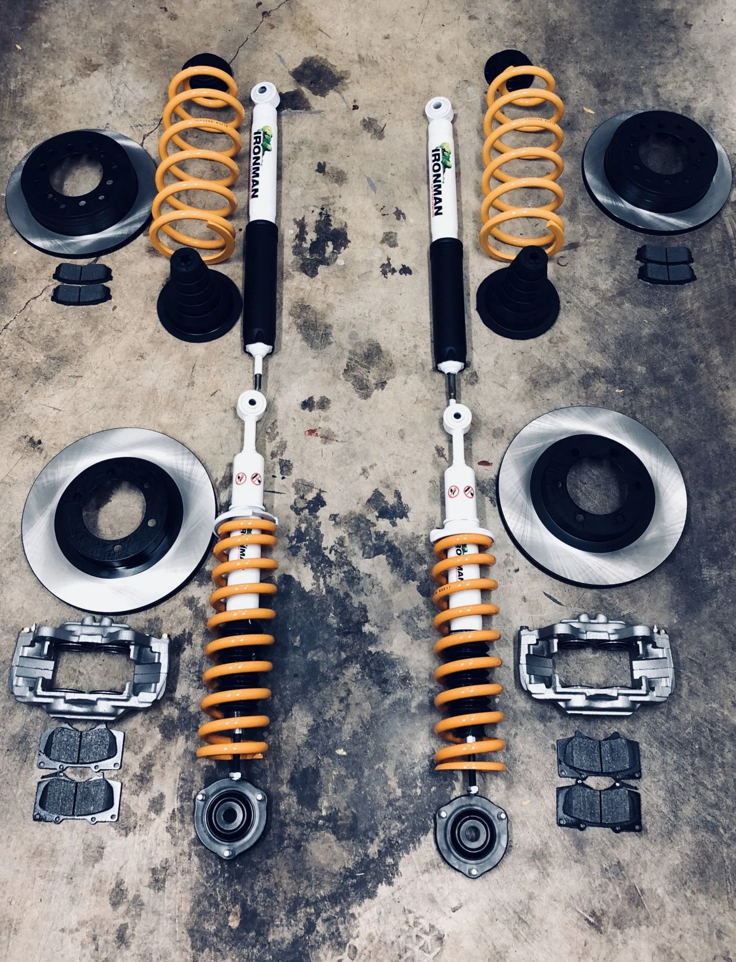

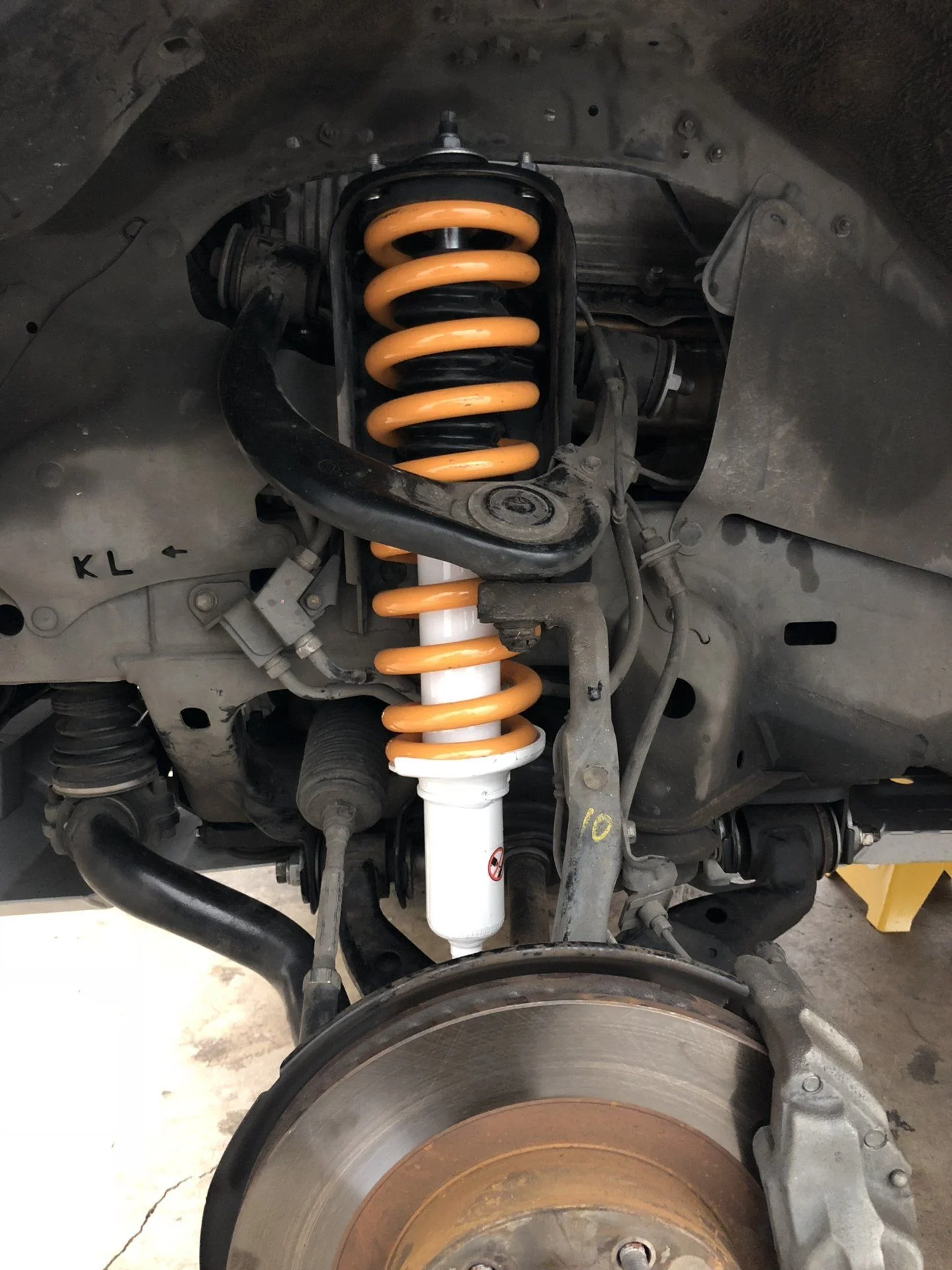

Installed new Ironman 4X4 lift kit, glad I did as the stock rear shocks were completely shot. Dealing with the KDSS swaybars was a nightmare, we backed out the shudder valves and still had to fight them. Rides great though!

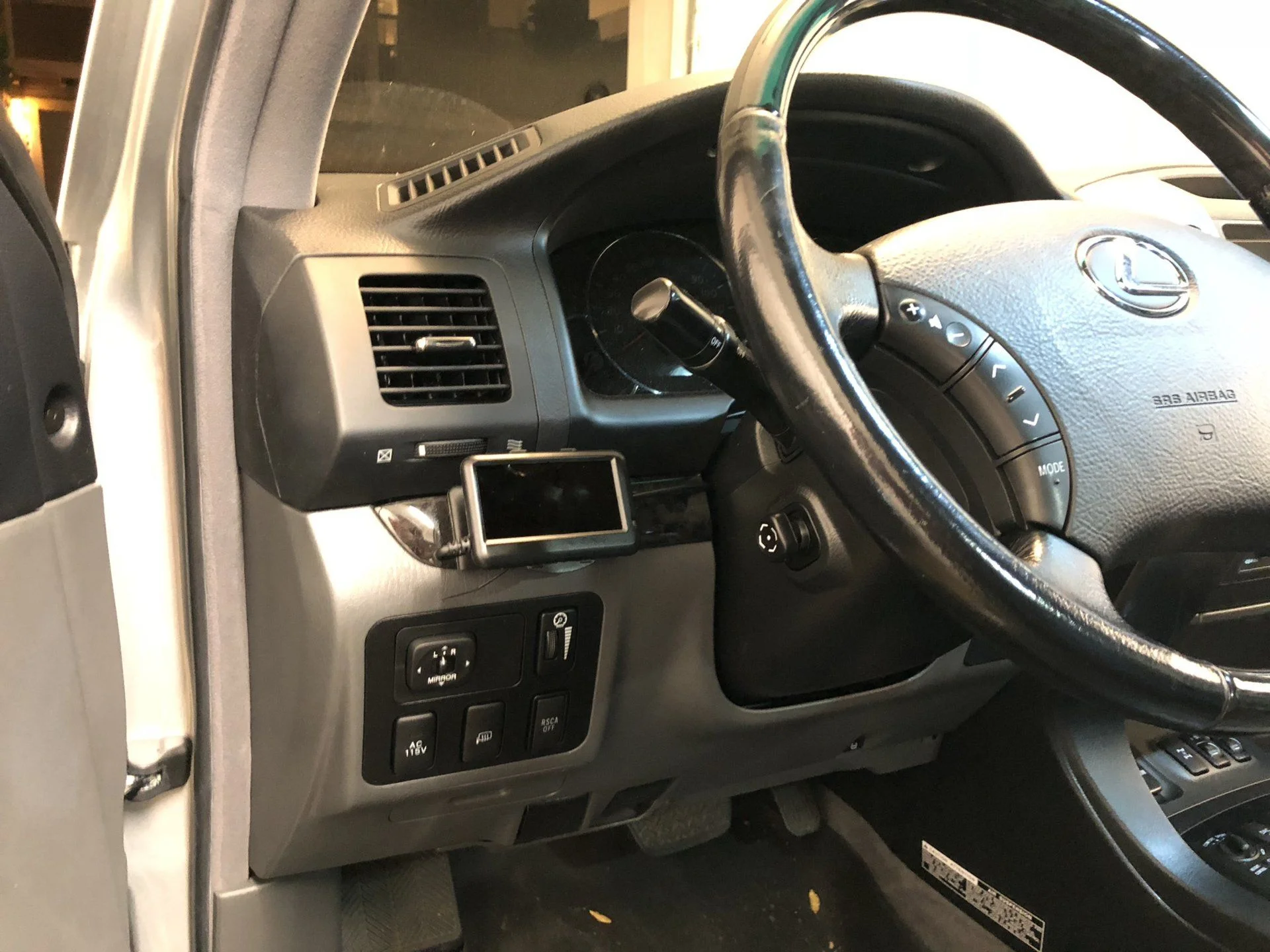

Installed my Cobra 75 from the tacoma to the GX
