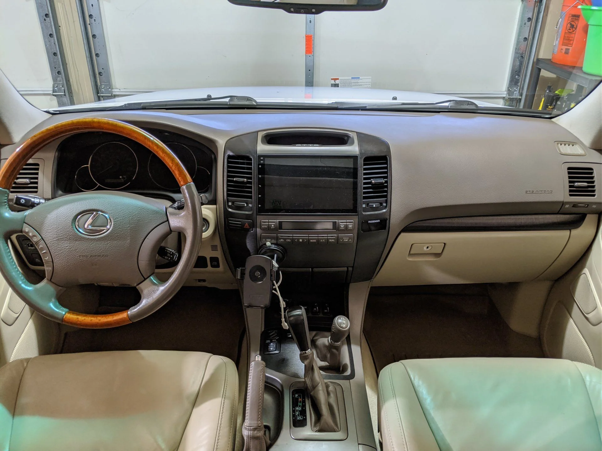

Getting rid of the wood by wrapping it with 3M 1080 BR212 Brushed Black Metallic vinyl wrap. It really changes the way the interior looks and I like it. It was a very time consuming task. The shift knob was a total pain and looks like crap up close. The door panels have to be removed to detach the wood trim pieces. Word of caution: If you are like me and let the panel hang while removing the trim there is one plastic door panel fastener that is in the perfect position to put a hole in your door speaker. Remove it as soon as you are able to!
I now have to decide what to do with the steering wheel. Options are to get a stitch on cover, black 4runner steering wheel and airbag, sport edition steering wheel and airbag, brown GX steering wheel that is all leather and keep my airbag.

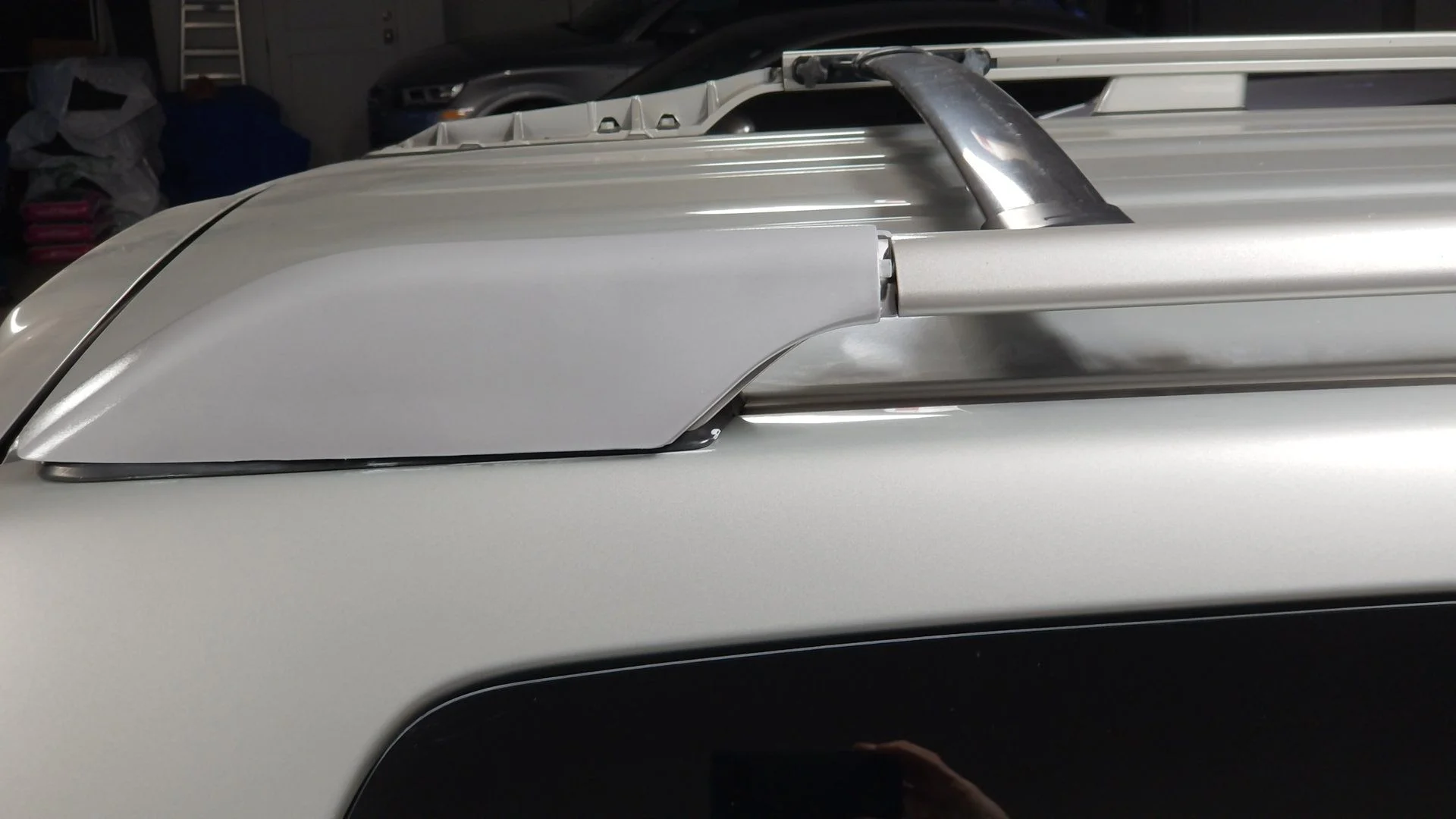

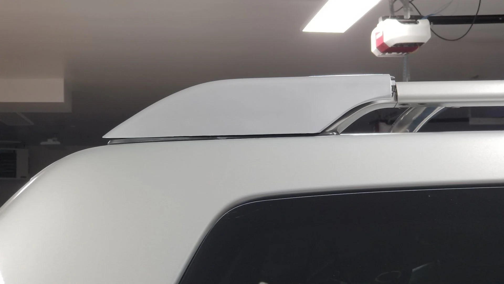

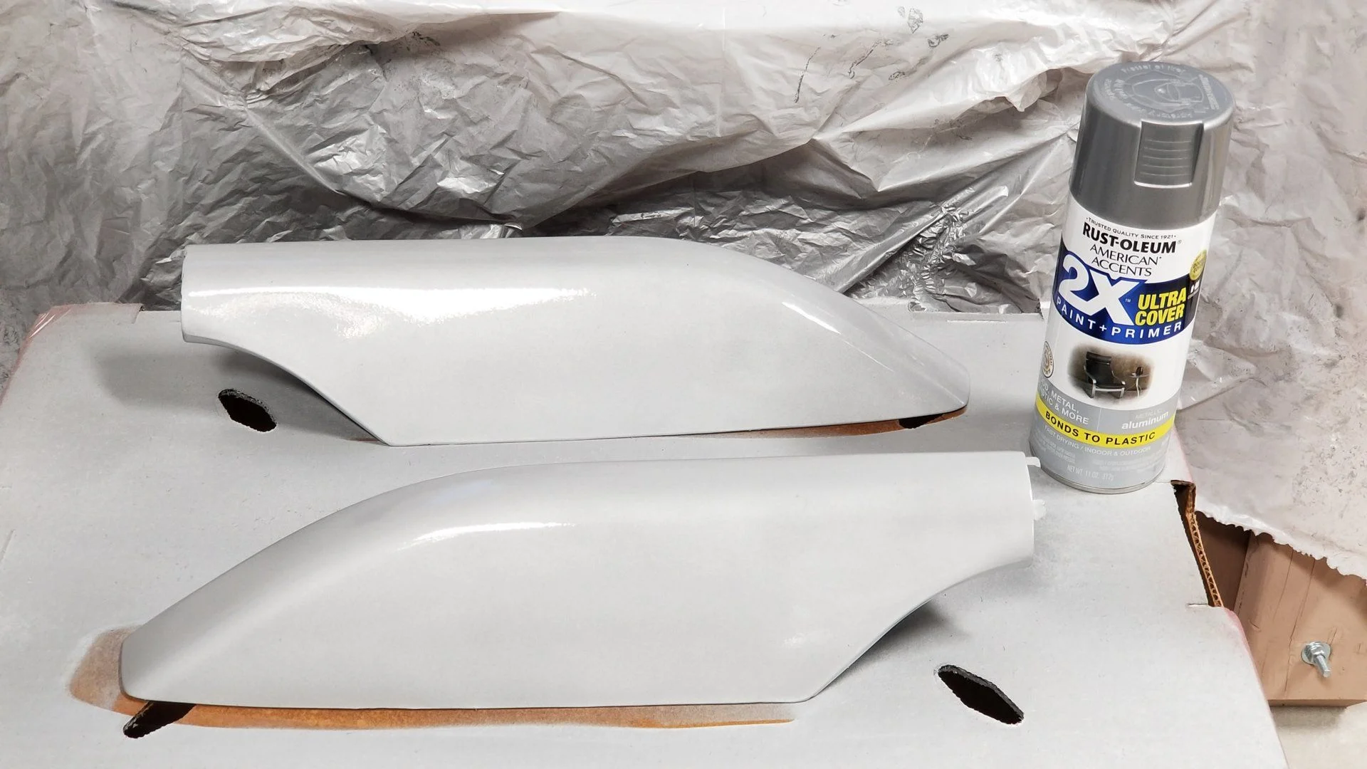

Had two oem roof rack caps missing, bought a set of cheapy 120 caps from eBay (or somewhere online, only a small bit of modding to make them fit) ran with them for months just plain black. At my in-laws now for Christmas all week and what better way to distract myself with a nice project than to sand, paint and clear coat the black caps to match? Good enough for me. Next distraction, headlight polish kit.....what could I do after that....?

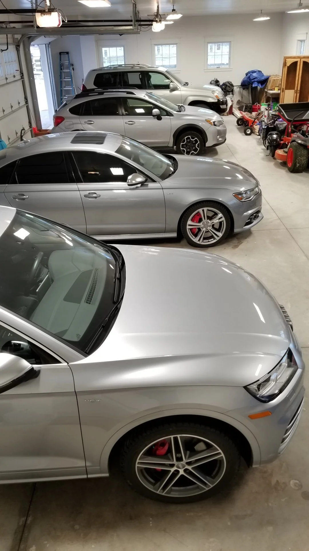

I think I'm seeing a theme here....
I need that garage.

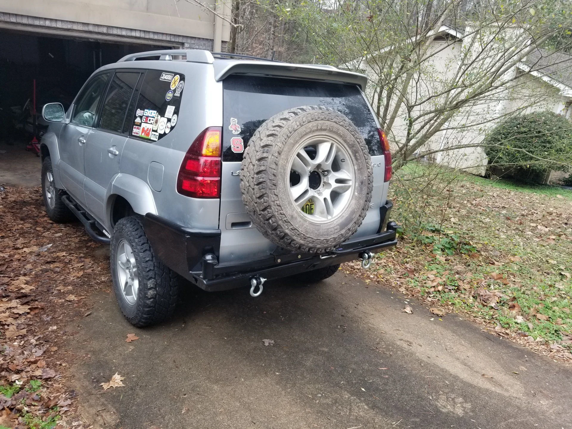

I did a thing. 4x4 Labs w/ dual swing
Daylight pic but still dirty.
What’s going on the other swingout? Is the double swingout a pain to open the rear door?
Nothing yet but I'm sure I'll figure out something. Opening it is easy so far but I haven't needed to open it a whole lot yet.
