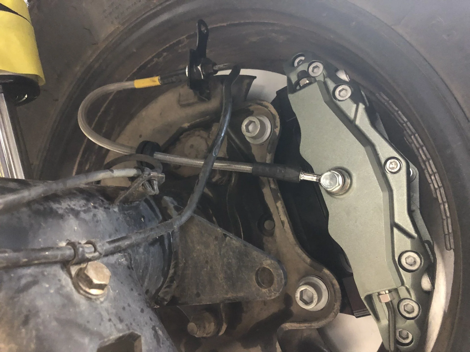

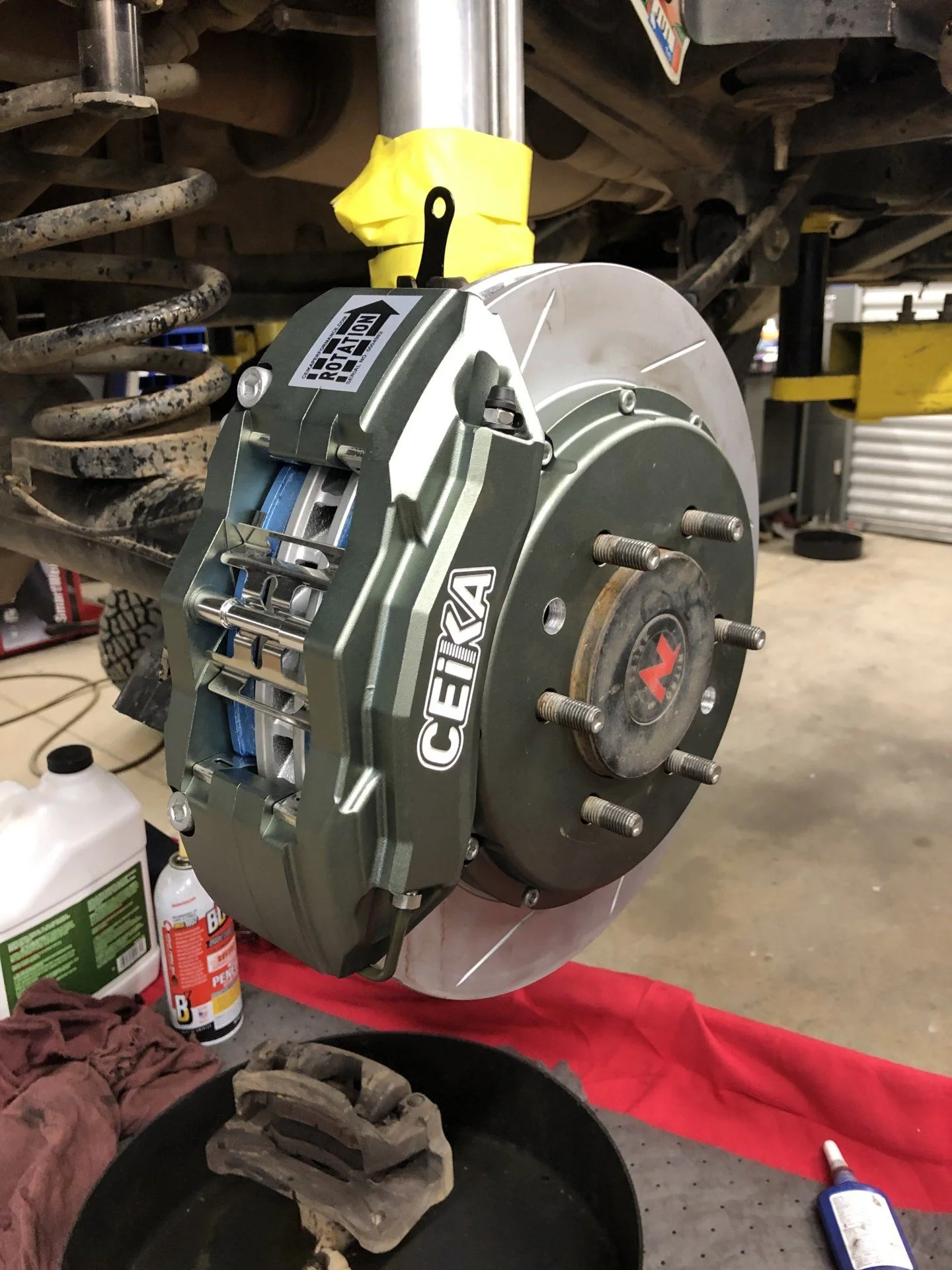

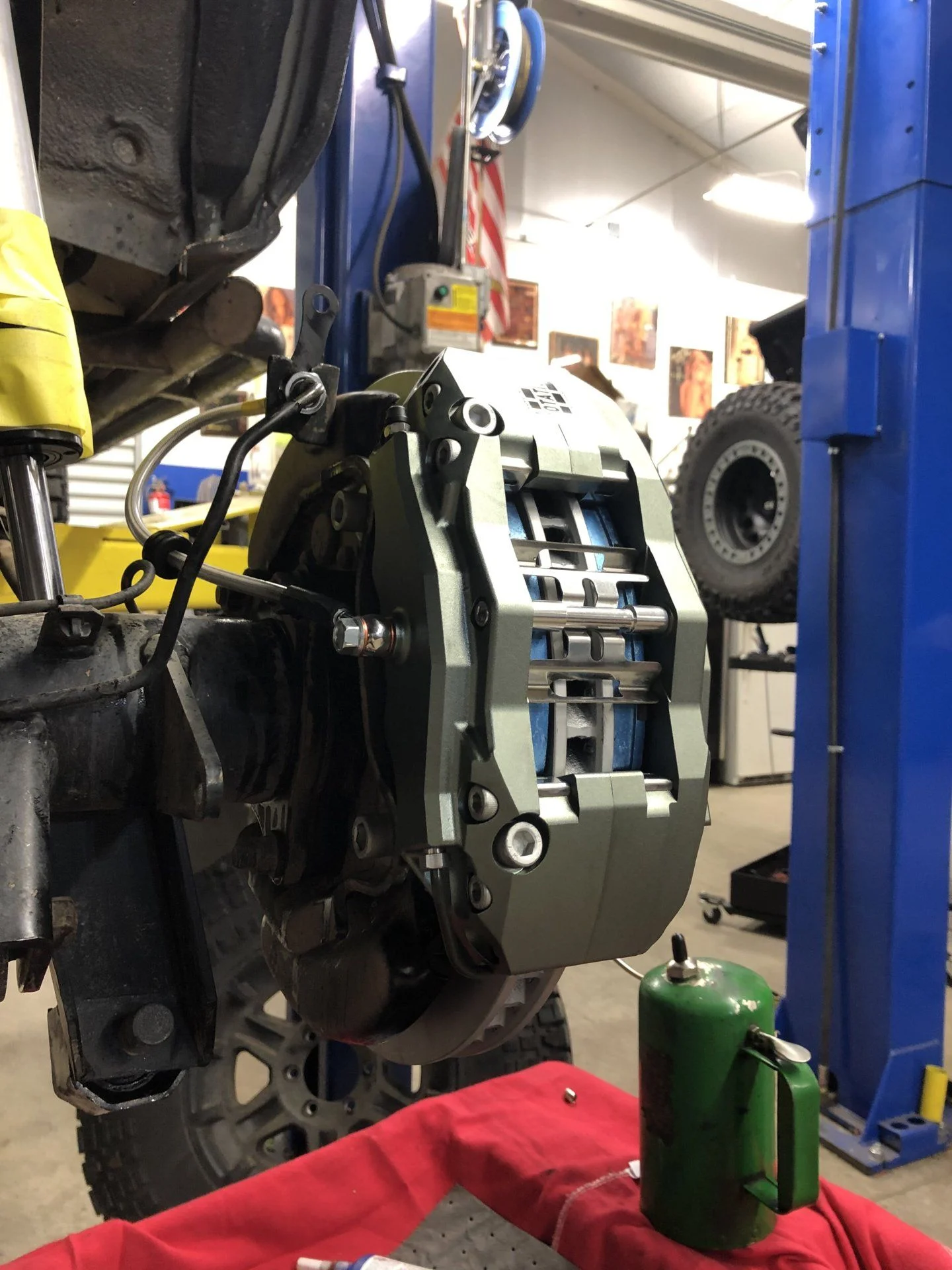

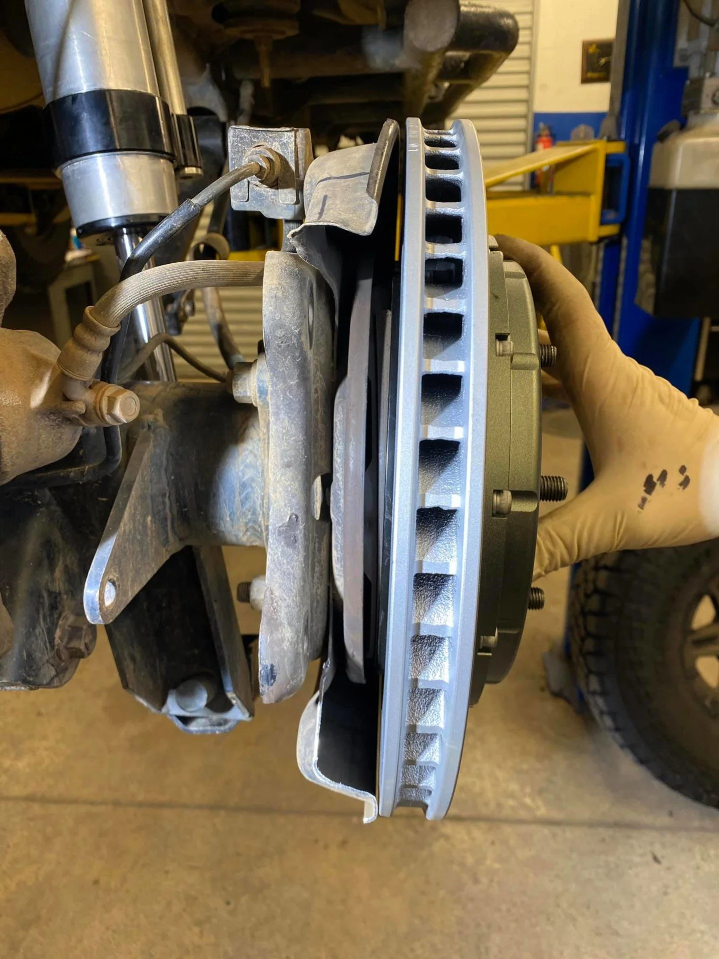

Seems the big brake kit in the rear is, indeed, bigger.

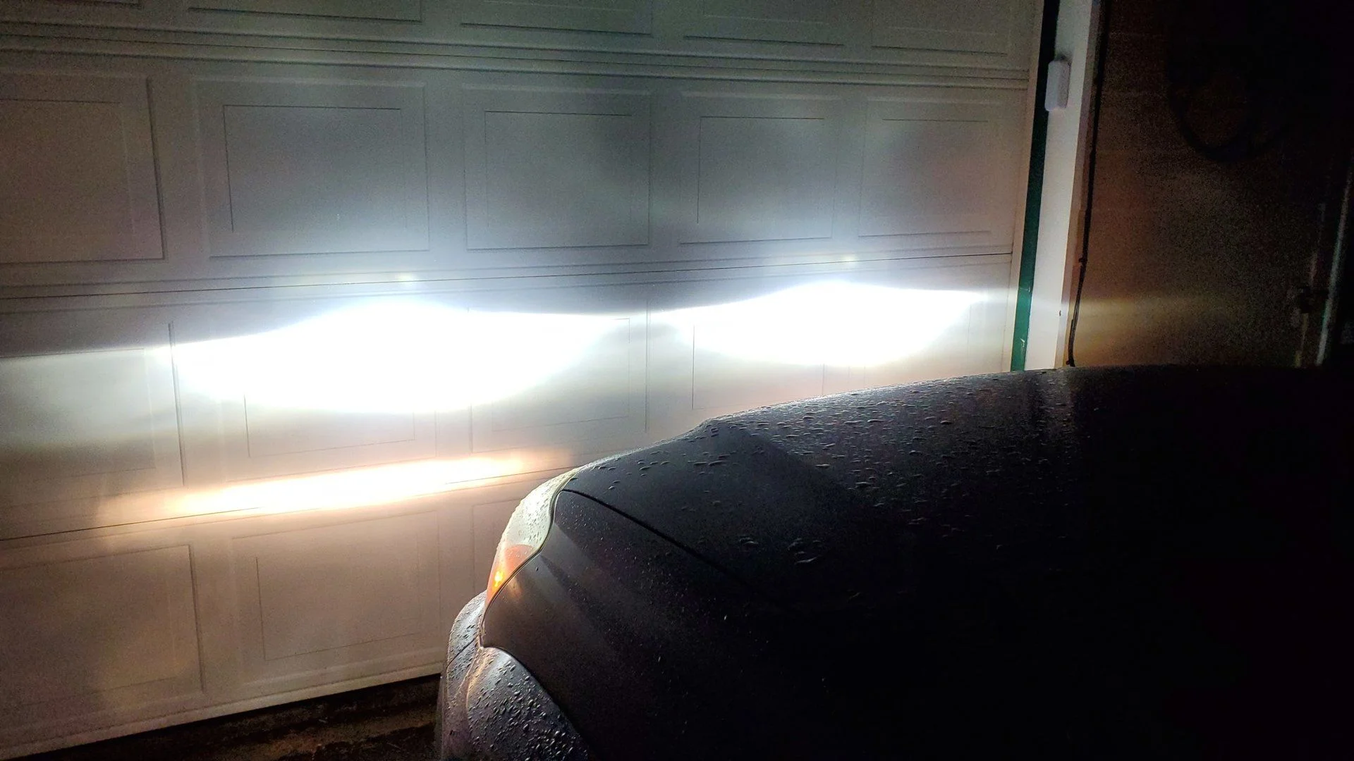

I installed the H11 Diode Dynamics SL1 LED bulbs in my low beams. They were on sale for Black Friday and claimed to be designed specifically for halogen projector housings. I don't have any photos, but the cutoff is nearly identical to the halogen bulbs, but the hot spot is wider and the light output is probably three times as much as stock. It is an amazing improvement, and I'd recommend it to anyone considering LED bulbs.
I finally snapped a photo of the SL1s. The camera on my phone made the light blossom at the hot spot, but the cutoff is very flat and sharp and follows the halogen profile almost perfectly. It is the rainy season here in the PNW, so some of the stray light streaks you see above the cutoff line are rain drops on the headlight lens.

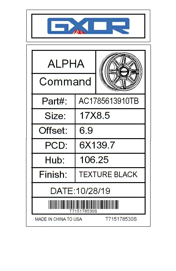

I worked with them on a spec that works for stock with larger tires, still works with a lift and larger tires, and doesn't take the stance out too far (and preserve scrub radius, etc). Here is the release:
NEW PRODUCT RELEASE! – ALPHAequipt Limited Edition GXOR wheel
I am pleased to announce that in collaboration with GXOR, ALPHAequipt will be releasing a GXOR limited edition wheel! Working closely with Dan Kunz and getting feedback from numerous members of this group, we designed a wheel heavily influenced by the needs of this group. It is our Command wheel in an exclusive texture black finish adorned with the center cap prominently displaying the GXOR logo.
Cost will be $225 per wheel. If you are interested, please send an e-mail to chris@alphaequipt.com with GXOR in the subject line. They will not be listed on our website as we are not releasing these wheels to the general public. You can find all the specs on the photo label. If you wish to secure a set of 4 wheels (minimum) and pay later, we will take a refundable deposit of $69. We’ve made a very limited batch of these wheels; thus we will be taking pre-orders starting today.

Looks very nice! What is the larger round hole at the end of the bottom spoke in the picture? Valve stem location? I see another smaller hole 1 o'clock as well.

Correct so you can air down and monitor the PSI at the same time.

exactly. One is the TPMS stem (if you have it) and the other is a non-TPMS stem for airing down/up so you can do it faster with no errors (or air down on one and read pressure on the other).
