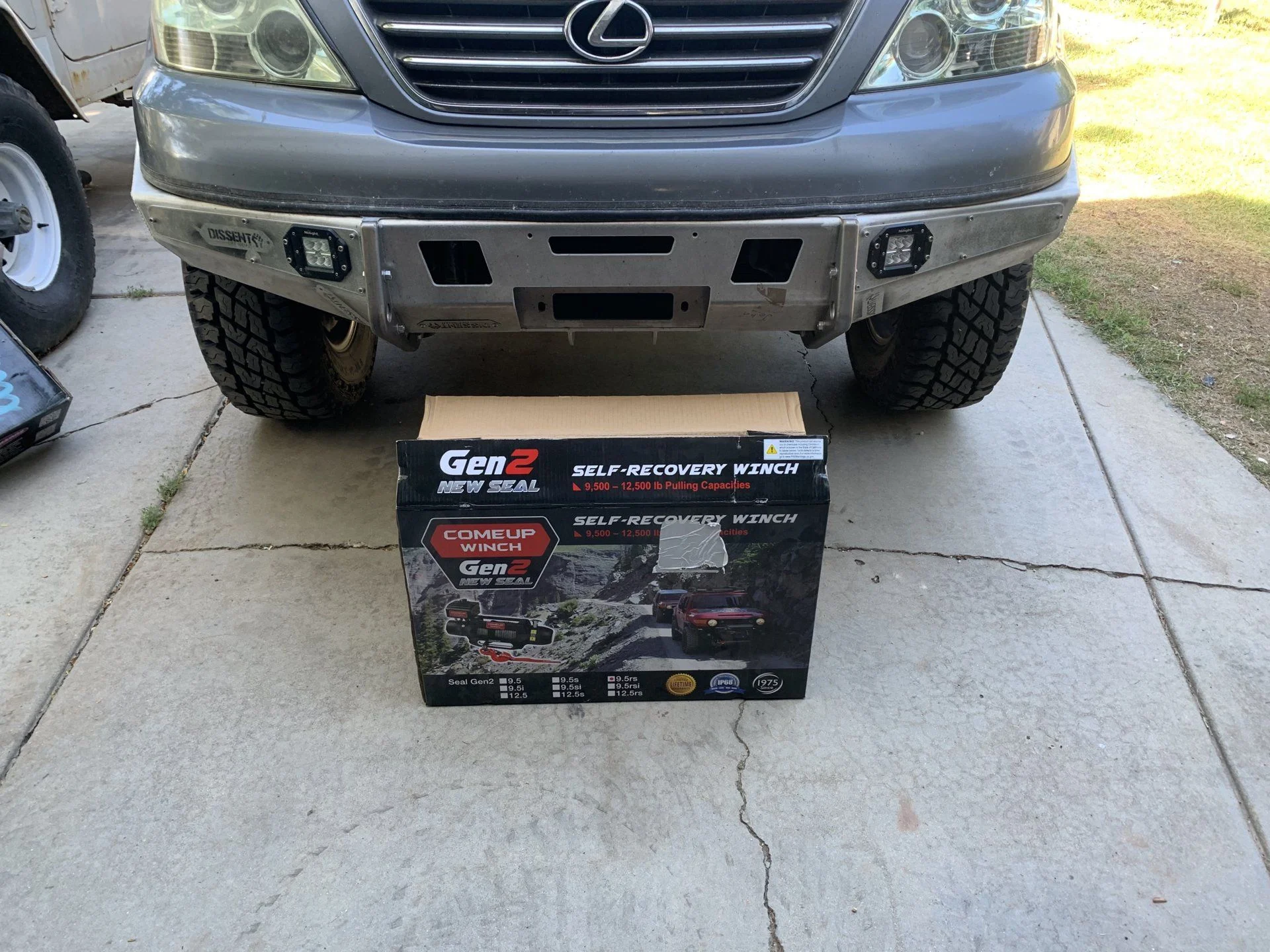

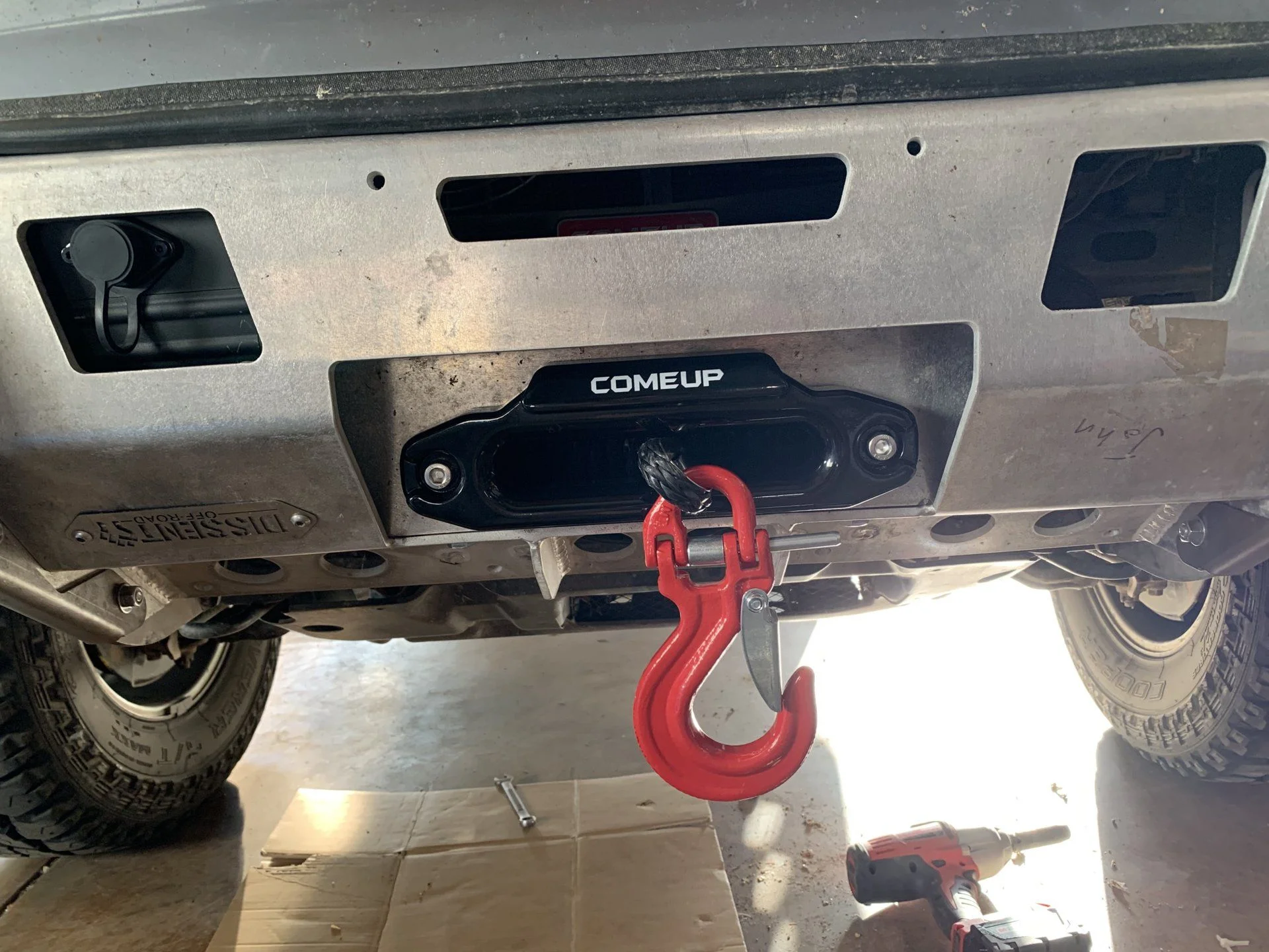

Back in August I installed a Come-Up winch:
hanging out at toytec doing my details, I watched them install a few winches. I’d never done it or used a winch and thought my install went well (did it myself). They unwind the whole thing and attach it to their forklift then winch the forklift across the shop to re wind the winch cable under tension. I finally did that today using my other gx in neutral with e brake on one click.
not sure it’s totally necessary but they told me it was best practice so I did it figuring it couldn’t really hurt anything. And it tested the winch.....
It is a good idea. Stretches the rope so more fits and you don’t have any slack in the line when you have to winch the first time

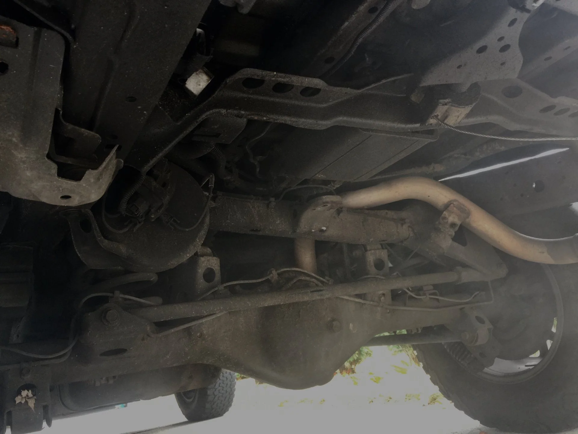

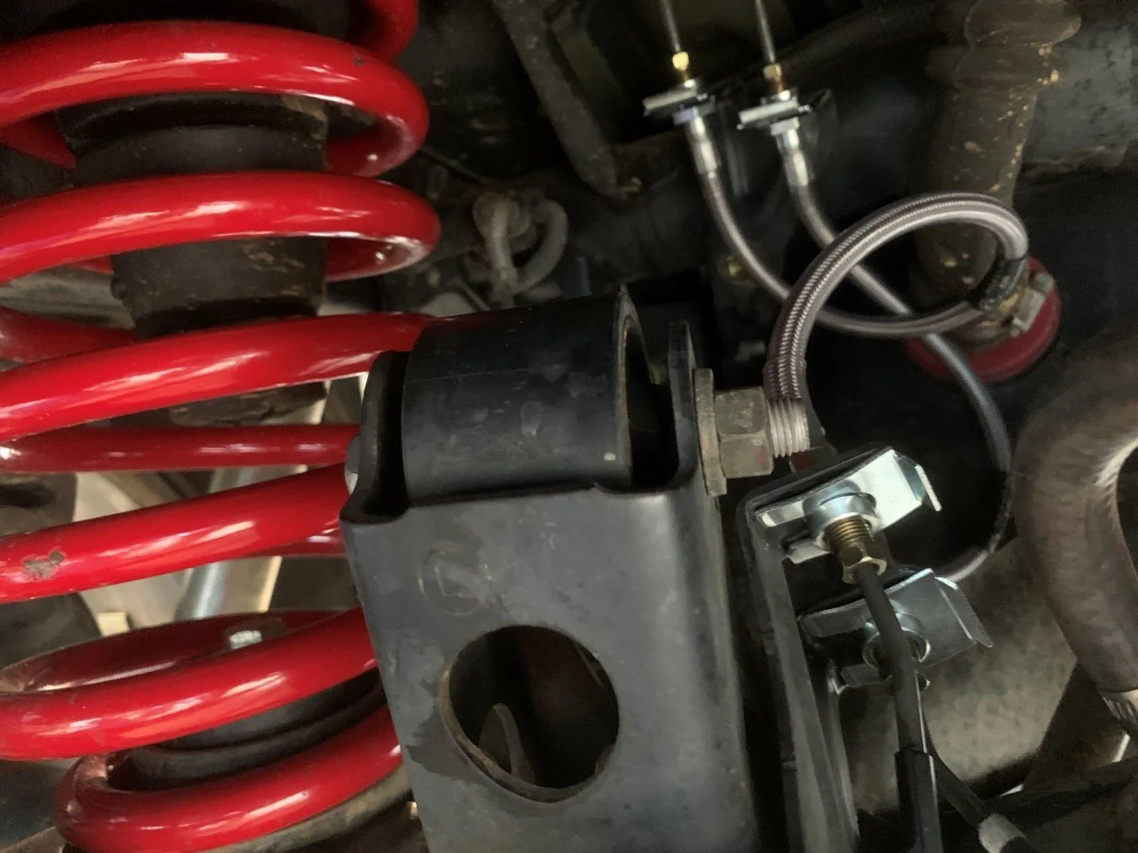

I installed the MetalTech extended rear brake hoses. The stock hoses are 13" and the MT's are 17". One hose coils nicely and the other seems to contact something no matter how I tried to orient it, usually it touched the fuel tank or fuel filler. I wonder if 15" would be the sweet spot for a mild lift (~2" rear lift)?
While bleeding the rear brakes, I experienced something strange. With the key on ACC the right side bled like normal, no issues. the left side would not push fluid out no matter what we did. Then, my brother moved the key to ON and it cycled a good bit of fluid quickly and he said the pedal pushed back while it was occurring. I took it for a test drive and the pedal is nice and firm, as it should be. It seemed strange to me but it seems to be okay.
