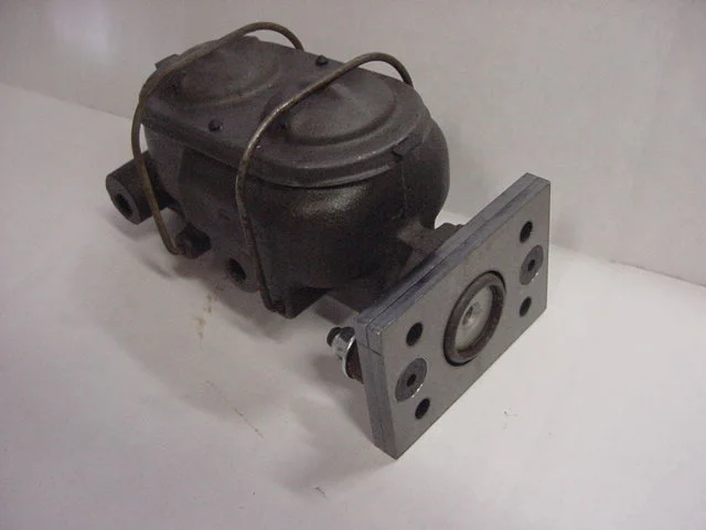

Sky Mfg makes this

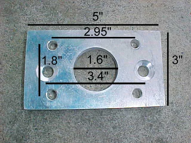

or one can make their own like this

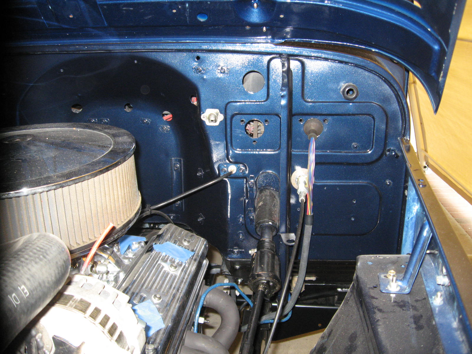

Wow! Thanks for all the information. I am using the stock axles with disk brakes. I'm starting from scratch, as I have no lines run or anything yet. Here is my "canvas":

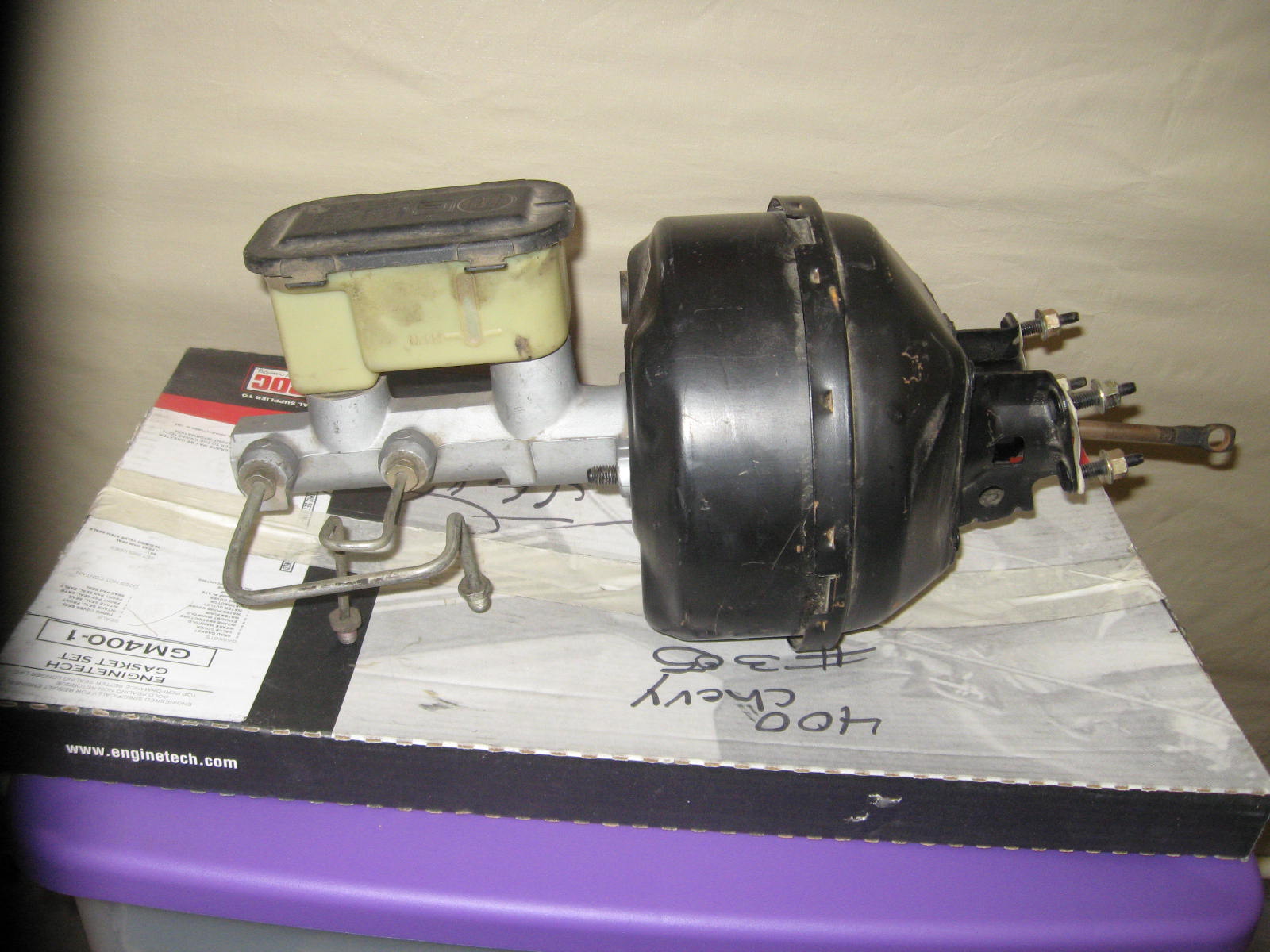

Here is the booster / MC I could use if it will work (not sure what it came off of):
Ideas?

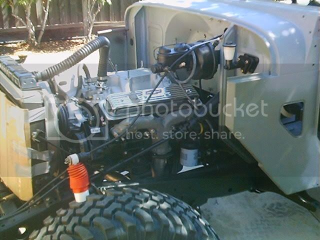

With your style firewall rib you will need to space the booster out from the firewall. The spacer is basically a piece of pipe sandwiched between two flanges, one with the toy bolt pattern, the other with the chevy. I needed to make a smaller adapter for the clutch master which shows up better on the pics (FJ40 mc to FJ25 firewall)
Any muffler, brake, machine shop should be able to make the adapter. You are on your own to make a longer actuating rod.

The booster you've snagged looks like its out of a mid-eighties Suburban (I've got an identical one sitting in my parts pile) As far as a "divider" goes, you have two ports for two sets of brakes, so what you may need is a proportioning valve to make sure the front brakes get the better pressure. Wilwood makes a good one, as does Jeg's, or just about anything from Summit Racing should work. Just make sure it's adjustable. You'll also need a whole mess of adapters to get the brake lines to mate up.
