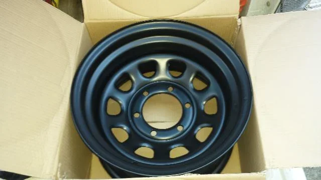

I got new rims! Still need tires but it's a step towards total blackout.
15x8s
BS is 3.75". That is what the spacing is on my current rims. I got these at 4 wheel parts for $56 each. Hard to pass up.
