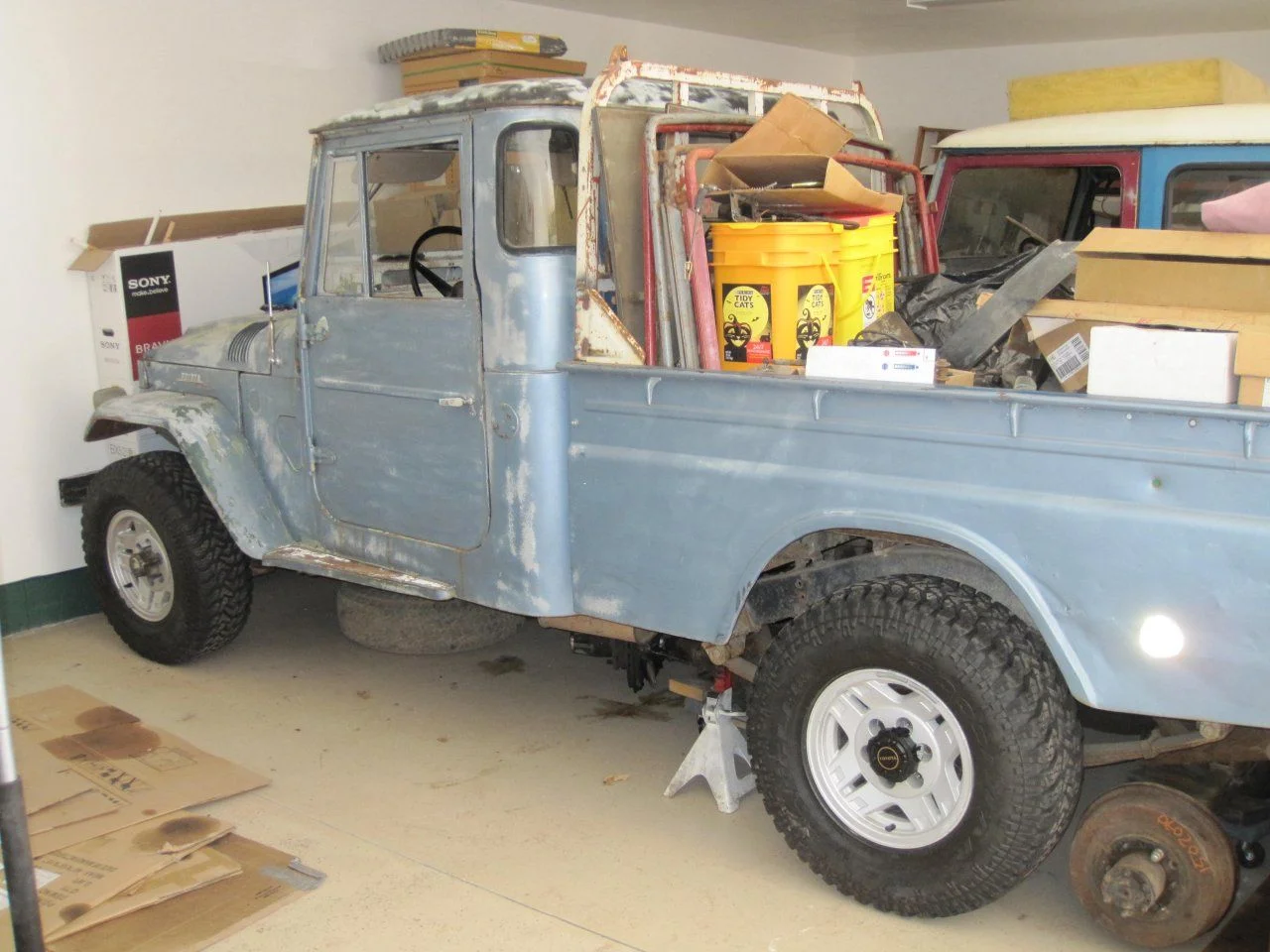

The problem is that the short little hose (very short) with the banjo fitting coming off the caliper goes directly toward the axle and has to be bent one way or the other to clear. No matter how I install the caliper, I will have to do rerouting/bending of the brake line. In the best position for the brake lines, one of the caliper bolts won't clear the leaf springs. So I have done some cursing. The front ones installed cleanly.
@Living in the Past

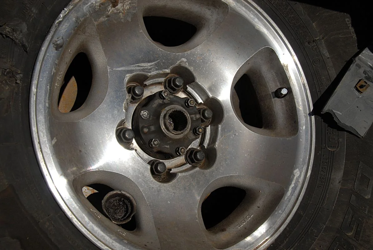

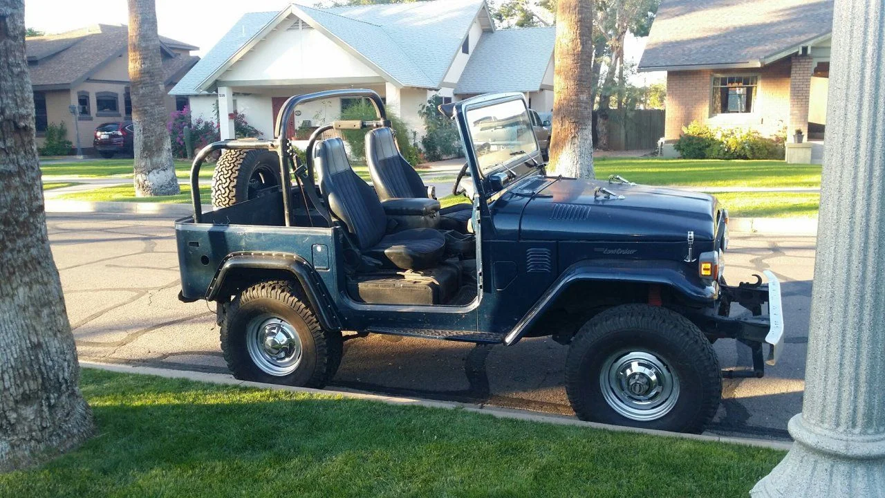

Those 80 rims look really, really good on the 40's!
Checked one of my early rims and found 11/85 production date. Not widely known but the long wheel base versions of the 4X series production didn't end until 4/86 which would make this style period correct. The nineties 16" five spoke rims would be easier to install just don't look right. Now wondering how the standard 3rd gen. rim would look. Closer to the eighties and came 15" and 16".
EDIT: just looked at my old 3rd gen. standard rims and don't think they would look on any 4X series. Vote still goes to the eighties aluminum rims.

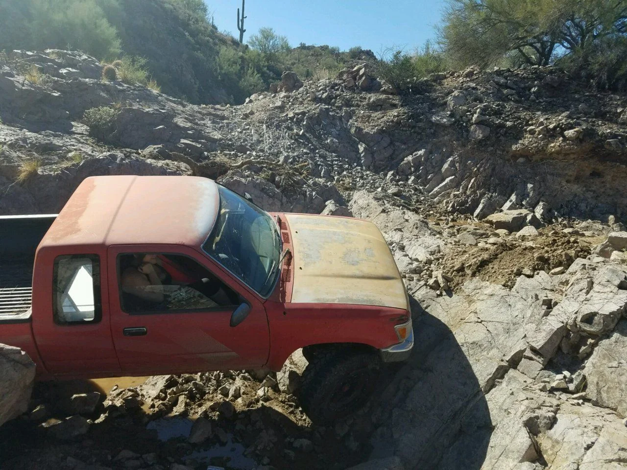

Geez, that took a solid hit, glad nobody's hurt.
