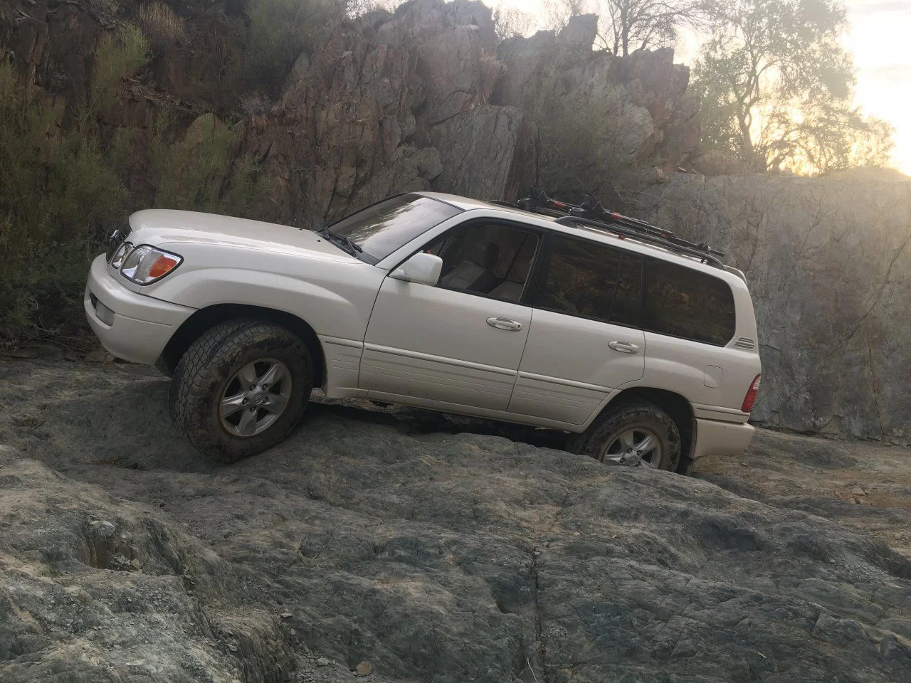

Well....... you guys nailed it. Rough day wheeling. ☹️

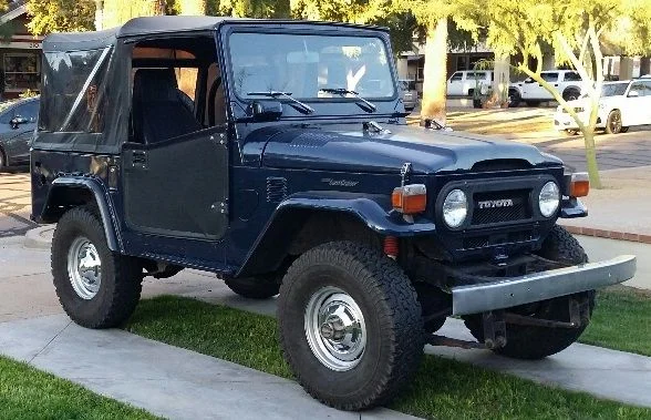

I actually got lucky back in the 90's and found a 72 tub in a salvage yard. Since the 69 tub was in really bad shape rust (etc), I put the 72 tub on the 69 chassis, so I have the later pedal bucket. Everything lined up as it should have.. The only real issue I have had was finding and/or jury rigging the 10mm T's and junctions (Some of it is Rube Goldberg). I think I have enough to finish the job. I wanted all the other hardware (rotors, calipers, master cylinder, booster) on before I finished up the brake line re-do.
That is where I currently am. All the hardware is on.
Wish someone would have told me that I needed new brake hoses. Got the new brake lines in, and duh!, no hoses. Just ordered the set from SOR, so can't finish until they come in. And, BTW, I have installed the rear caliper in 3 different locations, and am not happy with any of them.
