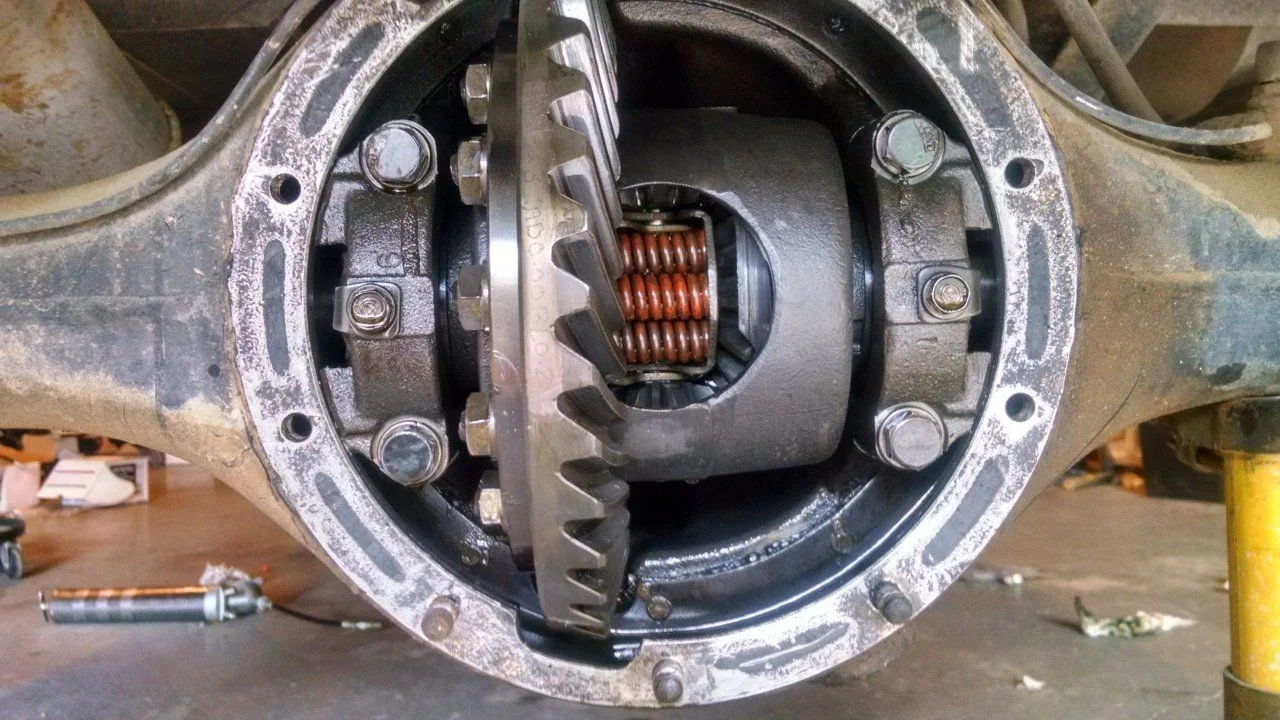

It is a project for an other day, but am considering putting the Auburn in the Piggy, and going with e-lockers on the 40.
I like the factory E-lockers but require a full floater rear axle. For 60/62 series those seem to be harder to find in the US then for the 40 series. If I down size enough might spring for air lockers or aftermarket E-lockers that I believe don't require the long splinebinner axle. Have the long spline inner axles for front and back on the 40 series.

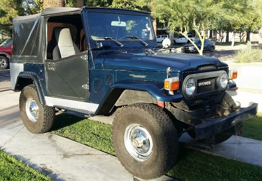

Replaced the broken throttle cable and drove it for the first time. Based on my confidence to get it running, replaced the wheels/tires earlier in the day. (Next: remove diamond plate, paint front bumper, & bezel)
Maybe it is time to replace my avatar ( 3 years and two cruisers ago)

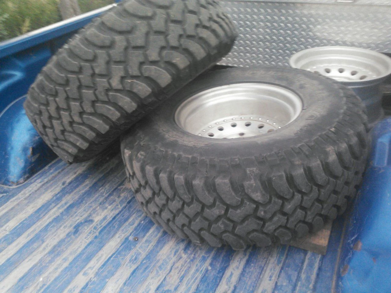

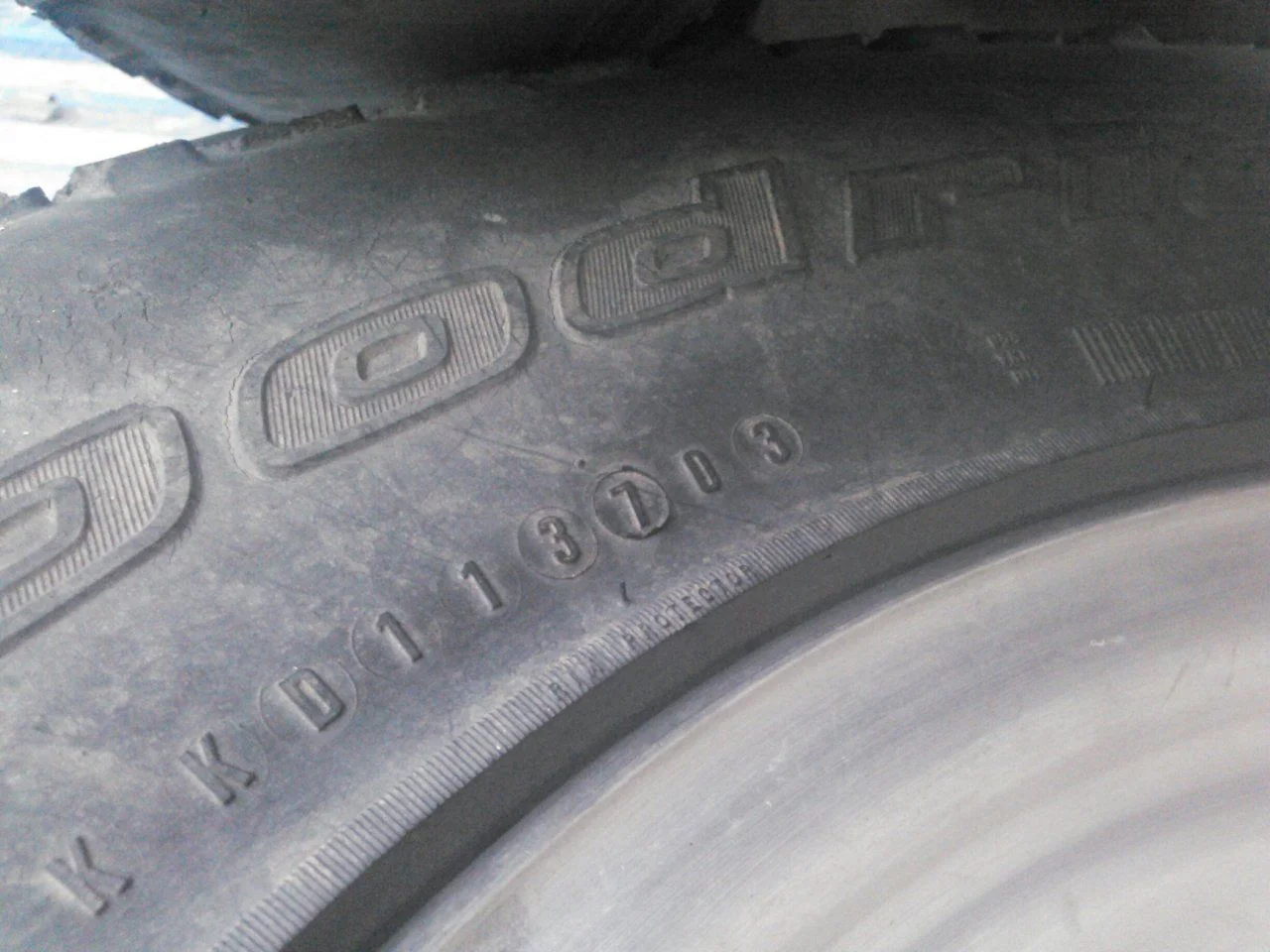

Juggling tires and rims for the 'ol Studebaker trailer to get me to deer camp and back home..
These date codes go back from the 45th week of '97 to the 31st of 2009.
1997 must have been a good year for rubber, they actually have less dry rot than the early 2000's.:hmm:
