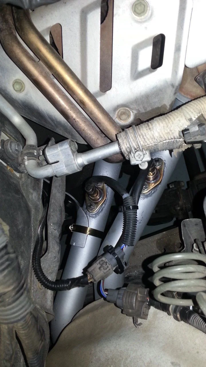

Updated the Y-Pipe to the '96 version with in line cats and needed to relocate the O2 sensors. The '93 is a mixture sampling system with O2 both before the cats and the '96 is a before/after system that monitors the levels into and then out of the cats. Many have just deleted the P.A.I.R. system and used the unused ports for the O2 sensors; I needed to leave the emissions system in place so new O2 ports were needed in each down pipe.
After the conversation with the muffler shop I decided it would be best/easiest to just do the new ports myself. I could put them where I wanted and take all the time I needed to make sure they cleared everything. I decided against just capping the '96 O2 port and cut it off and welded it closed. Anyone need O2 port caps? LOL I have three I did not use. (I needed one but Toyota showed only 3 in the national system so I bought all three. Now I don't need any. :doh:)
Now a trip to the muffler shop to have a piece that connects the '96 cat to the new '93 muffler back stuff.

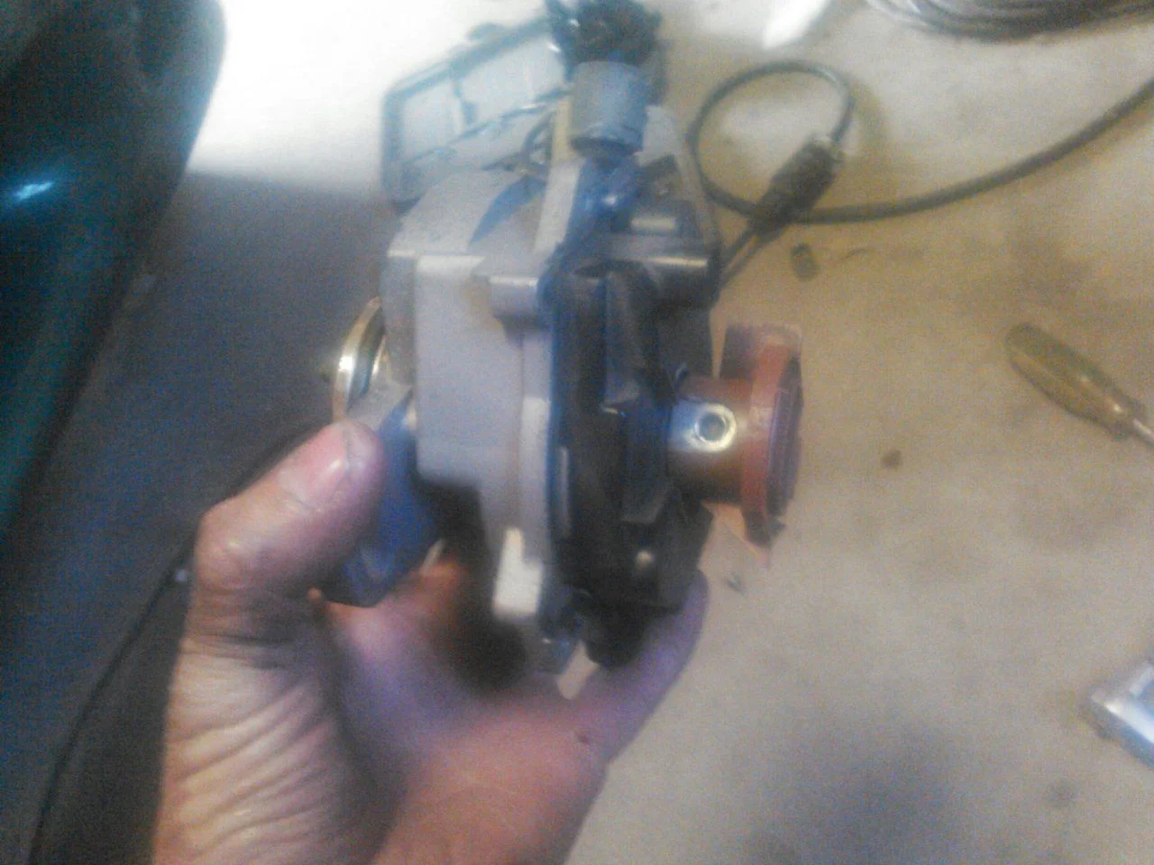

I'm finally getting around to getting the Land Cruiser up to snuff. Finally tackling the EGR error, cleaning and replacing the EGR VSV. I'm also going to take this opportunity to replace every vacuum and cooling hose. I am also fixing the massive oil leaks from the front, crankshaft, oil pump cover, valve cover half moons and distributor. I have it all apart only to discover oil in the distributor housing, an internal leak. :frown:
Everything I've read is the distributor housing shaft can't really be service. BOOOOOOOO!

I went through the whole oil leak process you are doing a couple months ago, it is not bad just takes time and the RIGHT #3 cross point bit for the oil pump housing screws. I also did new water pump, thermostat, Radiator, fan clutch, hoses, belts and pulley's because "ya might as well while you got it all apart".

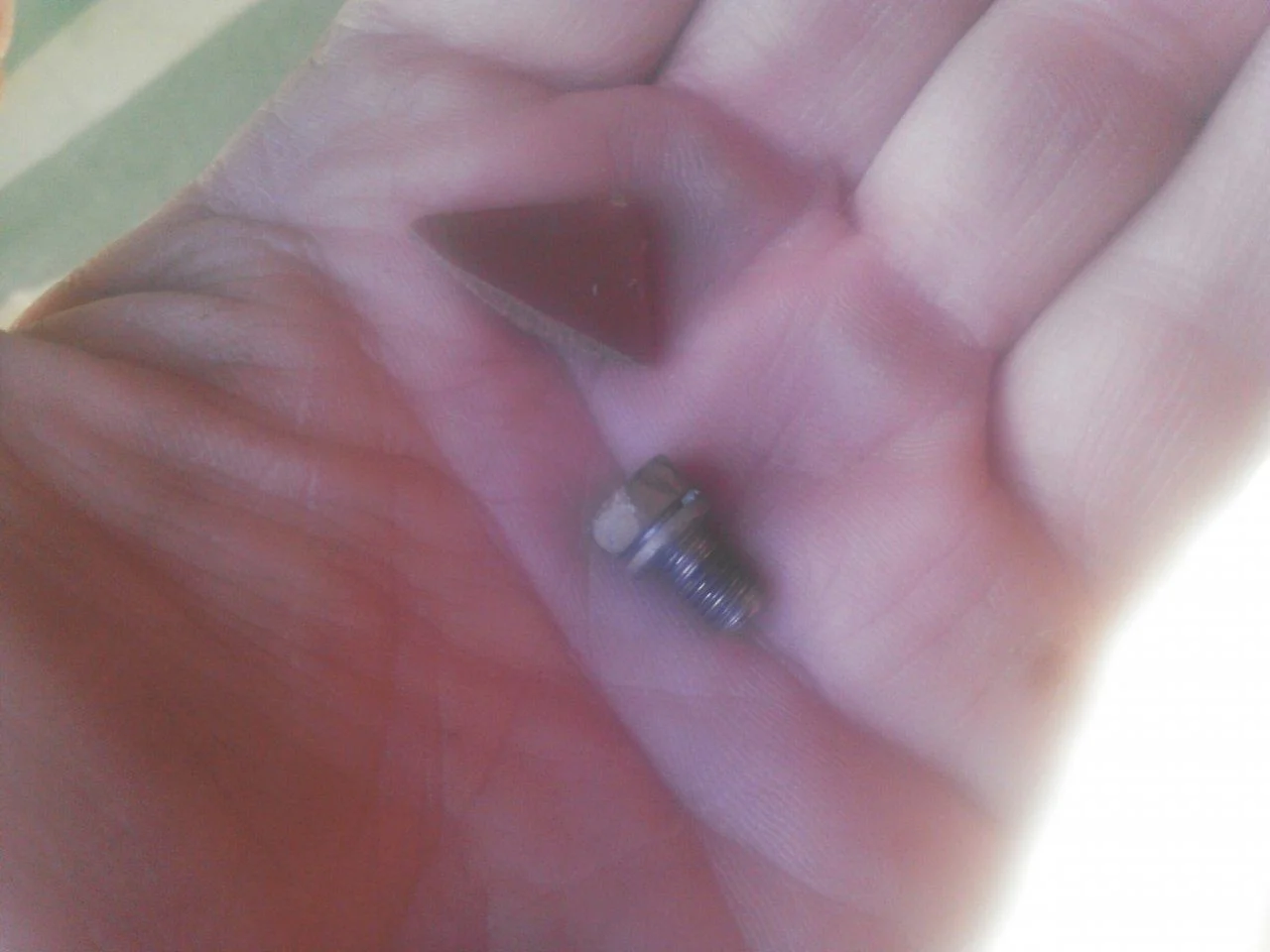

Off topic, but found the issue on the kid's Nissan...
Added to the "never heard of this happen" list.
lost the rotor retaining screw in the dizzy.:hmm:
