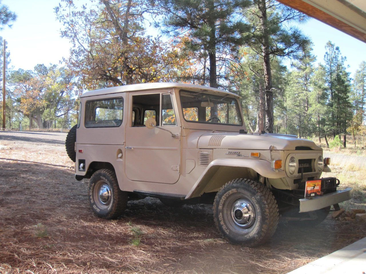

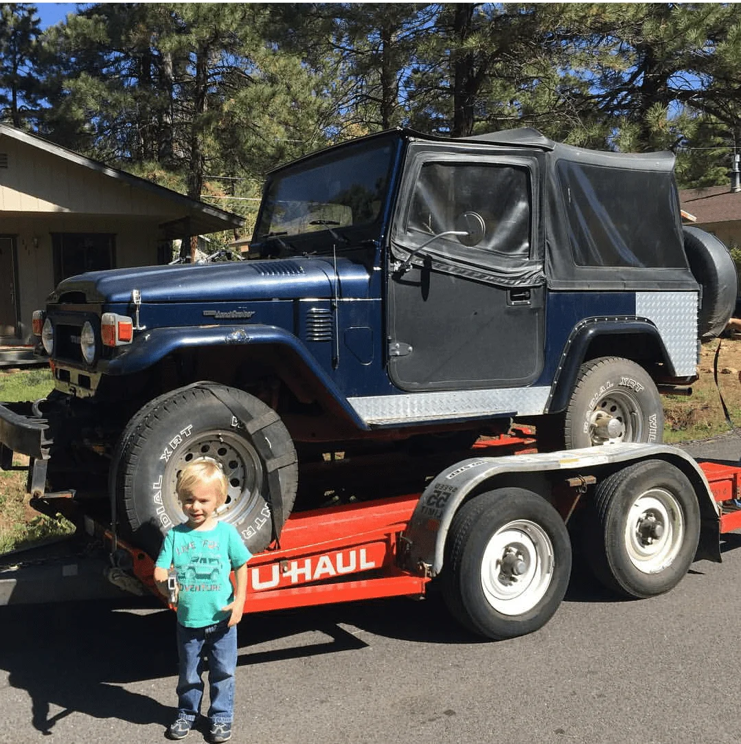

Bought it and towed it home (without event which is a first for a return trip for me).
1976 FJ40
Original Drivetrain with LOW miles
Even though all the diamond plate it is 99% rust free (one spot on the fender)
My plan is to take off the diamond plate, sell the soft top, and get a set of OEM wheels & caps with BFG 33x10.5 wheels and drive the heck out of it this fall & spring.

Did you sell your fj45?

Score!:cheers:
D-plate was the cool dumb thing to do back in the late 80's early 90's (I fell into that trend). Give it some time, it may grow on you, I have a couple of boulder scars in the corner panels that go unnoticed with the aluminum.;)
Murph, Yes, the FJ45 is in Denver now (which was one of many calls from about 4 different states)

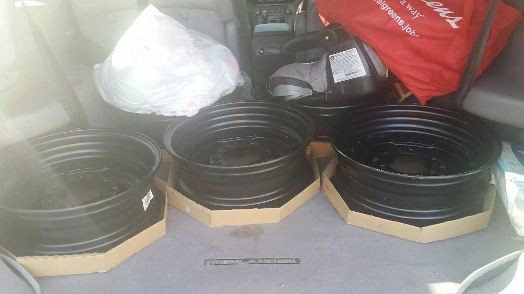

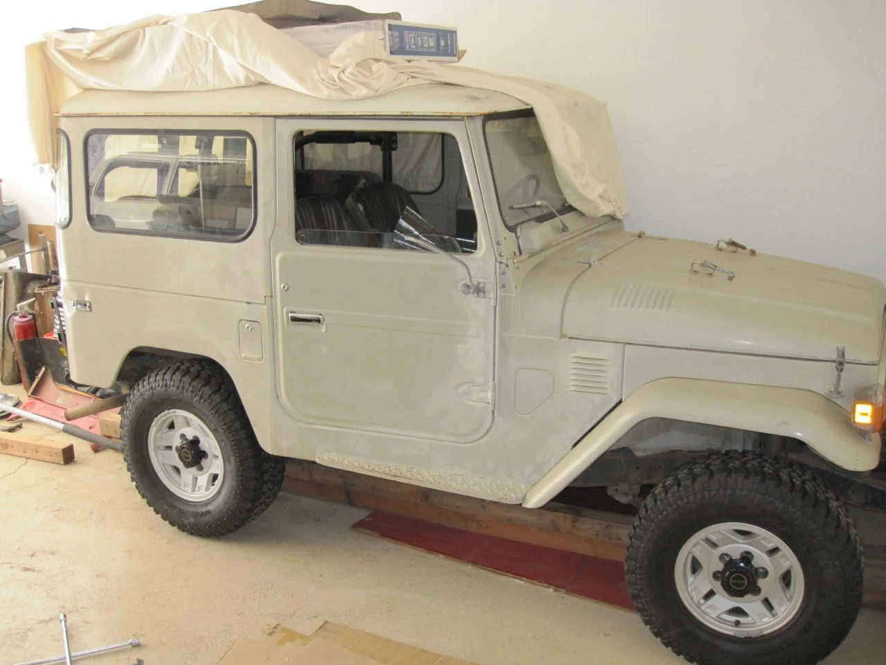

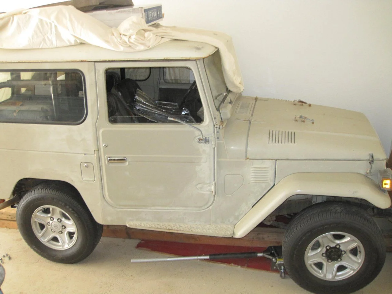

Finally spent some time trying different rims out on a FJ40 and my FJ45. The three generation 4Runner rim being 16" and shank style lug nut will fit the 76 disc brake axle with only a 1/4 spacer. Plenty of threads on the lug. The 80 series being 15" and tapered lug nut will require at least a 1" wheel spacer.

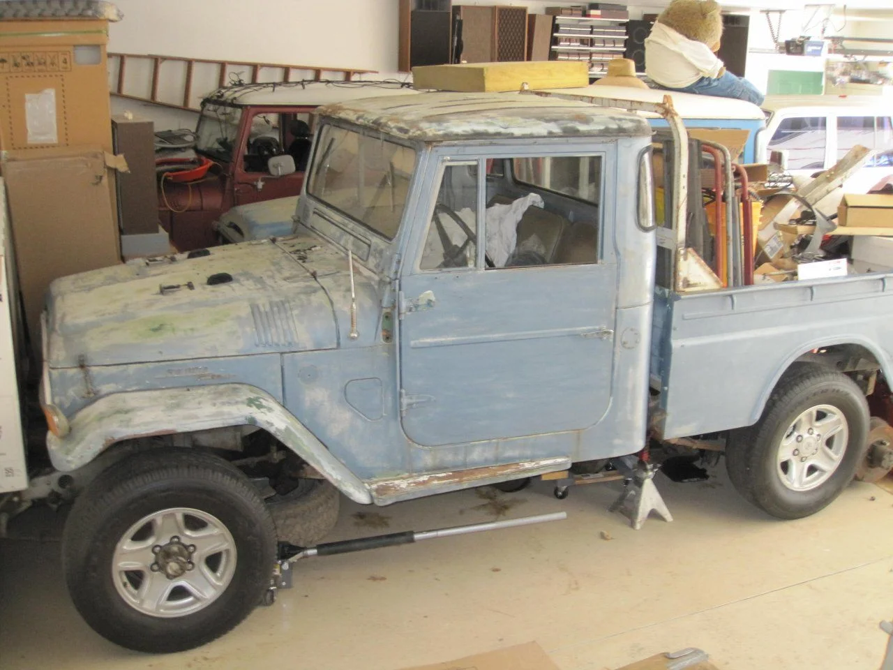

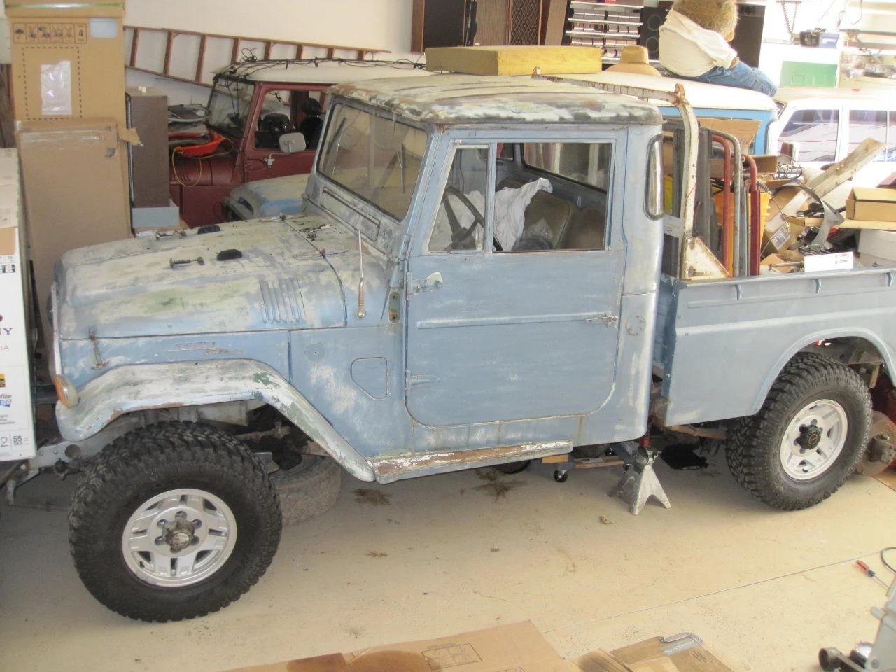

The FJ45 is doing just find. Much better climate for storing it then the valley. Tracking the temperature the in the garage it's around 80 in the summer and stays above freezing in the winter. You can see the full floating for it behind the rear wheel. What you can't see is the H41 split transfer case with hand brake in the bed and disc brake axle underneath. More goodies in the valley.
