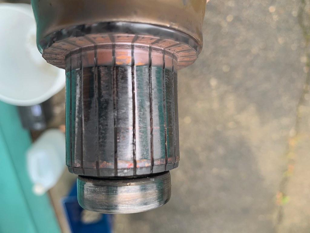

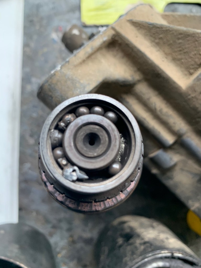

90 HDJ81 with a no start situation. Troubleshoot a bunch, pull starter - this bearing on armature has seen better days...
Frozen solid.

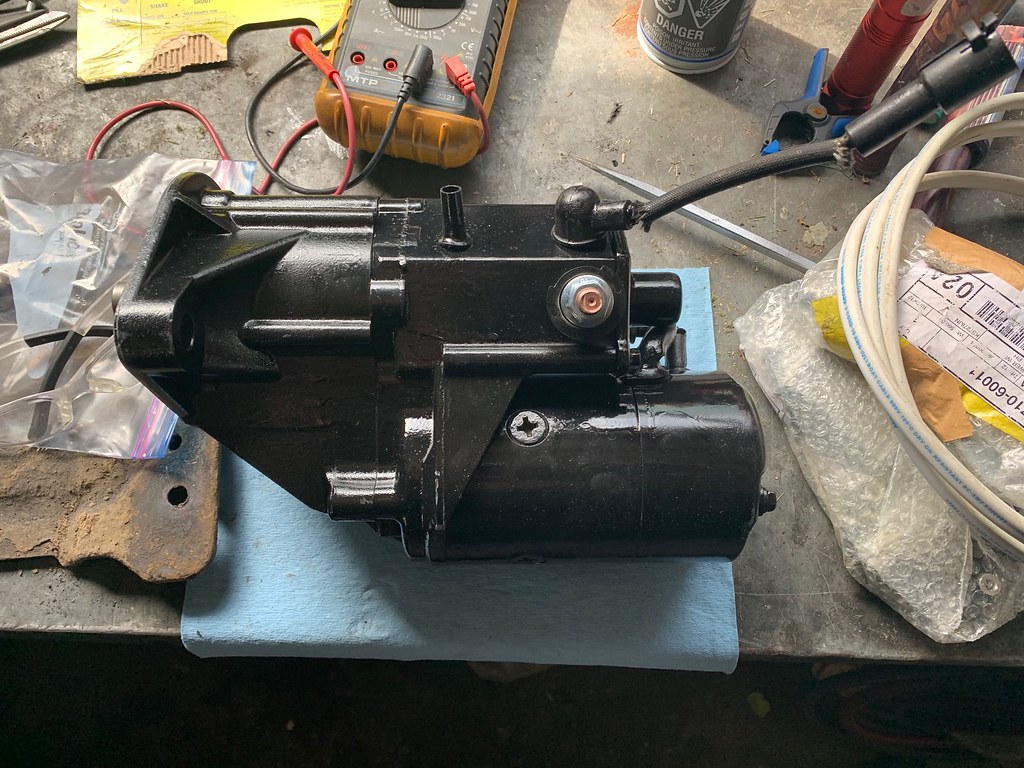

Took to old school auto electric guy who fixed some commutator open connections, replaced bearings, new OEM contacts, plunger, brushes, drive clutch etc. Got back this
Installed, held breath.... and still no start :bang:
Gnashing of teeth, more troubleshooting - long story short: Neutral Safety Switch.
