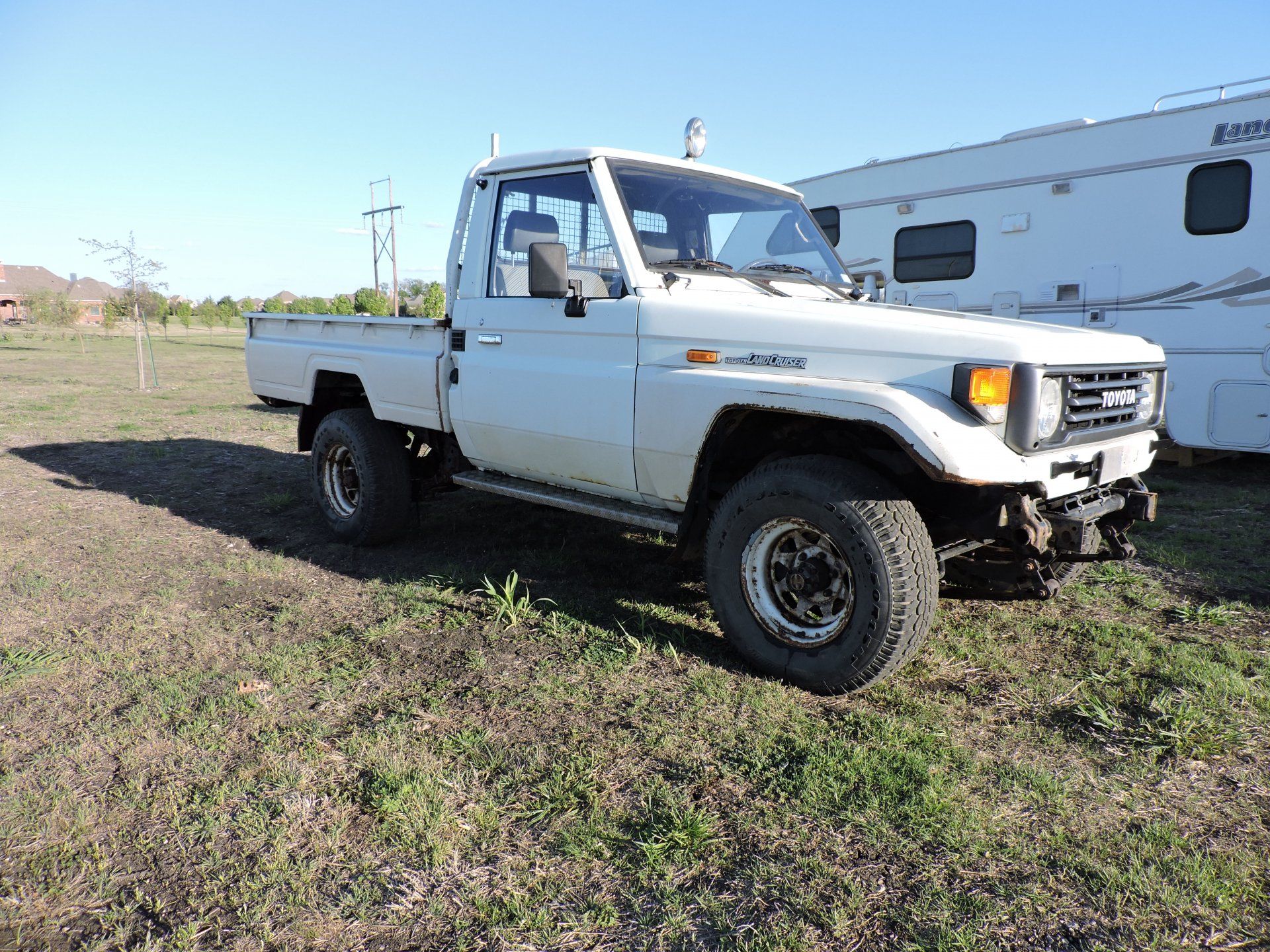

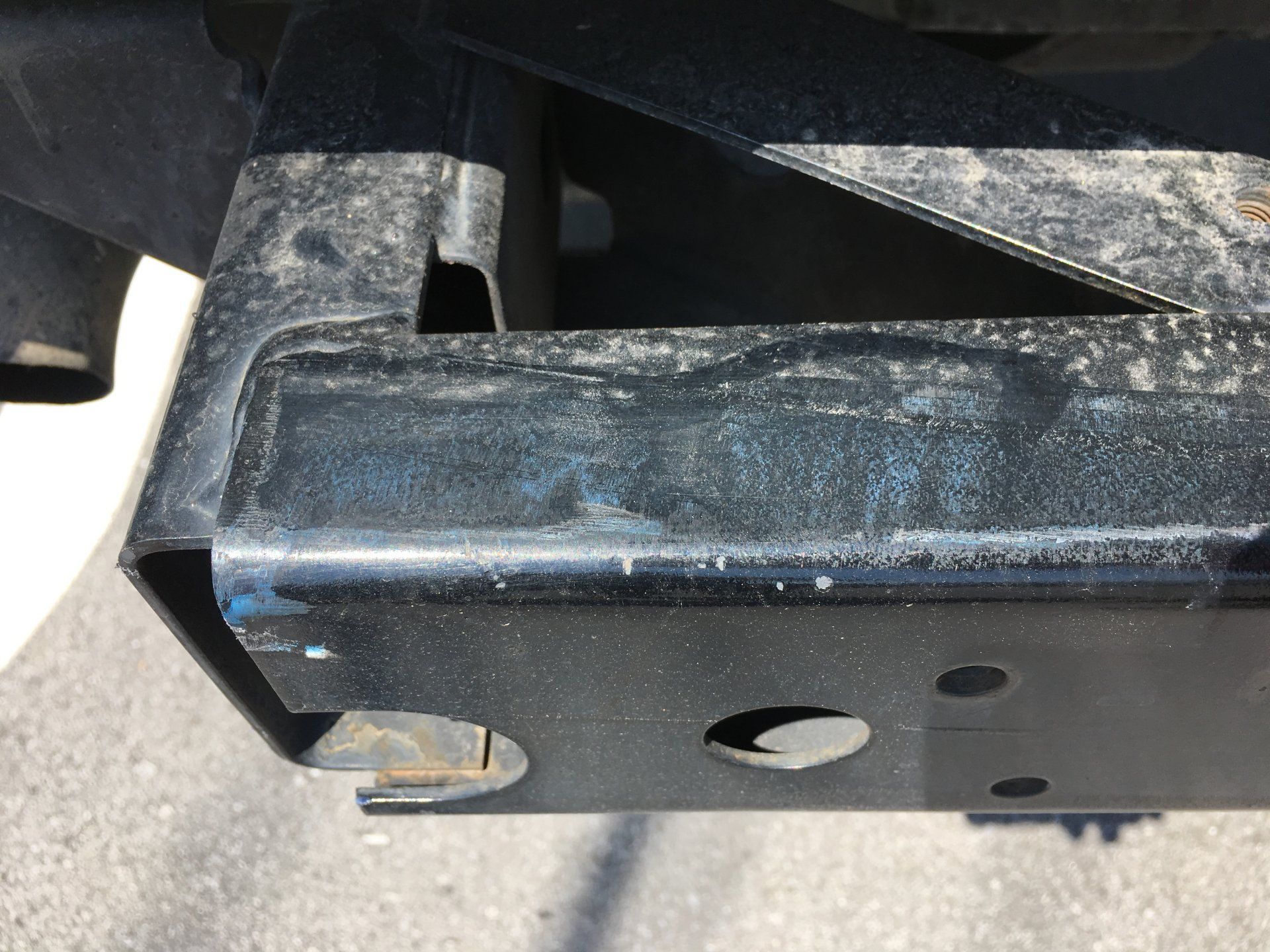

Son of Toyota.... this guy tries to rearrange the rear of the cruiser....
Just a little paint transfer for me. Him not so much.

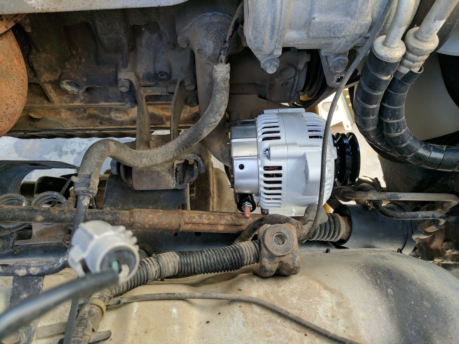

View attachment 1455349 View attachment 1455348
Pain in the butt replacing alternator... Must be origional as the bolts were a pain. Had to remove the intake to beat the s*** out of it with a pry bar and mallet. New one slide right in.
Nice work dude. I take the exact same photo of any part that gives me trouble when I finally get it out hahaha
