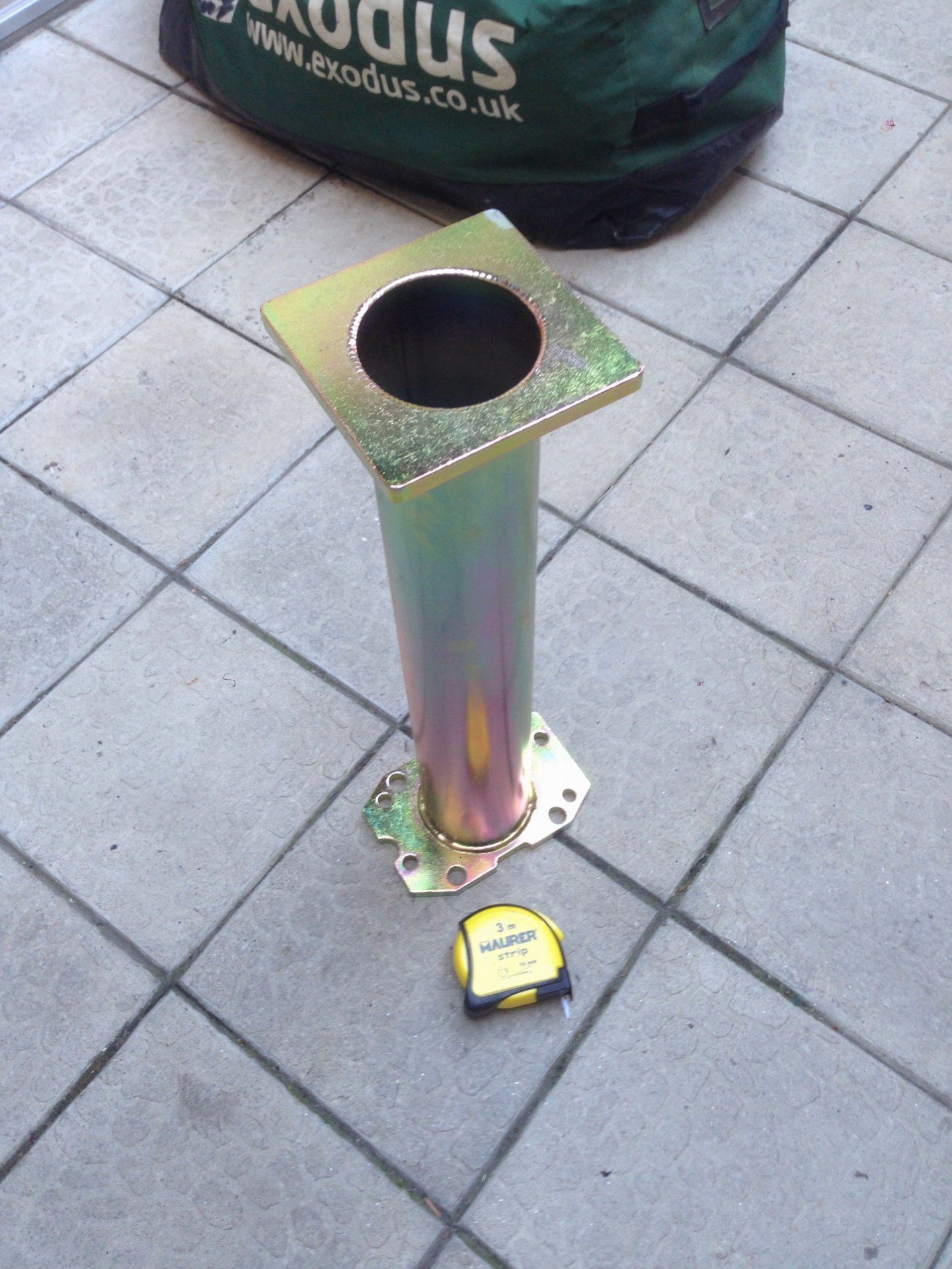

Changed rear axle bearings and seals , followed by brake pads. Self adjusting mechanism seemed bit erratic and I had to open the drums few times after checking temperatures with an infrared thermomether .Toyota Italy gave me TRW pads as oem.
Shiny tube is sst to depress the driveshaft on lightduty axles, in Europe can be purchased from roughtrax in Uk.
