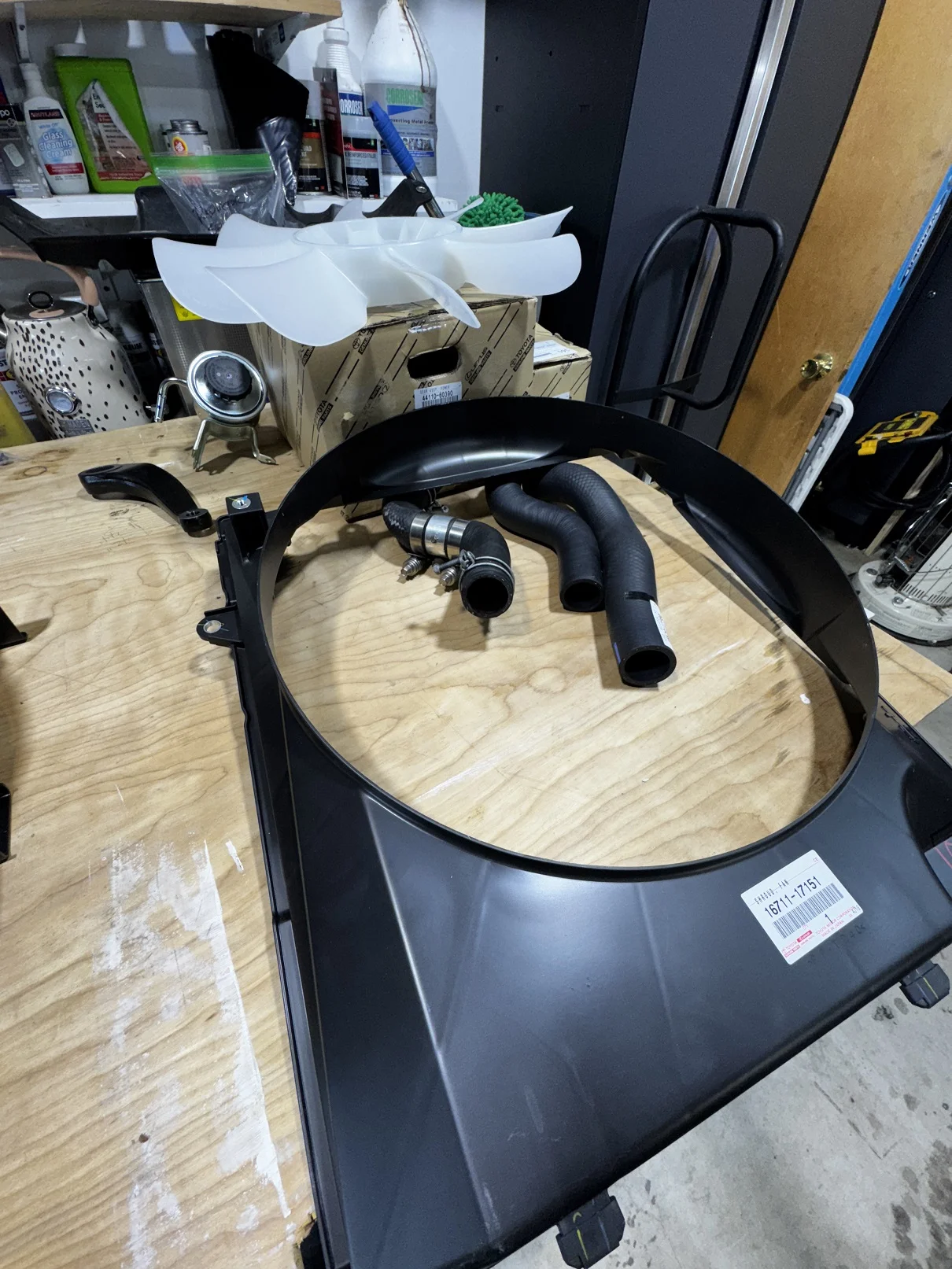

@Guyute is the shroud deeper than the OEM? Looking really slick now dude.
Thanks, Man.
Not sure on the depth comparison. Had the earlier metal shroud and it had been ugly modified at some point. So knew I'd be replacing. The TT radiator is a little longer and wider and the shroud holes didn't line up for me. Was also worried the yellow dot fan wouldn't fit. Fan is about 1" wider. Didn't take many pictures comparing. Fan tucks into the shroud the same as my old set-up though.
Found these.
Old shroud w/ new radiator >

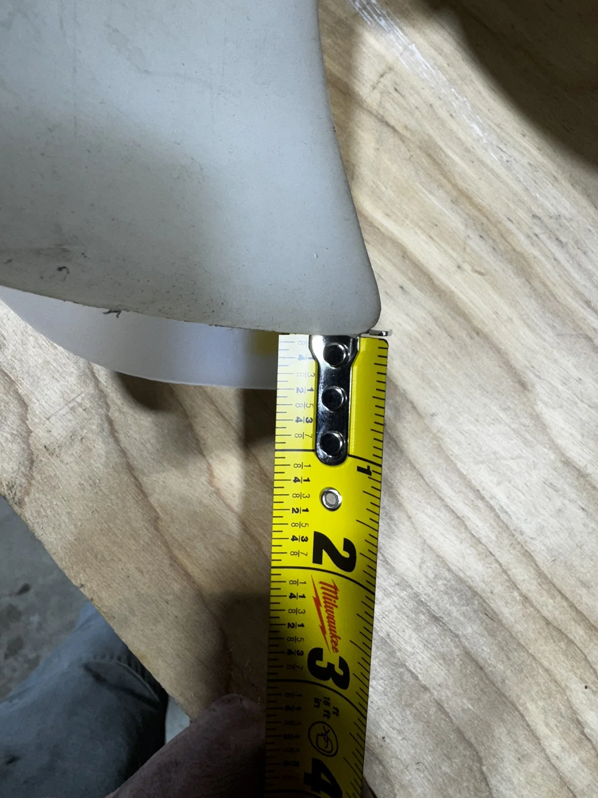

Trimmed a wee bit for the lower radiator tube, cut those tabs off. Also made brackets to hold the shroud's center section snug to the HD foam seal.
1/2" x 8 = little more better

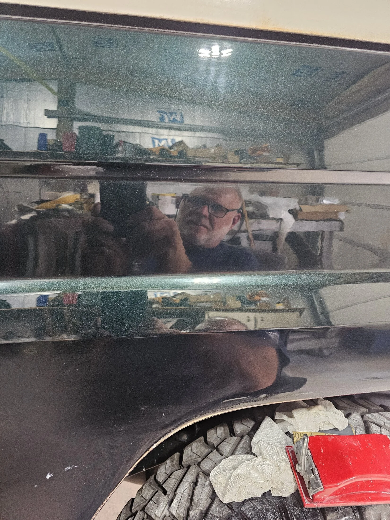

Started the cut and buff on the paint. Not going crazy on it, but leveling it pretty good.
Looking better and better!

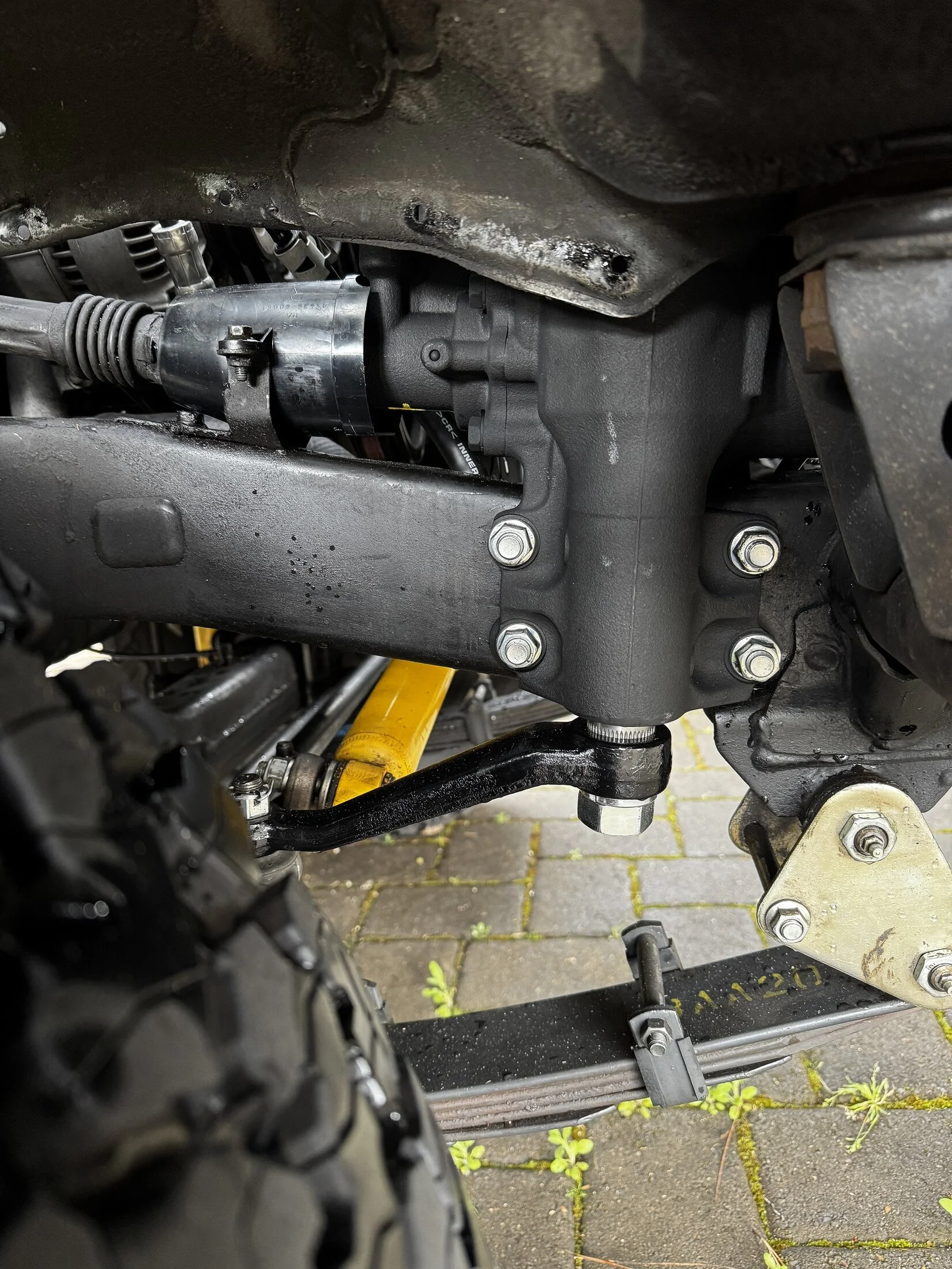

PS refresh: New gearbox, hard/soft tube assy, pump, reservoir, hoses, clamps, nuts/bolts
PS fill/bleed was great fun. Ended up spraying the area with ATF when my janky bleed bottle overflowed.

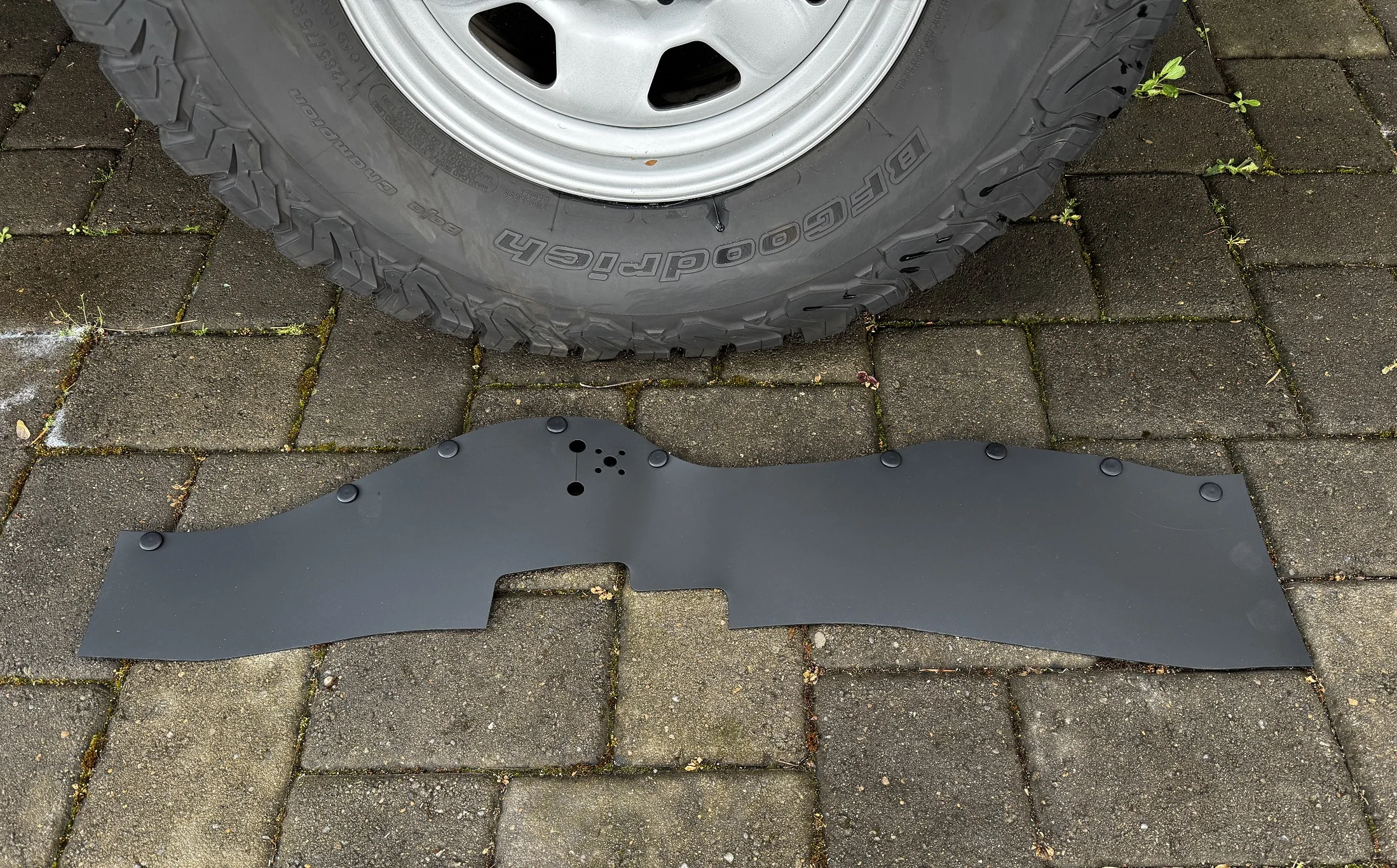

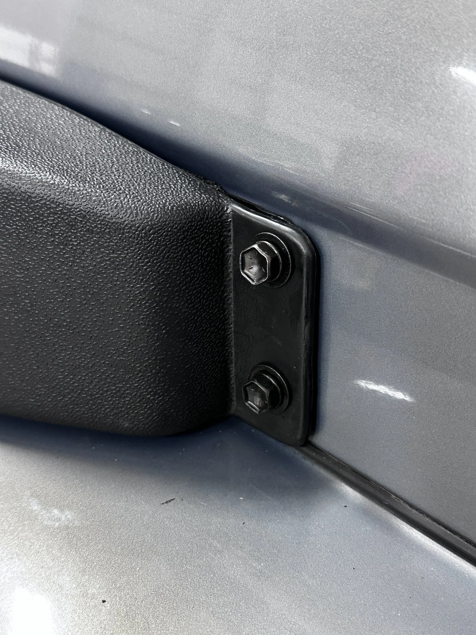

Several test drives with no leaks. Hope I didn't jinx myself but, installed new aprons on both sides to end my day.
