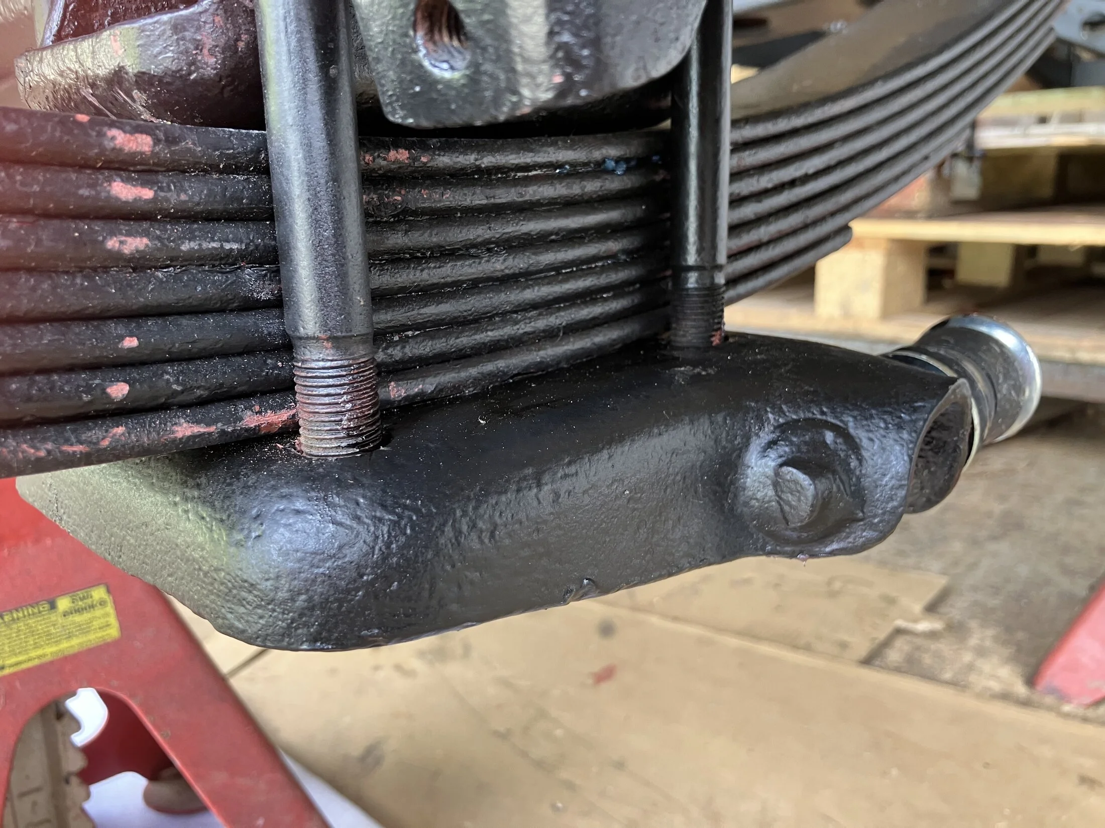

Front axle in and on. I couldn’t fathom out why the U bolts were not protruding more through the base plate.
There are two lengths it seems. 200mm and 210. It would also seem I have one more leaf in the spring set up than standard. I can only think that the nuts securing the base plates were standard nuts and not the tall flange type used.
To add more quandary there seems a spacer plate is missing ( even when I look at the pre dismantling photos).
This spaces the nut and bolt through the middle of the springs avoiding interference with the transaxle and base plate so they sit flat. It seemed ok without.
So I’ve just machined a cap head bolt to fit , and no interference. It all now slots into place.
Having measured the axle distance to the front chassis bar, there is 1mm difference…..I’m happy with that!

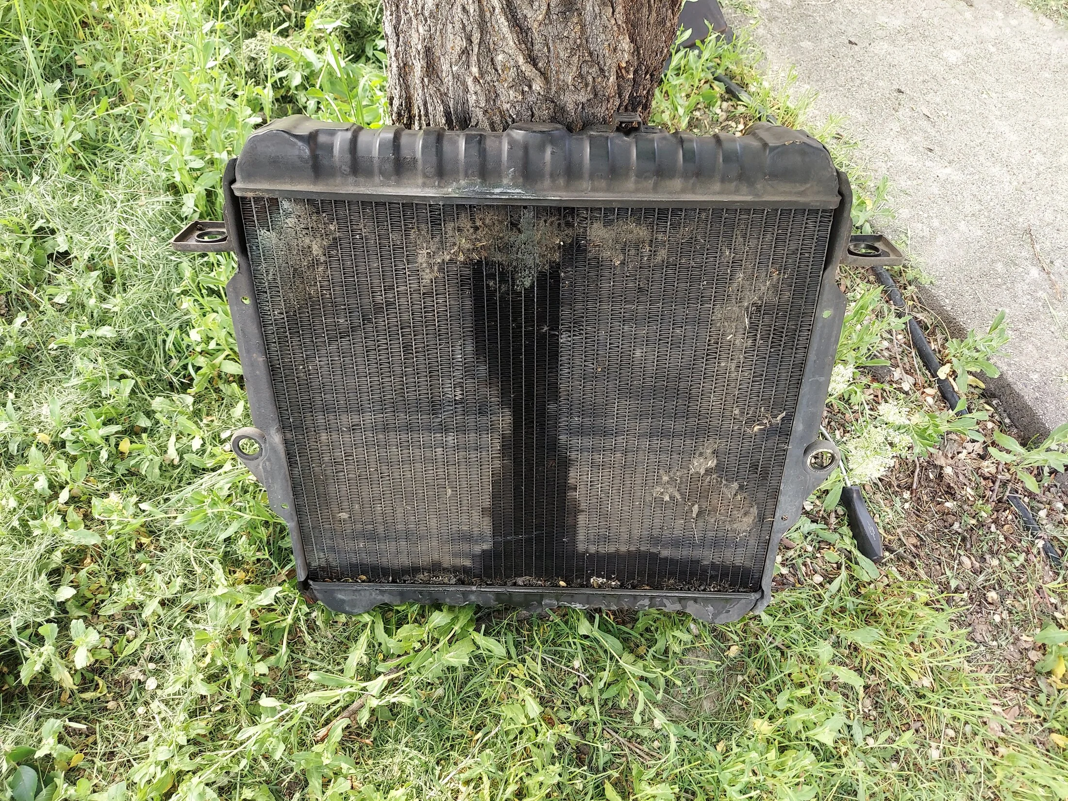

Leaking radiator pulled. It took about 2 1/2 slow-paced hours.
I nicked the lower valance when the radiator shifted on me as I was lowering it:doh:
That's the only scratch in the truck.

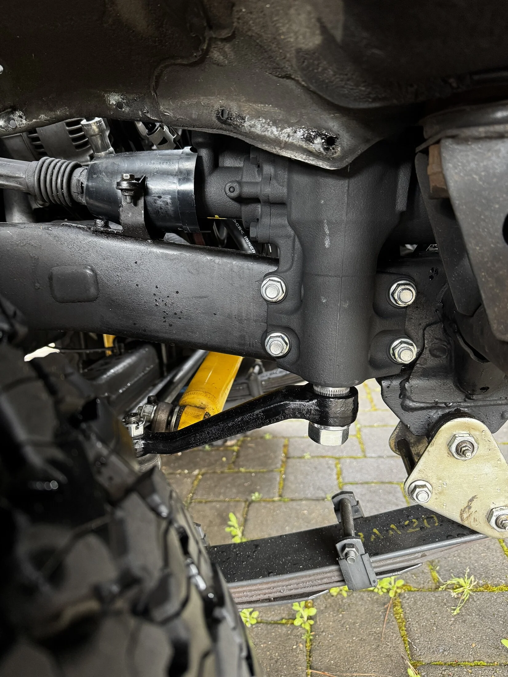

Cooling refresh: New Terrain Tamer AL radiator, top tank temp sensor, yellow dot fan, 1HD shroud, new T-stat and hoses/clamps
PS refresh: New gearbox, hard/soft tube assy, pump, reservoir, hoses, clamps, nuts/bolts
PS fill/bleed was great fun. Ended up spraying the area with ATF when my janky bleed bottle overflowed.

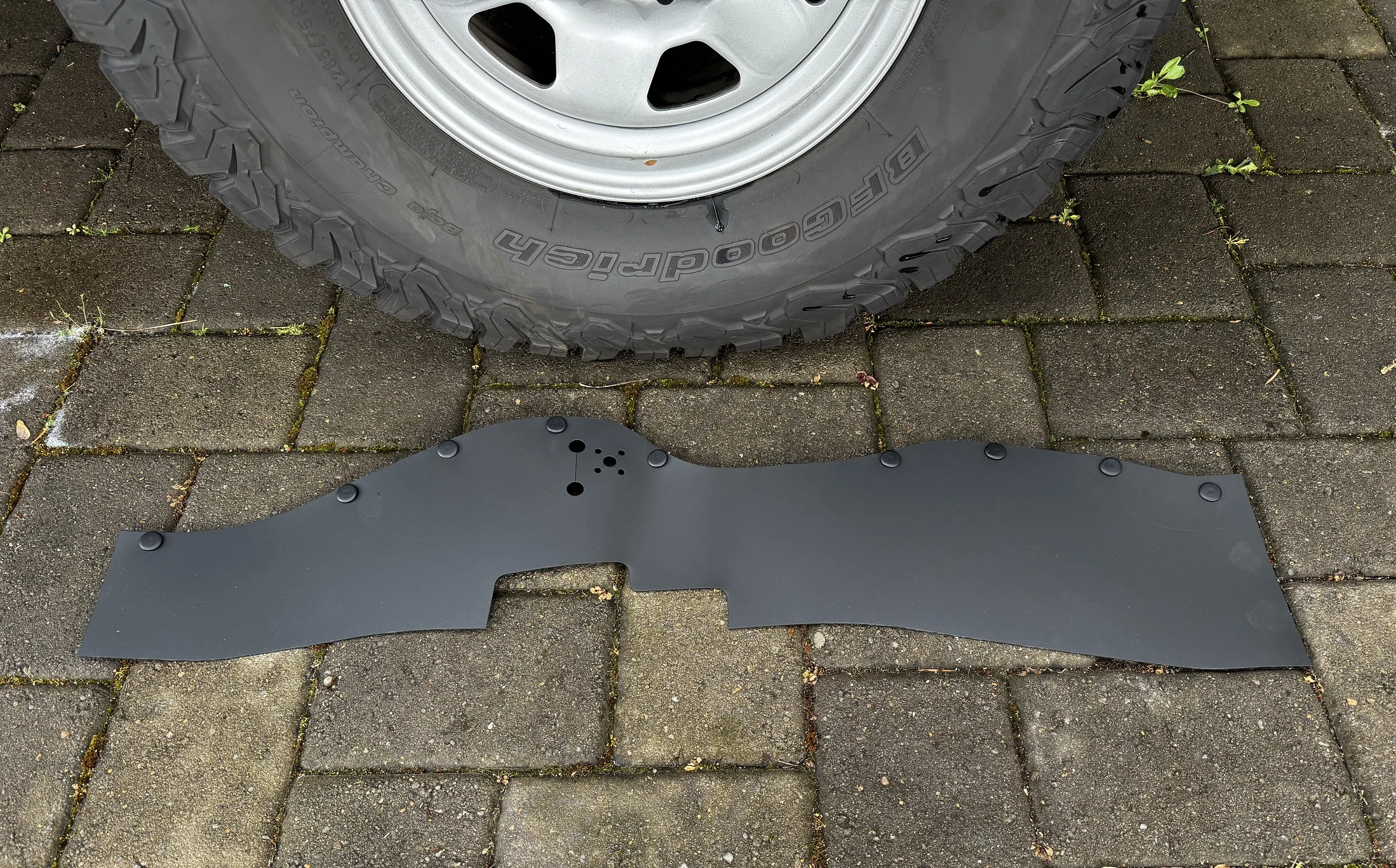

Several test drives with no leaks. Hope I didn't jinx myself but, installed new aprons on both sides to end my day.
