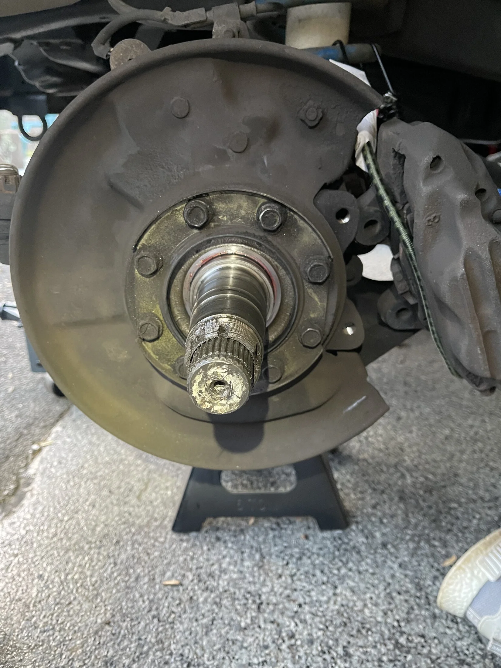

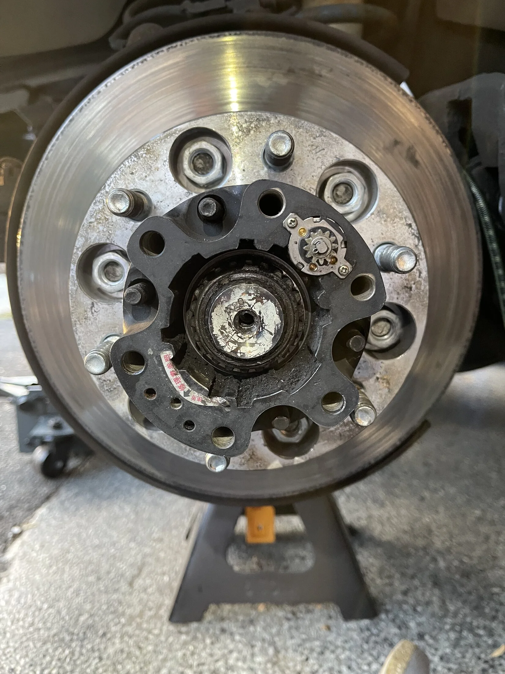

Thank you to @AirheadNut for confirming my wheel bearing was bad and to @cruiserdan for recommending Cruiser Outfitters for the parts. I called less than an hour before close on Friday and they made a custom kit for me to do just the front wheel bearings on my electric hub Kzj78. Package arrived on Monday too.
I used this thread: LJ78 Prado Axle Service How-to and these videos DIY toyota landcruiser 70 series front wheel bearings , 70 Series Landcruiser - How to Repack Front Wheel Bearings for references. The package from Cruiser Outfitters also came with a great print out of how to do everything.
Took way too long to do this side but it was a first for me.

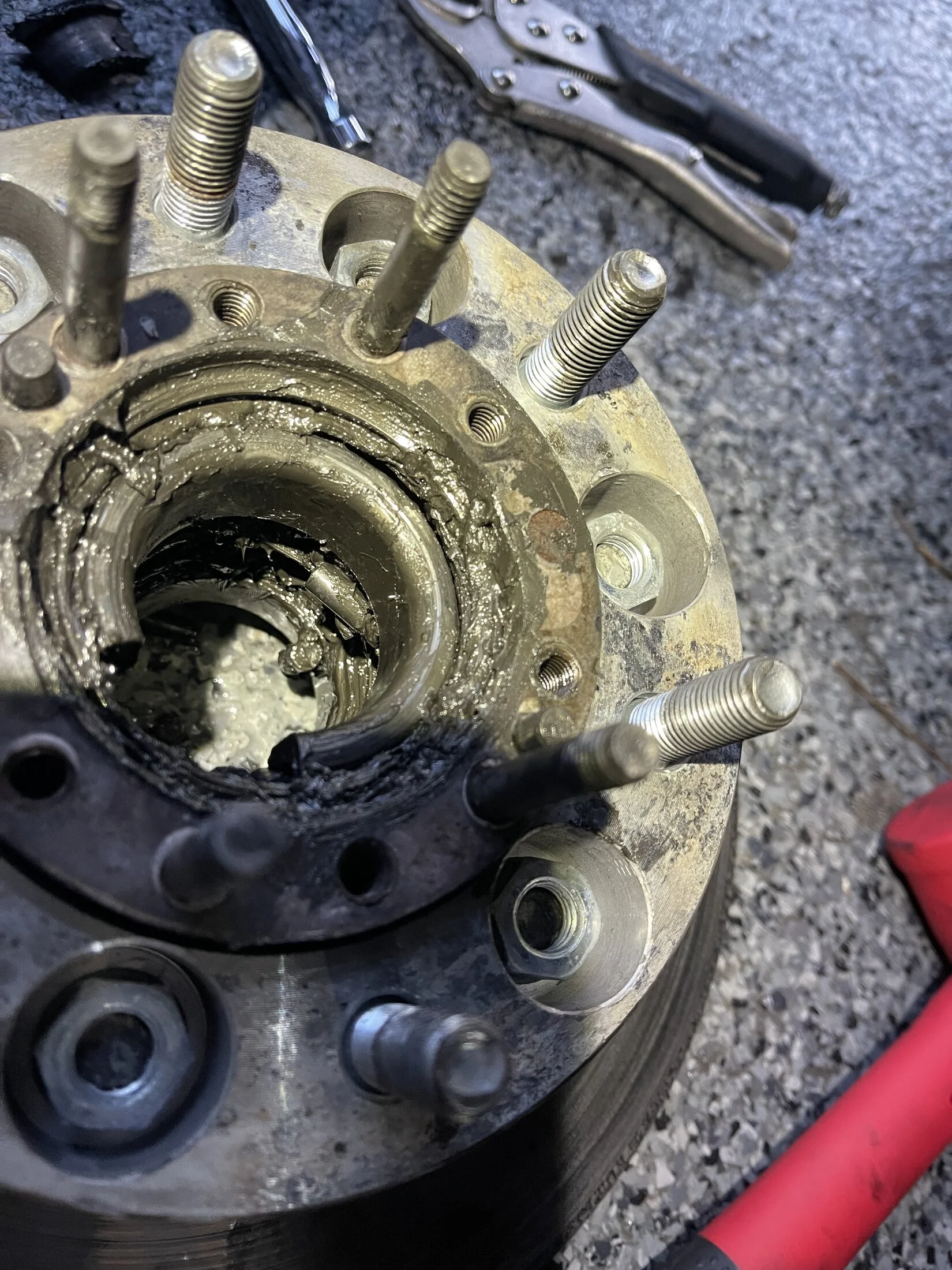

The keen eyed of you will notice loose rollers sitting here. This is right after removing it. The inner race of the outer bearing broke but was holding its shape while on the spindle. This was probably the noise I heard hahaha.
I always thought the cruiser just had squishy brakes when we bought it. They’re so much firmer after replacing these parts and it actually brakes like a new car. I was able to move the rotor by hand before this and we’re all good now.

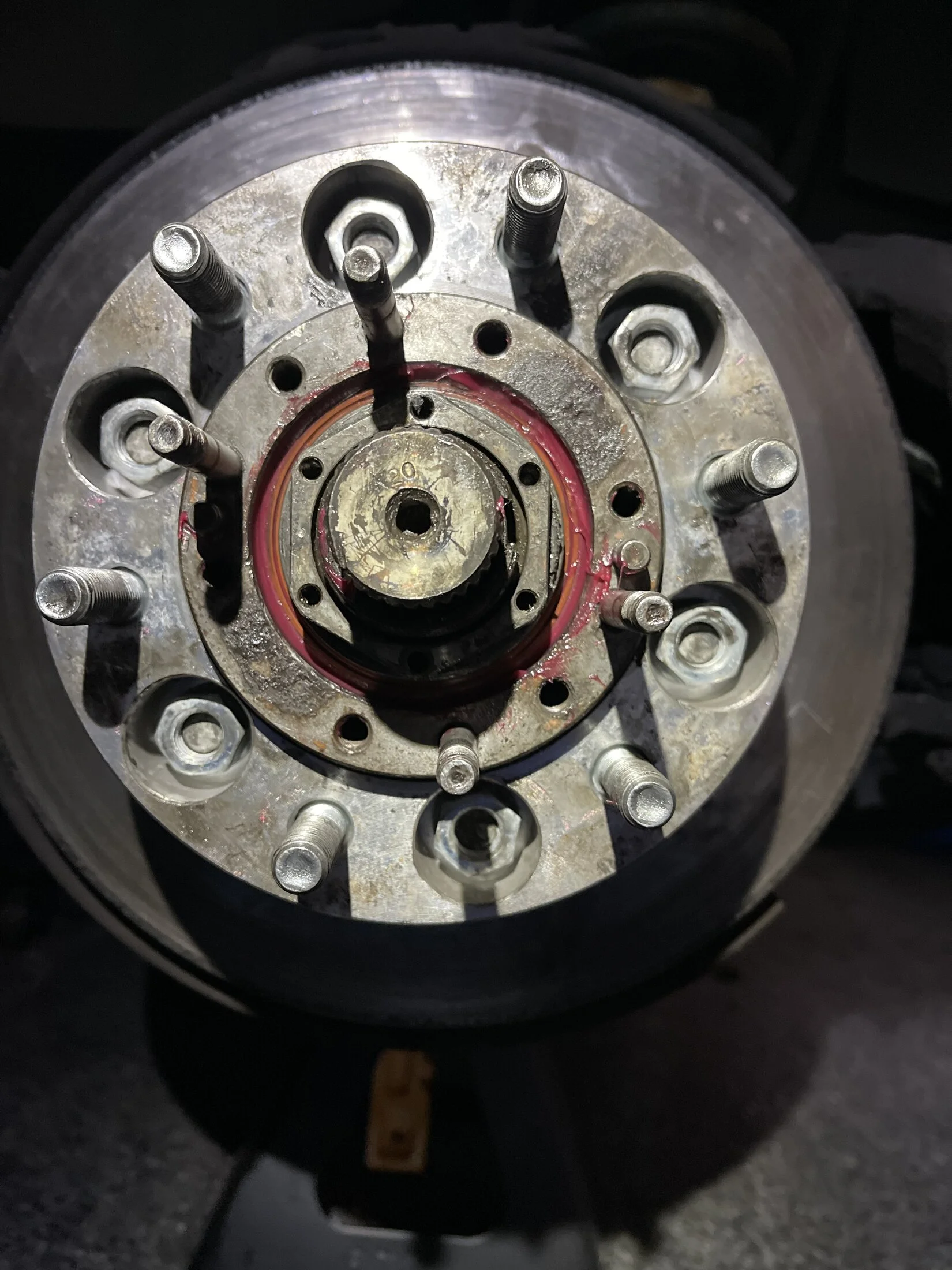

Took way too long to do this side but it was a first for me. View attachment 3870799View attachment 3870800
View attachment 3870801View attachment 3870802
Do your wheel spacers have enough thread engagement? Pics make it look it lil sketchy.

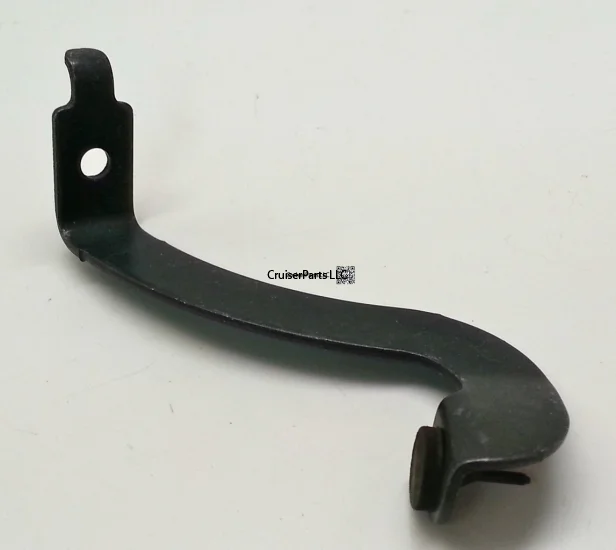

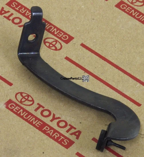

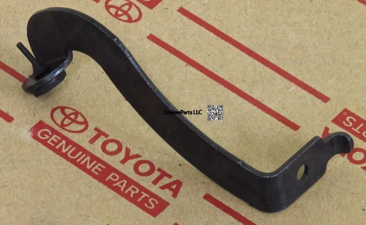

Put the das back in. New glove box door. I’m missing the one little thing that makes it all function. Anyone got one of these little buggers. Or is someone willing to fab me one? Door stop arm.
55556-90K01. As close as your local dealer.

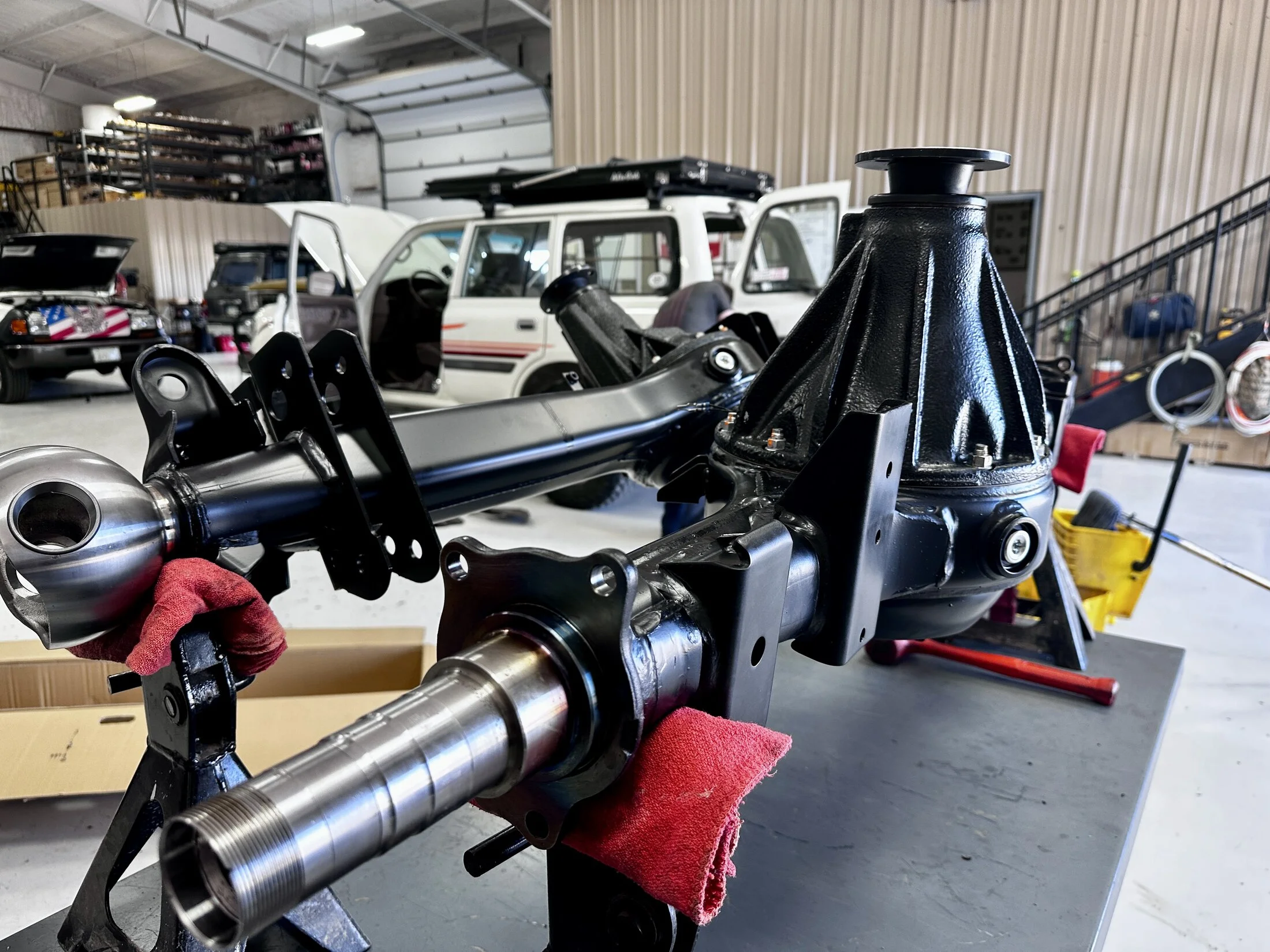

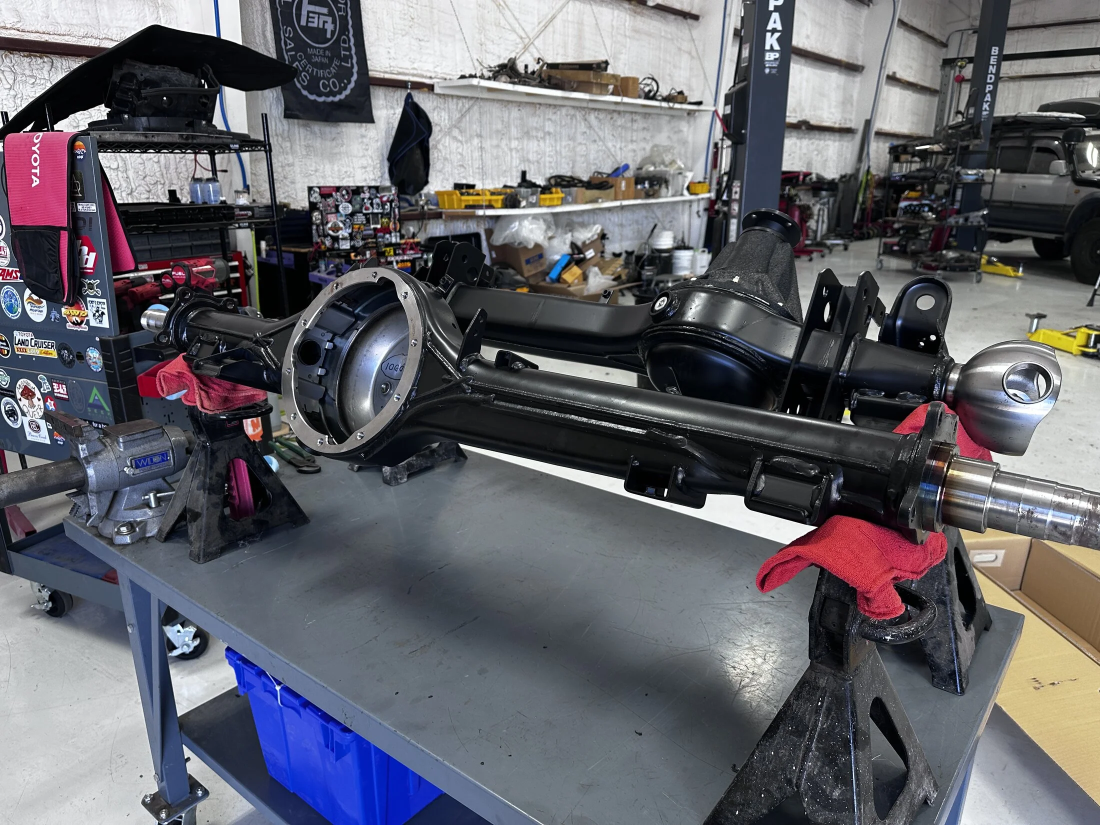

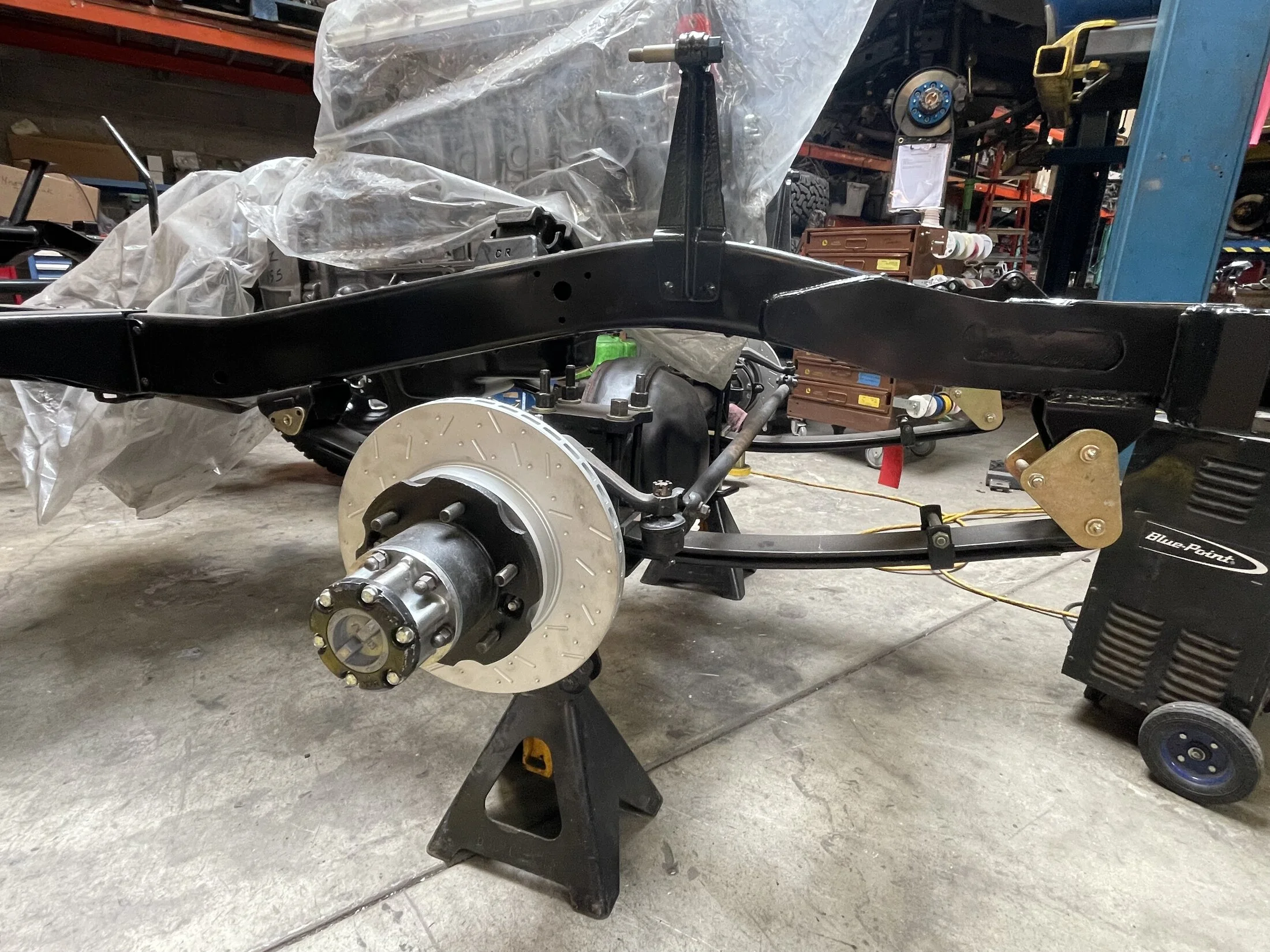

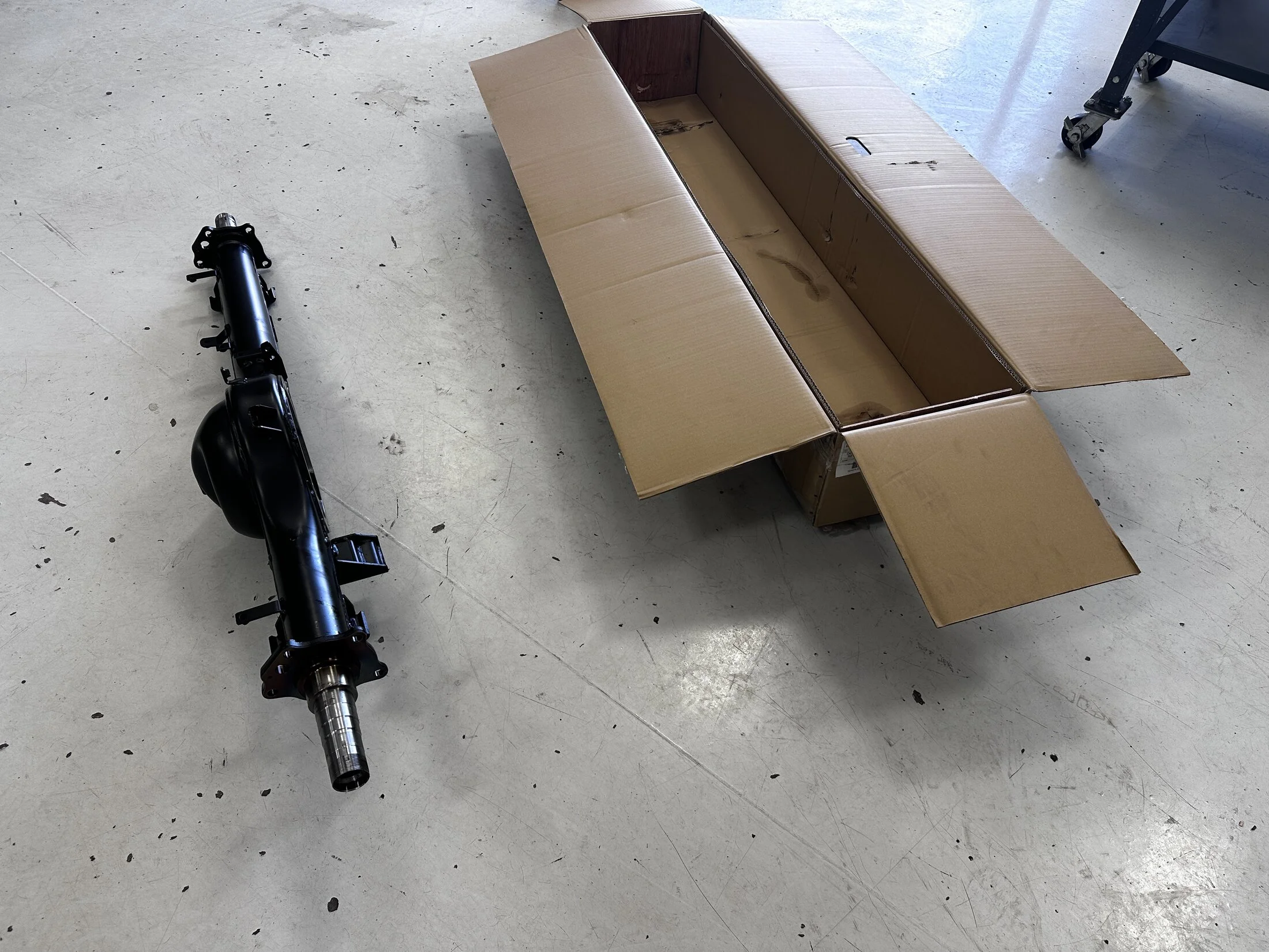

We are building my son‘s first car here at the shop. It’s a 1959FJ 25 with 70 series axles along with an H55F 5-speed and split case.
We decided on the 70 series axles because we wanted disc brakes in the front, 9.5 inch diff front and rear as well as a full float rear axle with drums and incorporated emergency brake.
The primary purpose for this vehicle is so it can be a daily driver, as well as driven to any destination, for camping, offloading, or whatever other purpose, and then driven back.
Since we are building this car from scratch, everything is being fully rebuilt. The vehicle will run 33 inch tires and a set of the terrain tamer parabolic springs and suspension components. Given the tire size and engine and transmission combination, we opted for 3.70 differential gears along with Harrop electric lockers for their simplicity and ultimate reliability.
Both axles were rebuilt using Terrain Tamer components; knuckle kit, diff rebuild kits, lockers, wheel bearing kits and upgraded brakes.
Here are some pics.
