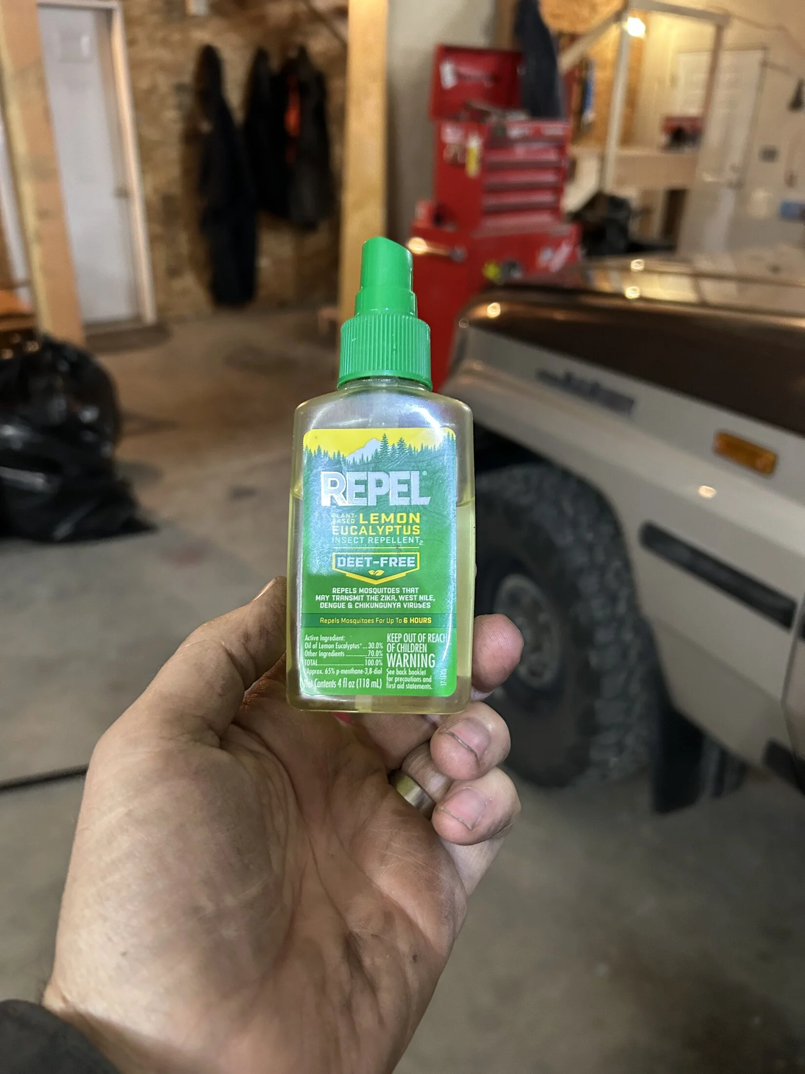

Had to kill some time waiting for FedEx guy to deliver my lift kit. So I pealed the ugly EFI Turbo Wagon stickers off my doors. The bug spray worked really well for breaking down the adhesive.
Heat gun took off the stickers
Bug spray took off the adhesive.

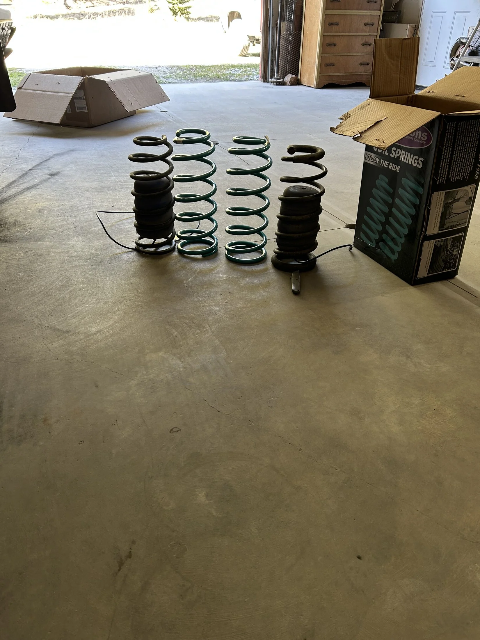

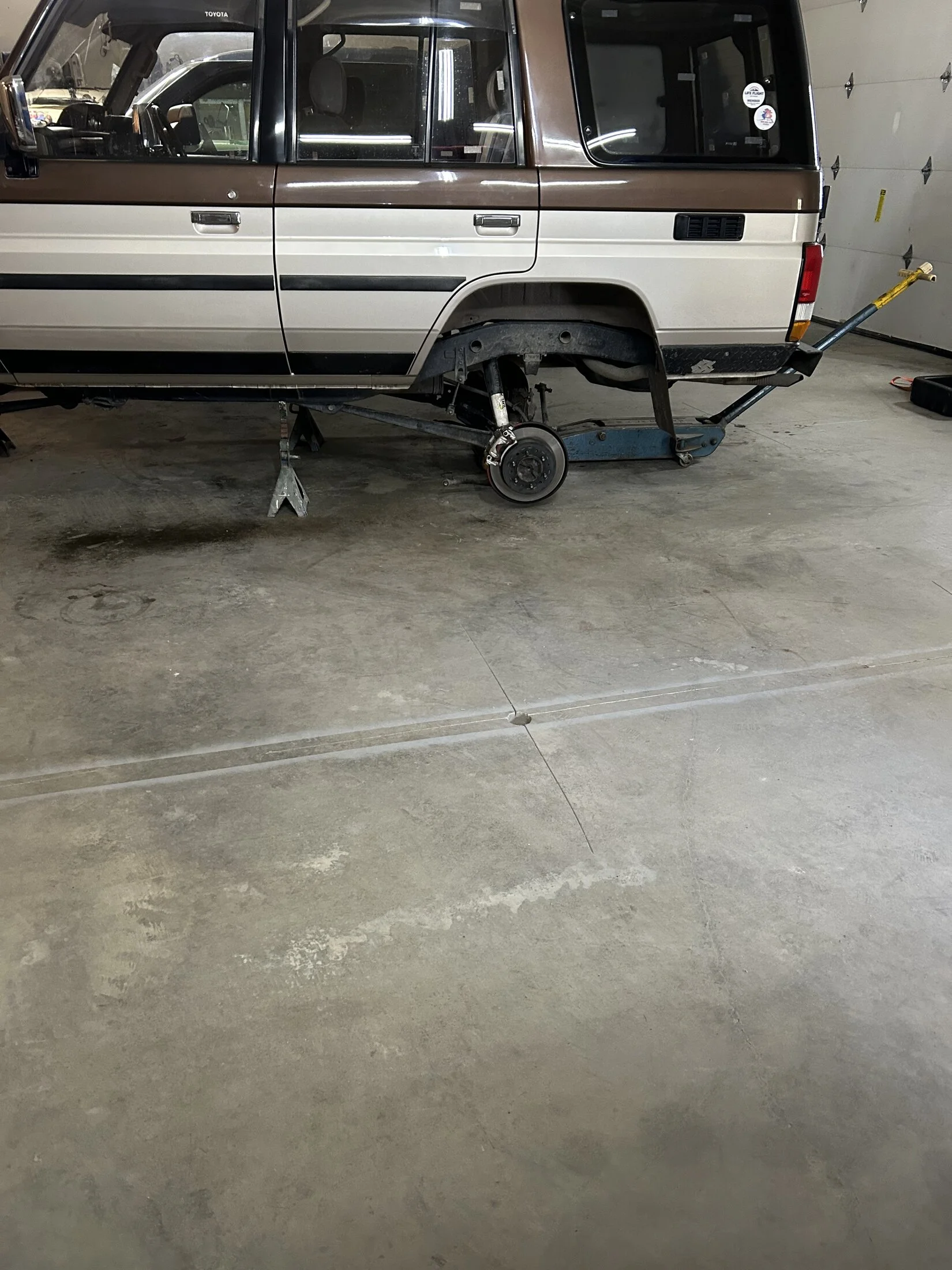

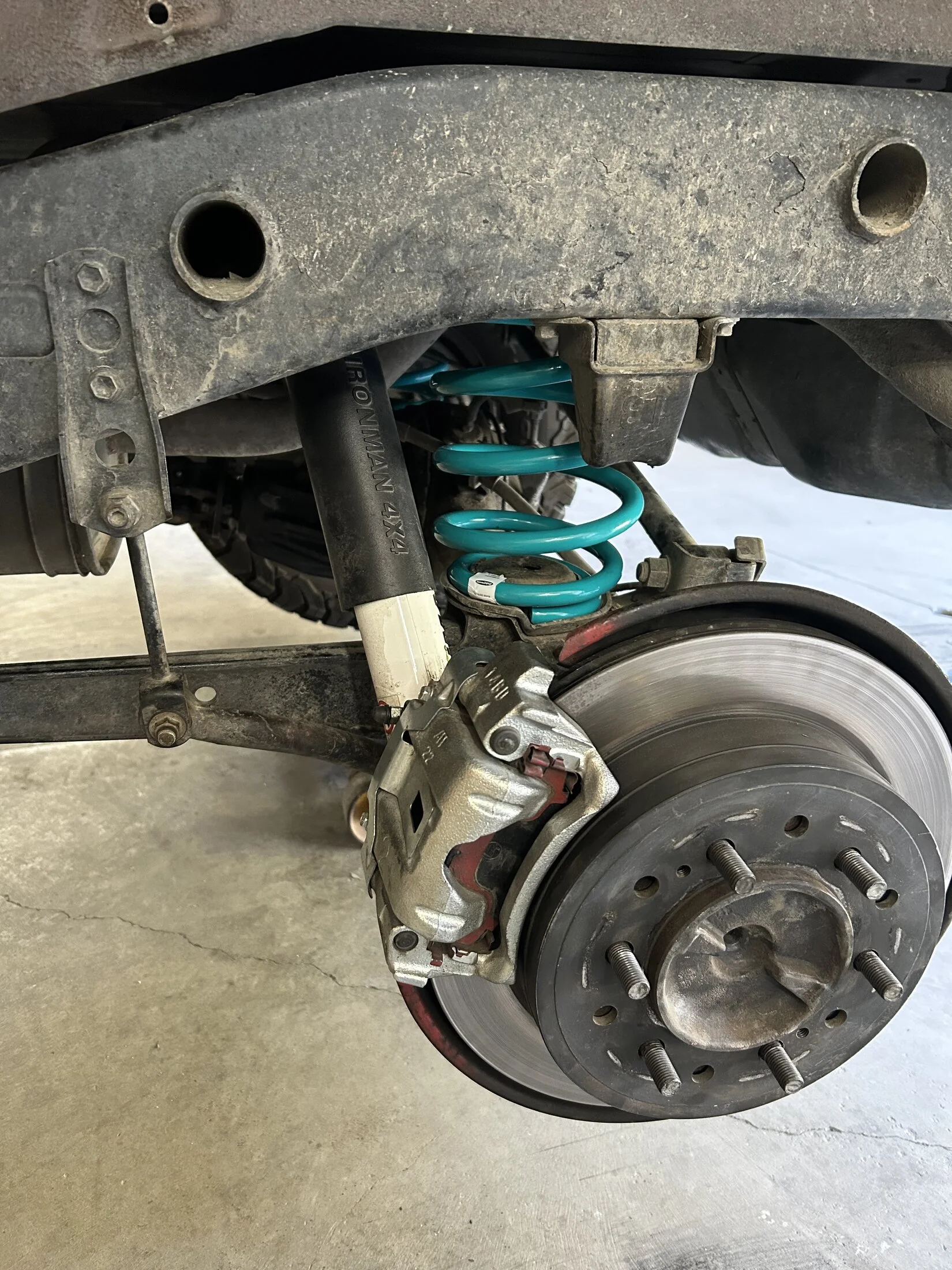

Ok done deal. The lift is done. Leveled it up nicely. I went for a 200mi test drive to Spokane and back to see how it handled with the stock control arm bushings. I couldn't tell any difference. I guess with the 1.75” lift I wont need the caster correction bushing I bought with the springs.
where i found castor made a difference was 'darting' on the highway, tires following ruts and depressions in the asphalt road surface and some return to center feel
Yes. I decided since I had them I might as well put them on. It only took a little over 2 hrs to swap them out. Didn't even need to jack up the truck or take off tires. I just got back from a test drive and there is actually quite a noticeable improvement in handling over the original stock bushings.

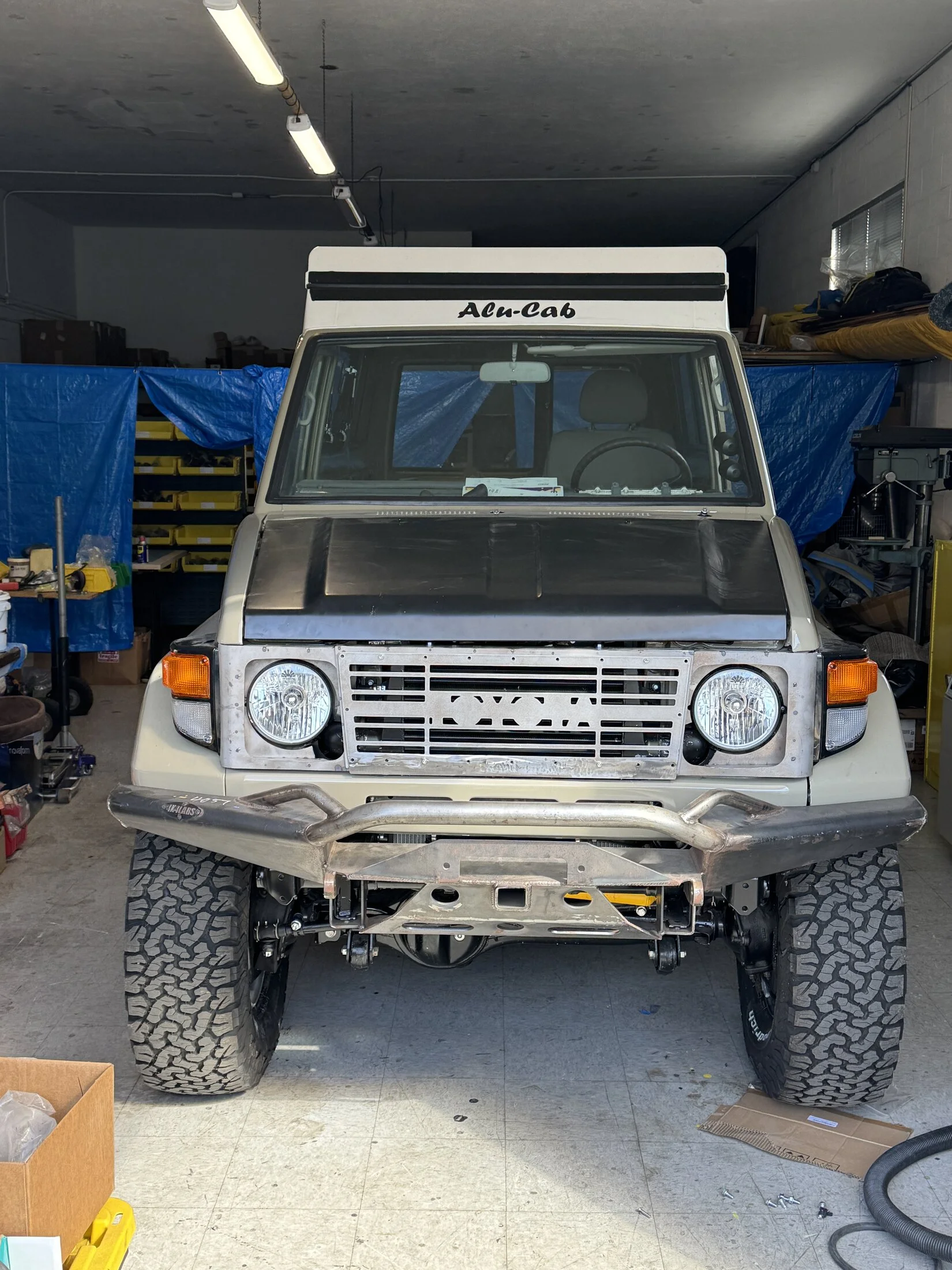

Been building this troopy for a while. Only thing original is the frame except the front suspension (coil conversion) and 50% of the body. So this week got the tach to work courtesy of @joekatana. Thank you brother!!! Apparently the one I bought on eBay two years ago was not for a 1Hx engine. This is great because the drivetrain is 80 series. 1HDFT/H151.
The excitement yesterday was that I managed to fit an 80 series speedometer so there is no mechanical cable running the Speedo but also I can use the output of the Speedo to run the 80 series cruise control. Also 4x4lab bumpers are done, grill is almost done and panels courtesy of @orikawa are done. Thank Spencer!!! All going to powder coating.

How did you tackle the front shocks?
If you mean how did I remove and install them, I first compressed the suspension then strapped the shocks with bailing wire to keep them compressed while removing and istalling the springs. If you mean did I use 2” lift compatible shocks, yes I did but dont know the brand. I put them on a couple years age and they are not labeled.
