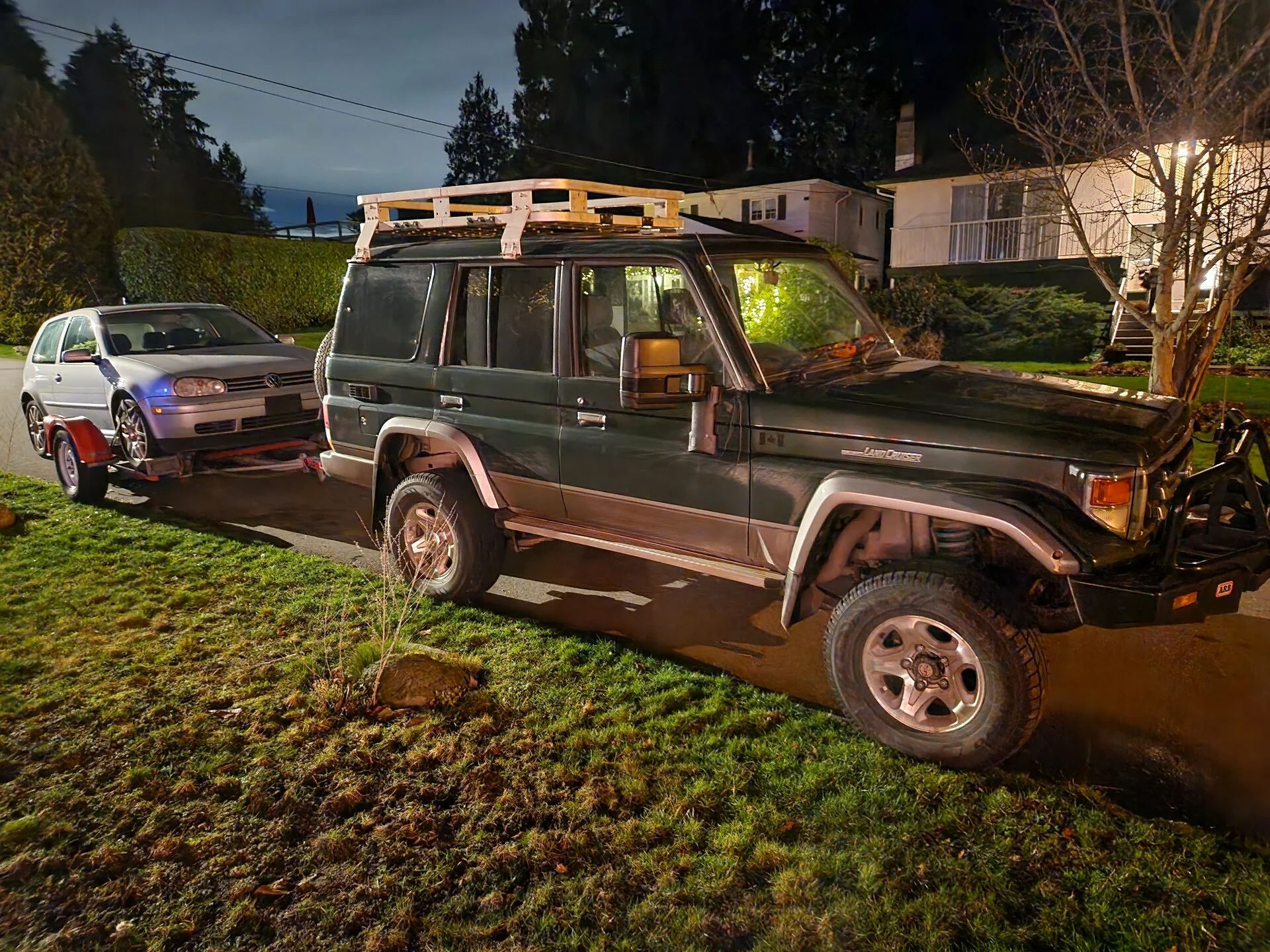

So... my oldest is driving my old jetta diesel that I used to own that my wife used to drive more than I did.
In fact, she loved it so much she promptly went put and bought her own when we gave it to my oldest.
My middle son is good at saving. He wanted to get something more sporty and spent a few months searching for a deal on a GTI.
He found one about 5 hrs away that was pretty promising. The price was right too. They agreed to hold it until we could get down there to take a look.
This was the cleanest 20yr old car I have ever seen. No rust (west coast car) only just over 200,000km (125,000 miles). Got it for $2500, mechanically needs nothing and had new brakes and tires.
1.8L Turbo, 180HP. Pretty sweet car for a 16yr old.
The land cruiser did amazing hauling it through the mountains in the dead of winter.

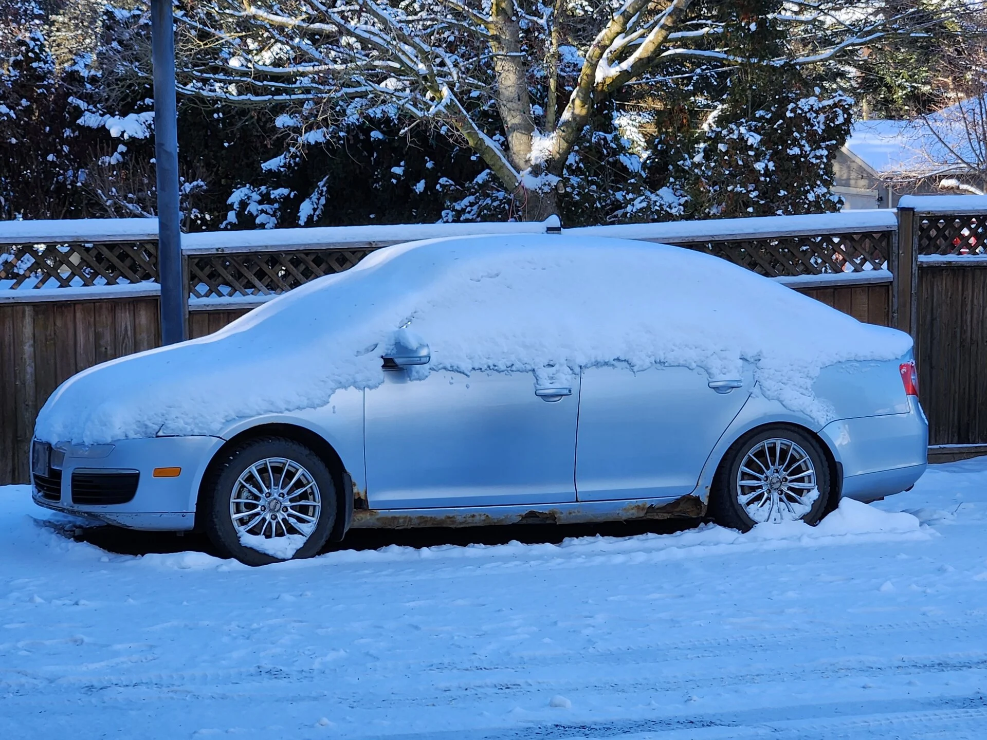

Part 3 of this saga...
If you may recall, this same son is the one that found that 2006 VW Jetta diesel that the seller had thought there was a "transmission problem" and we ended up purchasing that car for only $1500. If you have been following my threads, you will also know that the transmission problem was actually a disconnected boost pipe behind the engine.
So I agreed to purchase that car from my son and will make it my flogger and keep the miles off the less efficient land cruiser. So now I am back to owning a little diesel jetta. What goes around comes around as they say....
I am going to flush the transmission, probably change out the fuel filter, and at some point, probably use this vehicle as a guinea pig for learning to work on bodywork. As you can see this side is in dire need of a complete new rocker. The fender isn't worth the time as you can get second hand ones for around $100 in the correct color and in pretty good shape. The other side is in actually pretty good shape, though the rocker does have a little bit of bubbling in a couple of spots, so it will need to be addressed at some point as well.
Otherwise, I think this is a great little runabout for those quick errands and carting kids around.

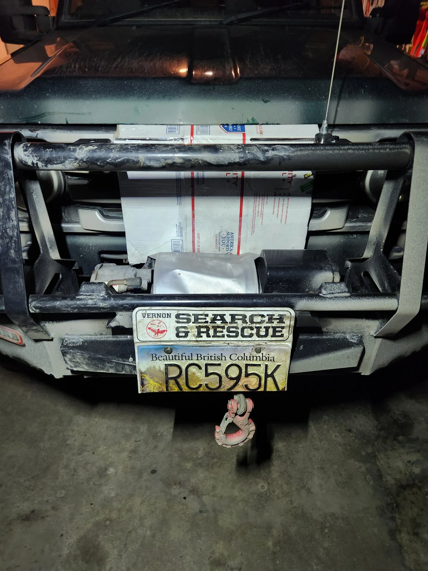

With the unseemly arrival of true winter on our continent, I have been unsuccessful in finding anyone that makes a winter front for the 70 series. Perhaps a European market somewhere might have one?
Anyways, I decided to make my own in the interim. Thanks US postal service...
It's notched out for the hood latch up top to keep it in place, and custom covered with dollar store packing tape to protect it from wetness.
It's not lost on me, that we folks used to milder Temps that folks like @coldtaco are just putting on a touque (beanie for you folks from the US that don't appreciate metric) and laughing at us "southerners" scrambling with block heaters, webasto's, winter fronts, oil viscosities and the like.
Cheers to you brave souls truly dealing with challenging climates. :cheers:
My BJ74 had a cover that functioned like a window shade that when deployed covered the majority of the grill. I always assumed it was a factory option. 😊
I know Land Rover offered a cover that could perhaps be adapted.
I know Land Rover offered a cover that could perhaps be adapted.View attachment 3530775
I recall my BJ42's that I owned and were built for the Canadian market had the roll-up "shade" right in front of the radiator with a drawstring to pull it down for cold weather.
There is no such convenience on my JDM cruiser, unfortunately. And of course the diverse aftermarket support in Australia would have no use for such things, so why I was thinking perhaps the European market MIGHT have something to offer.
For now, my 20-min solution will have to do.
What I do not understand is why Land Rover has covers for the lights? Perhaps being a previous Land Rover owner you might have an idea? 🤔
That photo was simply lifted from the inter-web so I’m guessing that’s a military thing. If you were to install their radiator curtain to your Land Cruiser, it would starting leaking oil within minutes. 😊

I've got a piece of PVC raft material as a radiator screen on mine. It stays there all year, I have it zip-tied to the frame cross member on the bottom and just roll it down in the spring and up in the winter. The fan pulls it tight against the radiator and holds it in place. I initially hooked it over some bolts at the top, but have found the fan holds it there and when the truck is off, the material has enough rigidity to stay up without the bolts holding it and I can adjust it to have some of the radiator blocked or all of it.
Looks like some one borrowed your idea and made an easily removable one, it also has a screen for insect/grass/stone protection for the warmer months.
Some other cool items on this site.
I like the elegant simplicity of yours.

Ah, yes I can see that would reduce visibility in the daytime.
I like the material choice as it is very durable and stays flexible in really cold weather. Now you have me wondering if SAR will notice if I cut out a piece from our rescue raft or RDC (rapid deployment craft) - I mean, I do not need THAT big of a piece.... 😜 :rofl:
I DO like what you have done here, that makes sense. I have a limitation in the area of space however, with the front mount intercooler. I will have to think some more on this idea. I am not so prima-donna that I need it to be aesthetically pleasing. In these temps, those "conveniences" go out the window. Complaining is a convenience? Damn right it is! 🙂
Thanks for the link! I will peruse and do a little more research on options from the european market and try to see if I can find something that will work with my setup.

No shame on using cardboard 😉 most of us Ak use cardboard. I never taped it for waterproofing 🤣 come spring time throw away next winter install a new piece 👍

Hello,
This is a good solution using materials available at hand.
May I suggest that you post this in the Random Redneckness thread as well? No offense intended. Many Redneck solutions are quite creative, considering they involve available materials.
I have not seen a reference for factory radiator screens for 70 Series trucks built after 1990. Perhaps Toyota decided to drop that feature back then. Or perhaps I have to check again.
I hear the polar vortex is getting worse. Take care, stay safe.
