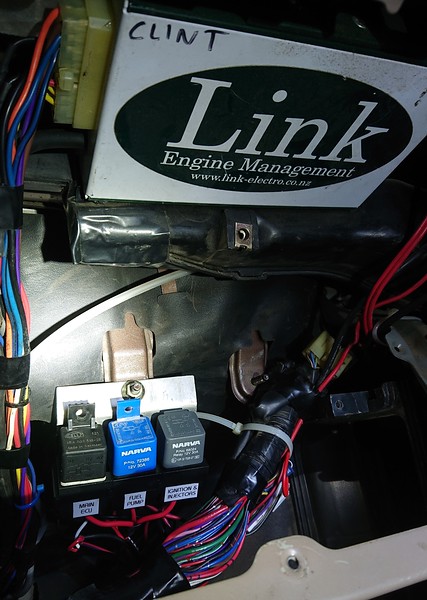

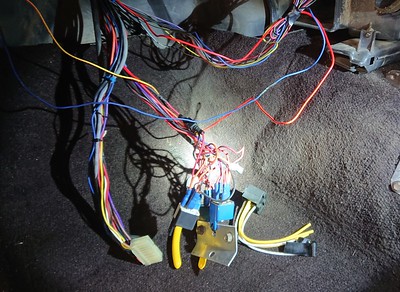

Some re-wiring...
When we swapped in the V8 ~16 years ago the new wiring to the aftermarket ECU etc was pretty basic, but it has all been perfectly reliable. However when a relay crapped out while out on a trip last year it was a real PITA to diagnose the problem & very fiddly to swap all the terminals to a new relay while troubleshooting. So I resolved to put in some mounting blocks & this weekend finally got around to that job.
Also wired in an off switch for the Ironman driving lights, the relay was previously just hardwired into the high beam, the old hub lock switch was perfect for that job.

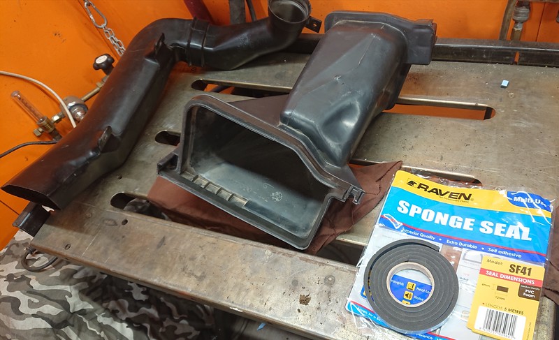

The fan assembly & heater ducting that was removed to get easy access to the wiring let me clean out about half a forest worth of twigs & leaves & detritus out of that stuff & also the plenum. Of course all the foam strips sealing joining the ducts crumbled to dust, so new seals were installed.
Also fettled the heater flapper that wasn't shutting off the heater duct fully - I always thought the cold air setting wasn't quite as cool as it should be. A future project maybe to install air-con.
