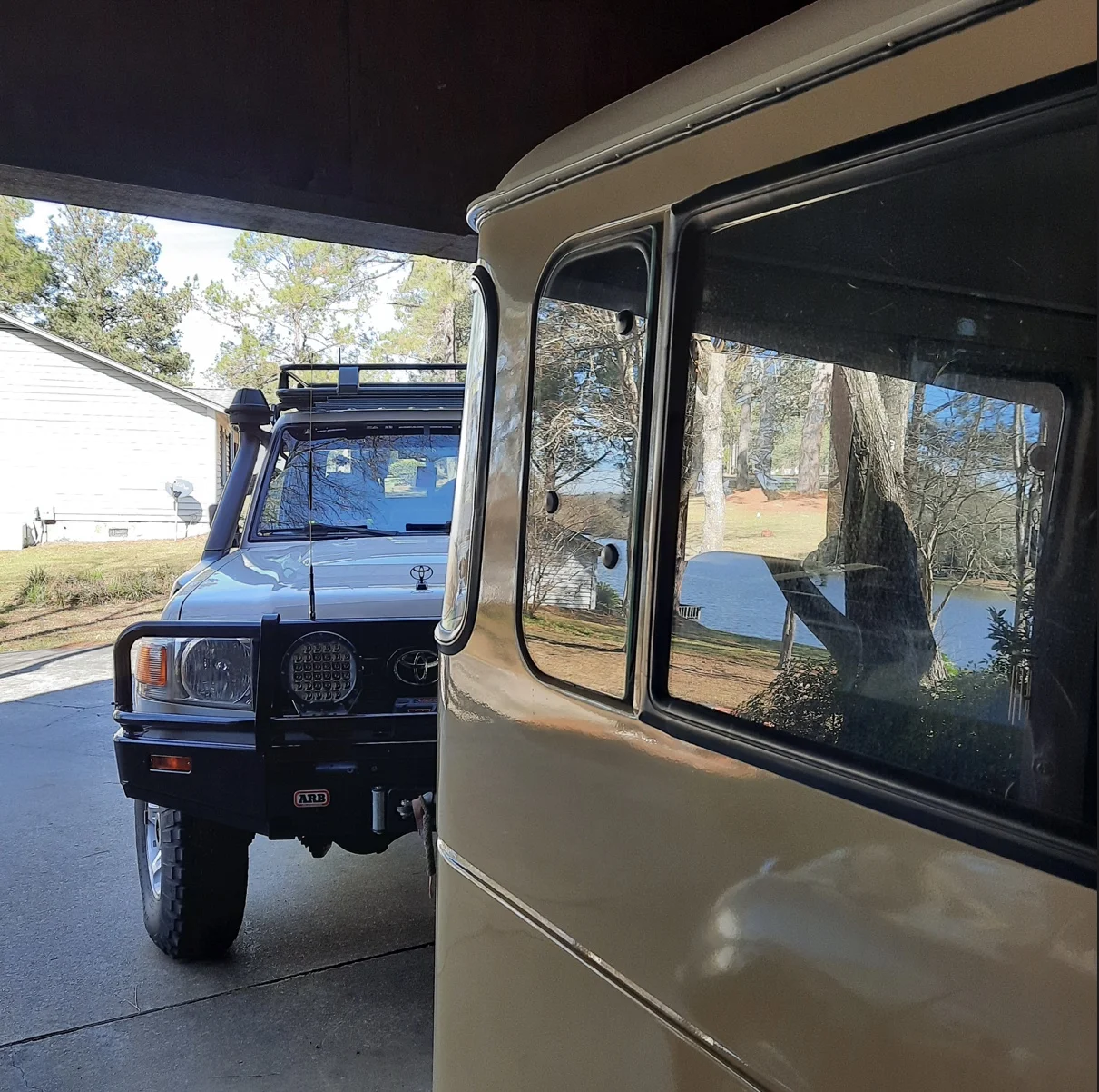

Haven’t driven the 70 Series much lately but today was “haul off the trash” day. 😊

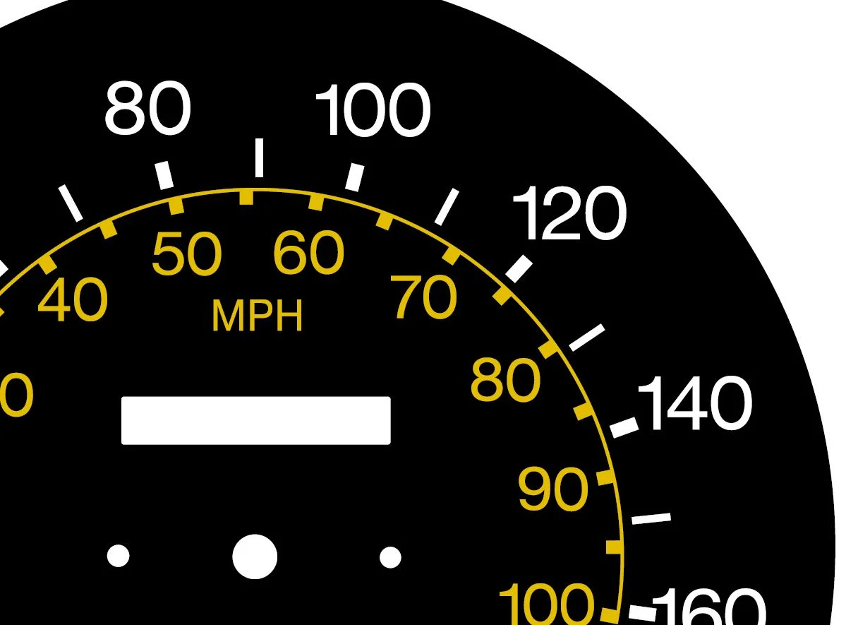

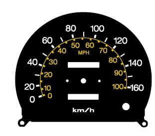

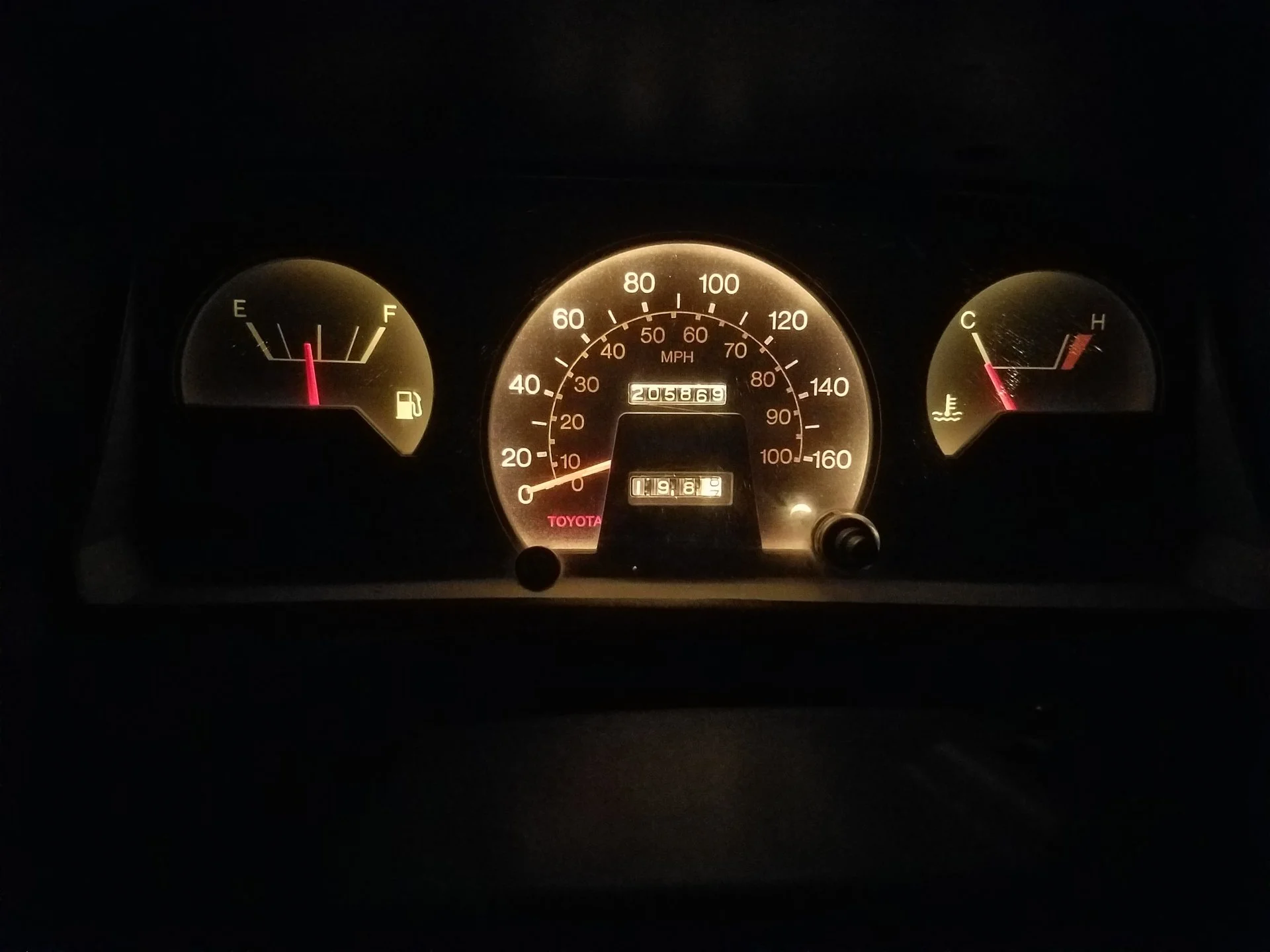

The speedometer graphic was revised and redone in adobe illustrator. It looks a lot better than the original one I did awhile back which I did in a different way and not very good. I plan to start working on 180kmh version later.
Wait, so you are saying my 1st gen @FJ73Texas overlay is inferior? All this time I thought I was ahead of curve! :) Thanks for working on these, I love mine! 👍👍👍🤙
I guess it sounds like that from what I typed but you just got the first batch of when I attempted to make the overlays. I just felt I could have done better so I made version 2. I know it may not be worth the trouble to you but if you want to try out version 2 and compare...I will send you one. What you are using now actually still looks very good though. From what I remember you don't have to remove the needle in your case.
I think mine is sweet as, looks great and was only joking about it being inferior. I'm surprised you went back to messing with these since you couldn't use the first ones you created.

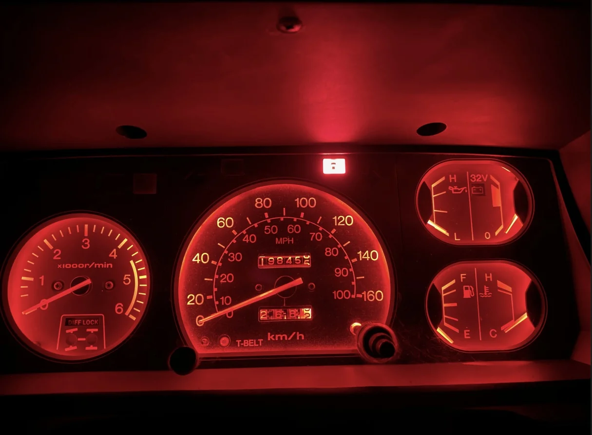

You remember correctly, I did not remove the needle, and it would be pretty easy to swap it out with a new one. Since I have that funny tab that separates the odometer from the trip odometer I cut the overlay so it could go around the needle base; the tab hides the cut. I can barely see it and I know it's there. It really is an awesome "upgrade".
Couple of people asked for one so I decided to redo the graphic at the same time. but yes I do wish I could use one myself.
One of your early versions. It required a tiny hairline slit under the speedometer needle to install. 😊

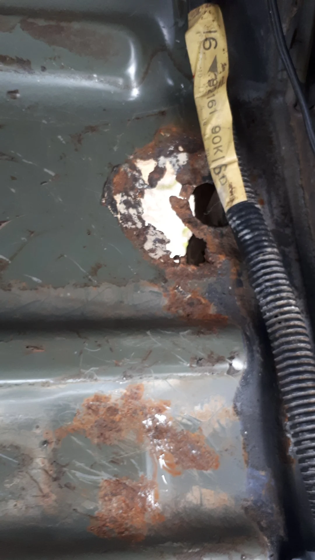

Pulled out the vinyl floor today to see what the PO left behind under it...
1. A layer of cotton recycling stuff as isolation and sound dampening. Humid. To be removed.
2. Pieces from a camping mattress.
The floor panel showed the expected bridle asphalt sound deadner. Removed it...
Diagnosis:
Driver footwell: OK. Some surface rust spots under that asphalt stuff. No problem.
Passenger footwell: Not so well. An area is heavily rusted, with a hole. The drain hole has trippled in size. PO had covered it with plaster. :-(
I need to find somebody to weld in some patches..
The vinyl floor is torn. I'm tempted to get it replaced, but I must first use my budget to fix the floorplan undercoating.

I eventually got my passenger footwell welded. 😀 Thank you, Darius. Nice work.
Next is coating (in and under) and butyl sound deadner to replaced the removed asphalt stuff.
Next big job then is removing and preserving the tank as well as replacing the rusty filler neck octopus.
In March it will go for body cavity- and underbody preservation. All coating needs to be completed before they flood the rig with FluidFilm and Mike Sanders.
