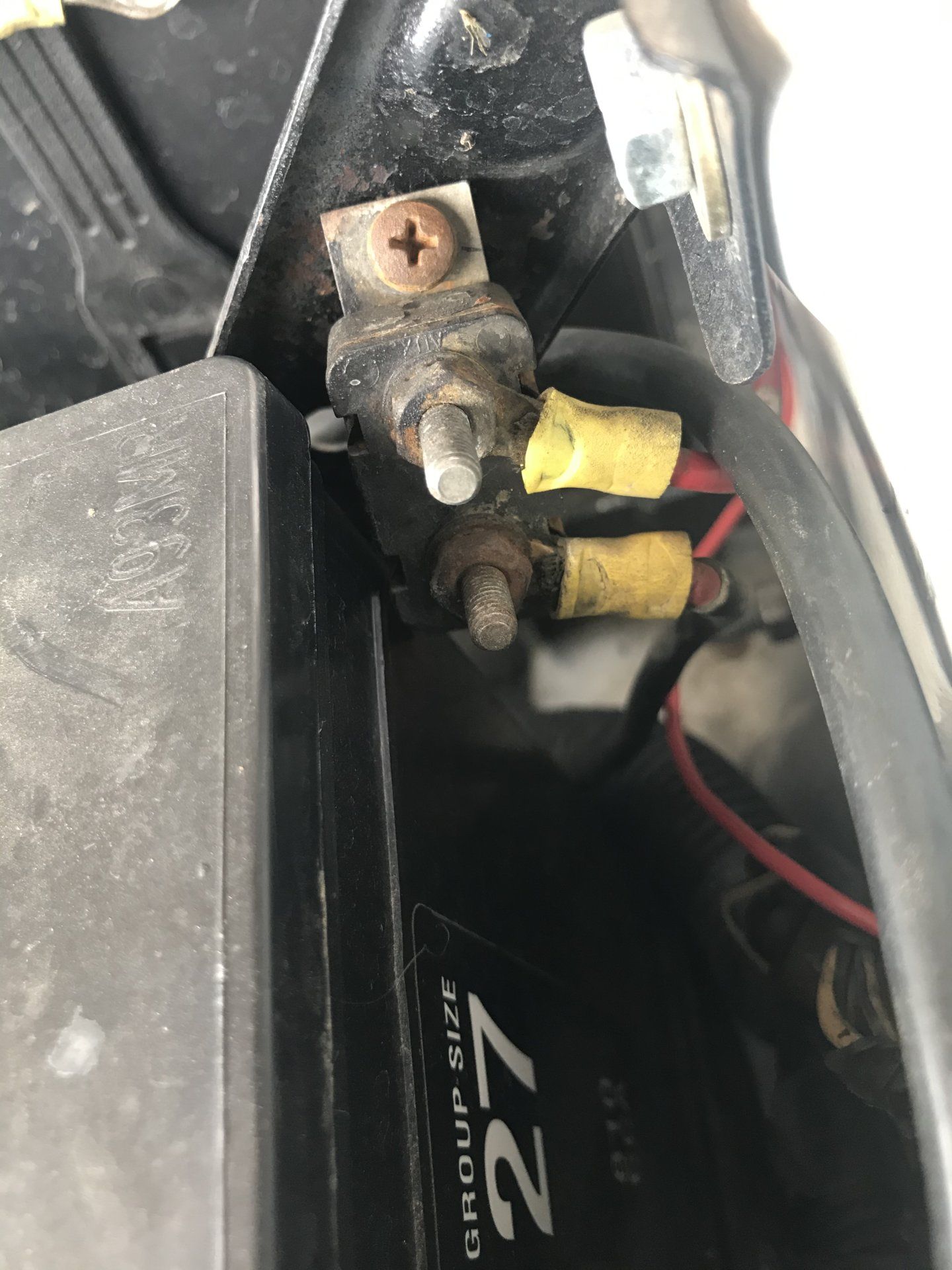

Fixed a taillight bulb, then found this unhooked wire
I believe it goes back to the waterproof deck connector in the back seat that isn’t showing power. Is this just a fuse junction?
I added a circuit breaker to protect my cheezy 7200 Pyle 12V converter: it has 2 studs like that... about the same size.
I would get it loose and look at the back side. Maybe it was intended to allow several wires to branch off at that point.
You are correct, I couldn’t remember it was called a circuit breaker. :doh:
If you need to replace that circuit breaker, i got my 24V model from an online boat supply place. Can't recall who tho'.
They are used for 24V trolling motors.
