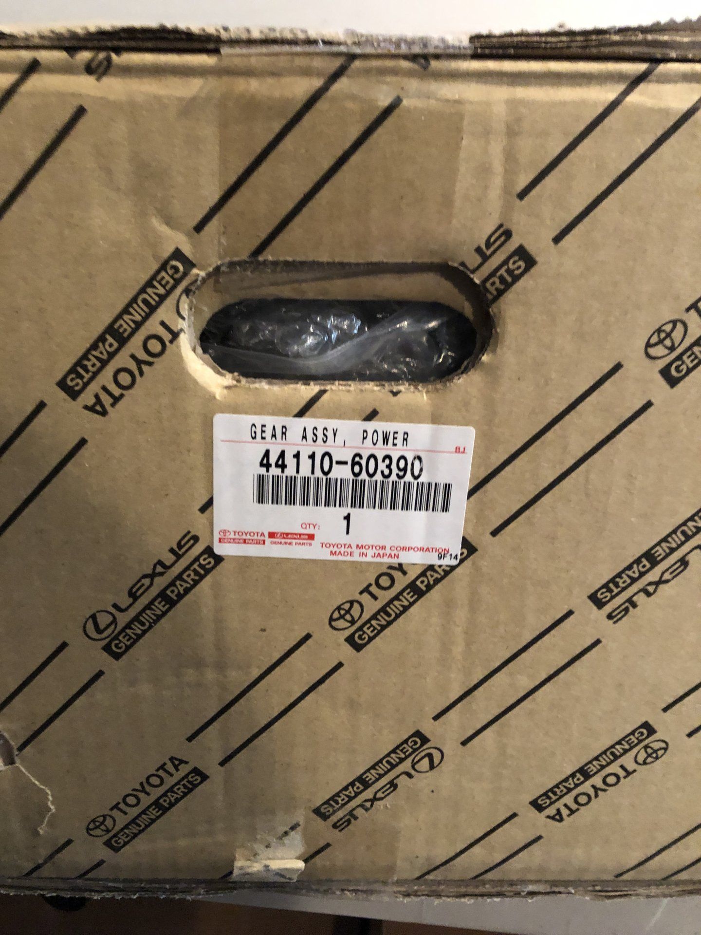

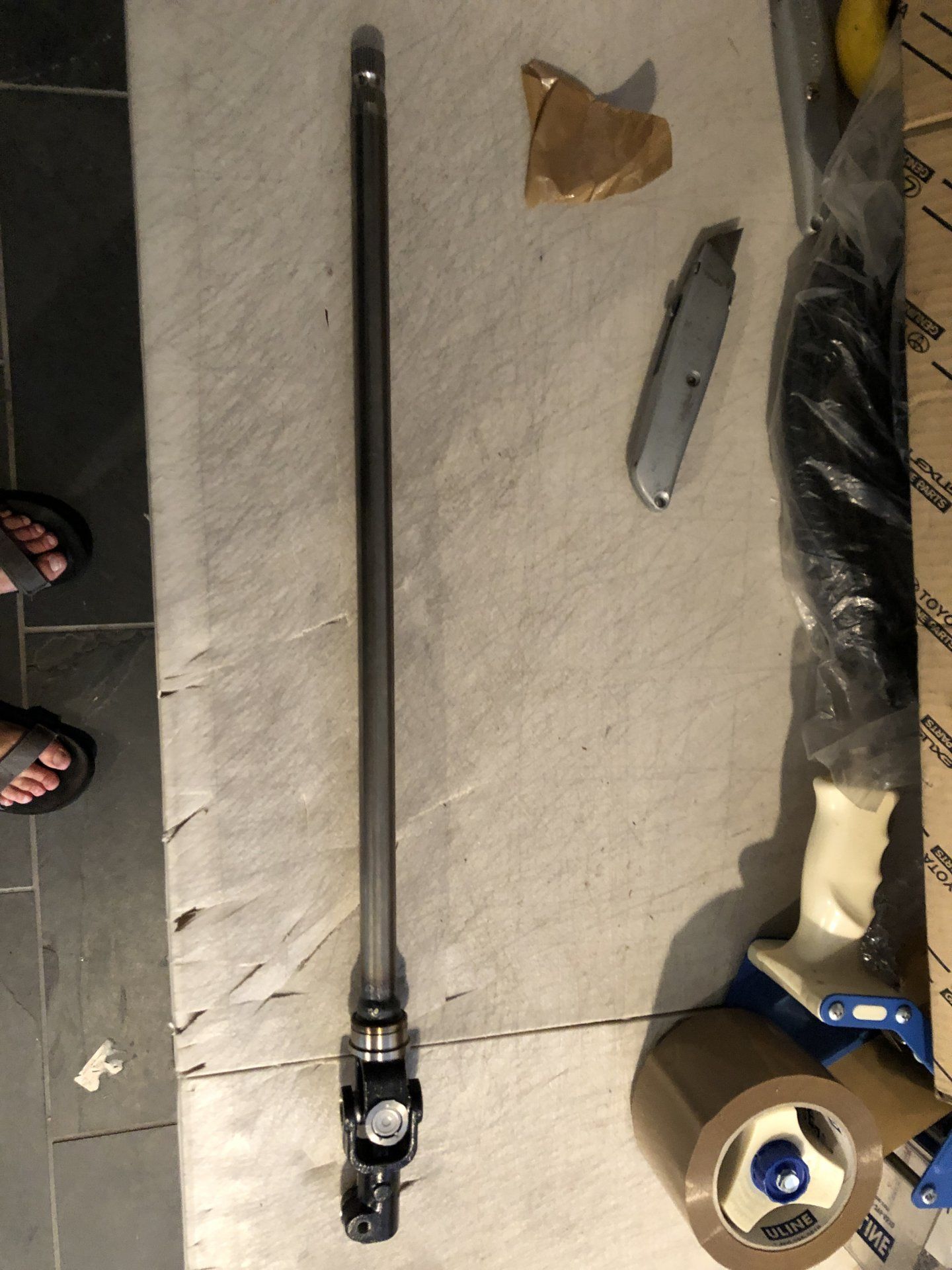

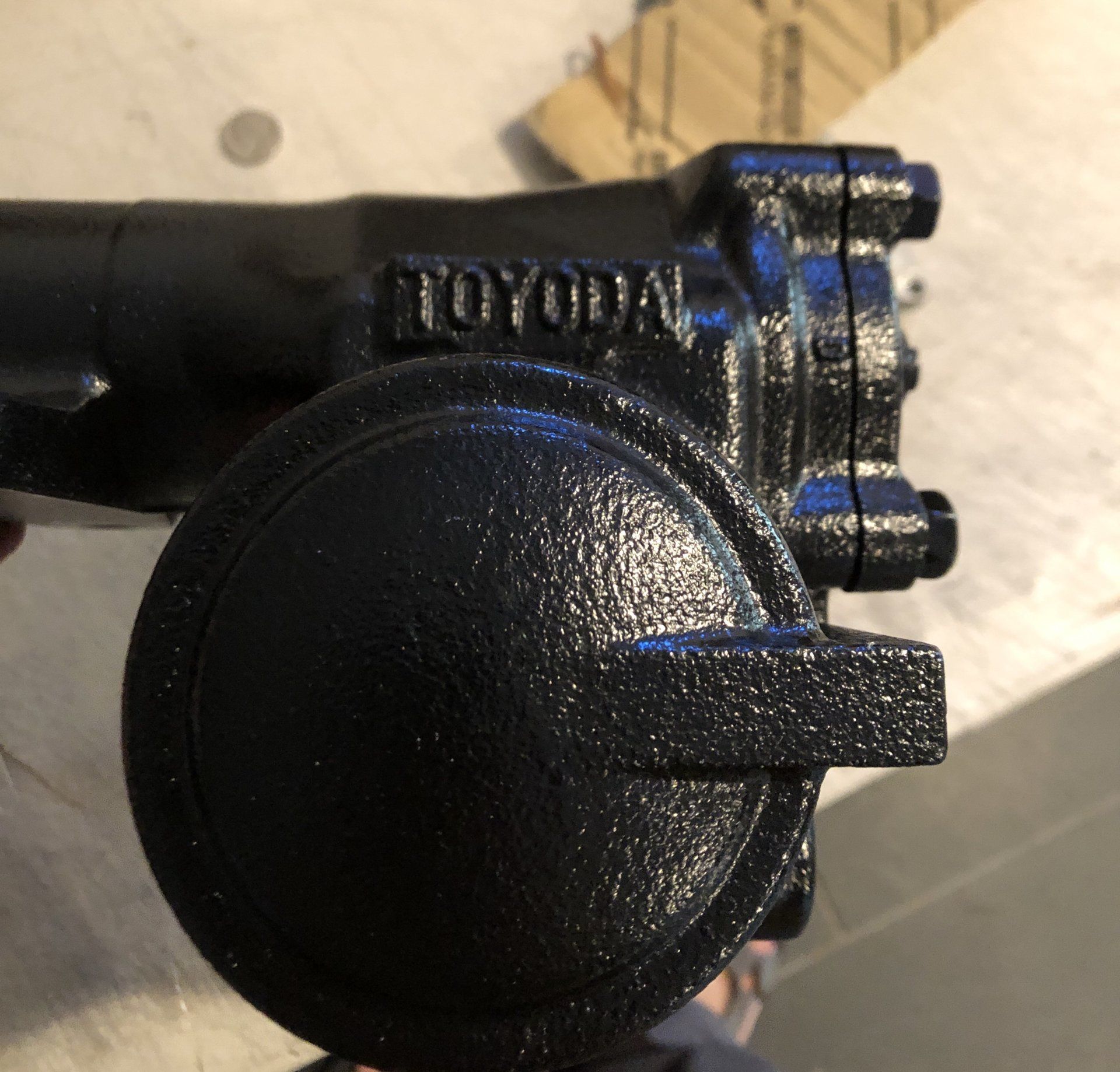

Next project: new steering system.
I’ve already replaced the pump. Gear box was original, leaking and I was done with the hard steering effort and sloppiness in the gear box.
Ordered a new OEM unit. RHD. Interestingly enough, the gear box part number was a reverse supersession: meaning the most recent iteration was 44110-60392. But it’s not available and reverse supersedes to -60390. Very rare that you see that from Toyota.
It’s a beautiful unit.
