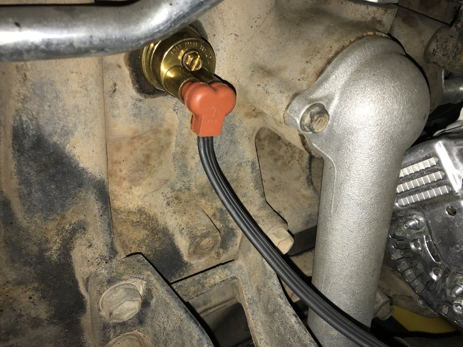

Installed a block heater the other day in the gold 70.
It was about 35* this morning when I started it. Easiest cold start this truck has ever had.
I also installed a fan clutch and new fan recently.
With the heater installed I would say this is no longer a tropical spec Cruiser. Comes up to temp much faster now with the fan clutch, heater cranks!
It is ready for the cold white north which is where it is headed on Monday.
Cheers

Could you post the info on that block heater? I don’t think I’ll ever need it but figured maybe some might be interested.
