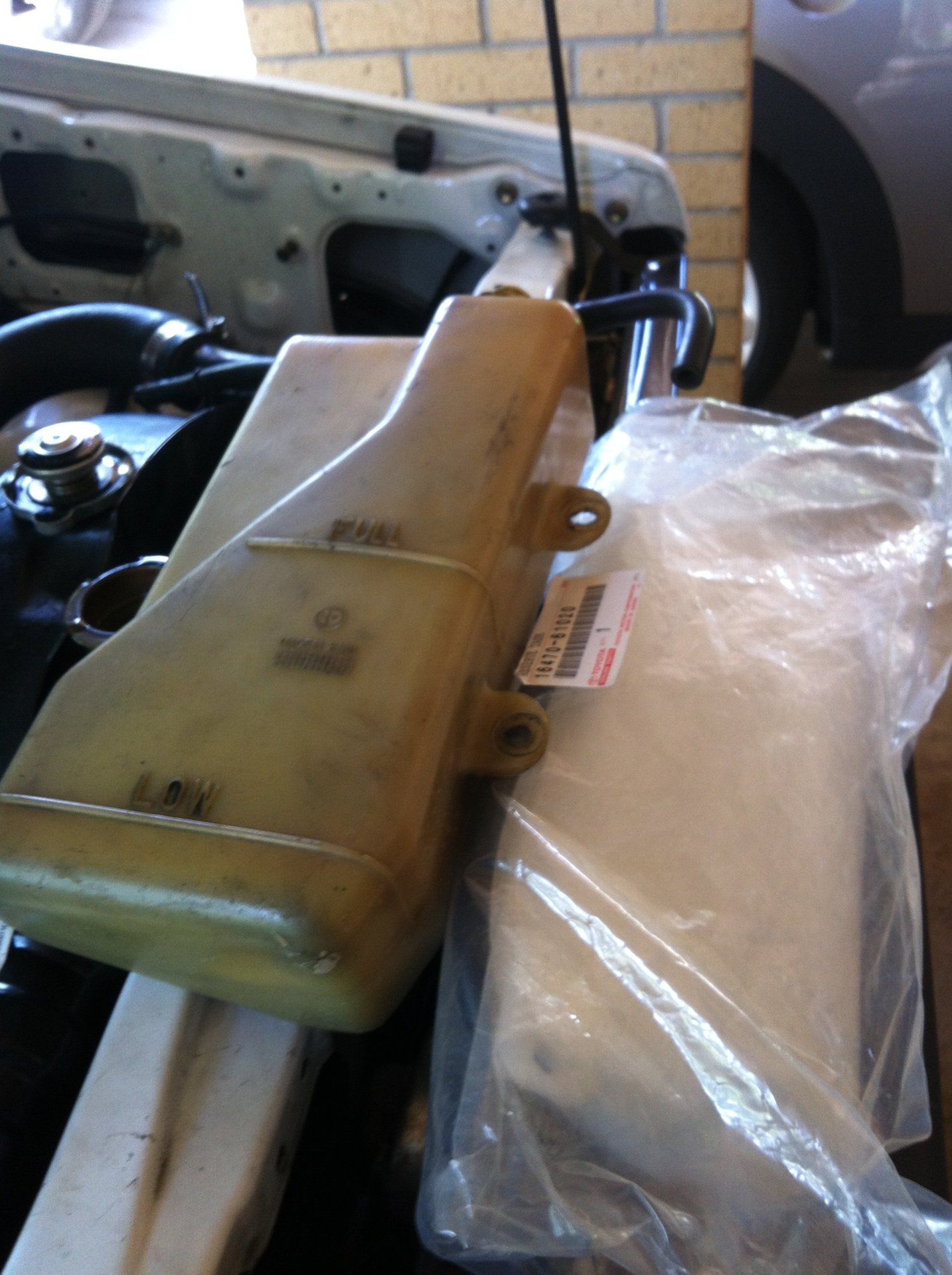

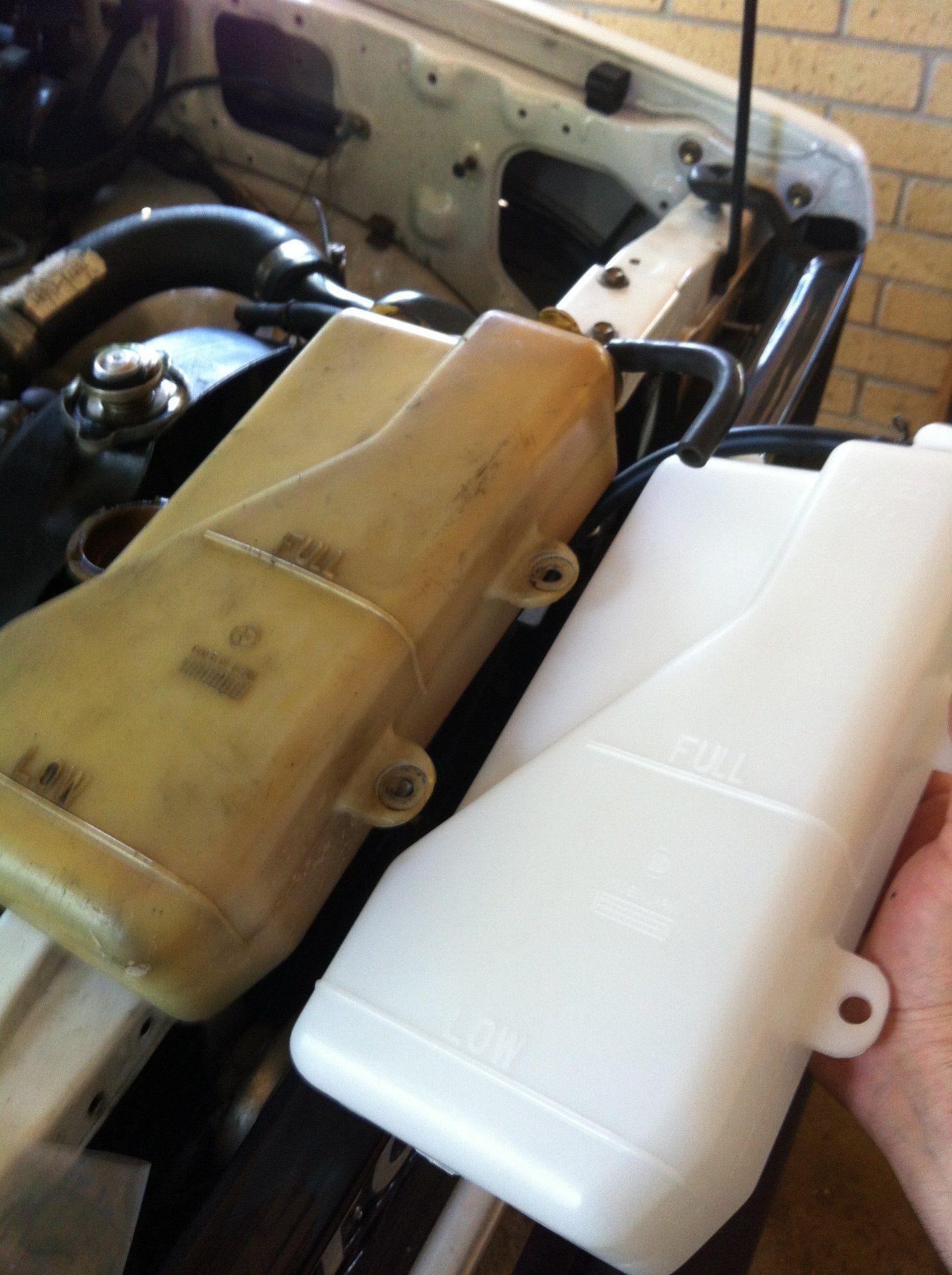

I forgot to mention I did manage to swap out the coolant overflow reservoir with an OEM unit from ebay. I was told this part is discontinued so I was pretty fortunate to find it as it must have been sitting on a shelf somewhere in Australia where it shipped from.
