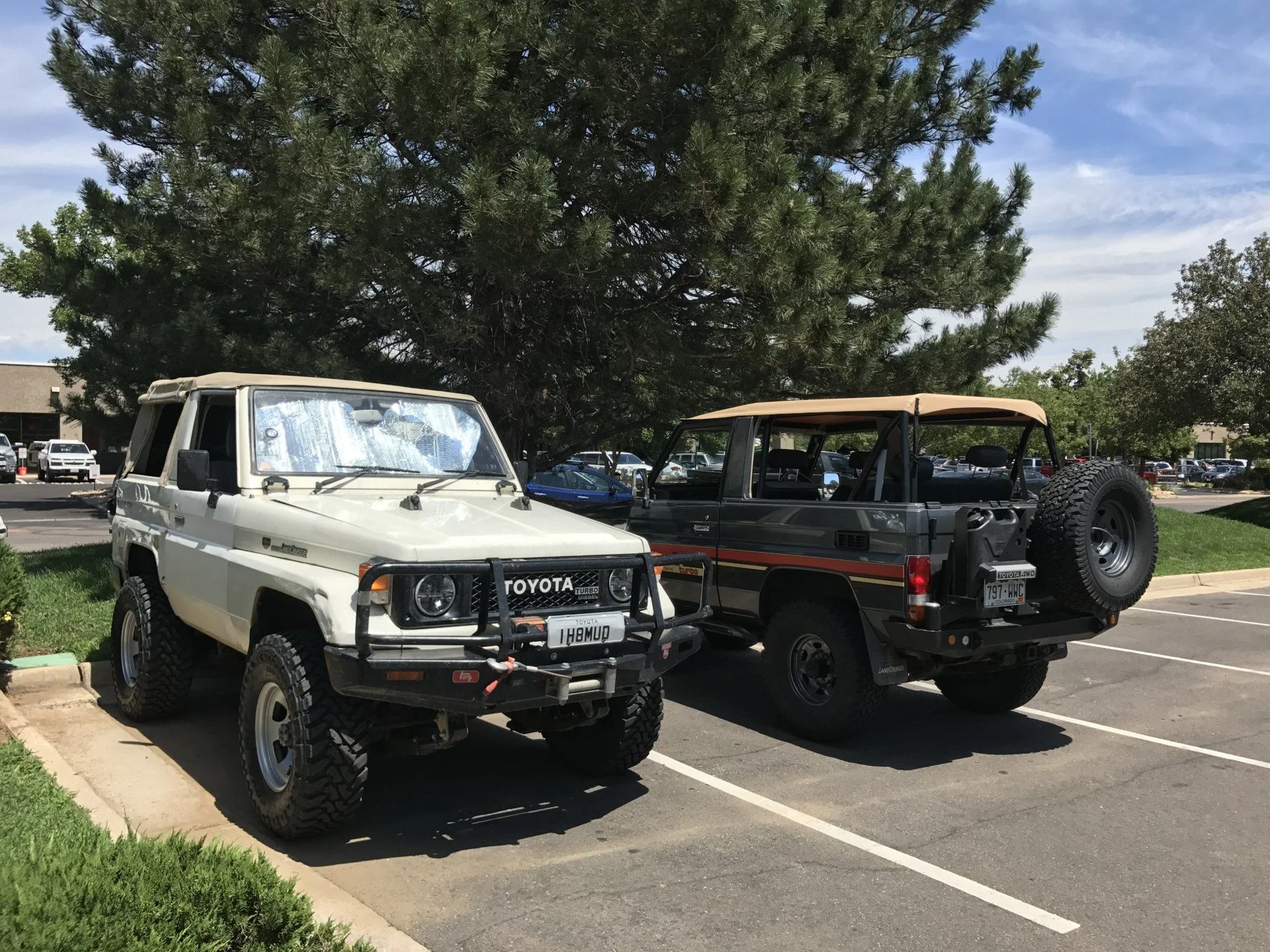

Met @jfrench for lunch today. Sweet truck dude! Hope to do it again!
We'll definitely do it again. As you discovered, I need some help with the ol' girl, who by the way looks a bit peaked next to yours

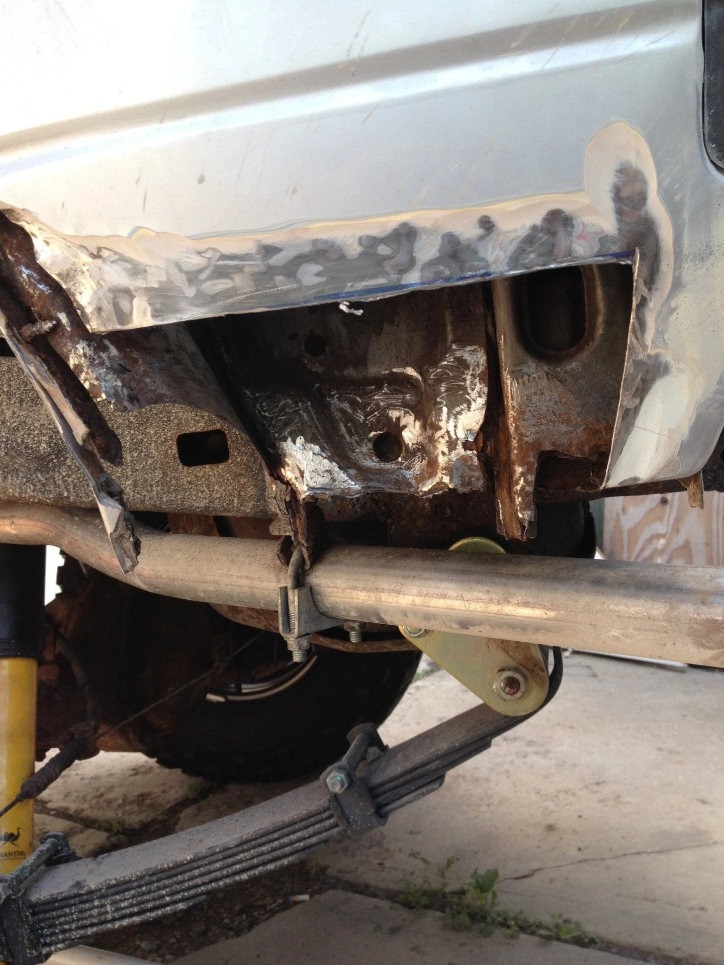

Finished rust repair on rear q panel. Had been fixed previously by some one who had stock in Bondo. Was 1/4 inch thick in places. Now all hr s.metal and ready to run the gauntlet of the dreaded Safety Tech. Just have to grv guard n paint.

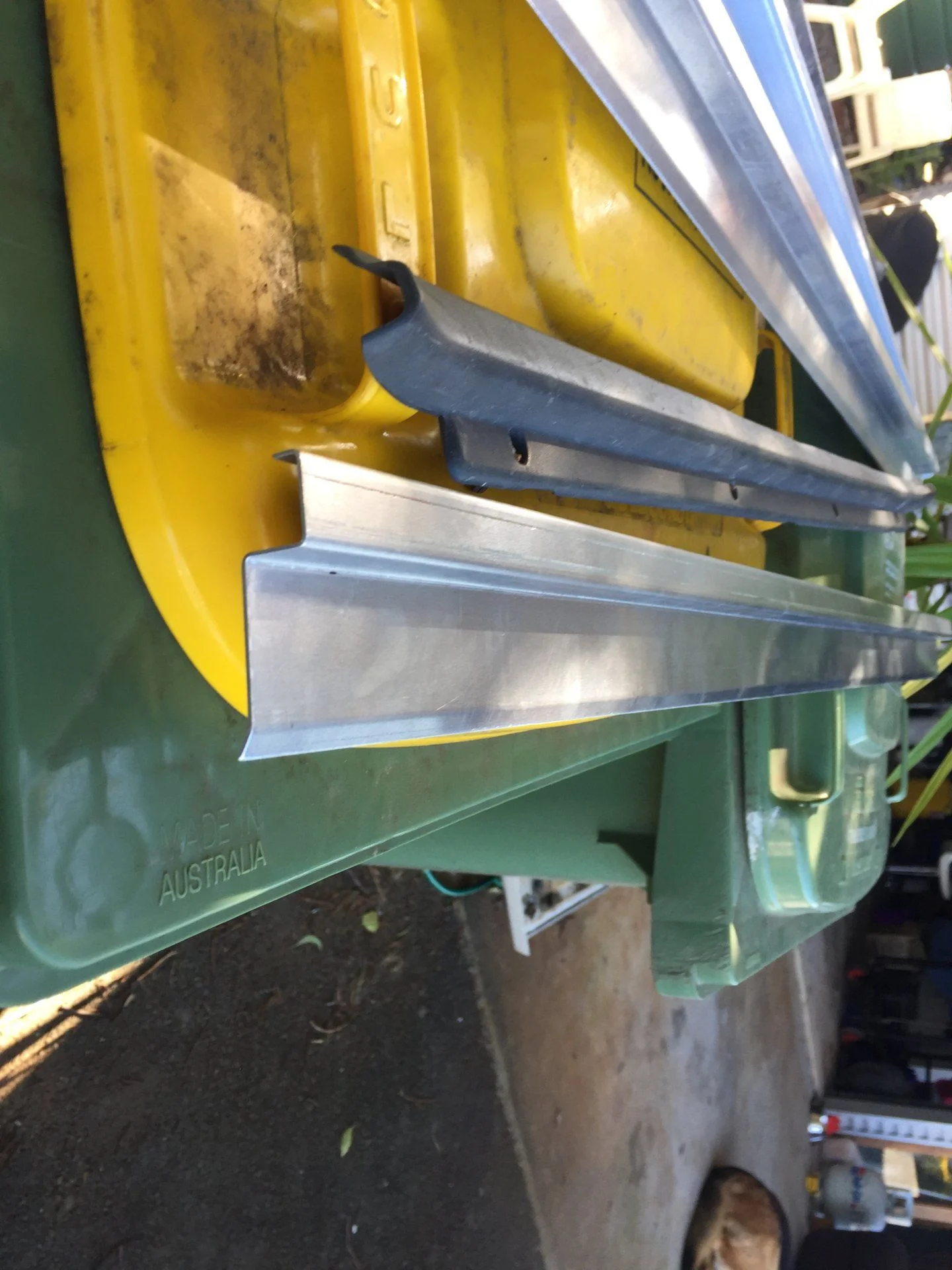

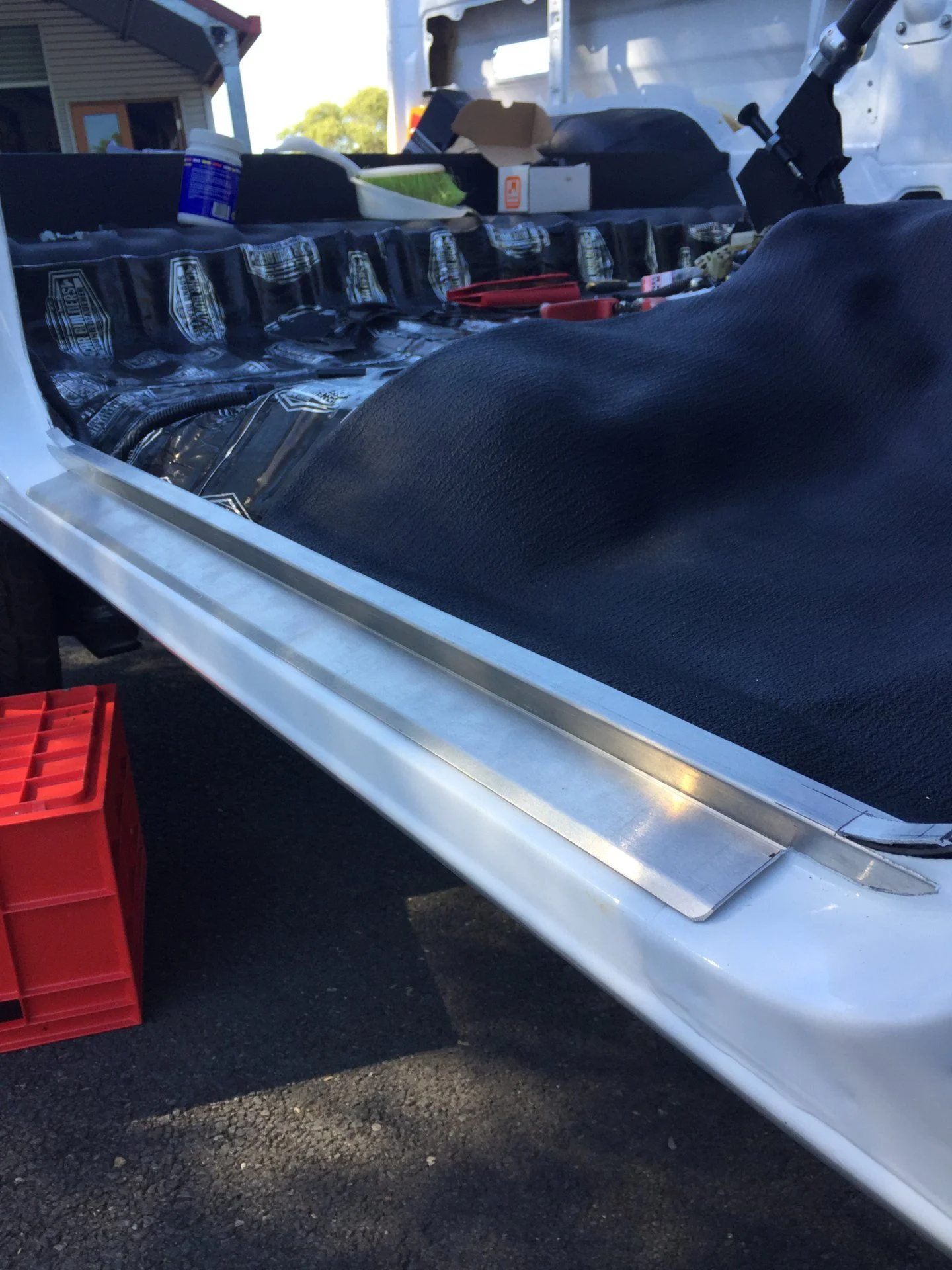

Got some aluminium and St/Steel pressed to match the old factory plastic door scuffs. Changed it slightly to cover the whole sill and to grip the new rubber floor mat better. The aluminium set I'm making for my son's birthday as he has a 75 series then I'll use that set as a template for my St/Steel ones.

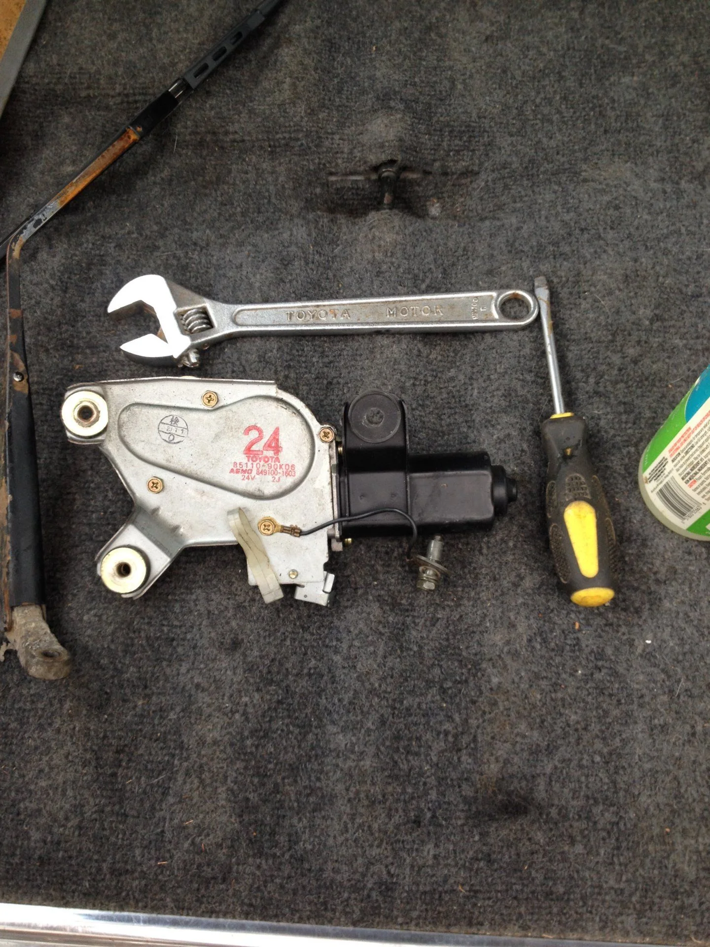

Last chance to check all systems before safety. Rear wiper moved 4 inches n quit. Fuse was gone replaced 20amp with a 15. Blew instantly. Dead short some where. Started at the motor. Wiring. In plugged harness to wiper and tested with a 20. No short. Process of elimination says motor wires. On inspection can see where two wires have been rubbing. Re insulated them. Worked perfect. But I think the washer tubing got pinched. Pump runs though so should be an easy fix.
Those scuff strips look so good I'm totally stealing your method. My sons bj was missing both sides. I scavenged two from a prado but the fit is too short. So just bend some up! To hell with stock yours are prime. I love custom

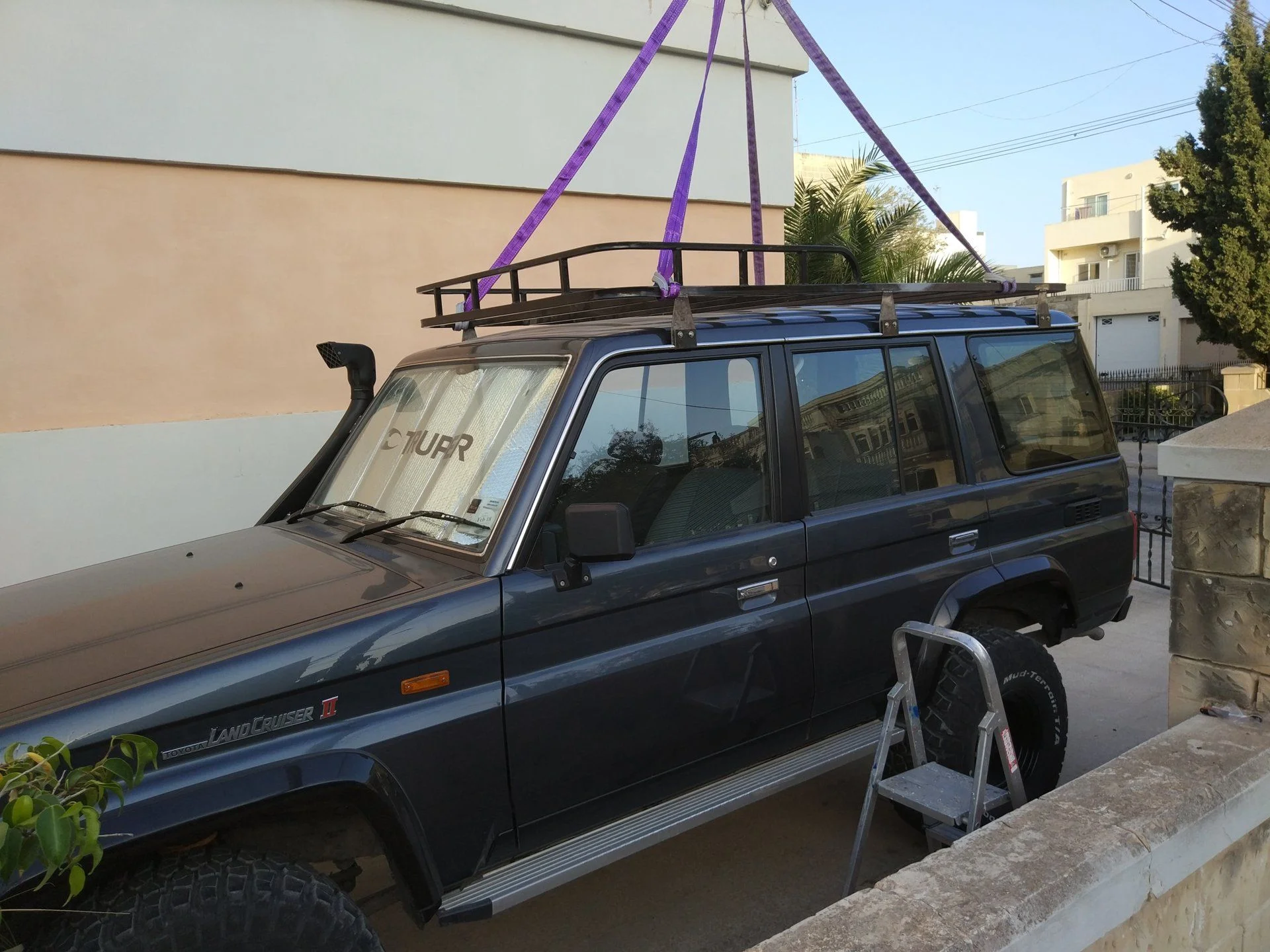

Finally finished fabricating the roof rack, gonna take it to get it coated in LineX tomorrow. Originally had fabricated the front section to attach to roof bars I had under my roof tent, that is why half of it is already painted.

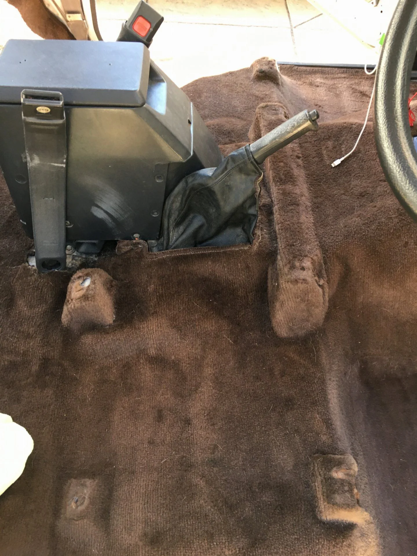

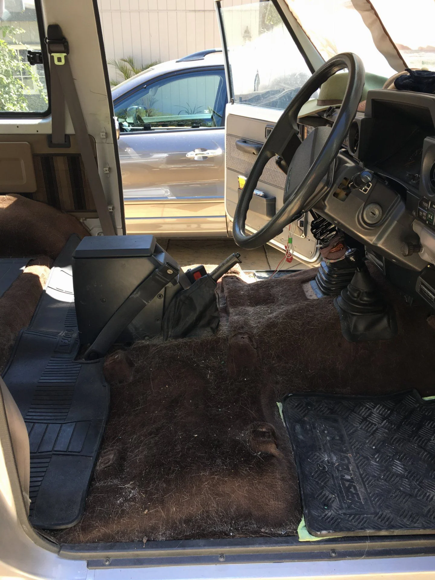

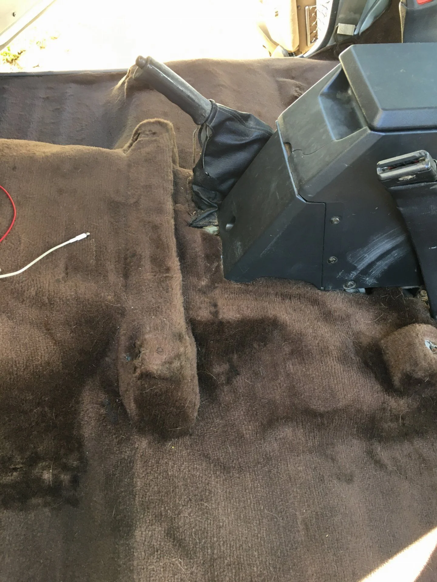

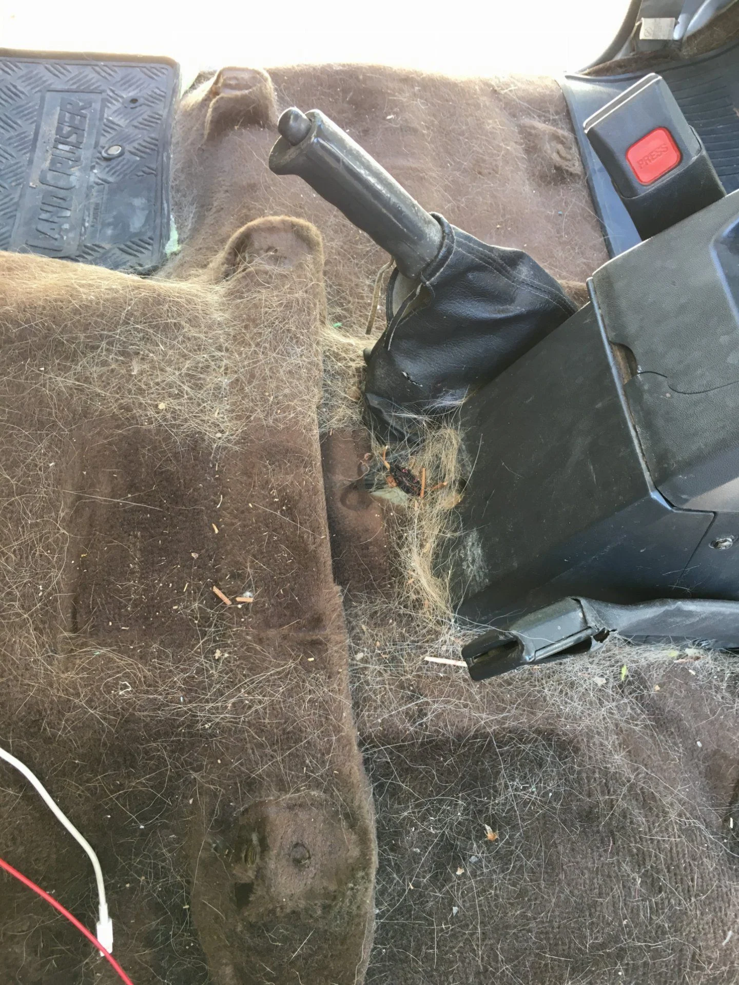

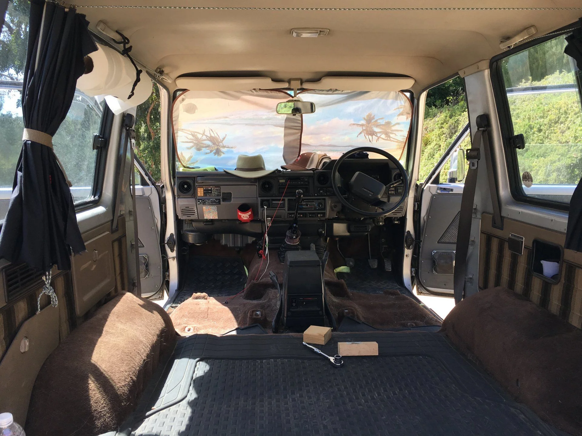

Finally pulled the seats and vacuumed the sh** out of the interior. Can you tell I've done two long trips with a dog?

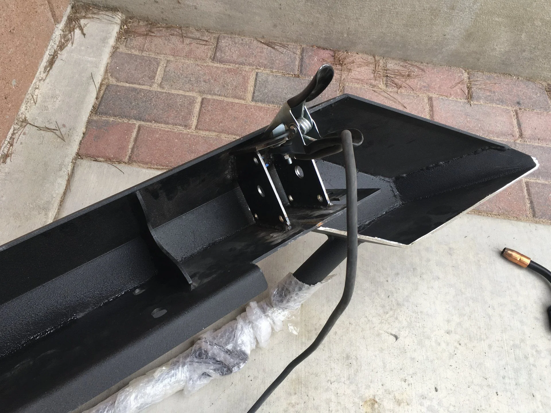

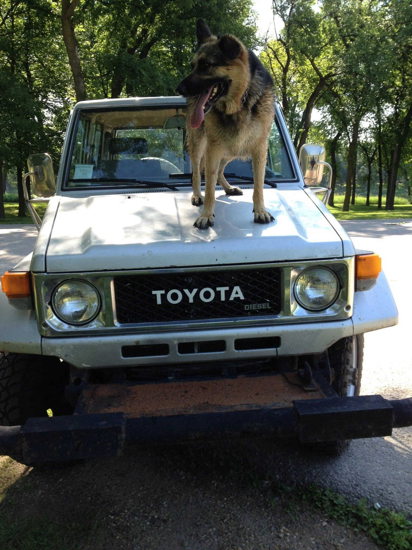

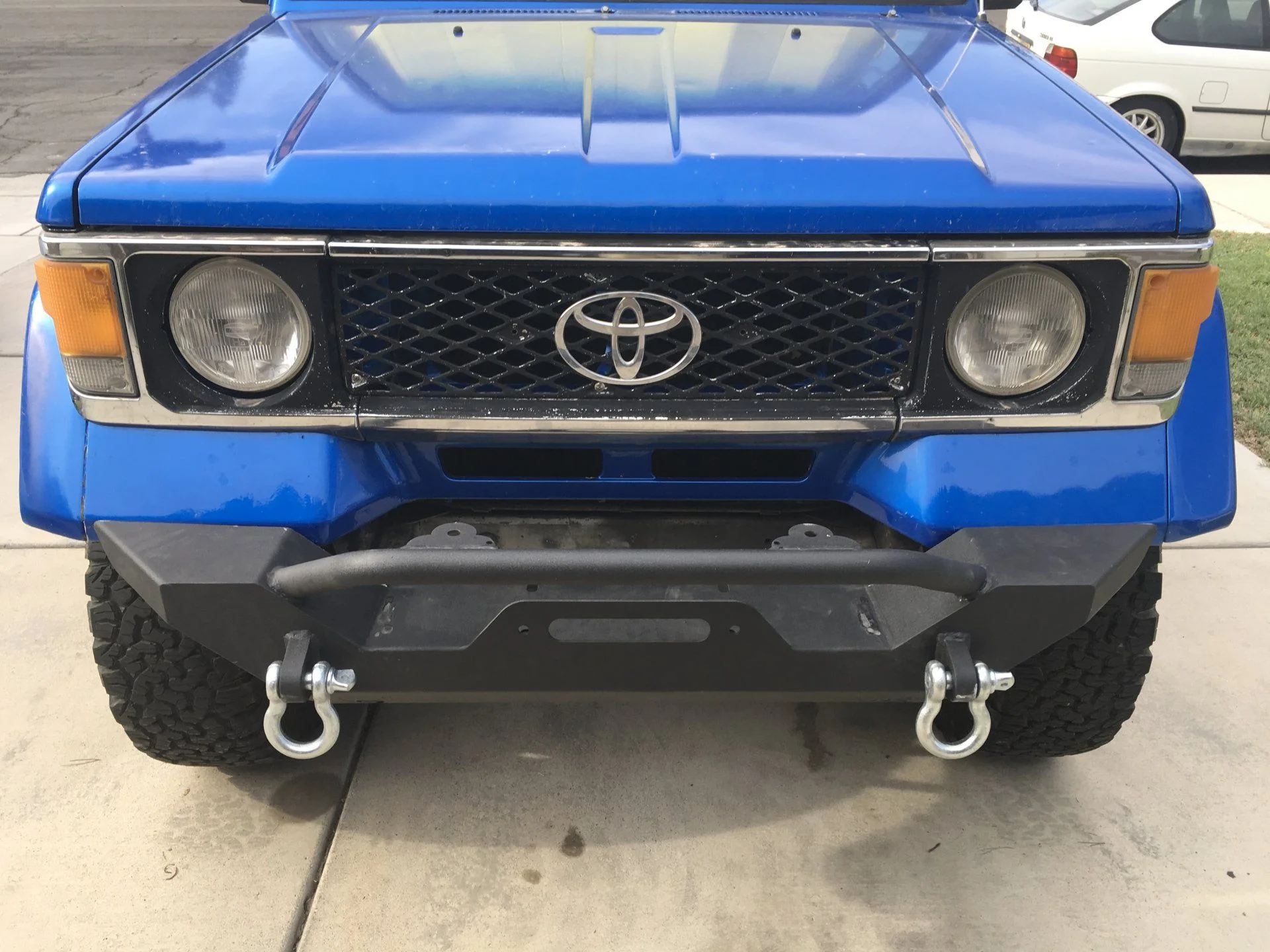

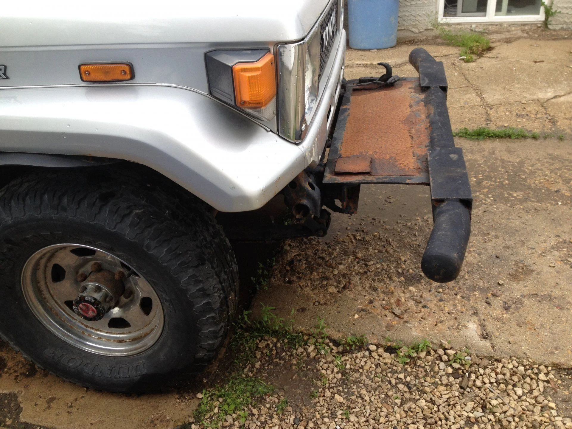

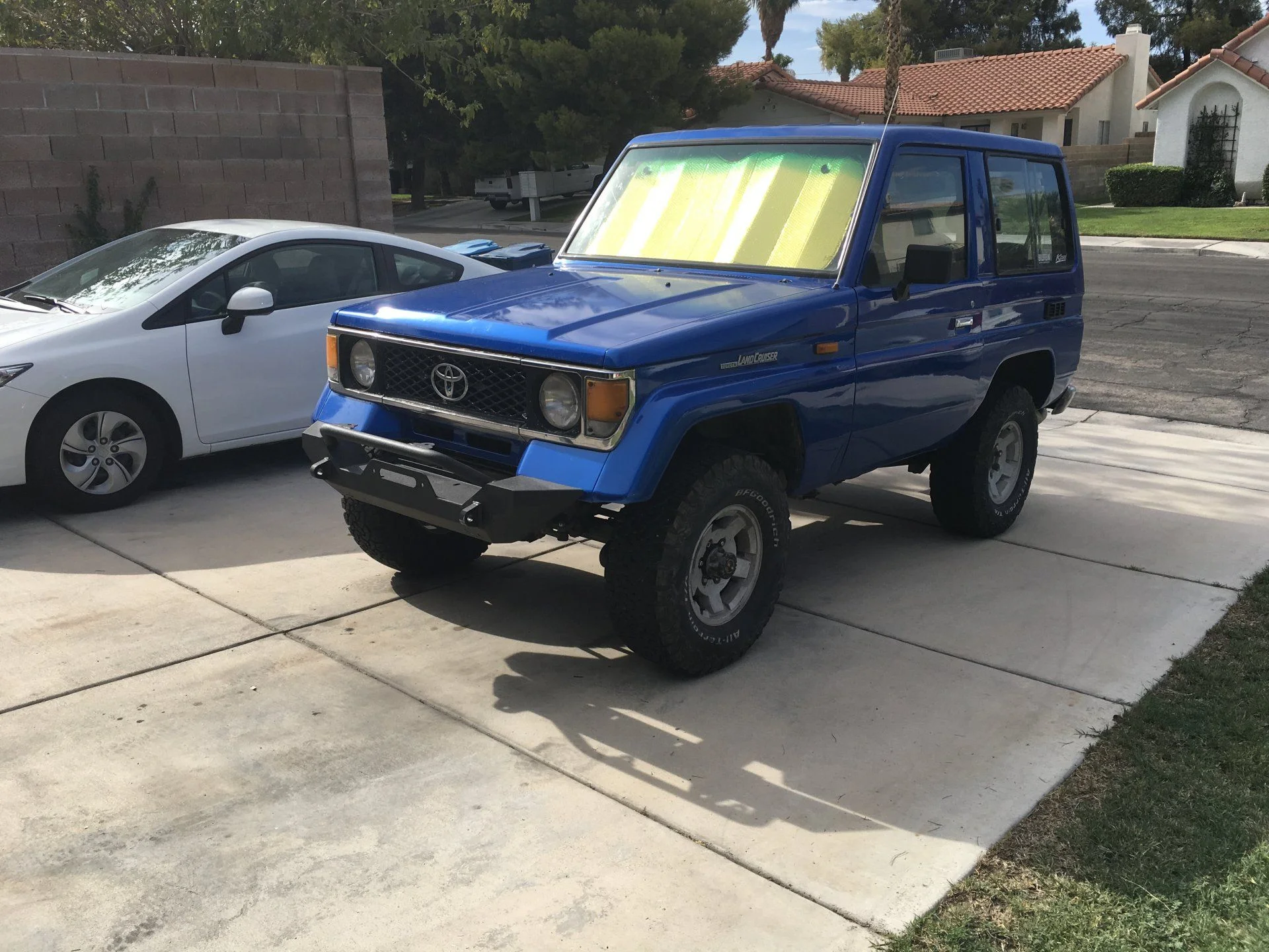

Really like your tucked in look nice and clean. I see a grnd clp. You make that? I need a new bumper to replace the monsterous platform on this bj

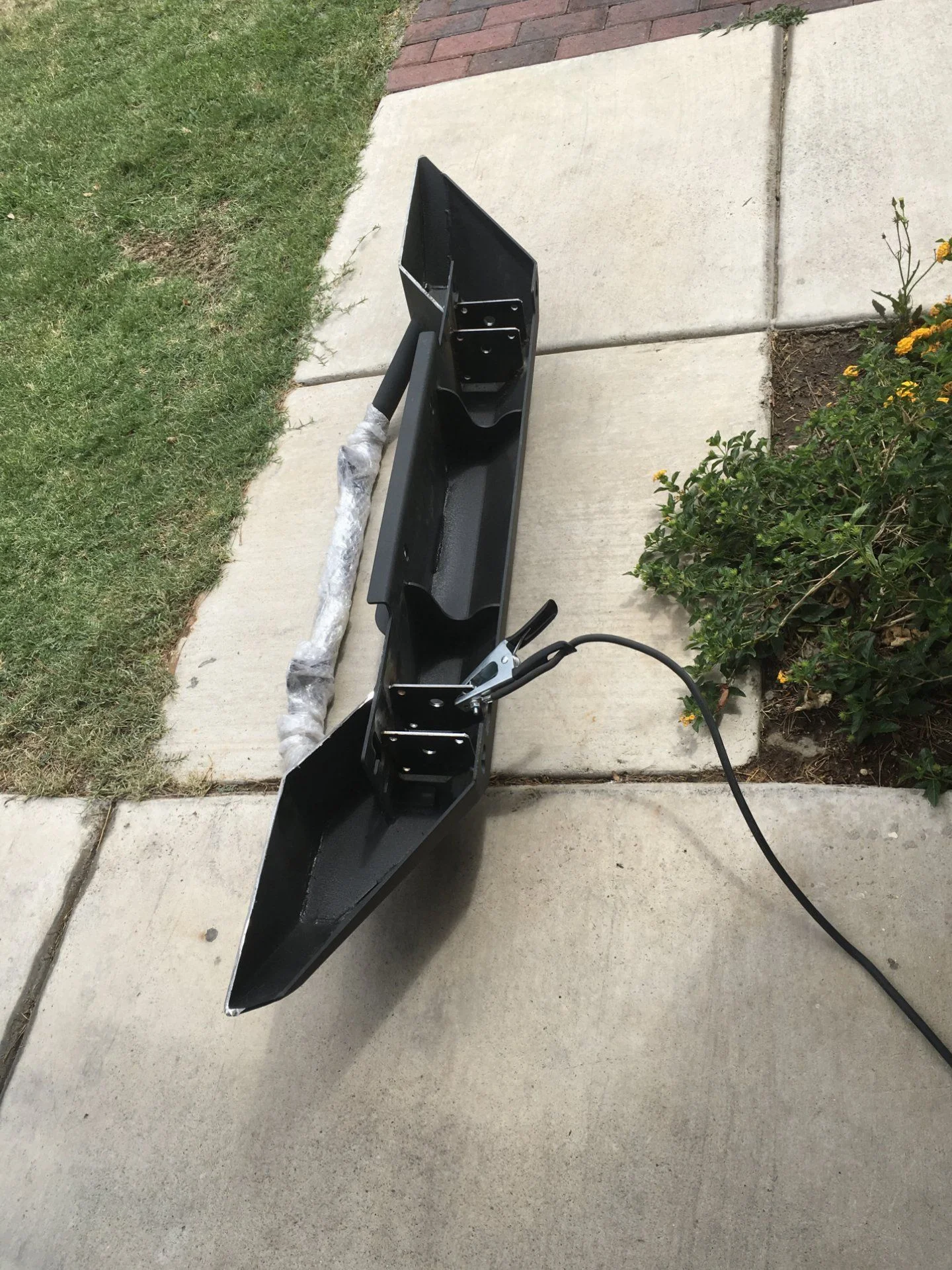

I wish I was that good to fabricate the entire thing, but it was a JK aftermarket bumper that I modified. These are $200 bucks with shipping on Ebay.
It took about a 10 hours to do it right. I need to get it re-painted since the welds took off the epoxy where the new brackets are.
I can tell you how I did it. It really wasn't that hard. Get some 3/16th stock at the local steel supplier and custom fit it in situ. Get some drill bits and a step bit and you are golden. You have to cut about 3/8" off the top of the bumper wings to get it "tucked-in" to the fenders or else it will hit. Email me and I can send you some more pics and give you some more details.
