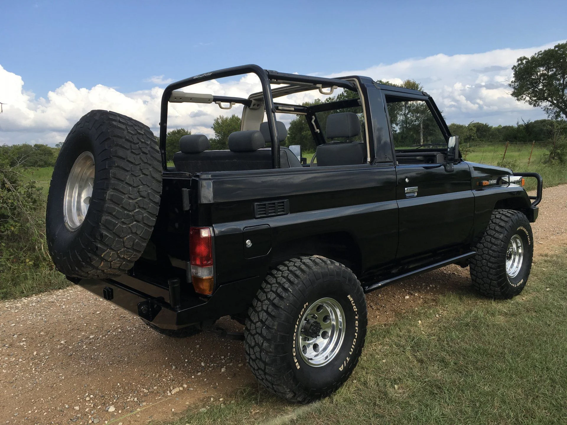

Got my HZJ73 back together after replacing some sheetmetal and new paint.Even installed new seats and new wheels.Now only wait a week or 2 on that softtop to get here.
That is downright sexy @joekatana
Thanks my friend, it is missing your decal now because I did a full res pray , send me another if you want so that I can show my appreciation to my favorite vendors/friends
@woody @orangefj45 got some room on that rear bumper ;-)
Gorgeous. Are you going to drive it? I see it's not in a museum that's a great thing. You will get lots of well deserved attention. Enjoy

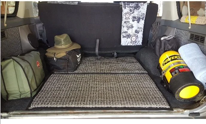

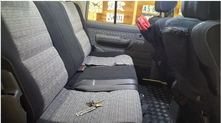

In anticipation of an upcoming road trip, I installed my rear seats.
WARNING:
For those of you that are driving either SWB or MWB Cruisers, this photo might be confusing. What you're seeing is actual cargo space and the photo wasn't altered to make it look bigger. :lol:
WARNING:
Was it altered to make it look like you wheel your rig? I've done the same to mine;)
Details on the Powertank mount? I'm assuming it's a Rob Smith special?
The recovery kit and tool bag is simply a cardboard mockup. The Powertank bracket was indeed modified by Rob.
(I can provide photos if requested)
