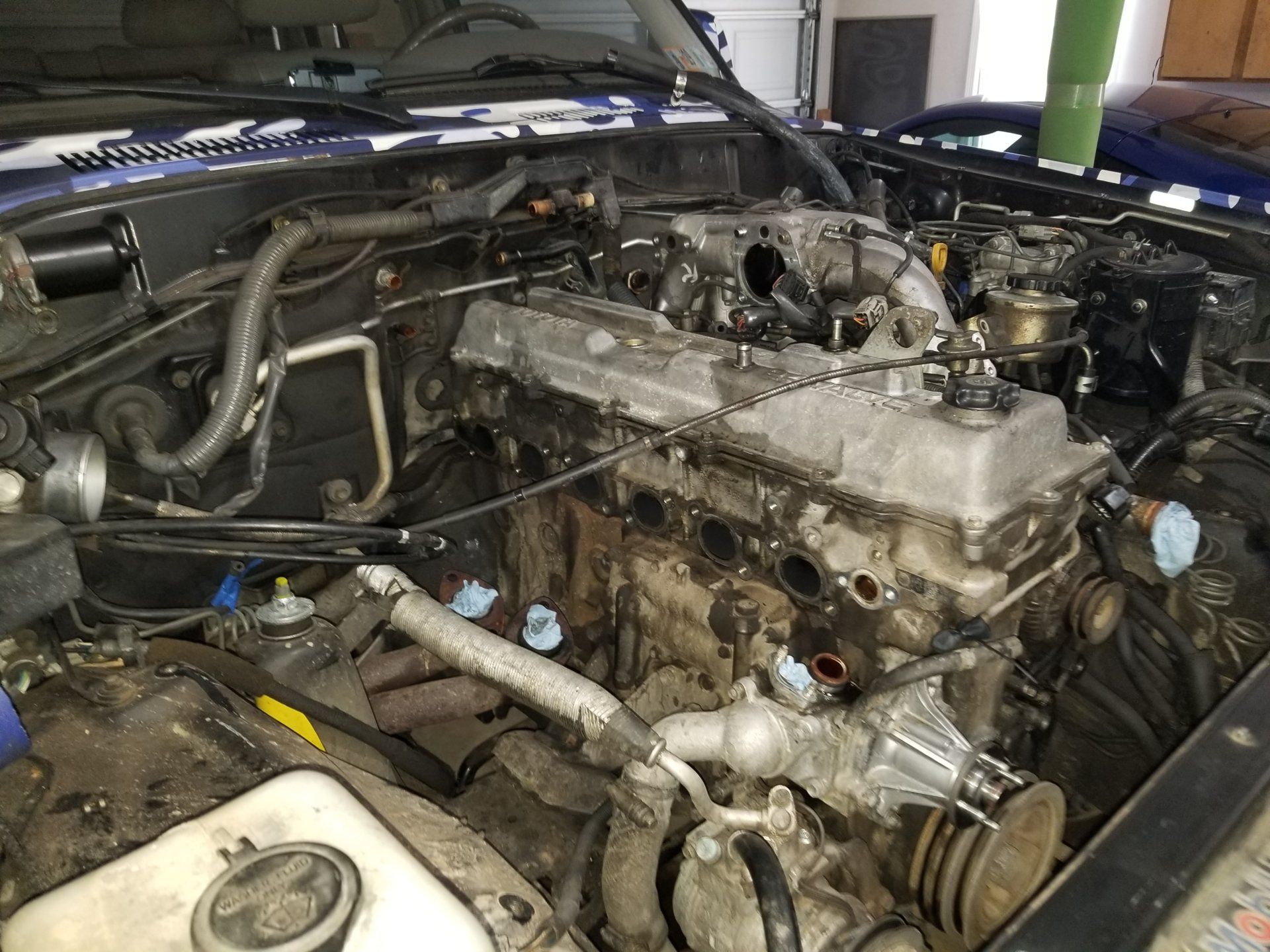

Progress .... keep getting hung up on stupid things like waiting on my kid or wife to help guide me to the rearmost plenum bolt so I can remove the upper half and getting the small internal coolant connection pipe to come out of the lower portion near the thermostat.
Haven't snapped anything off at this point, so WIN. Decided that rather than located and disconnect all the clips on the drivers side that haven't been apart since Clinton was President I will try to unhook the main plug inside and feed it backwards through the plenum. Many fewer connectors that way and I already have the 3 undone near the oil filter, just need to locate the VVT hoses still and I can cut them and replace if needed.
Would it really have been that hard to design the plenum to have the bolts on the top ... sheesh. Hoping to have the head off by the weekend if all goes well. Hoist and trolley for the I-beam in the garage should be here Friday and the other parts are showing up daily. @Crusha ... I'm already double your initial estimate in parts and tools.
I hope pulling the wiring harness down through the intake works for you. I followed the F.S.M and pulled everything up through... a royal P.I.T.A... transmission connectors especially near impossible to disconnect.
Yeah, that was my concern after spending 30+ mins getting the two connectors off the oil pan area and another 30 mins trying in vain to get the forward knock sensor disconnected. I may get lucky and be able to lift the head enough with the hoist to remove the lower plenum in the air and not disconnect anything, but will need to get the 75lb hoist and trolley mounted first. It came yesterday in a crate that was destroyed by UPS, so I hope it's all there.
Finally got the last nut off the upper plenum (what a PITA) now need to find the VVT fittings and I should be able to start moving forward again. Had a neighbor stop over yesterday that just had a tree taken down and offering wood, so I had to squirrel for the day and grab that up. Off to watch the OTRAMM video for the 11th time to get the next steps down.

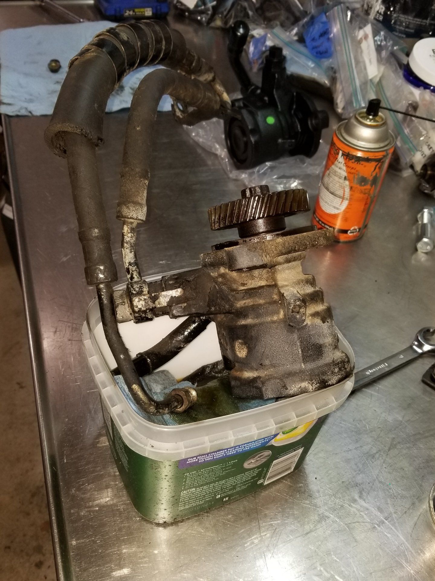

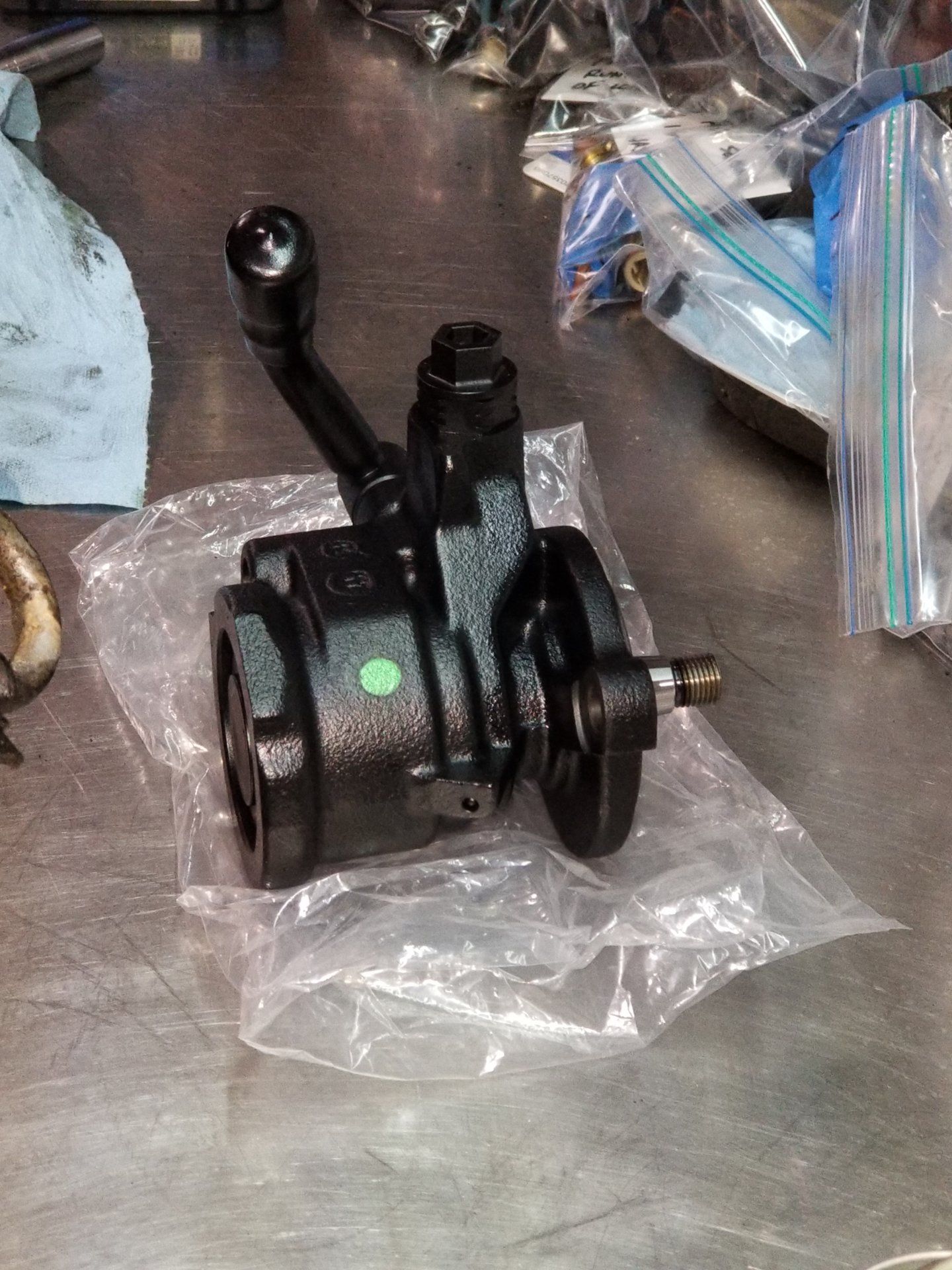

Well, the "while I'm in there" stuff has begun. Might not be the best decision to see how many things I can tackle at once, but the steering was starting to groan a bit and so much stuff is already out of the way.
Got the old gear off, now need to get the new one on. Can anyone confirm if I need to press it to a certain depth on the shaft or just tq the nut to 54 ft/lbs?

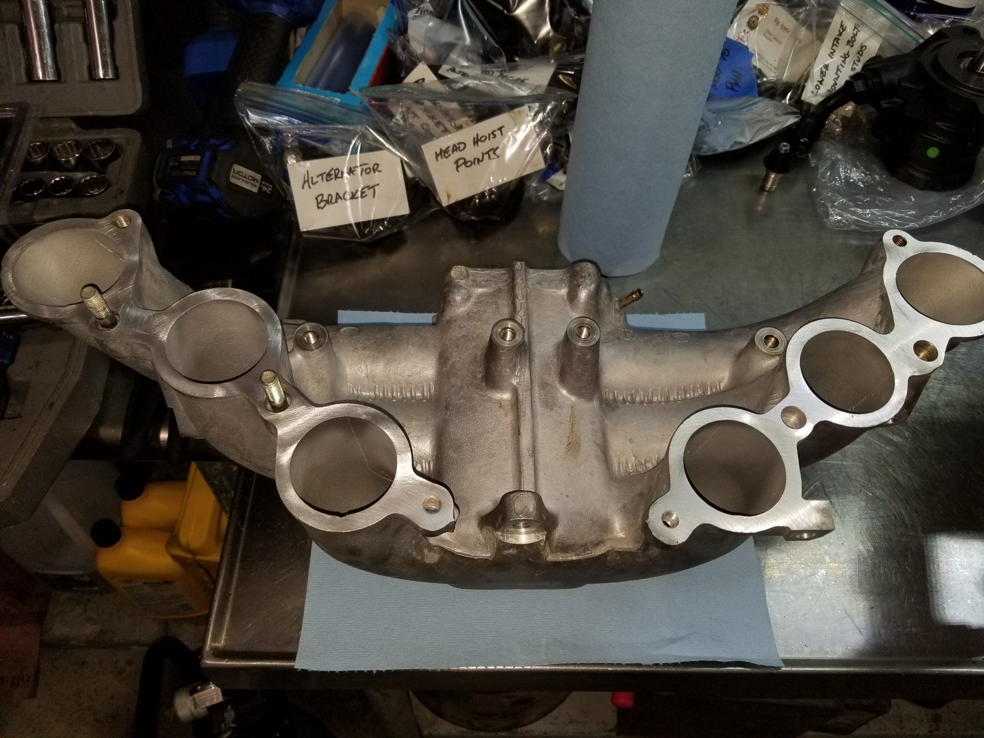

First parts back from being cleaned ...
Soooooooo clean .... very happy.

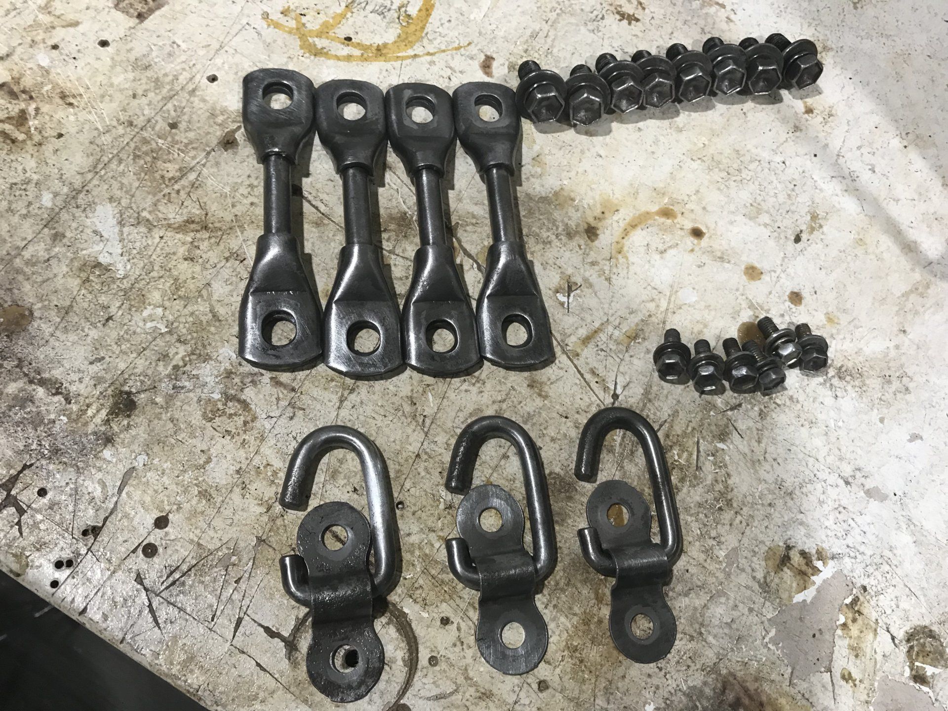

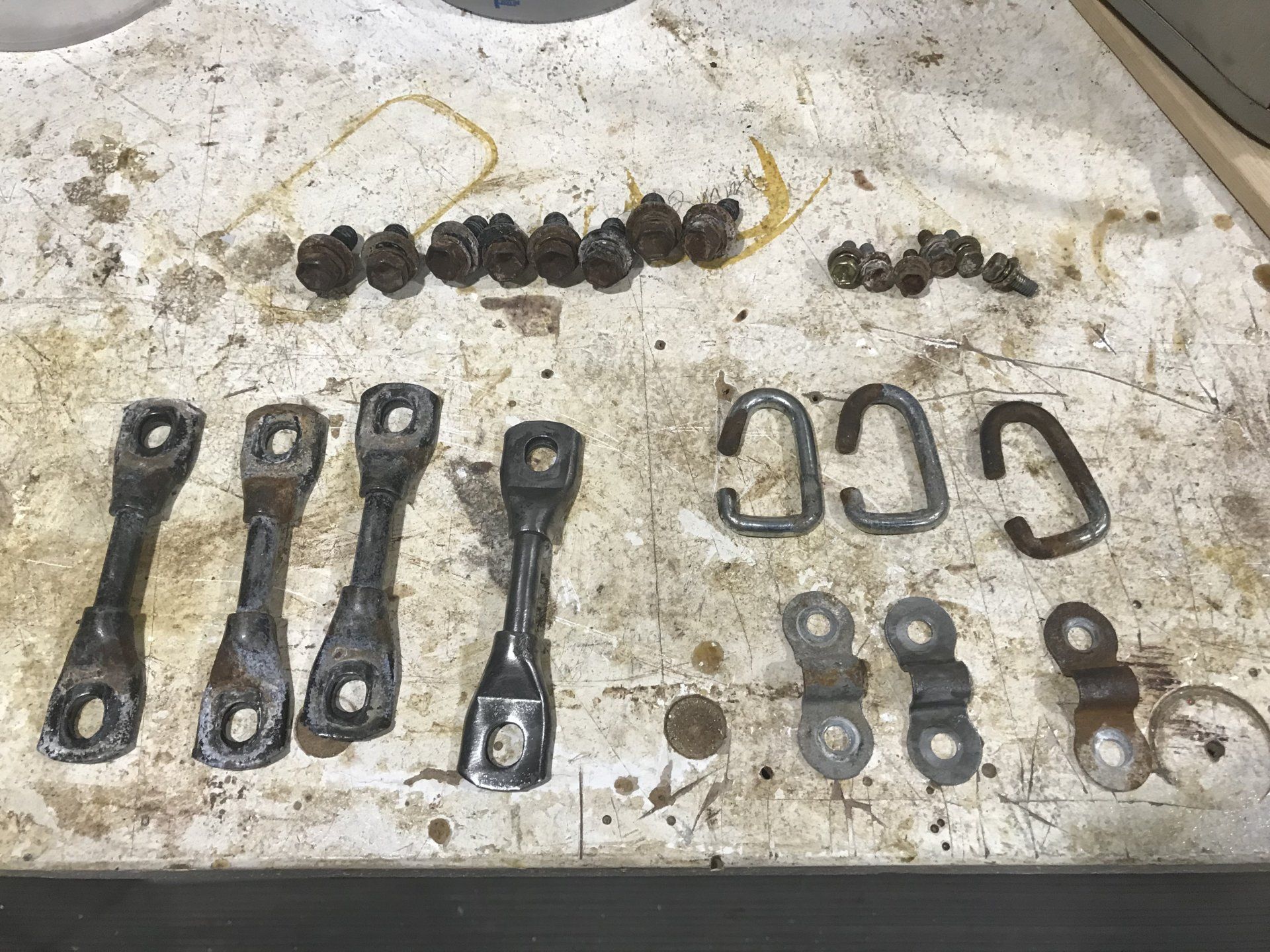

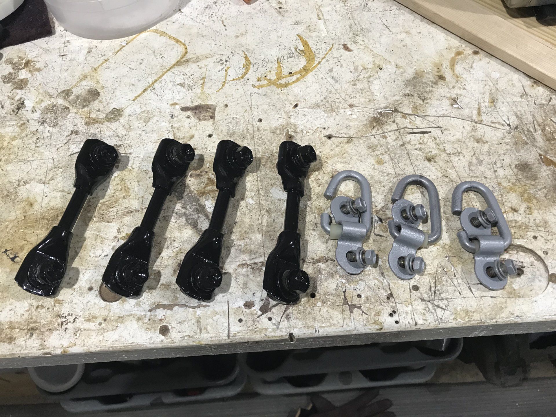

I purchased a powder coating gun from Eastwood last weekend and decided to test it on some brackets on the 80 today. So I ended up pulling out the hold down hooks and 3rd row seat floor brackets. I cleaned all the parts on a wire wheel, then made a spray booth out some old cardboard boxes, and used an old toaster over to bake the parts. Tuned out pretty good.

New steering pump is in:

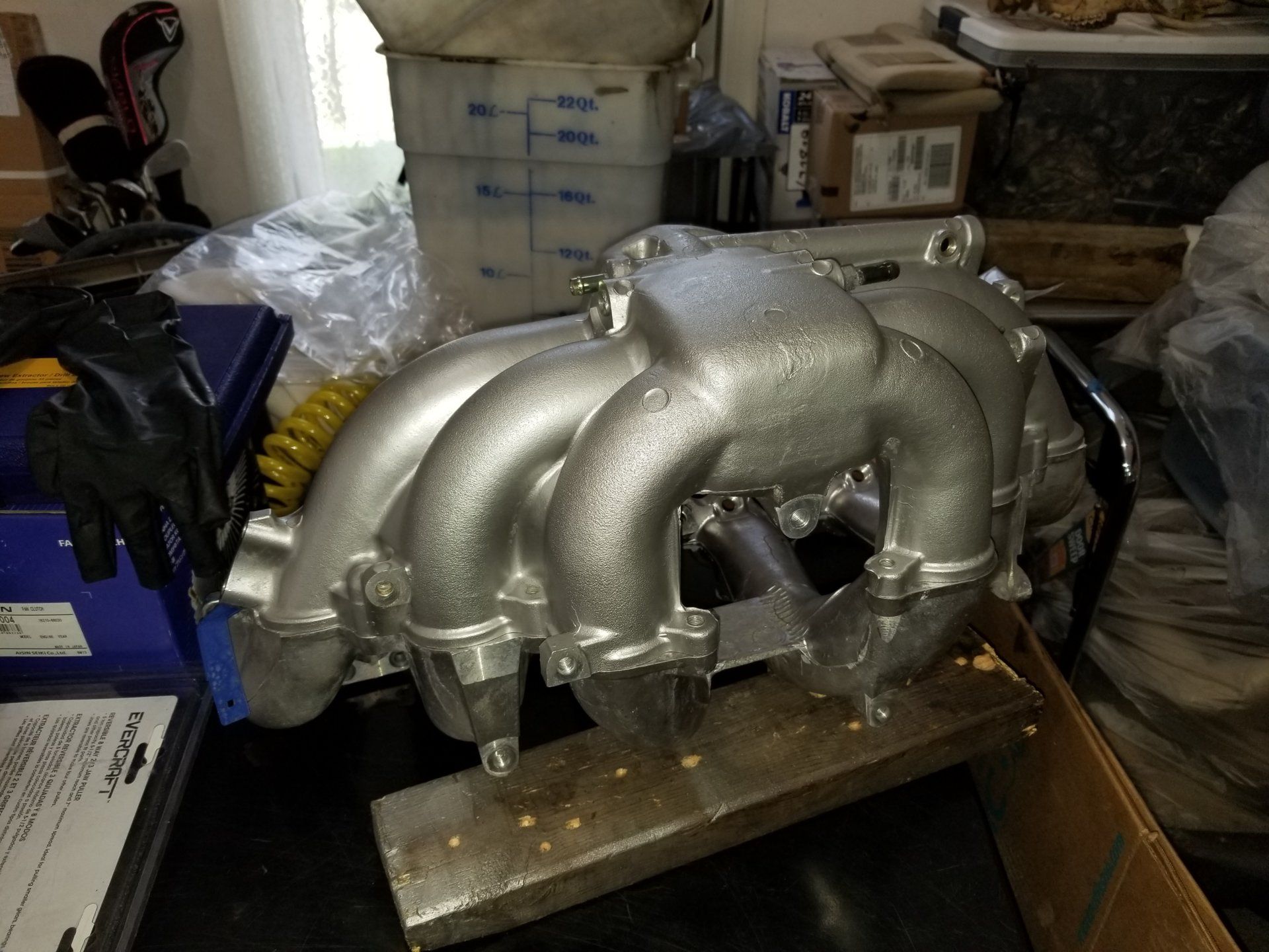

Painted the upper plenum:
