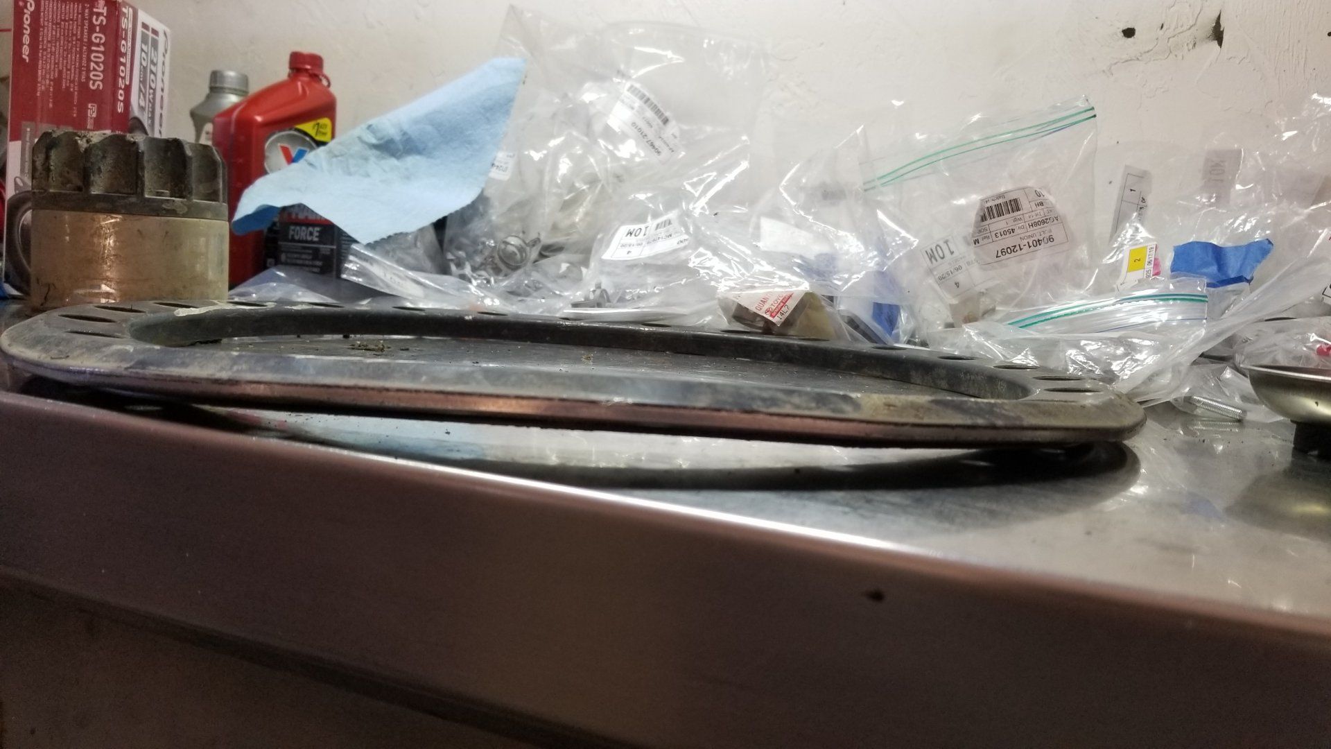

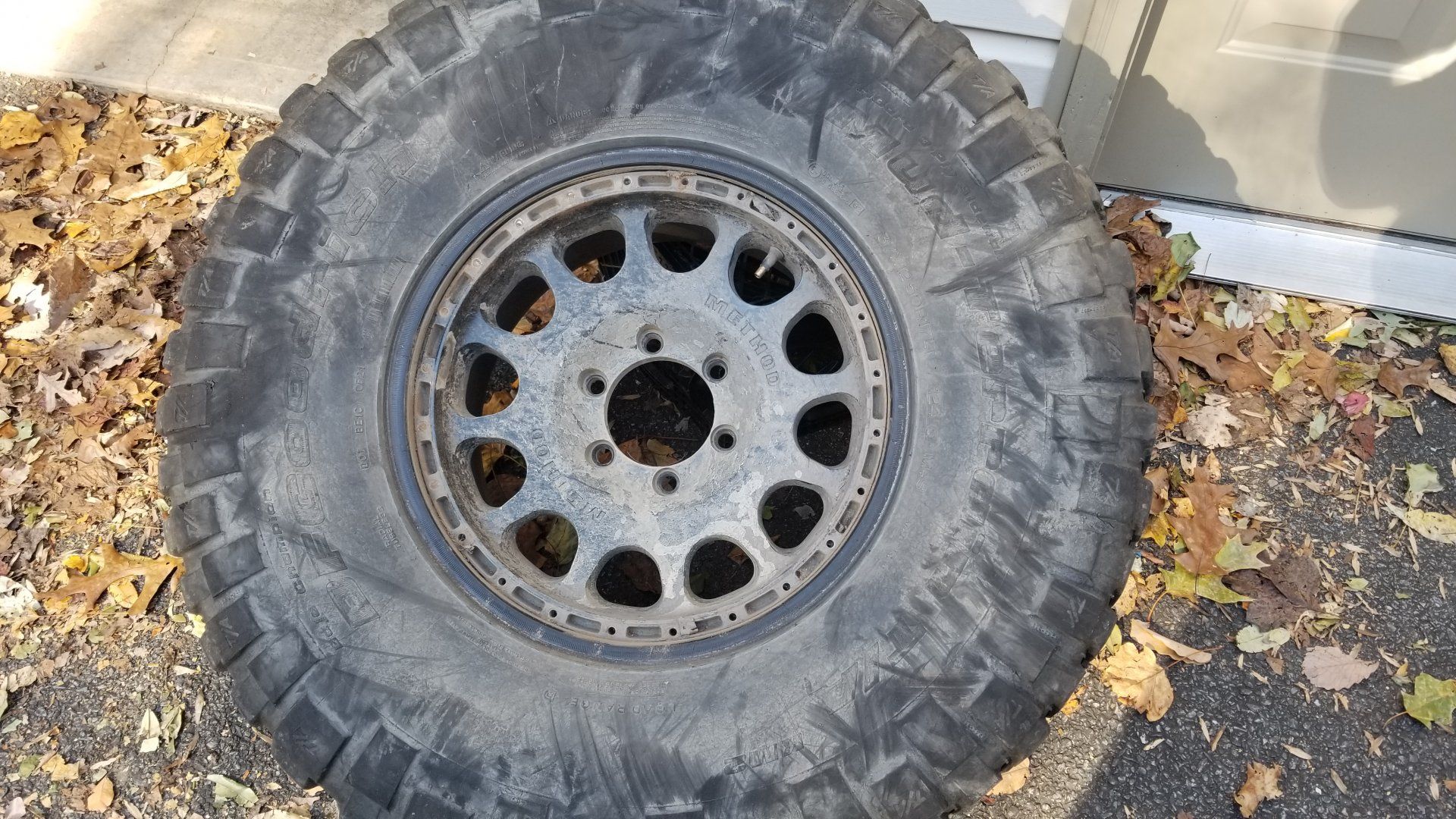

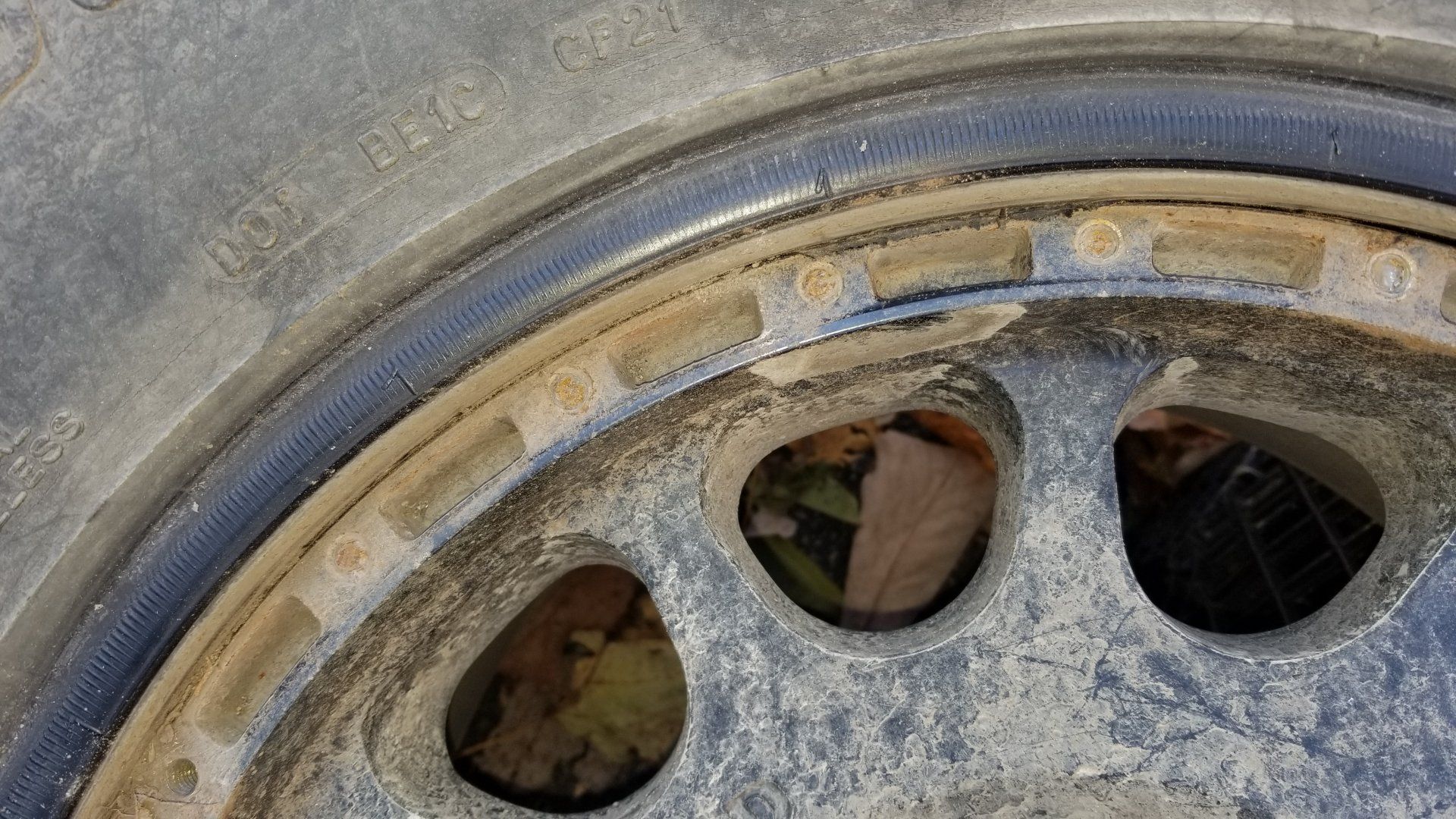

Also, I'm down a spare now. I had been losing a bolt or two from the LF rock ring, ended up being 7 bolts now. Realized they weren't backing out, but instead they were snapping off. The ring is now bent and deformed and the wheel has 7 snapped off bolts to get out somehow. Best guess is that I hit something hard enough to shear the first bolt head or blew the bead and then the pressure just kept snapping them off over time. As soon as I removed the first ring bolt air came rushing out and the tire fully deflated. Once the ring was off, the tire was off the bead as well.
TLDR: Tire is off the bead and rim needs to be repaired.
Snapped off ring bolts
Tire after the ring was removed
Pretty sure this will need to be replaced unless Brian or Andy think it can be pressed flat again?

If it were mine I'd bolt it back up. What grade and size of bolt were used before?

Top pic left most bolt hole. Is that a crack?
@brian ... aluminum
@jamarquardt22 ... no crack, I just checked. Hardware is 5/16" x 1.25" - 18 thread. I grabbed up some grade 8 hardware from Ace, but not 100% that was my issue. None of the other wheels are missing any bolt heads, just all in a row on this one wheel.
Trying to decide if removal is something I can try or if I'm better taking it to a machine shop? Some of the bolts were tight coming out. The impact had to work to get them loose.
I agree with this as long as the wheel is true and the ring isn’t cracked or creased. That aluminum ring should pull back into place, just tighten the bolts slowly in small increments and go in a cross-pattern around the wheel so you don’t stress one side out.
EZ out the old bolts, then clean and re-tap the threads before you go after it with new hardware. If there’s too much resistance, somethings wrong and don’t just attack with the impact.
I would not put an EZ out anywhere near those bolts. If some of the bolts where tight coming out, then they are likely corroded into the aluminum.
I would first try drilling with a small left hand drill bit. You might get lucky and then just back out. If you get the drill good and centered, then proceed up the size chain until the remains are removed. If not, then I would weld nuts to the remains of the bolts. This method works, and shouldn't damage the finish of the wheel.
Second @Crusha's suggestion for reassembly. Might want to pull the bolts from the other wheel and coat them too.
