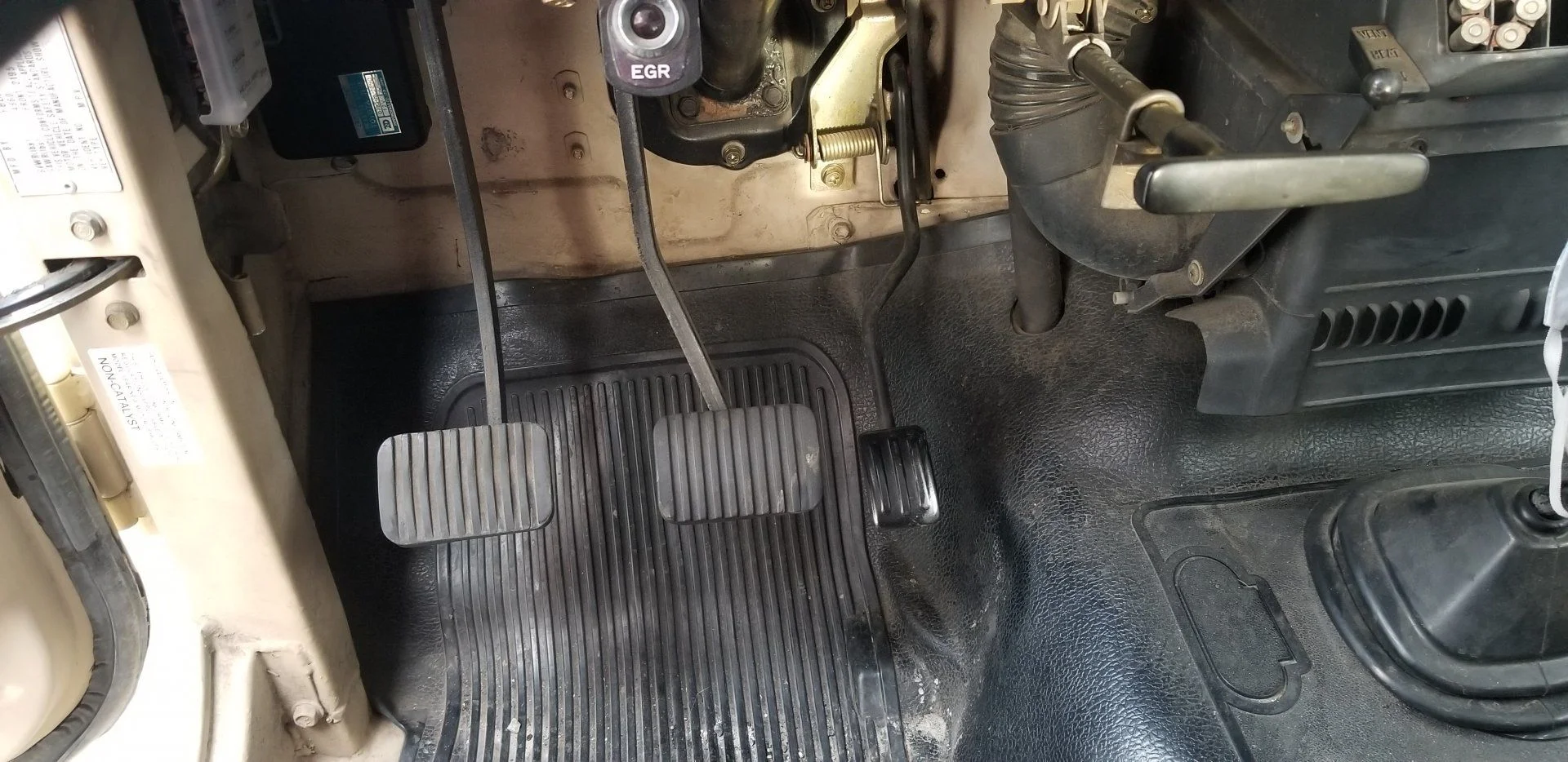

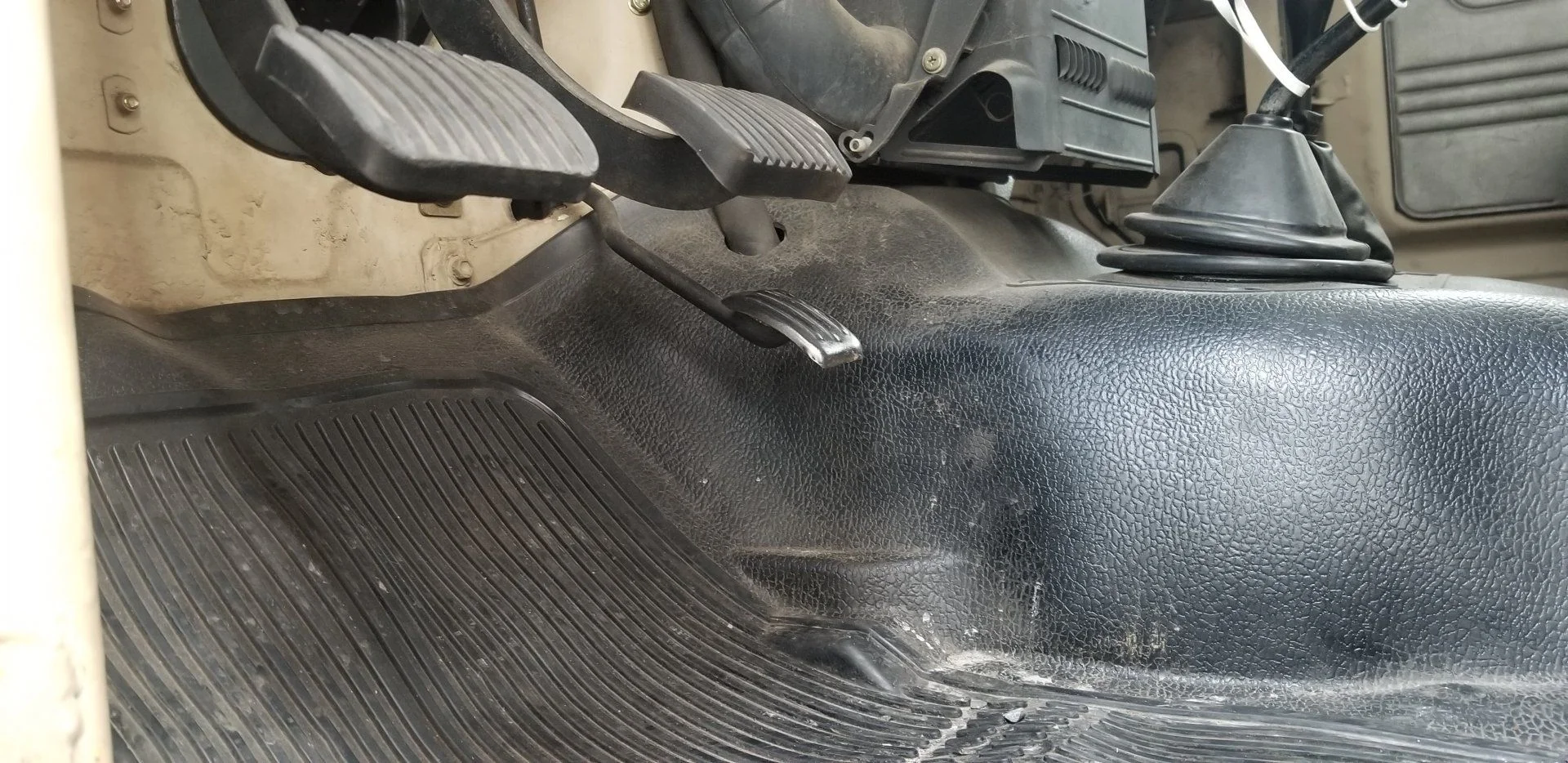

The way it should be setup...the brake and clutch pedal are well above the elevation of the accelerator pedal. Like high enough that if you side step the accelerator pedal from the resting position your foot would slide under the brake pedal nearly without interference.
The brake pedal should have the brakes firmly engaged by the time its depressed down to the elevation of the accelerator pedal.

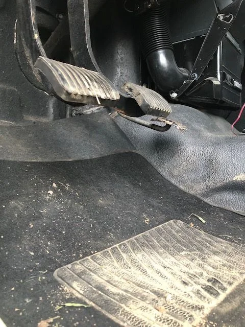

Hmmmmm. Mine is not. Is it adjustable? I forgot to even take a look when I took the pic. :rolleyes:
This truck does have a glass tub.
My concerns are getting the sole of my boot caught under the brake pedal, when trying to lift foot off accel to depress brake, as well as accidentally engaging the accelerator when depressing the brake.
Seems like maybe, I need to rebend my accel pedal, unless it is actually adjustable. :hmm:
On a slightly related note, we also have a 1963 Beetle, and the pedals are sooo close together, I can only drive it barefoot, while wearing a tie-dyed thong!
your accelerator pedal looks like its bent upwards, and the clutch and brake are set low, as if the PO was trying to get them all in a row.
yes there is an adjustment on both the brake and clutch pedals.

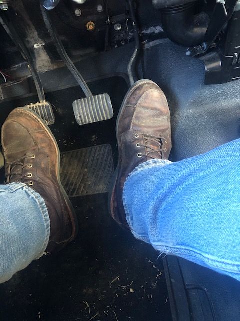

I've been daily driving the '78 40 lately, and the brake pedal is dangerously close to the accelerator pedal. I have about a 1/2" between the pedal and my foot.
I have a few simple ideas to correct this.
1. Heat, and rebend, the brake pedal.
2. Trim the brake pedal pad on the right side, and find a new rubber cover to fit.
3. Is there an earlier, or later, brake pedal I could swap right in without having to modify the stock pedal?
I'm hoping #3 is an option...
Open to all suggestions.
Wear narrower shoes...
In all seriousness, my truck might be a bad example because the gas pedal is modified, but the gas sits far lower than the brake on my truck. They're tight but I've never had an issue accidentally stepping on the gas when I meant to hit the brake and vice versa. I've got to raise my foot substantially higher to hit the brake.

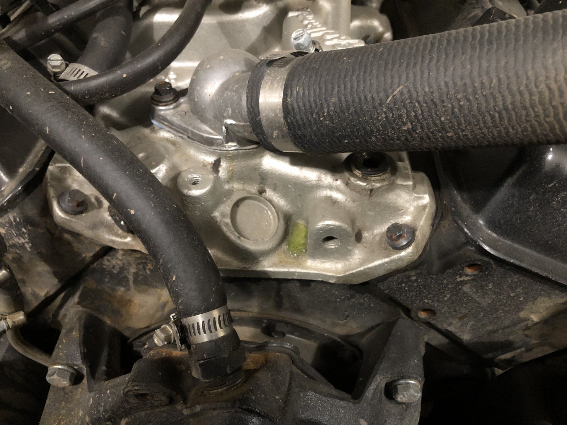

Well, the overnight temperature dropped into the 30’s - time for the annual weepin’ of the coolant from every damn hose on the truck.
I’m sure this has to do with metal contracting under the rubber but you’d think after tightening the hose clamps no less than 3000 times this would stop.

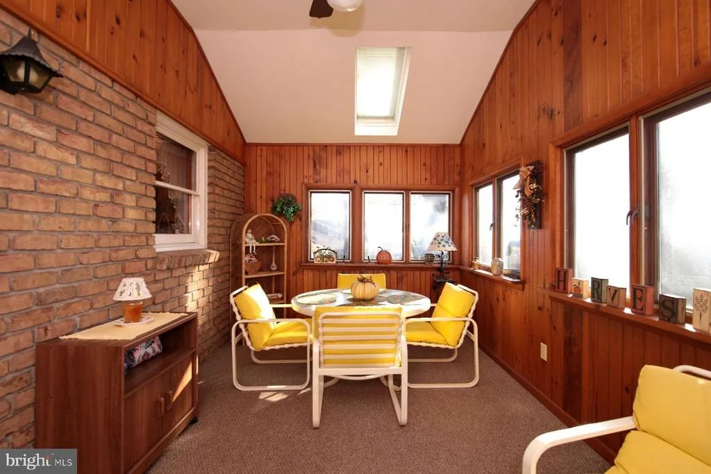

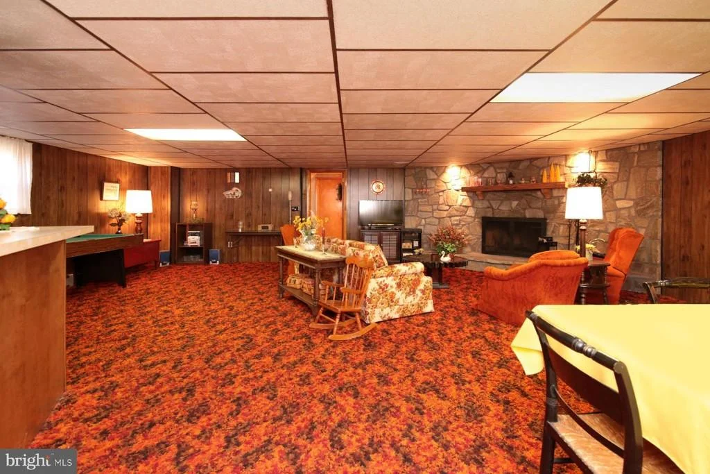

just a two car attached, not as large as i would have liked, but there is plenty of storage space in addition to it.
it's a one owner 1975 bi-level, that looks like it never left the 70's....which we absolutely love.
to say i'am a motivated buyer is an understatement.
