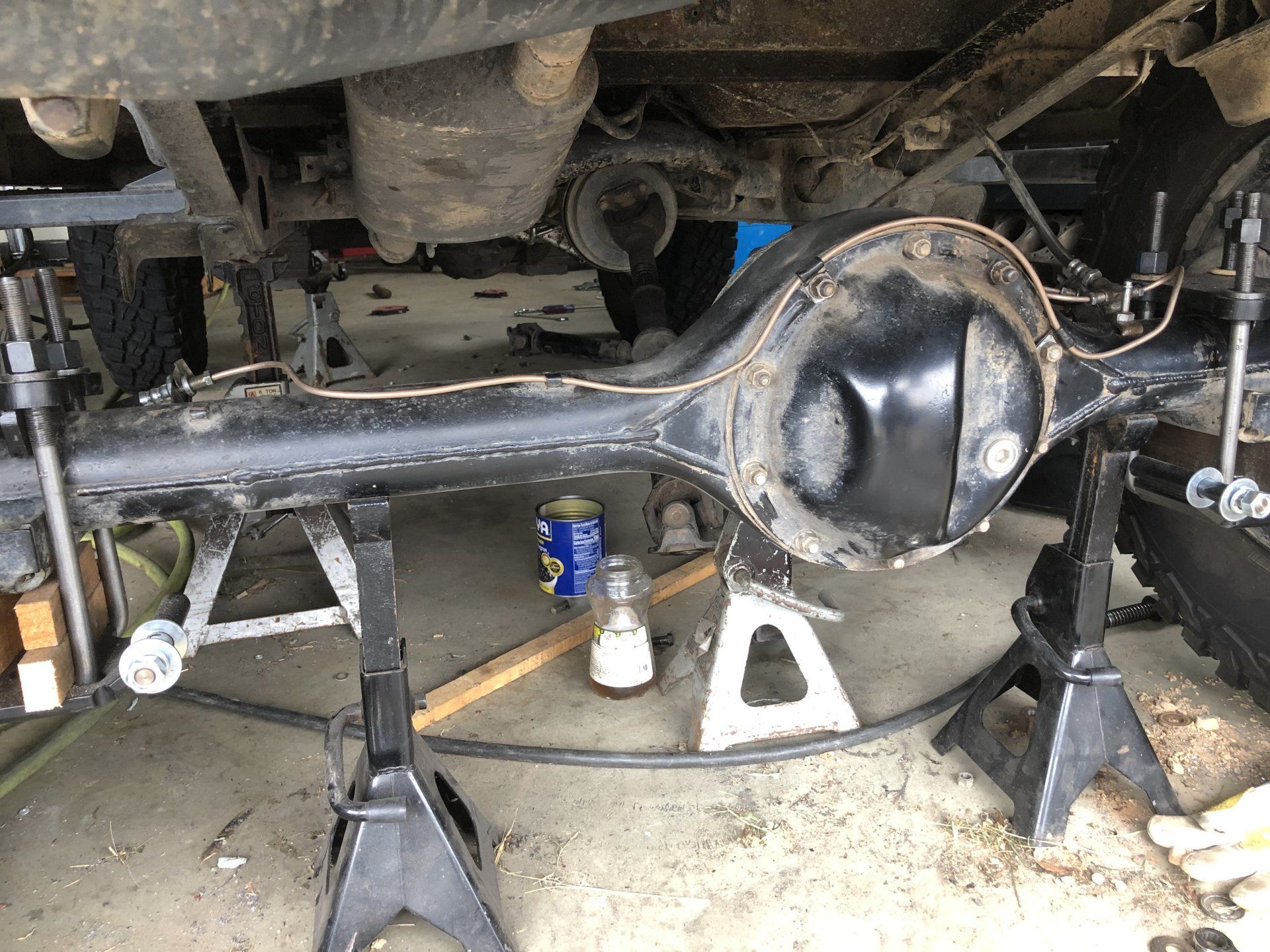

Brake lines made, new tabs welded on (check)

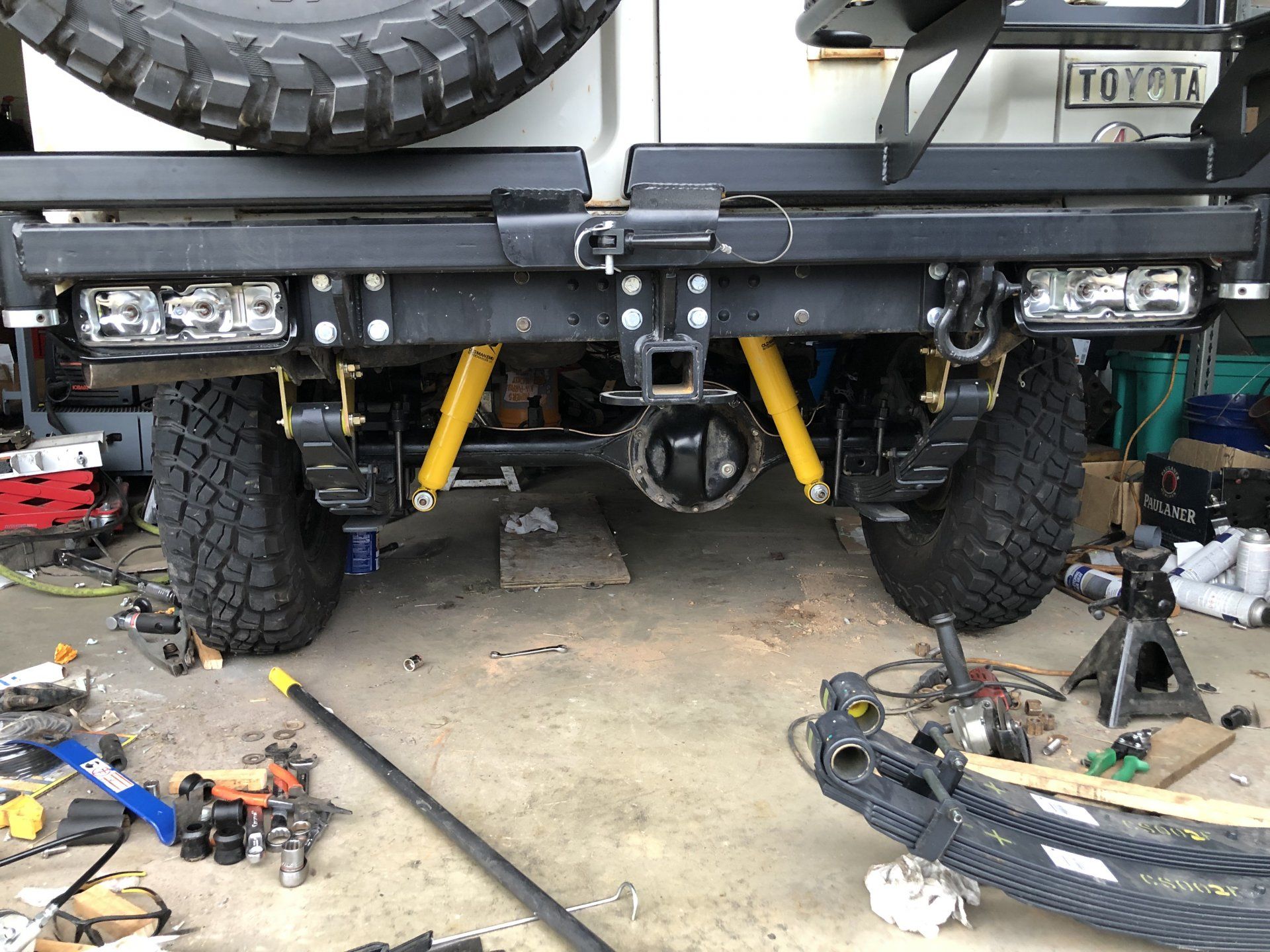

OME springs are in on the rear. Actually bolting them down got delayed due to wet paint. Hoping I might get to it and the shocks tonight.

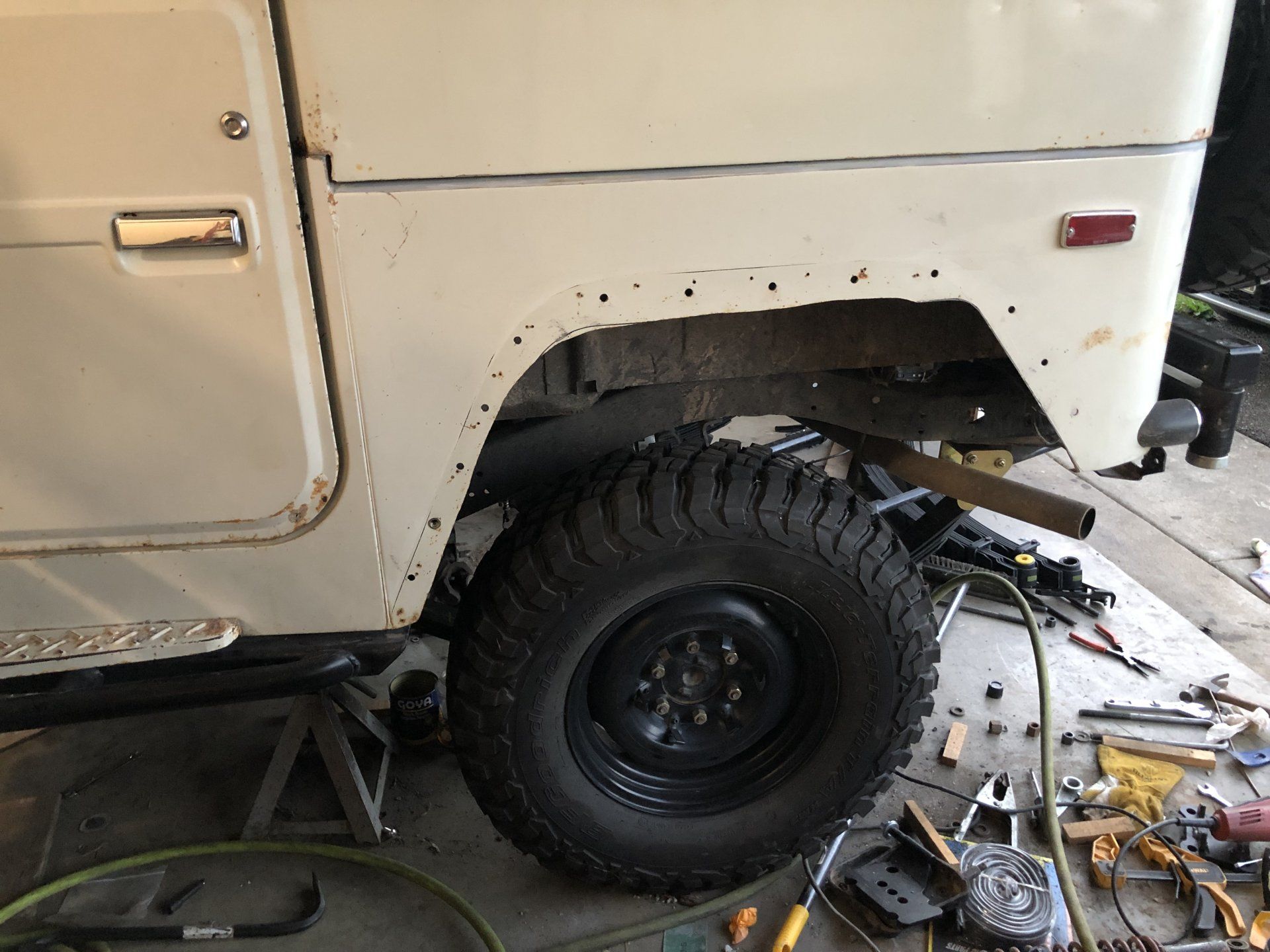

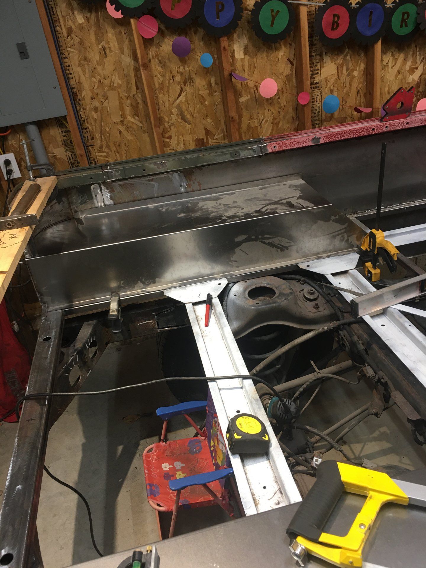

And this happened. Still very uncomfortable with how cutting quarter panels makes me feel - even if they’re totally mangled already...
At least my cuts don’t look like they were done with a sawzall.

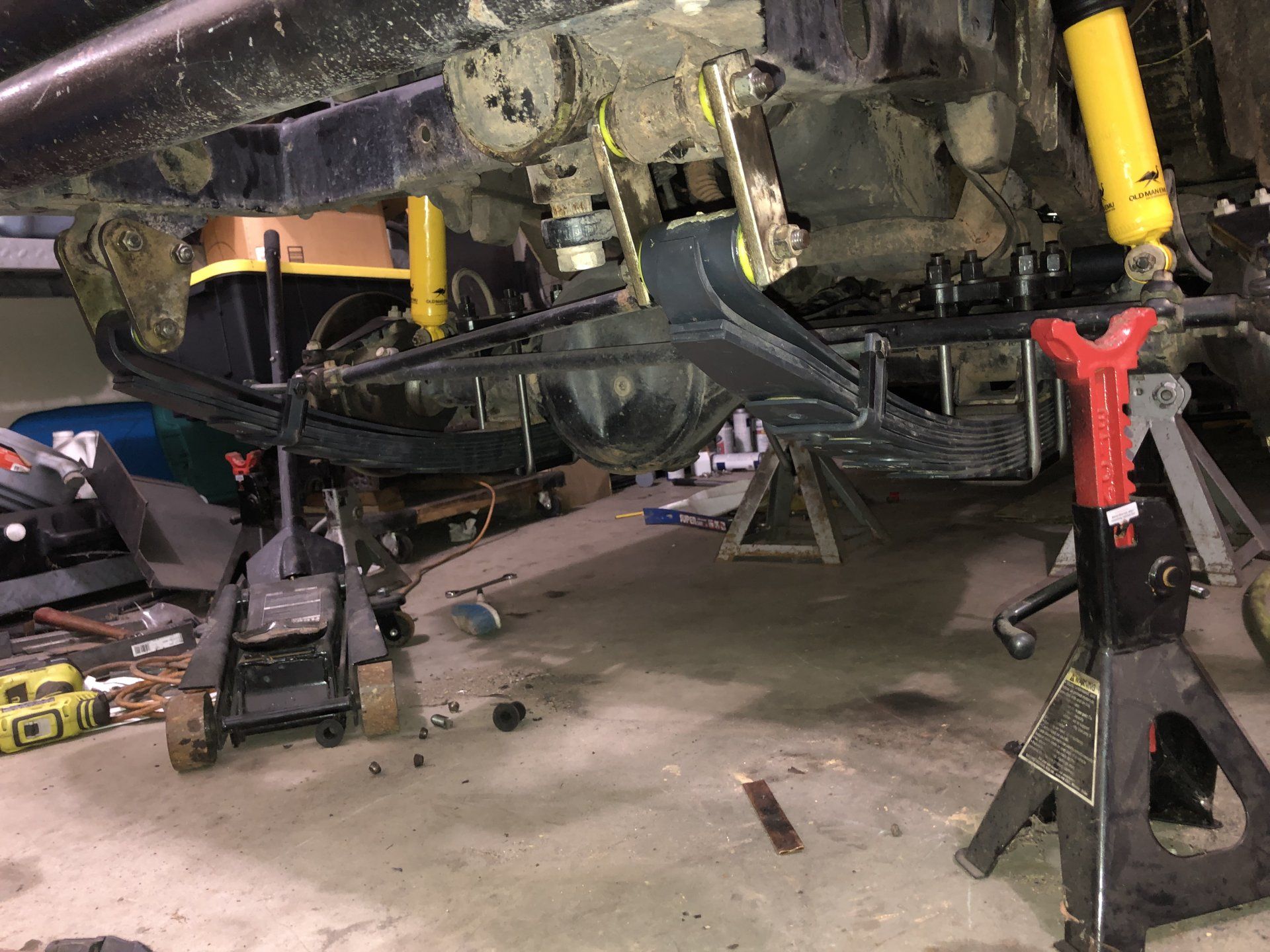

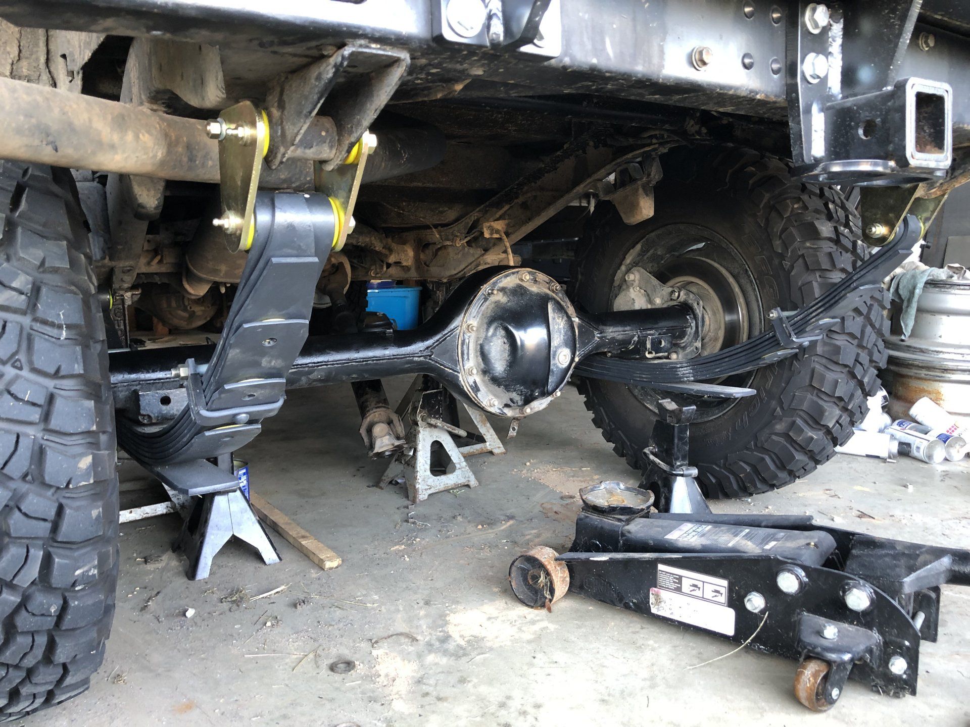

Well the truck was briefly back on 4 wheels.
The back springs are in, so now it’s time for the front.
Naturally, the truck won’t accept upgrades without fighting me tooth and nail.
Cut off the U-bolts because the bottom plates and nuts had become one after being dragged over the rocks.

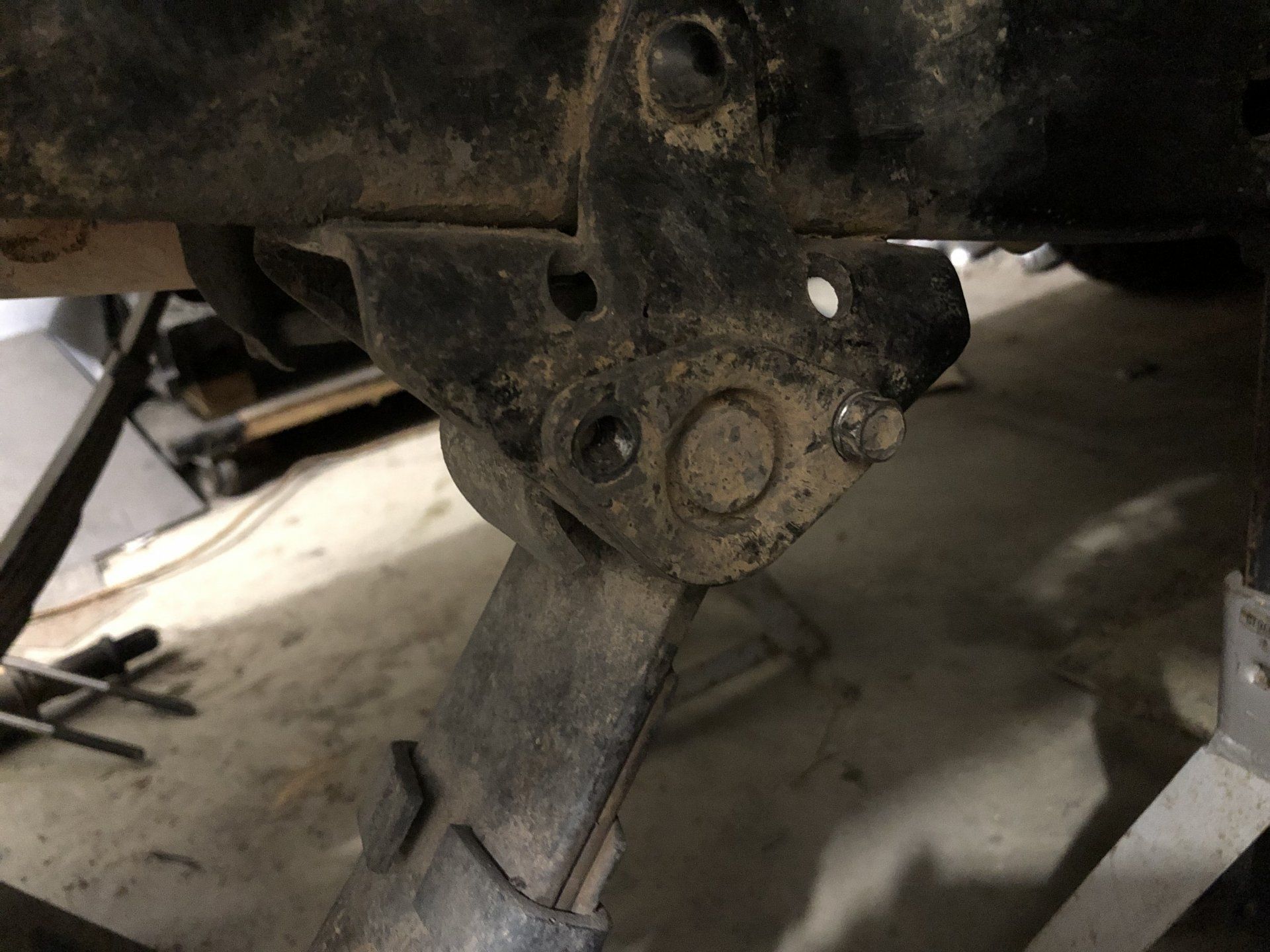

One spring pin retainer bolt on each side is stripped. There’s no nut retaining this just threaded right into the 3/16ish steel. These will need to get ground off, drilled out, welded shut, and re-drilled. Not impossible but not something I needed when I have a deadline.
I thought I’d gotten lucky and wouldn’t need to re-route the brake lines up front to accommodate the U-bolt flip. It was close, but it looked like I could just bend the brake tab slightly. Unfortunately when I went to do that I got a reminder that my father in law and I had been having issues with his welder that day...
At least it failed now...frankly I’m shocked it was attached at all.

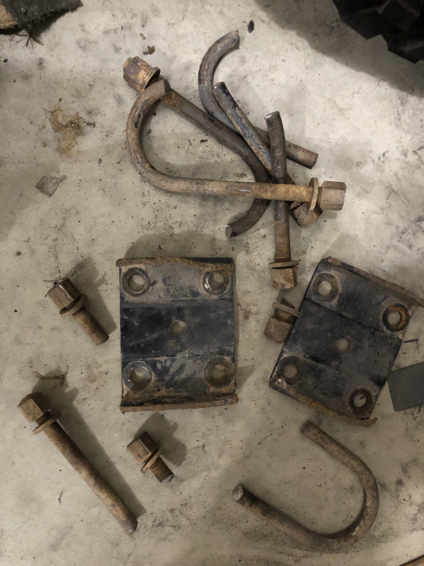

One spring pin retainer bolt on each side is stripped. There’s no nut retaining this just threaded right into the 3/16ish steel. These will need to get ground off, drilled out, welded shut, and re-drilled. Not impossible but not something I needed when I have a deadline. View attachment 2467469

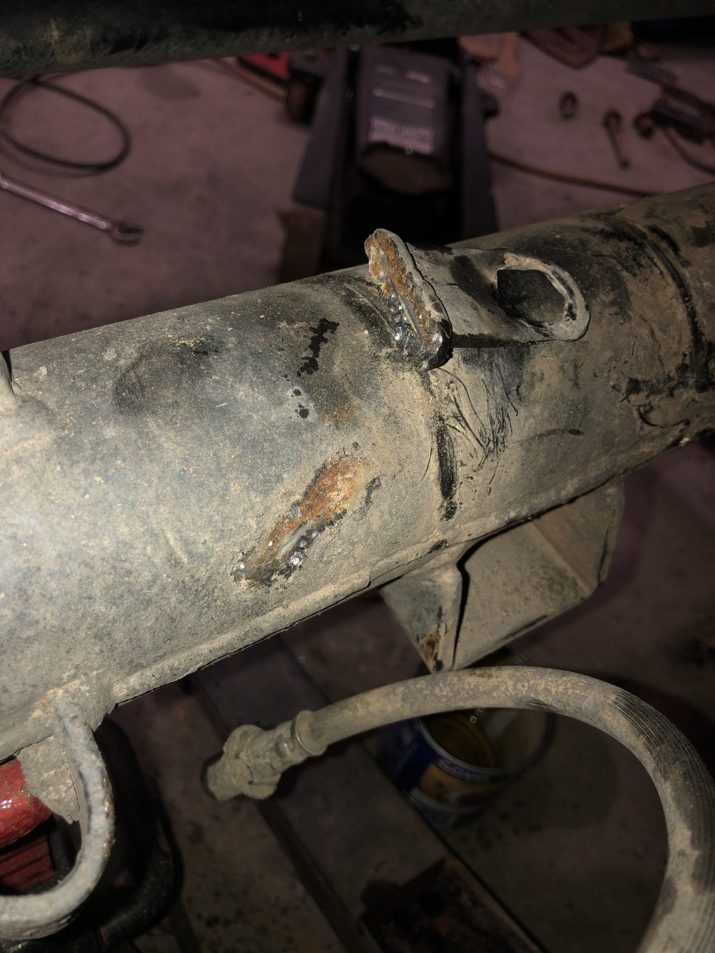

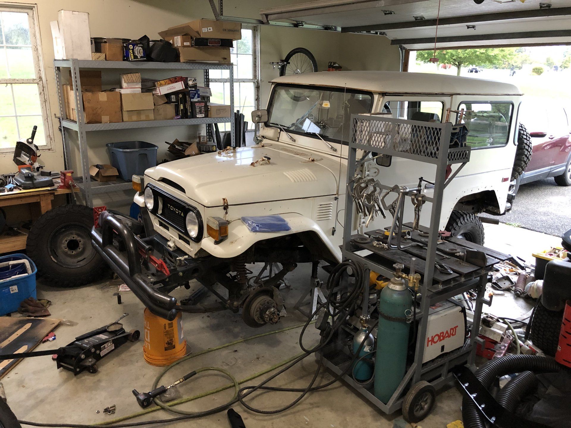

Are u using Home Depot bucket as a jack stand?
Hellz yeah those things are sturdy! Is that an issue???
No, I’m all seriousness the Depot bucket is holding up the power steering box since I have to remove it to get the shackles out. I also have to grind down the shackle and shorten the nut/bolt on that side. Tight squeeze is an understatement.

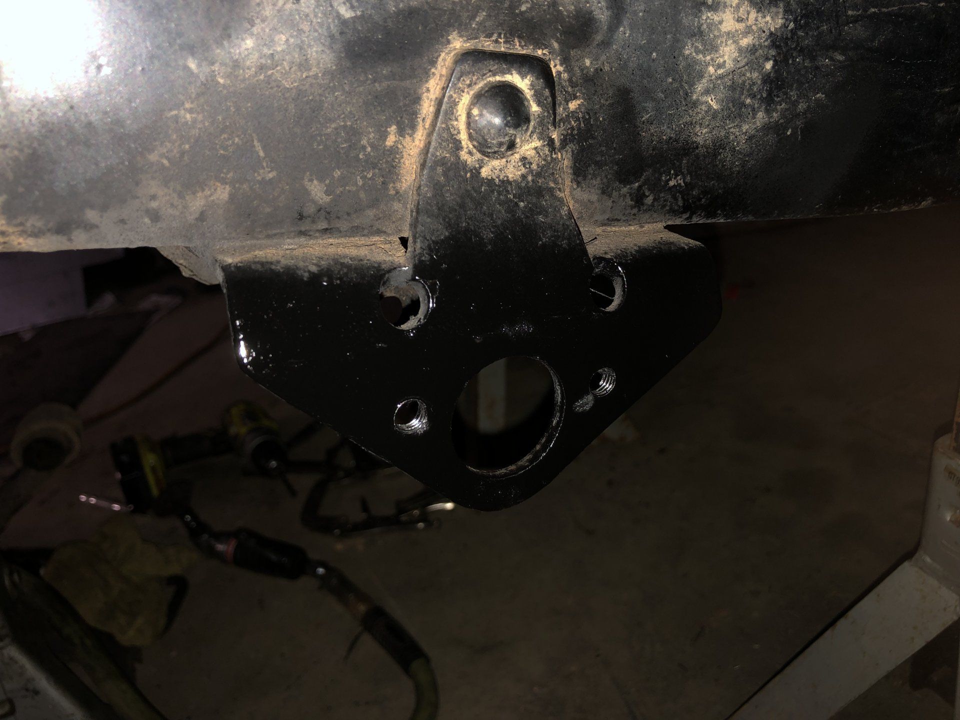

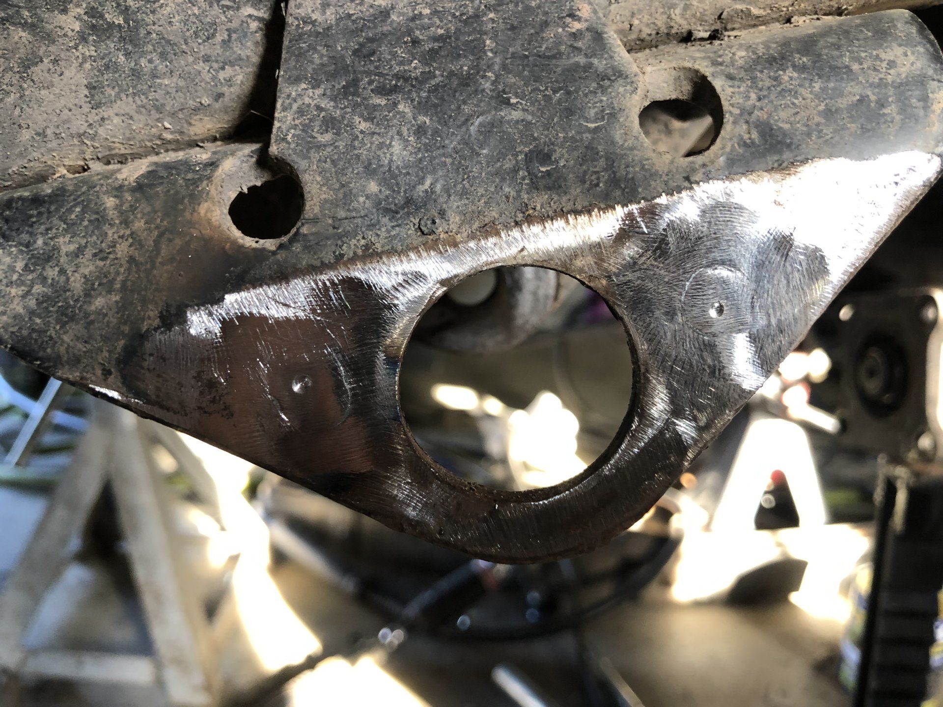

Chopped the spun spring pin bolts, welded the holes shut, drilled and tapped.
Brake tab welded back on (better this time) and new line flared to circumvent the U-bolt flip.
This should have taken like an hour and a half. Instead I spent an hour and a half trying to drill one hole. 3 out of 4 of the spring pin holes went right where I wanted them to ok the first shot. On the 4th, for reasons I can’t figure out - no matter how well I centered the pilot, by the time I got done drilling it was off center enough I couldn’t get the holes on the spring pin to align. The hole didn’t look “egged” and as far as I could tell the bit didn’t wander, but the hole kept coming out like 3mm from where I intended it to...

Yes, one Anti-inversion shackle and one bar shackle up front. The triangular section of the Anti inversion shackle didn’t play nice with my (much too low) power steering mount, so I re-used the old bar shackle, which conveniently was already clearanced for the power steering box and the same length as the anti inversion shackles.

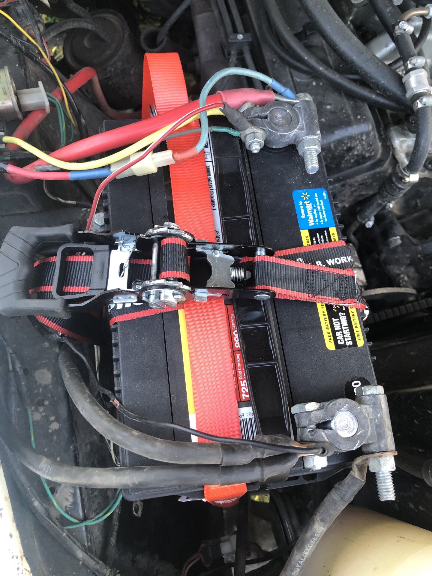

Shout out and a big THANK YOU to all the Keystone guys at Fall Crawl who winched me out when I got double teamed by a rock and a tree, and for the pit team who jump started my truck with no battery after mine melted to the exhaust manifold, and particularly @jamarquardt22 for cutting his afternoon short to make sure I got back to camp without stalling, and @shmukster for lending me his car so I could get a new battery back in the action, and @Crusha for the ratchet straps and getting me set up so this wouldn’t happen again.
Got lucky this weekend, learned some valuable lessons, and am really glad you guys have my back!
Up next from me in the “what are you working on” thread - a better battery tray.
