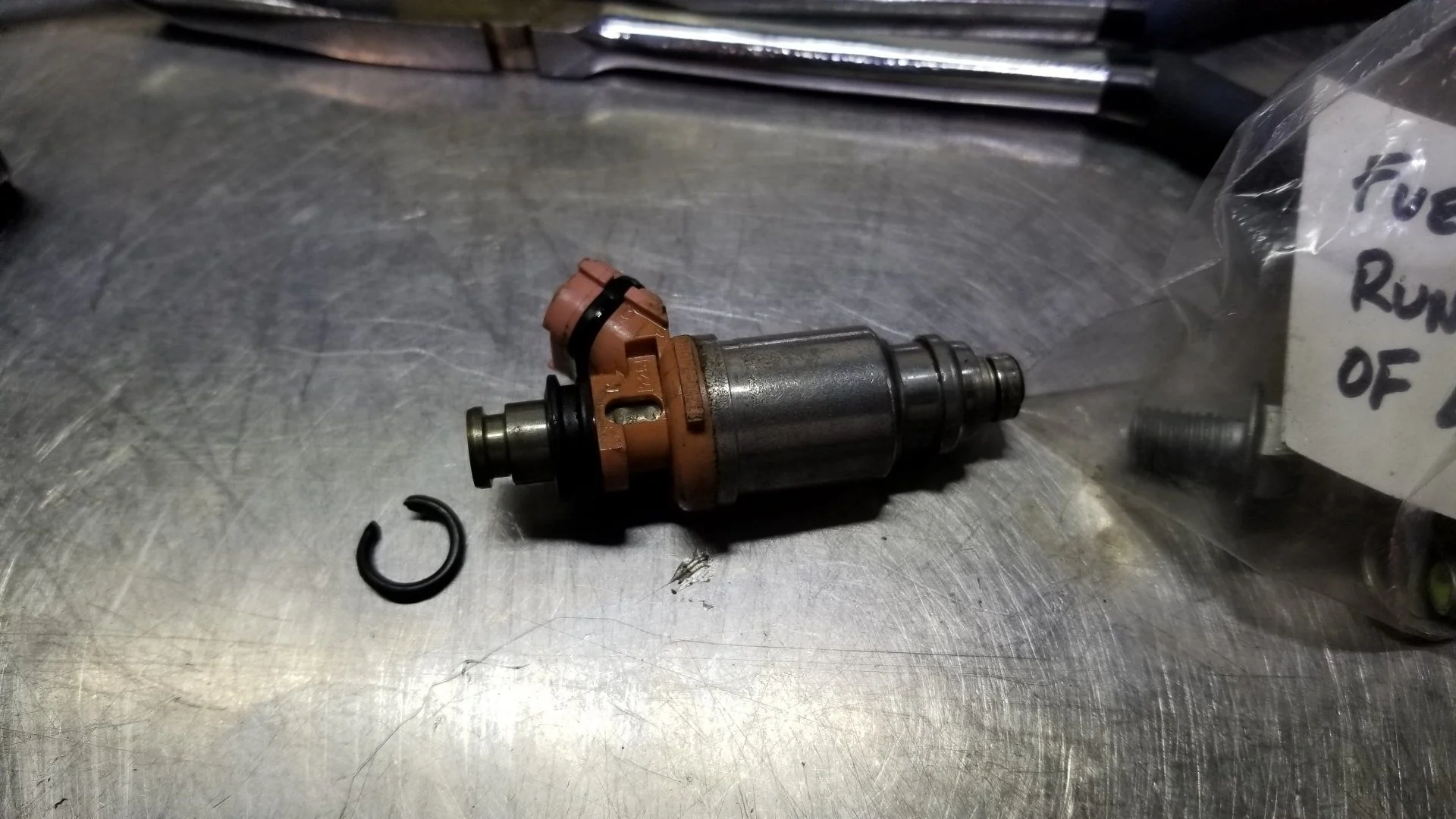

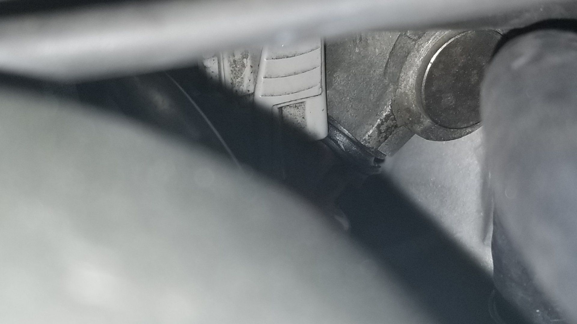

Took the LX450 in for inspection today and apparently the #1 fuel injector has a massive leak at the rail. Not sure what happened there yet, hoping I can get it sorted without having to remove the upper plenum. So that truck obviously failed inspection. Glad I didn't burn it to the ground. I have no sense of smell (not Covid related, been like this for 25+ years), so I couldn't smell the fuel. On the upside, they sorted the rear brakes for me finally so it no longer sounds like a trash hooptie.
Hard to see, but back side isn't seated. Those gaskets don't push up into the rail right? Just the smaller o-rings do?

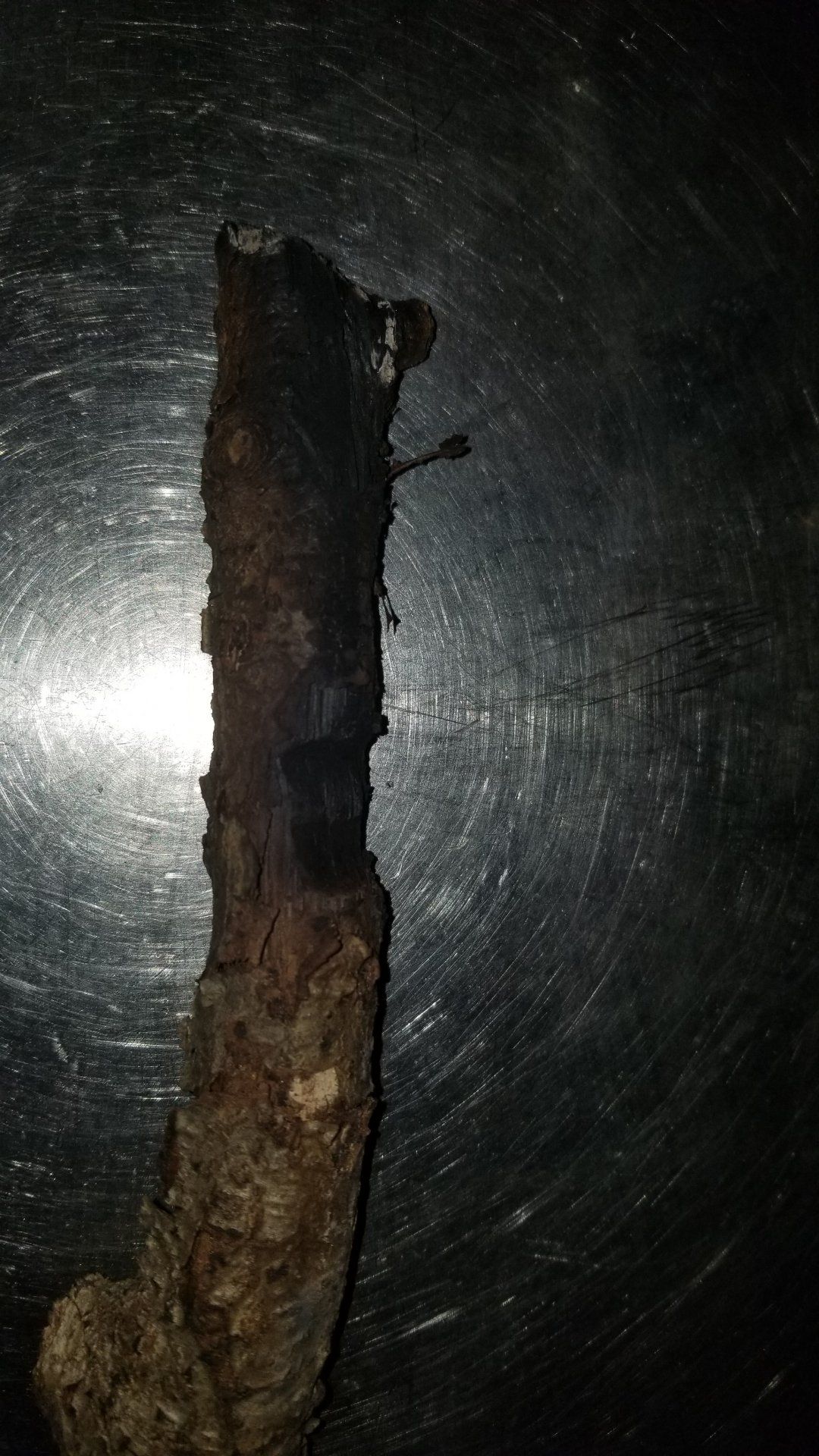

Dropped off the cammo truck then ... the OBD port shorted out ... classic. Already had that fixed once at Toyota. Got it passed as an under 5k exemption for this year. The tech also said he found a stick that was wedged between the frame rail and exhaust that may have started a fire. He's putting it in the truck for me to see.
Stick ...
Def looks charbroiled.
Stick ...

On a scale of toothpick to a phone pole, what are the dimensions of that log?
Spent an hour getting to the fuel rail, loosening it and seeing if the injector just needed to be re-seated. Put it all back together, started it up ... leaked worse than before. OK, there's no use crying in the breast milk (any Dodgeball fans here?), so I got busy on disassembly. Did all the parts I hate, upper plenum bolts and fuel filter bolt. Finally got the rail off and located the issue.
An entire head gasket repair and this is the fail point ... :bang:
I even used all the new gaskets, so not sure why or how that happened. Anyway, I had saved the old gaskets and I found the best looking one and re-installed the fuel rail. Now I'm a bit stuck. I can't get the line from the filter to the rail back on properly with the stupid banjo bolts on both sides.

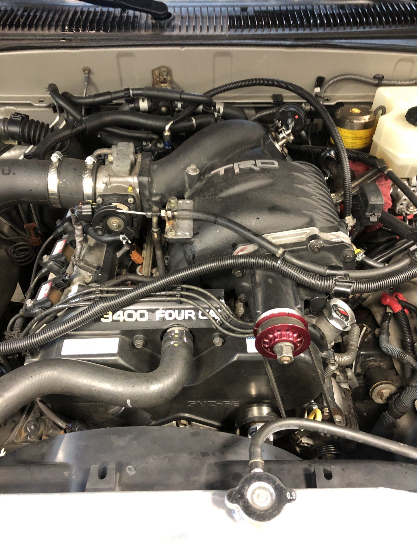

I have been researching super chargers lately. I may be able to get a used one. Are you doing an install or tuning it. Besides the expense of the wormhole it will create, do you think it will affect reliability and durability of the 3.4? Give us some details on that baby!

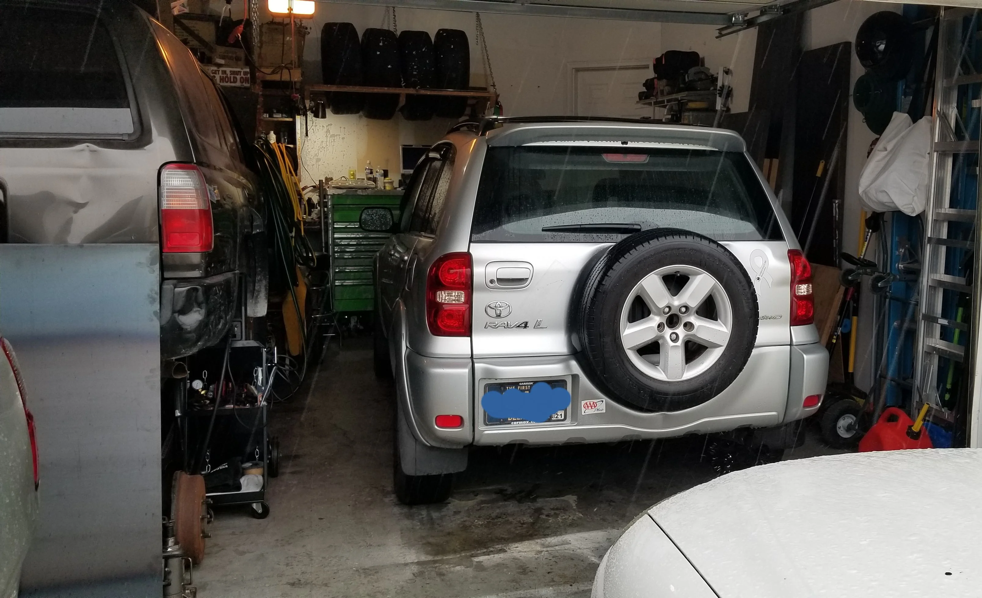

First the first time since furlough ended the garage is cleaned out so I could pull in our Rav4 to start getting the rear end apart to do rear wheel bearings, 141k and a little bit of rust, they are bolt in but so was the Camry and they gave me hell, fingers crossed I can get this job done easily -_-

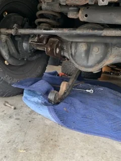

Lower control arm bushing replacement this weekend.
Good news: Rides smoother
Bad news: Suspension thump still there. I think it’s the sway bar joint.
Better news:
I now have a 20ton press and press tool set that will collect dust. If you need to press in new bushings let me know, I have all the tools for an 80 and don’t mind helping someone in need.
Customer installed the blower. It is here as after he installed it the relocacted throttle cable rubbed through a brake line, and he also wanted us to install the new bigger in tank fuel pump. He has yet to install the 7th injector so I dont think I'll get to drive it to its full potential just yet.
Ah the 🐇 hole. The 7th injector was a bandage from my research years ago. The real fix was a tune and larger injectors. Urd used to be the place for the good stuff. I don't know if they still are.
I believe they still are. I have to do some research. Also I read somewhere, I'll have to go back, that you can use 2RZ injectors as your bigger injectors. Which is a nice factory option.
