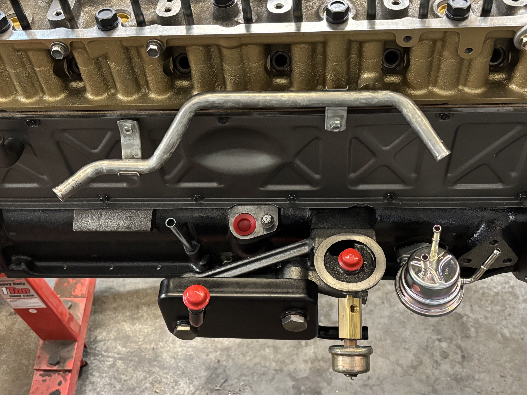

On my 2F both. I'm running a stock sending unit off the oil cooler banjo bolt and a aftermarket oil pressure gauge tapped into the oil filter housing.
My donor motor has solid banjo bolts - not threaded hole for a sender. The filter bracket is tapped just below the filter. I wonder if that’s one of those pre- and post-85 changes Toyota made. See the photos above. I have an adapter threaded into the position (same threads as the sender) so I can run stock and an aftermarket gauge, at least for the cam run-in.

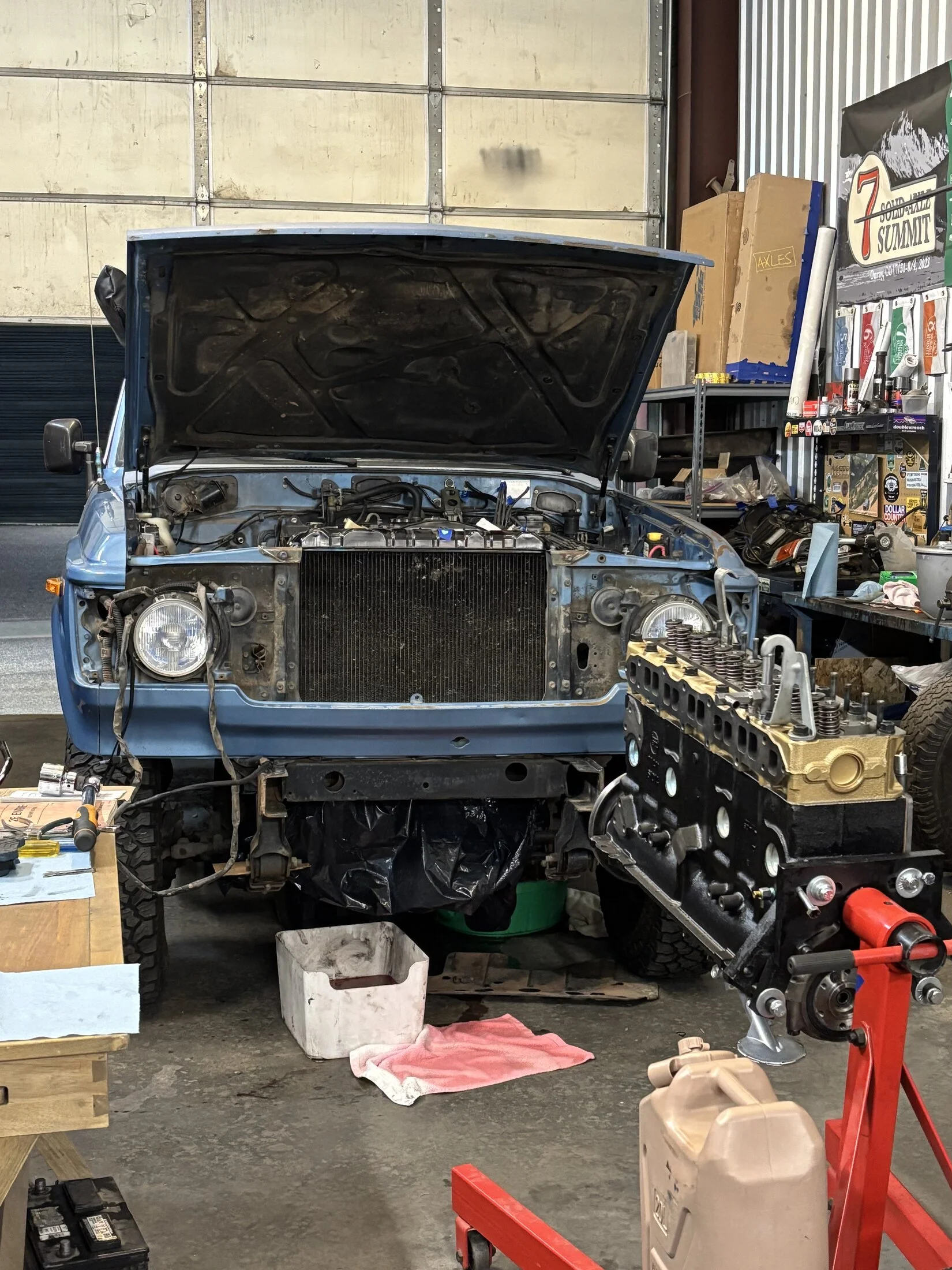

Matilda’s face got ripped off tonight
Fluids drained, some onto the floor. Oops. Both batteries and trays are out. I removed all the engine bay AC stuff and it’s not going back in. Carb, air cleaner, and dizzy are out. Karen’s been cleaning stuff up as I pull it off - it’s still got Moab mud from last October. A solid start to tear down.

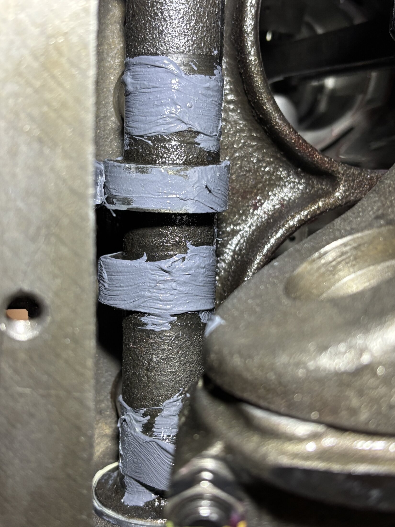

I hemmed and hawed on the cam run-in lube so I took the side cover off, remover lifters, cleaned. Cleaned the cam lobes from underneath while Karen rotated the motor, and then used this stuff.
A couple people I trust kept saying moly, sticky, and use lots of it. So I stopped by the only hot rod parts shop in town, guys who don’t look at you crosseyed when you mention flat tappet motors. They both said 100% this is the stuff for new cam + lifters. And since it aligned with what a couple trustworthy folks said…
The bottom of the lifters got some of this goop as well. The sides of the lifters got a very thin wipe of 15w40, and the tops got assembly lube. Three different goops per lifter … I’m in overthinker’s territory. But it’s done and sealed up.
The threaded banjo bolt I'm using is from an '81. I think the threaded vs. solid banjo bolt is one of those early vs. late variations but with an earlier cut-off than pre- and post-85. I recommend retaining an aftermarket oil gauge that will give you an actual reading, or at least run it for a few thousand miles until you're confident of the oil pressure in the new motor.

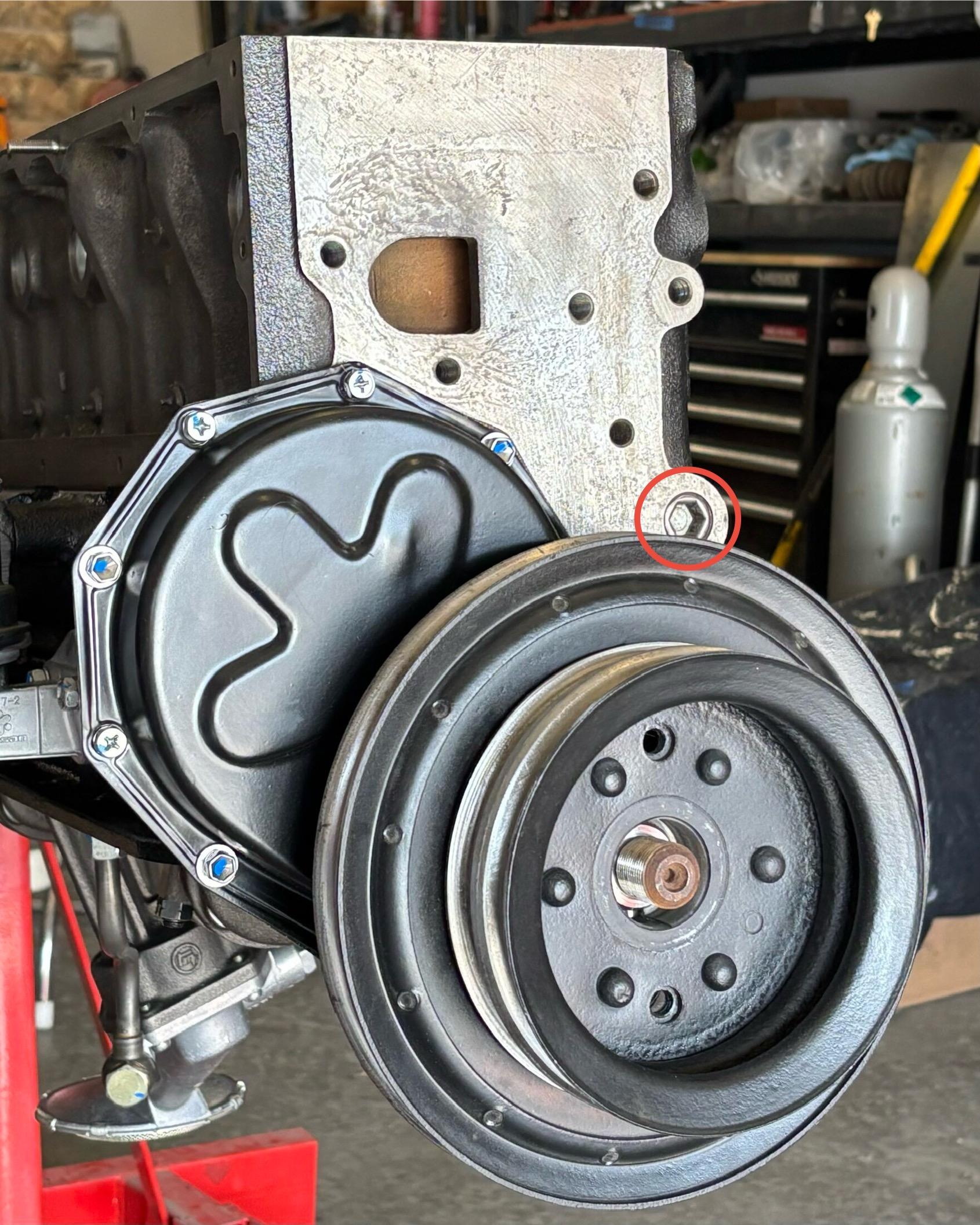

Found some interesting differences between my existing block (1982) and my new block (1986) last night. Some of the holes on the front are threaded differently!
First, the power steering pump bracket has three bolts on the side and one on the front. On my existing block the front hole is coarse threaded and had a stud with a nut. On the new block it's fine threaded and uses a bolt.
Second, the water pump bolts are threaded differently. Luckily when I was ordering parts I was using a 1986 VIN and I have the correct bolts on hand.
I haven't tested it yet, but I've heard the threading for the two manifold studs is different in later versus earlier heads. I don't have new studs, so I'll cross that bridge later today.

The later blocks also have threaded plugs for an oil gallery on the left side of the block instead of using Welch plugs. Which is good because they improved the design. I dislike Welch plugs lol. From the rear of the engine it is behind the bell housing. From the front it is right here

Yep my 1982 block has a welch plug where you circled on my photo. Also, see the threaded hole directly above the Allen head plug? That doesn’t exist on my 1982 block. No idea what it’s for. Could be a different bracket for a different belt-driven accessory arrangement on non US trucks perhaps.

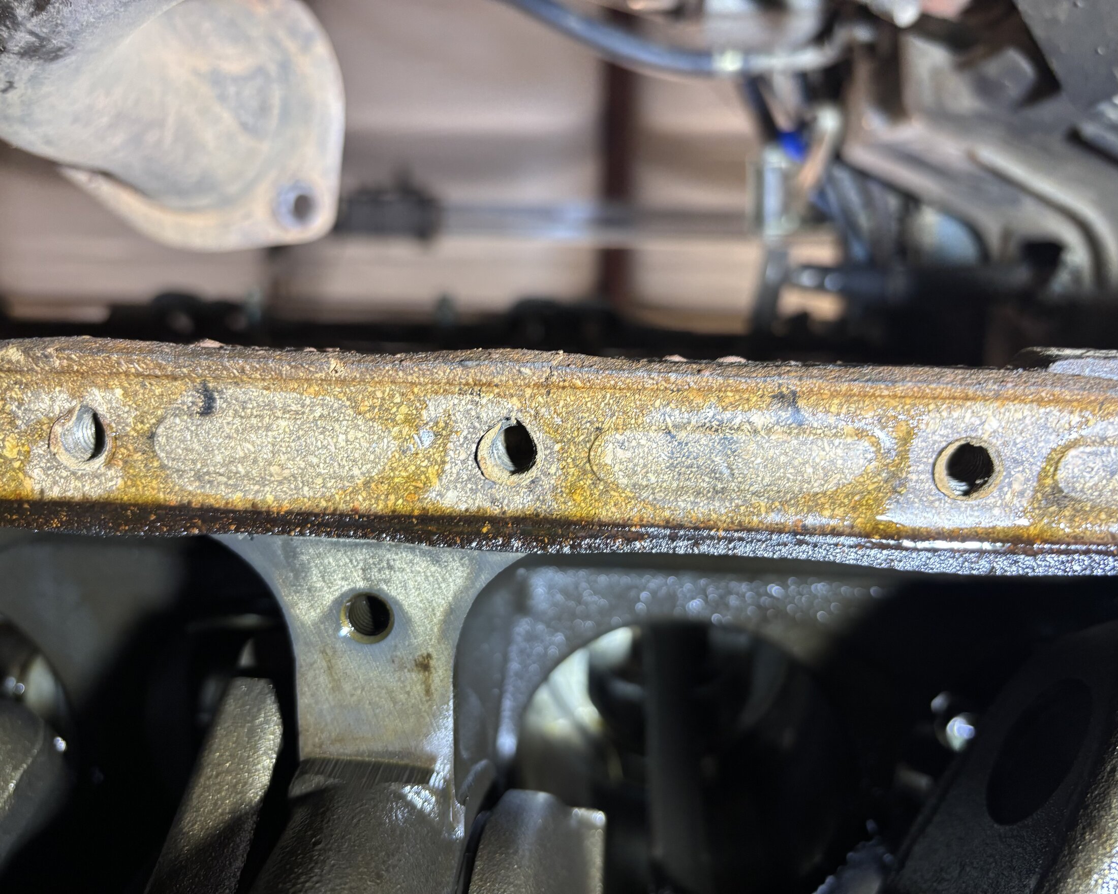

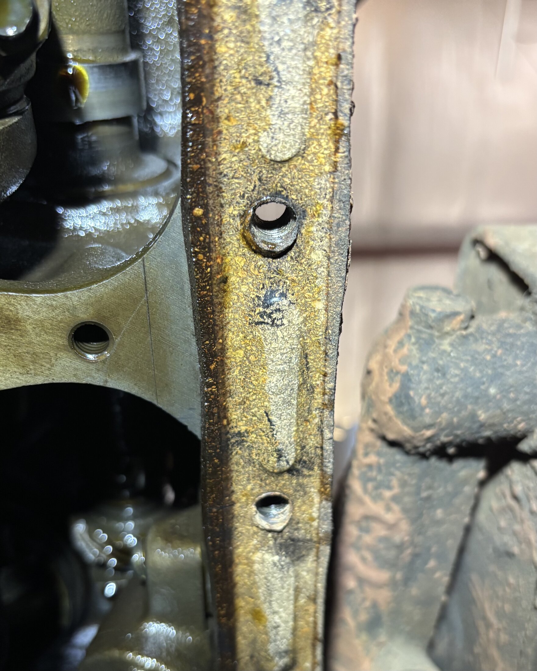

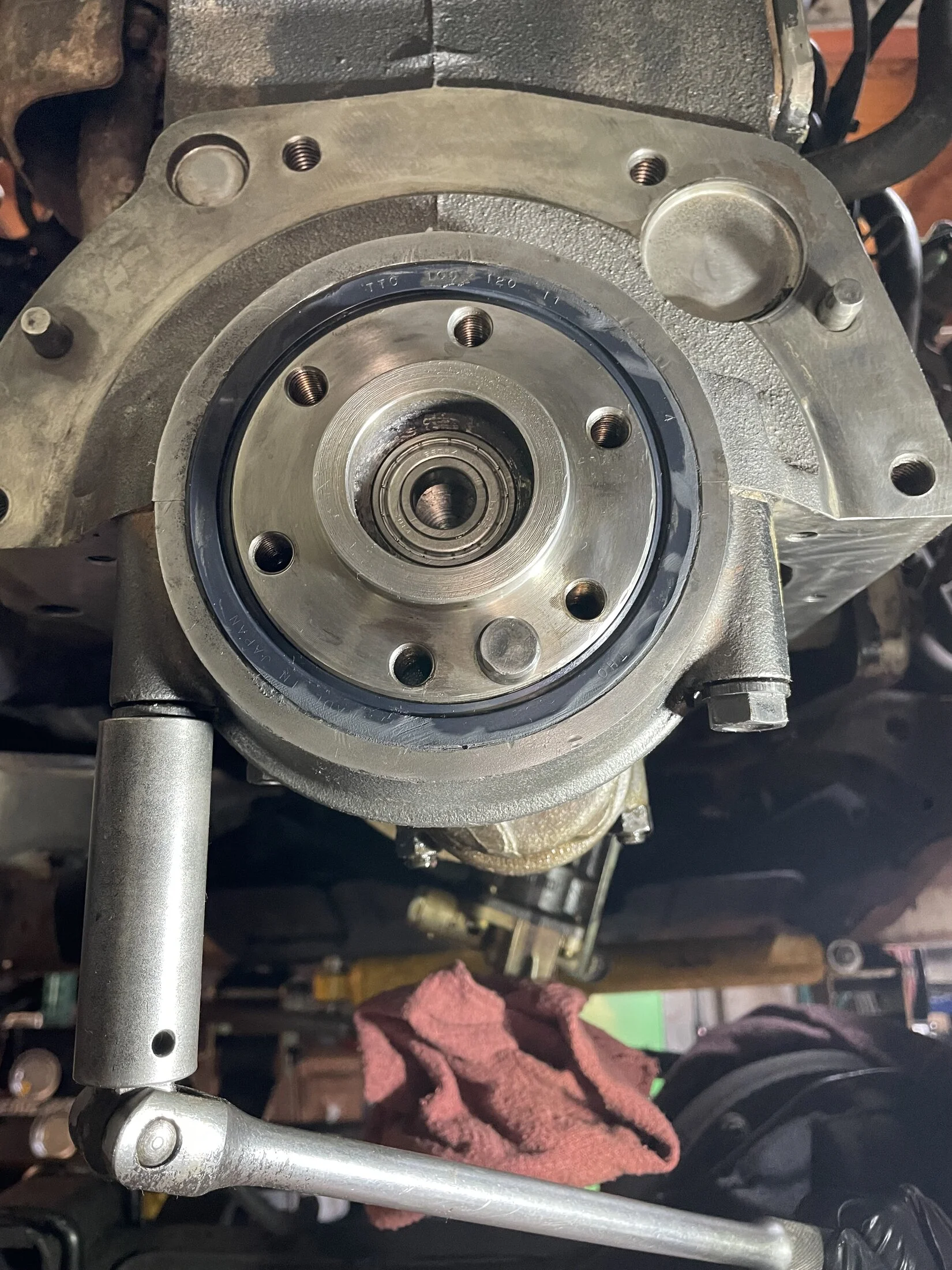

Took the oil pan off the old motor last night so it could be swapped to the new motor. Bought brand new from Toyota last summer and installed with a Toyota one piece gasket. I followed the FSM procedure to a tee: FIPG at the corners, dry everywhere else, brand new bolts tightened to the specified torque. And as you can see below the oil was getting past the gasket literally everywhere. Notice the darker areas of the gasket - saturated in oil.
I’ve read lots of Mud threads on installing the oil pan on a 2F. What’s the real solution here?
Have you read/seen Georg’s @orangefj45 write up on it?
seemed to work well for me.
The copper spray stuff layered on mating surfaces is the trick I think?

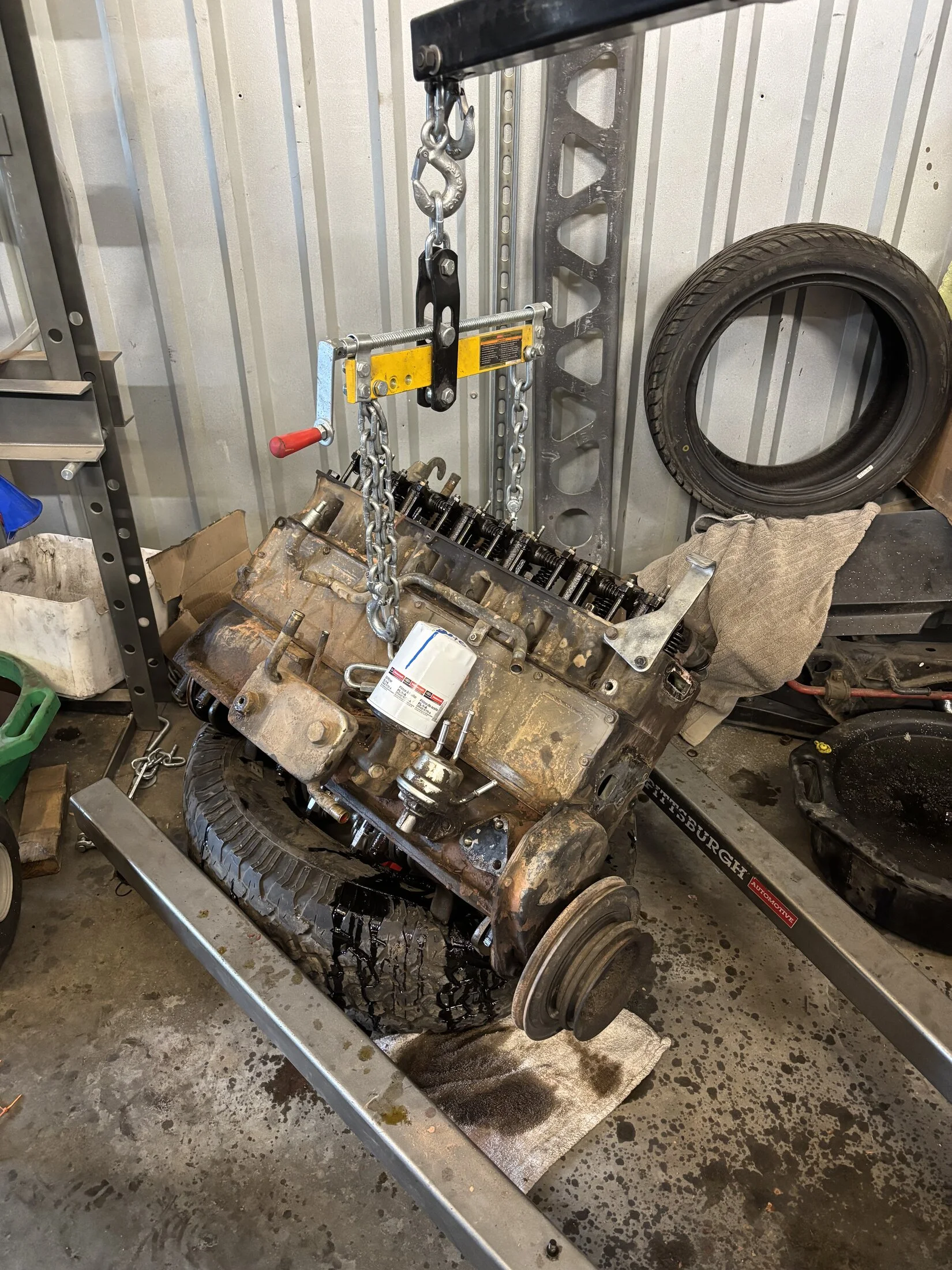

Karen’s feeling accomplished tonight. Old motor has been liberated. Despite running to some difficulties today, we saw it through and made big progress.
This thing came to us with two quarts of oil and 105psi compression (except for number 1, which had 135 for whatever reason) and still gave us 40,000 miles of service - commuting, hauling stuff, and lots of memories made on trips. We both poured a little 15w40 on her and said a few words.

Karen has been cleaning every part, nut, and bolt as I remove them this whole time, so all the parts are ready to go back in. What a saint she is - I definitely wouldn’t be this far along without her. I’ve been cleaning and chasing threads where needed too so things will move fast during assembly. Tomorrow I’ll drop the new motor in solo, then when she gets off work we’ll both put the hammer down bolting parts up.

I followed Georg’s method and it worked perfectly. It’s almost spooky now how well it sealed. I have zero drips in the garage floor after 5k miles. Feels weird :). On the plus side, my old engine was so leaky none of the bolts I’ve encountered were frozen!

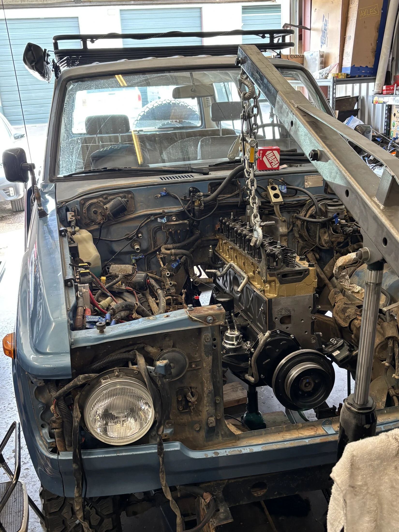

Motor is in! No drama, went very smooth. Karen is a whiz with the hoist maneuvering, and my friend Josie came by to assist as well. We should just let the girls do this stuff, they seem way better at it.

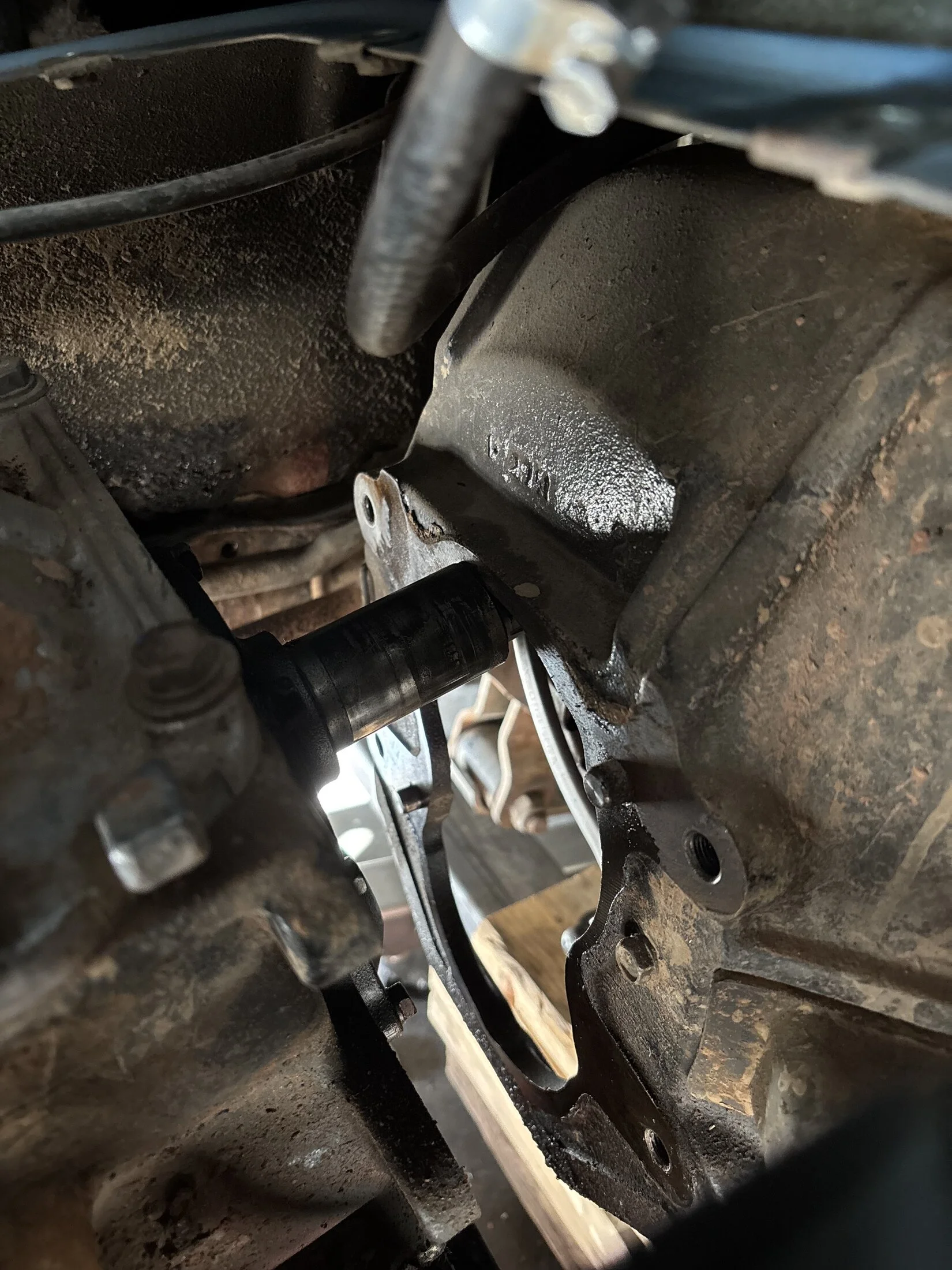

Story of the day was yet again the transmission being a drama queen. Forgot a pilot bearing, luckily Napa had an SKF in stock. Didn’t have a clutch alignment tool so I rigged up a dowel affair and eyeballed it pretty dang close. Got the input shaft into the clutch splines and spent an hour trying to nail the pilot bearing with no luck. 9:30PM, hungry … left for dinner and called it a night.
I think my eyeball alignment isn’t 100% - the center of the clutch is not perfectly aligned with the center of the pilot bearing. The clutch splines are now guiding the input shaft slightly off center from the hole in the pilot bearing. It’s so close to going in but just won’t do it. Tomorrow morning I’m going to loosen the pressure plate so the clutch can float a little bit, then try again. That should give me what I need to get the transmission in. It’s 8mm from being fully seated, the bolts nail the holes in the bellhousing, the dowels are very close … I think I’m missing the pilot by 1-2mm. Should go quick tomorrow.

Do you have a couple of long bolts with heads cut off to serve as guides for aligning the bellhousing, transmission, input shaft, etc. ? Guide bolts fit in the lower bellhousing bolt holes and help greatly with alignment.
