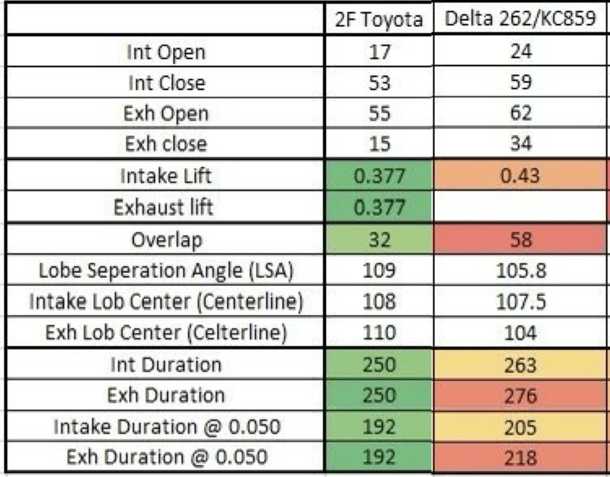

- I dug out my sheet from Delta Cam. It specs .014” for valve lash on both intake and exhaust. I set the valves to stock - the same .014 on exhaust, but a much tighter .008 for the intake. Perhaps the tighter valve lash is opening the intake valves too soon and leaving them open too late. Chances seem small, but there’s is a possibility that could cause a decrease in vacuum.
FYI, I found a chart here on Mud comparing cams, then edited it to show only the stock cam versus what I have.
With that additional amount and duration of intake valve lift, and the rocker hitting sooner than Delta prefers (due to my stock .008 clearance), it might just be causing me some issues. This gets into the stuff old hot rodders know, and that I absolute don't know at all. Those guys love a good lopey cam, which makes tuning for idle difficult and brings down idle vacuum but makes their car absolutely rip off idle. Obviously I don't want a lopey cam and lower idle vac, and I think in my conversations with Delta, this cam I have is not that at all. But with that intake lash misadjustment ... maybe it's having almost the same effect.

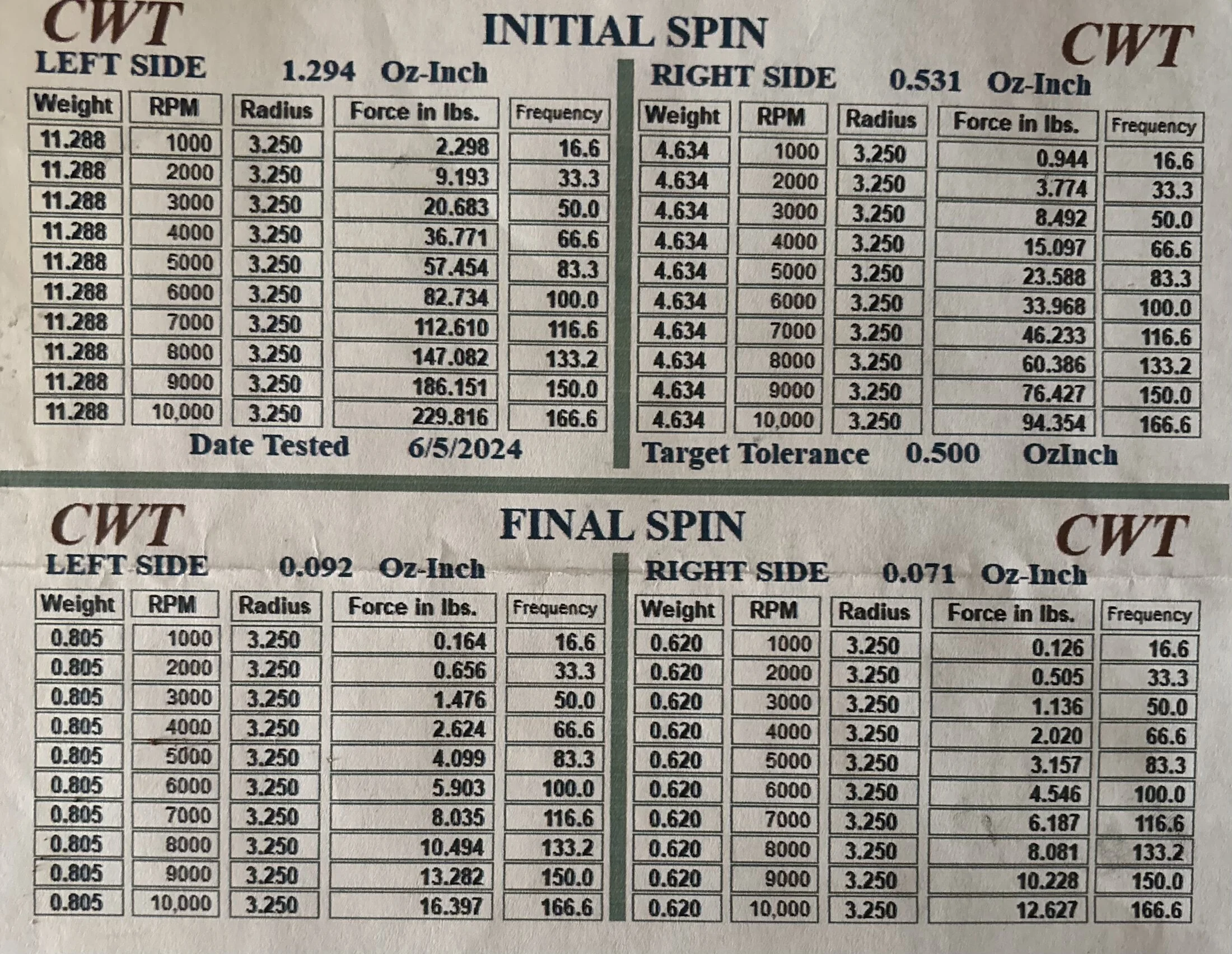

Anybody know how to read this balancing sheet?

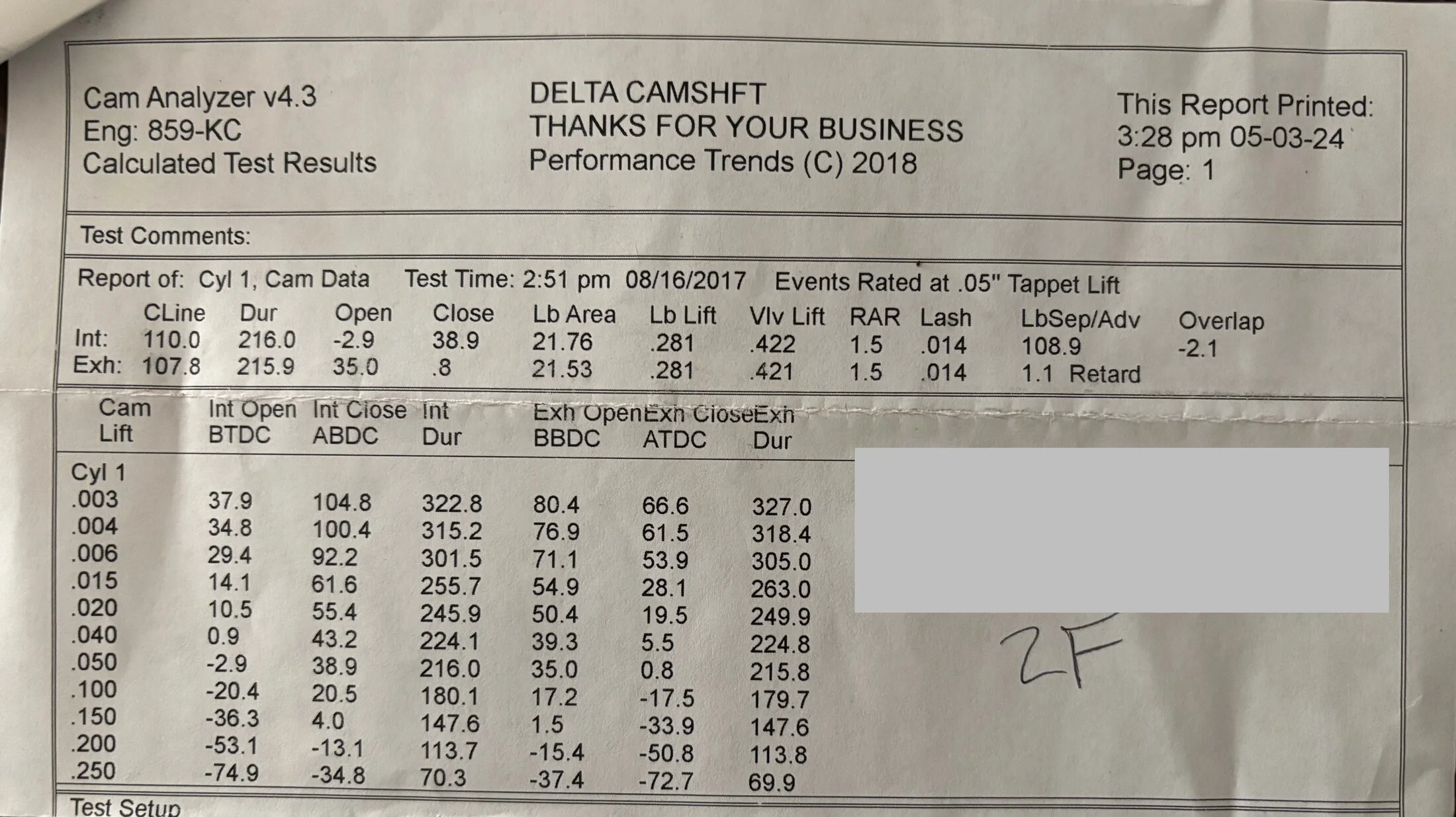

Here is the cam sheet Delta sent me in case anyone is interested. I understand some of it, but not all.
