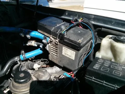

Here's the mess of wires I'm dealing with. A glow plug relay, starter relay, as well as windshield washer lines are going to have move a bit.
i THINK i flipped them around so the fender stuck inside the fender instead of out and i MIGHT have run the wires inside the fender as well

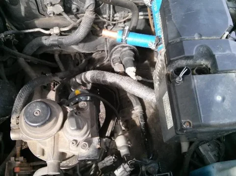

Crushers, my install instructions allow for drawing off the diesel supply using a "T" within certain limits.

yes, that is how i run it as well, T into the main feed line but air bubbles are a huge NO NO. so play safe.

As my install is on a different vehicle it will be an experiment. I was worried about how close to components I could be but from the photos on here I'll be ok. I'll have to move a few bits.

Finally got my webasto installed
Used the exhaust wrap. Smoked a bit at first but calmed down by the time I finished a beer.

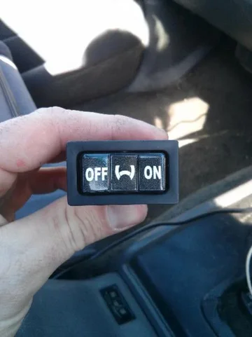

I'm also using my old dual set suspension switch to create an in dash switch. Having it relabeled right now. I'll post a pic when I get it back
