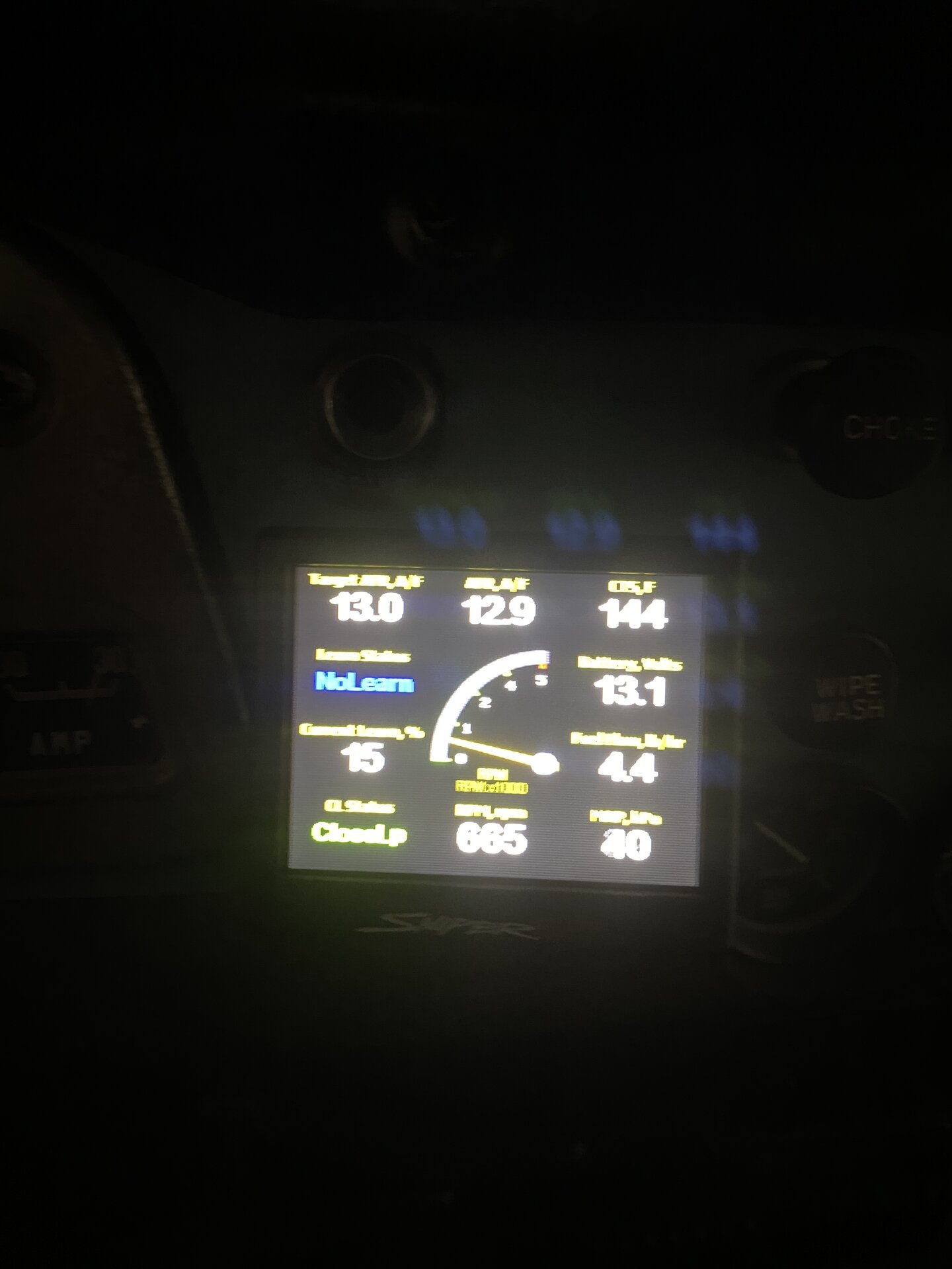

I have recently installed a sniper and noticed the voltage seemed a bit low driving around. Around 12.2 to 12.5.

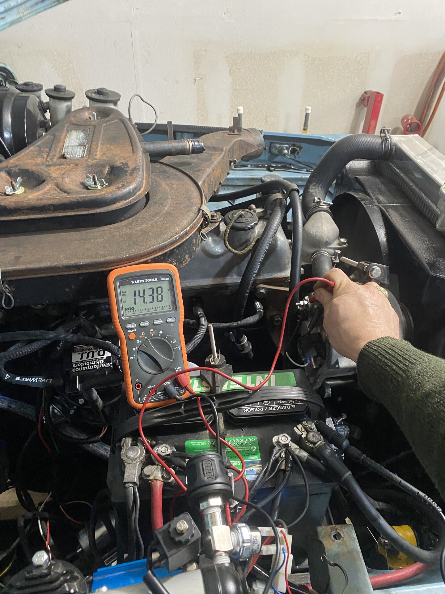

When I get home I checked the alternator and get 14.38V

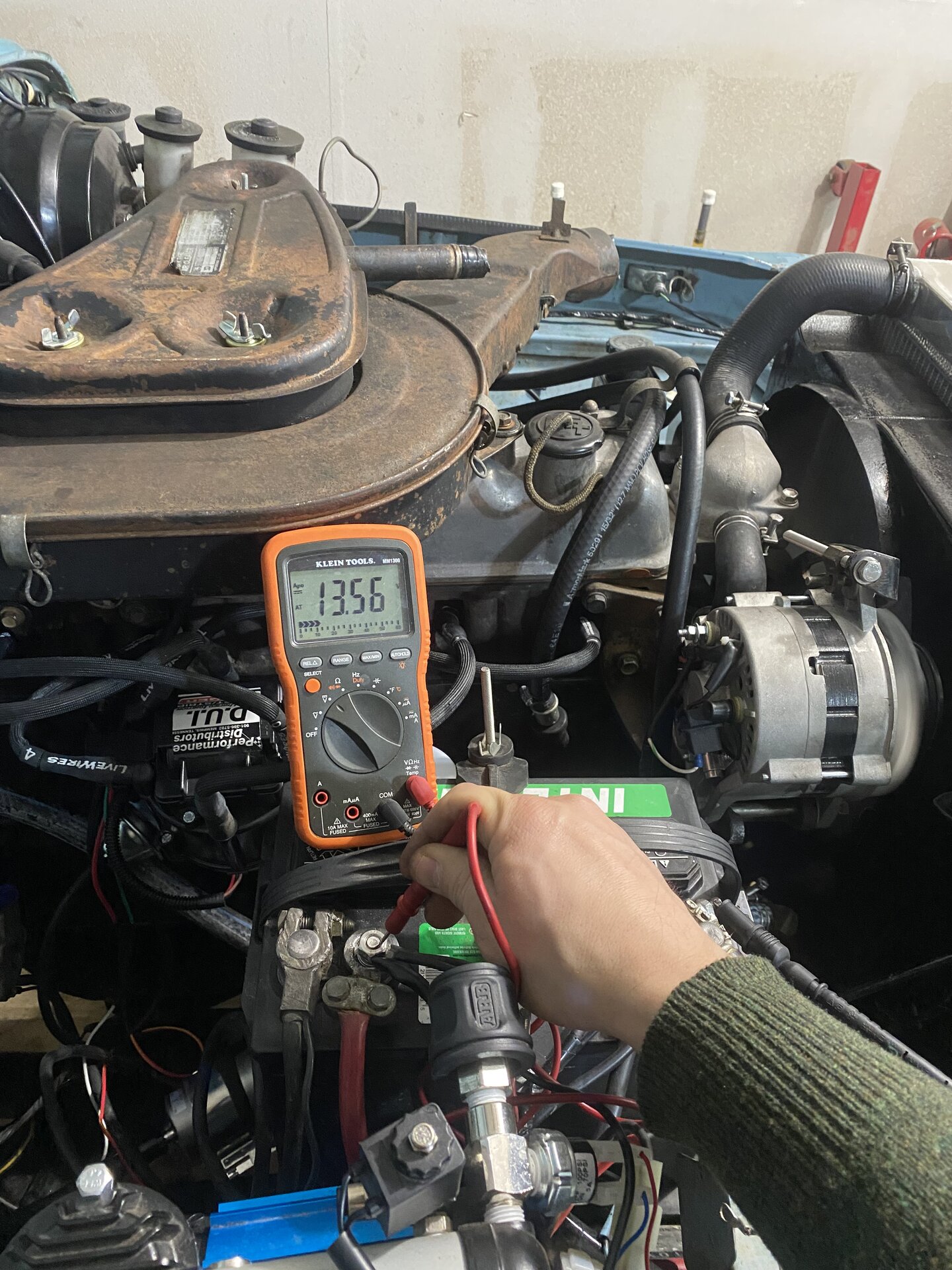

The battery shows 13.56V
But the sniper readout is showing 13.1V. I drove the cruiser multiple times throughout the day and it never read above 12.5V so not sure why it does now.

Sniper is wired directly to the battery it should read the same unless i'm missing something. Is there a way to calibrate that read out on the sniper maybe it's off?
There has to be something inline causing that voltage drop after the alternator. The alternator seems to be working just fine since the volts are good at the post. What is the battery voltage when the truck isn't running? Can you measure volts at the next junction after the alternator? Maybe you can work your way down the line to see where the issue is.

Your stack up of positive and negatives connectors on your battery is incredible. @ToyotaMatt is correct to point out those stacks of terminations need to be cleaned up.
I suggest, as a diagnostic test, you run the feed to the Sniper system directly to the alternator. That will determine whether the Sniper is reading wrong or there is voltage drop through the stack of terminations.

I would not worry about the voltage discrepancies. I doubt the Sniper's built-in volt reading component is of high quality or all that accurate. Why would it need to be? The only use I can see it providing is that if the Sniper is getting less than 12V. And if that happens, you then need to pull out a quality meter and start diagnosing your electrical system. If you’re looking to monitor system voltage on your dash, then I would suggest installing a quality dash mounted voltmeter.
13.5 at the battery post is correct, The sniper reading is being thrown off somehow.
